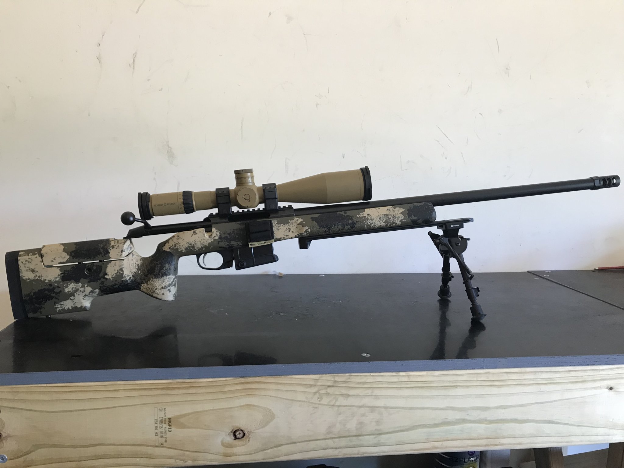

Tikka T3 Thread
The tikka is finally finished. Rebarreled and back at home. 7mmSAW, 26” 8T Proof steel barrel.
Edit: Updated pic. Got rid of those things that butler creek refers to as “scope caps” for a better set.

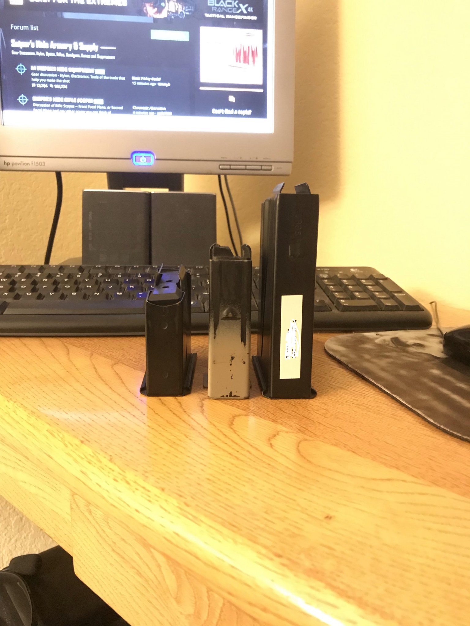

Yeah, I'm going to have to call BS on the length statement. The CTR mag is in between the lengths of the 5rd AICS (which is flush on most chassis) and the 10rd AICS. It's more along the lines (lengthwise) of the AW mag. And yes, I have all the mags I mentioned.
I'd love to see a picture of a single stack 5 round AICS magazine being flush with anything. I put an MDT 308 5 round mag next to a 10 round CTR and they weren't so far off. A 10 round towers over both. I'm not trying to put down AICS, just saying it shouldn't be an automatic decision for any CTR owner to switch.
-Stooxie
-Stooxie
Here you go...
The CTR mags are about the same size as an AW mag (with makes sense, since they are both double stack, double feed mags). Sure looks to me like an AW/CTR mag is in between the two AICS mag sizes... (my CTR mags are up in MT, or I'd include it in the picture).
Awesome, thank you!
So confirms what I said ;) I guess it depends on the definition of "flush." I take it to mean flush with the forearm, like a hinged floorplate. The 5 round hangs down almost has much as a the CTR 10.
Again, just pointing out some pros and cons.
-Stooxie
Very nice! What contour is that? I have a Proof going on my Tikka as we speak. Who’s your smith?
