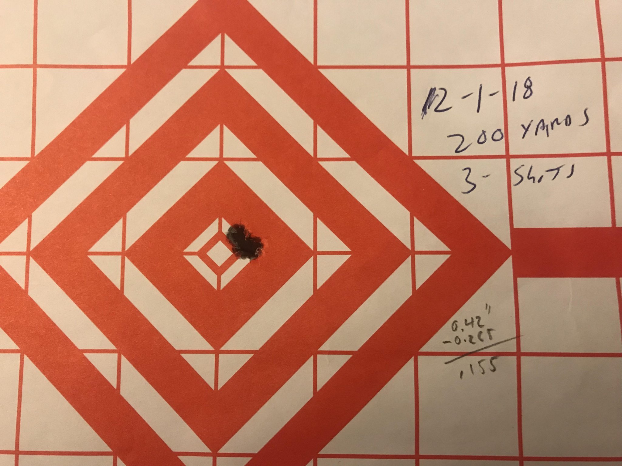

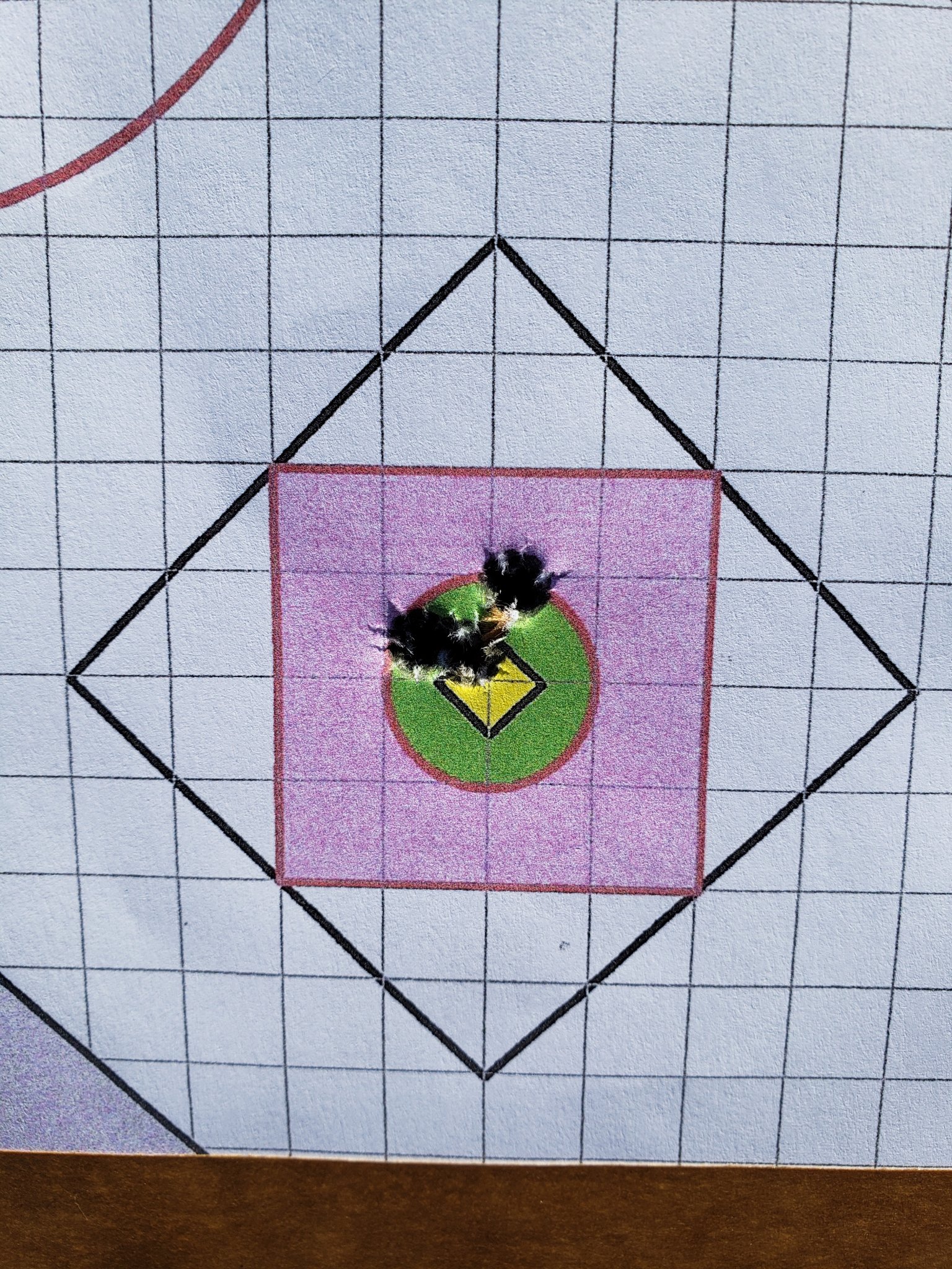

Took my 20 inch 260 CTR out for the first time today. After I got it zeroed I shot this nice little 3 shot group. Yes I know it is only three shoots but time and ammo where limited on my lunch break sight in.
I am still impressed with the quality of my Tikka CTR in 6.5 CM I bought in the spring. I was at my range the other day to sight in at 200 yards so I came up from my 100 yard zero 1-3/8 MOA and this was the first 3 shots. A 3 shot group all in one hole at 200 yards, I don't think I can reproduce that with 1000 rounds and some luck. But the gun will shoot half MOA easily. I have won a bunch of local egg shoots at 300 yards with the gun and a 200 yard shoot also. I shoot Sierra Match King 142 grain in either Lapua brass or Alpha, 10 thousanths off the lands and 40.7 G of H4350 CCI magnum 450 small rifle primer. I look forward to trying some PRS matches out to further distances next year with it. I am learning a lot all the time with this sport.

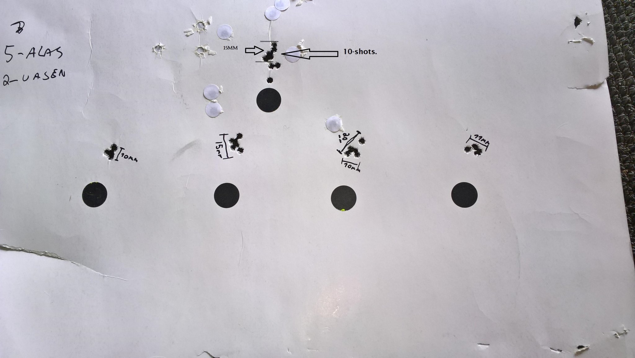

One 5-shot group is ok.
But how about 4x5 shots and one 10-shot group :cool:.
This is over a year ago, but still counts.
Tikka T3X CTR 260rem.
Shot with MDT ESS chassis.
Ase Utra SL5i supressor.
4-low shot´s are 4x5 and one in the up and middle, is after the 4x5 one full magazine.
Time for all this went about 20-25 minutes, so that the barrel was warm, or even hot.
