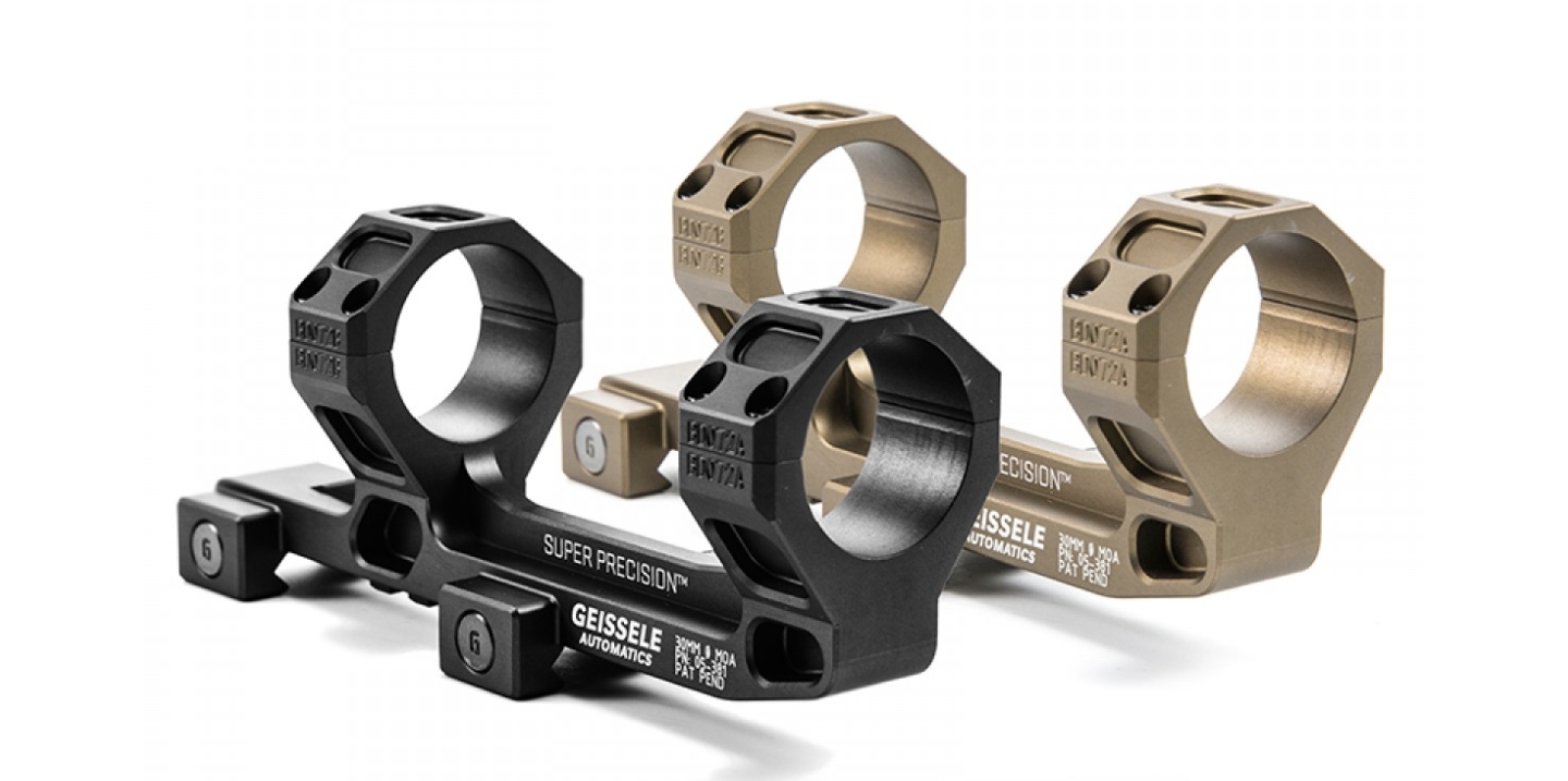

Looking at the rail it looks like it would be hard to match up. Mountain Tactical advises against replacing the rail. They suggest using a mount with 20 moa built in.
Which 20 moa mounts are solid that folks are using? My scope has a 34mm tube.
Reactions: Winkmeister
Geissele mounts in 34mm are excellent. For longer scopes , They're excellent. And come in 20moa...
