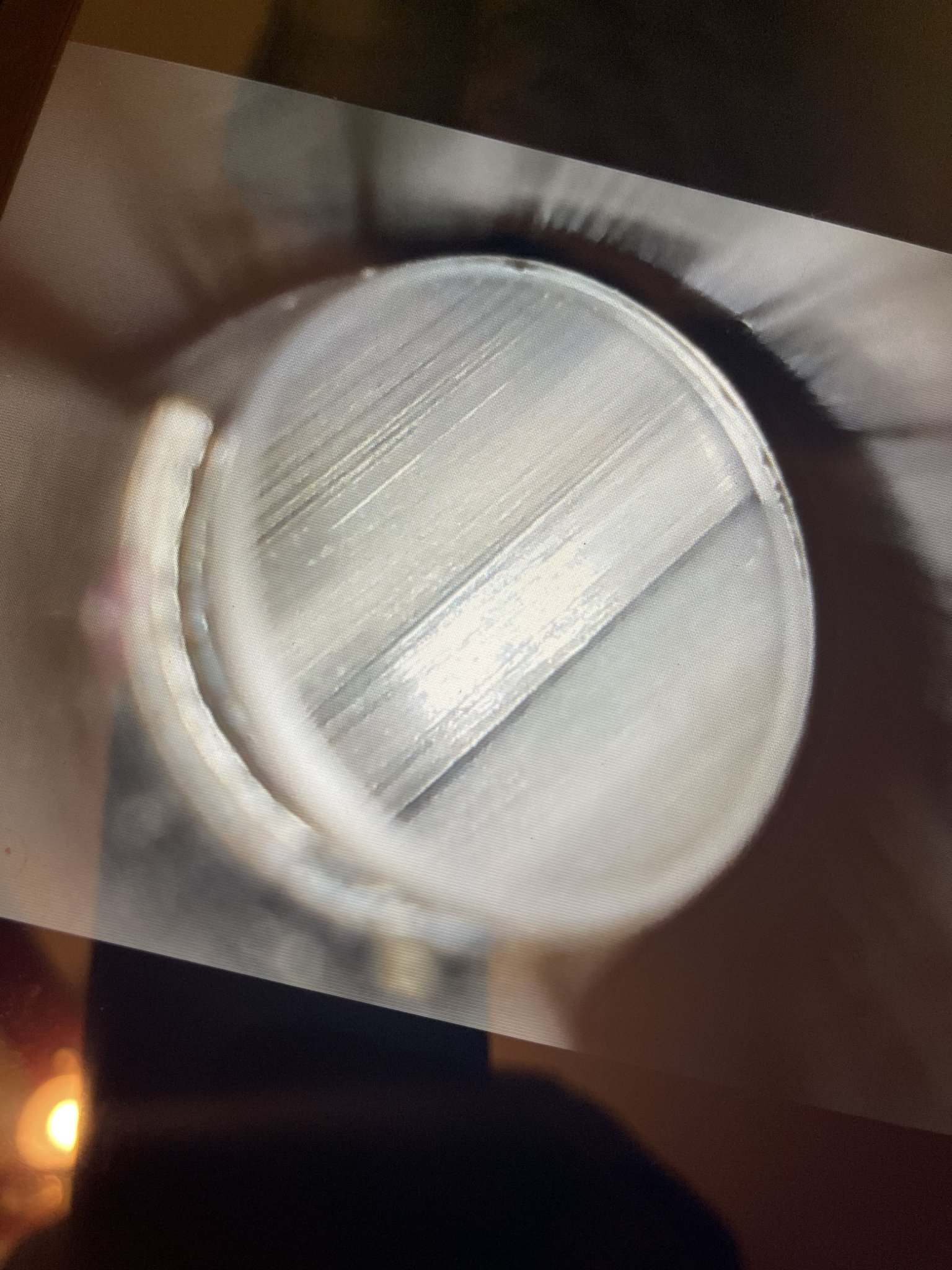

A borescope really helps with cleaning. The teslong is pretty cheap and does great job.
Let’s you see exactly when you have the barrel cleaned to your liking.
