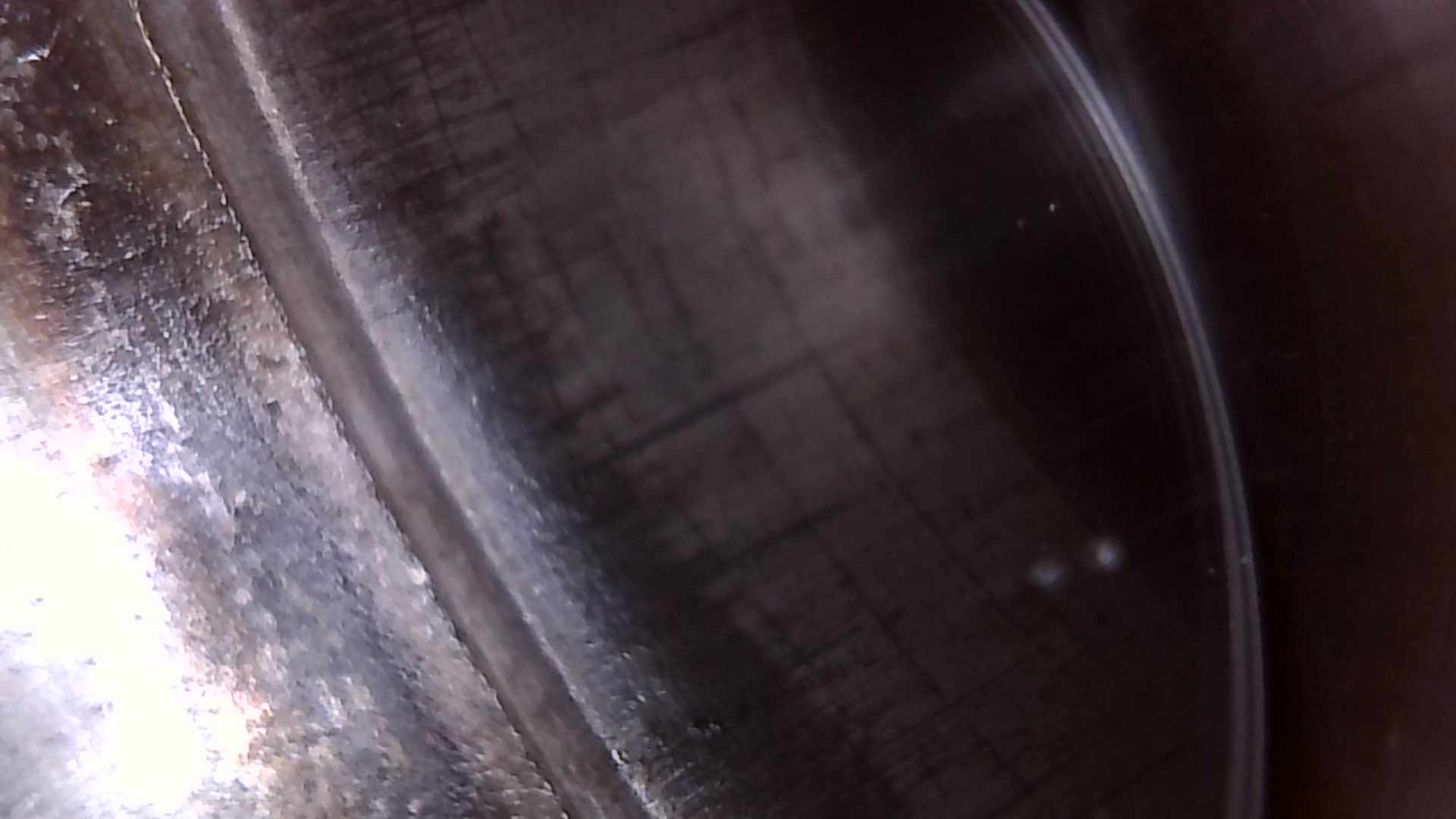

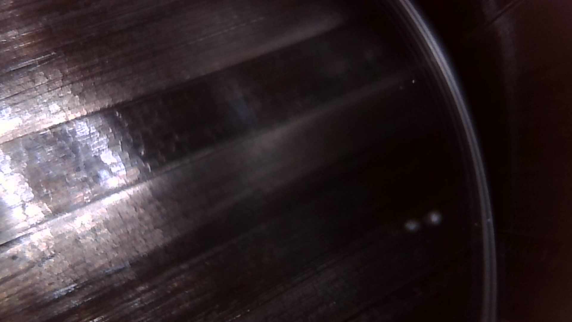

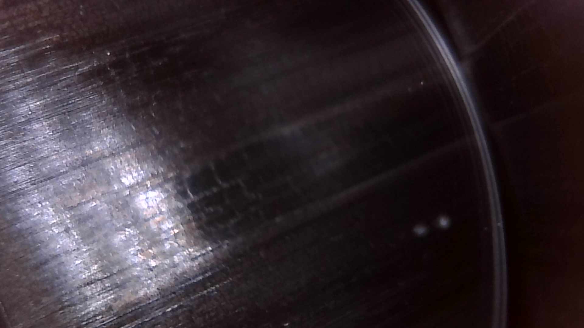

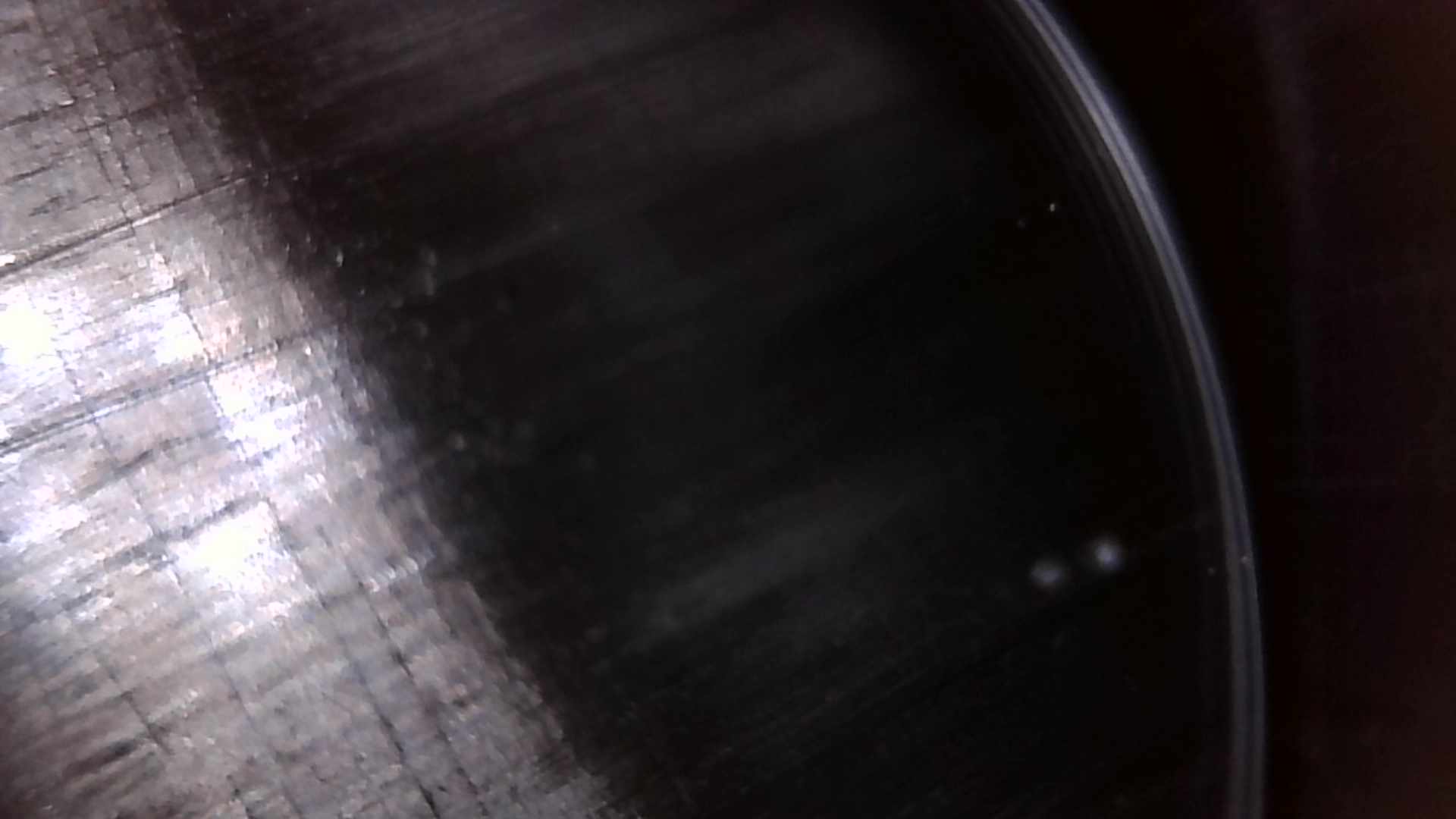

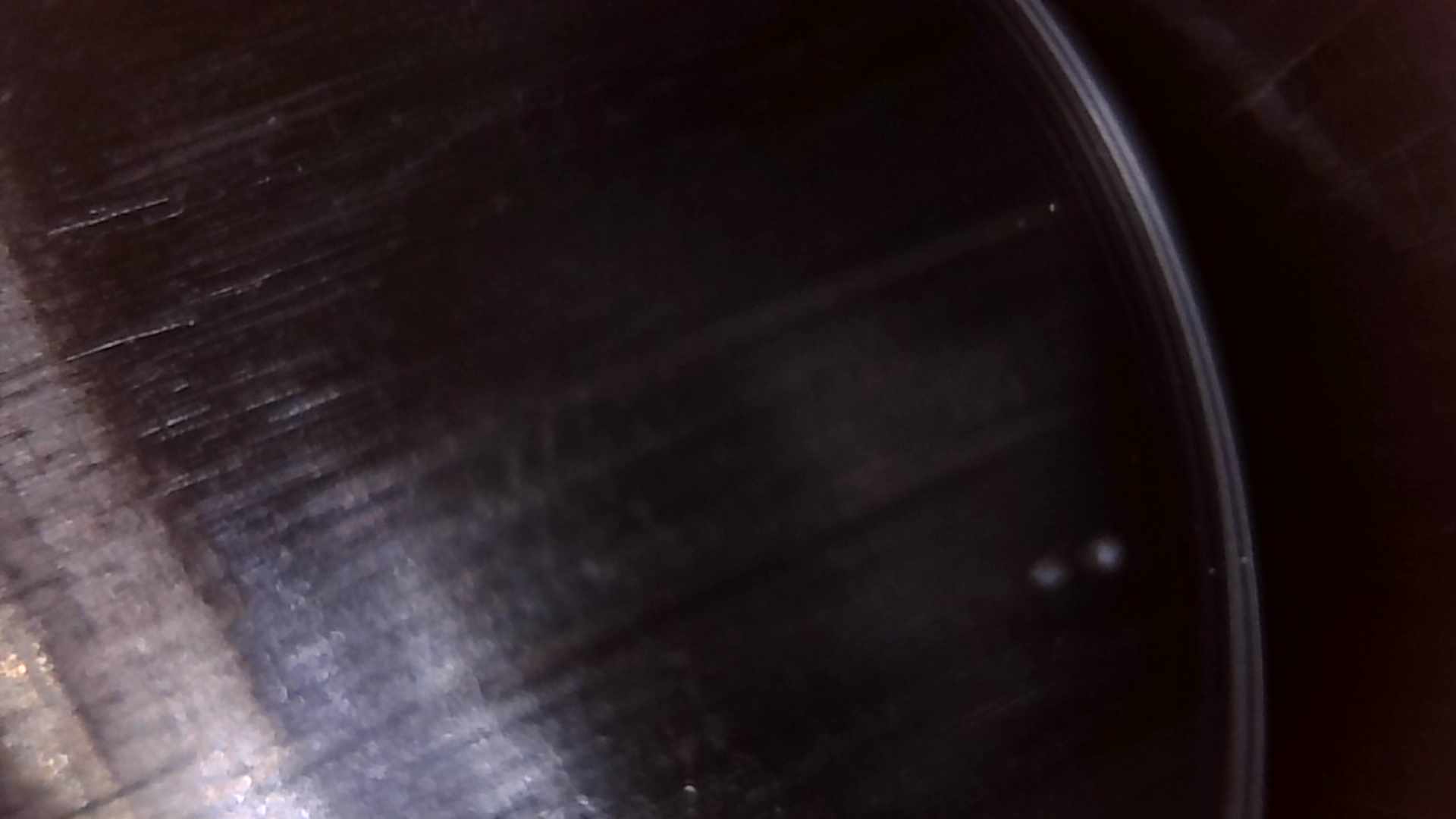

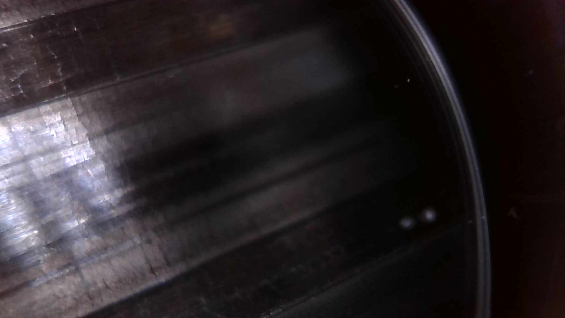

Hi guys,
Can someone chime in here on whether or not I should be rebarreling? I already have a new bartlein in hand for my ax338, but I'm not sure if it's necessary to make a change yet. I'm leaning more to the side of doing it anyways though because my groups have been opening up.
Couple photos I took through the borescope.
(that's the one that has me most concerned since there's firecracking on the grooves).
Thoughts?
Have you ran those rounds that are now opening up over a chronograph?
Have you ever tried seating the bullets further out during the lifetime of that barrel?
I've definitely had far worse looking than yours shoot great. That's about what my 6CM barrel looked like at 600 rounds, and it made it to 1400. Accuracy and velocity falling apart together is usually a pretty good indicator that it is time. Sometimes, just accuracy falling apart is a failure elsewhere.

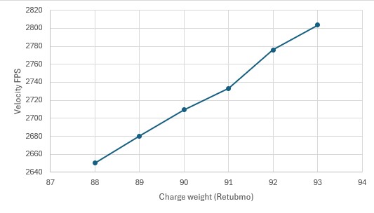

Biggest change I did was switch to the Nosler RDF (bergers aren't in stock anywhere). I didn't change anyting seating depth wise with the new bullet, kept the powder charge the same, and was getting very similar velocities. I even shot a match with the new bullet and was getting impacts at 2,800 yards (which is honestly a stretch for this rifle). But up close at 100yds on paper, the groups just suck. I even redid the cortina method where you find jam, subtract 20 thou, and then shoot 4 shot groups every 4-5 thou shorter. The best group I shot was 0.67 inches at 100 yds. I'm not pleased with that. This thing should be giving me hole on hole accuracy. So I ordered a new barrel, but before I have it spun up really want your guys opinion.
Also velocity has not dropped off. I'm sending a 300gr nosler at 2,750 with 91gr retumbo.

They ain't Bergers and that firecracking ain't that bad. Compare apples to apples. In my opinion your barrel is still good.

It doesn't look horrible. I don't see chunks out of the sides of the lands from what I see.
What and how are you cleaning it? Could use a good cleaning from what I'm seeing.
If you give it a good cleaning and at long range (500 yards or further) will tell you what is going on. If the groups down range have opened up and you've tried retuning the load etc... to no avail... then pull it. If it's shooting good at short range but long range suffers... that's a warning sign your barrel is on it's last legs.

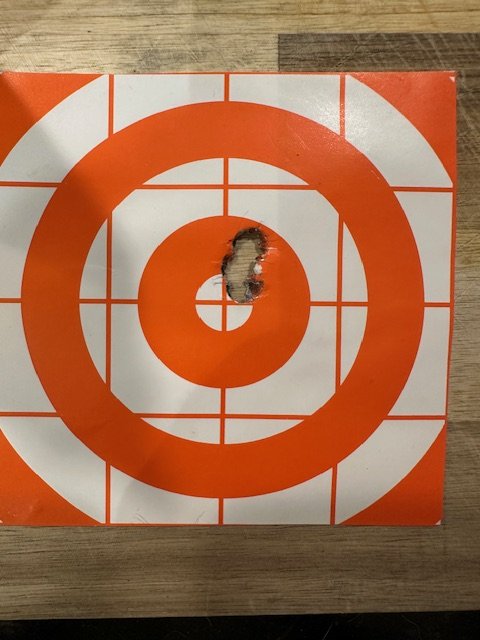

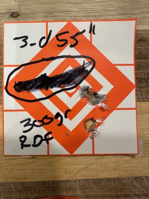

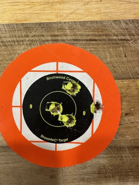

I've never tested the RDF before this past weekend. The first time I shot the RDF was at a match. Where again, I impacted at 2,800 yds. I had no previous experience with the RDF, I just kept everything the same. Same powder charge, same seating depth. Showed up, zeroed, and shot the match. Not saying I can't do it with a berger either. After I clean my rifle, I'm going to go shoot groups again on Friday with the RDF.
These were my initial groups with bergers
100 yd group

Best group I shot with the RDF:
edit: also I just remembered in the last match I shot, I also impacted on my first cold bore shot at 1,000 yds too. (take that texas plinking) - so I'm not convinced the RDF is a trash bullet.
100 yd group

I think i'm around 900 on it. I bought the weapon used from someone who never shot it. I had Mile High borescope it upon purchase and they thought that max there was 500 rds on it. But, my first 200 rds of bergers I was using N570.
Regarding cleaning, well, I never really clean. I bought in to the principle that you don't need to clean your rifles until about 300 rounds through it. So it would just sit in the safe after a match or weekend shoot. This past weekend was the first time I cleaned the thing in months. I followed your method on your website and just ran wet patch after wet patch through (using hoppes 9). It got better after about 20 different wet patches, but now even as I push a dry patch through, there's still some carbon on the patch. Not as much as when I started, but it's not coming out "clean" per se.
Perhaps since I've neglected the barrel for quite some time, I should switch to something other than just standard hoppes?
Is it worth starting at squre one again? RDF or not, it's what I have right now, I stockpiled ~500 of them in my pantry and I'd like to see them through. Should I give a good cleaning, find another velocity node, then redo a seating depth test?
If 900 rounds on it and your using a double based powder.... your getting up there on barrel life. Double based powders are harder on barrels then single based powders. That's a known variable.
Depending on rate of fire and cleaning etc.... on a 338 Lapua.... about 1500-1700 rounds is max for barrel life and that's assuming 1moa requirement. If you want less than 1moa.... your barrel will get pulled sooner and I'll say 1000 to 1200 rounds will be about it.
300 rounds in between cleaning... the more rounds you put on the barrel life wise.... the higher the round count the more frequent your cleaning needs to be. Also once you have a fouling / build up and if it's causing accuracy issues....then when you go to clean it it's going to take you longer to clean it to get the accuracy back.
Right now I'd dry patch the bore.... get Sweet's 7.62 solvent and wet patch one after another until the patches come out clean and then dry patch the bore... then get a patch soaked with 40x cleaner or JB bore compound and stroke the barrel 10x with that one patch and short stroke the throat area say another 5 to 10 more times. Dry patch it out and follow up with a light coat of Hoppe's. Before you take it out to shoot it... dry patch the bore and chamber. Shoot it and see what happens.
Reactions: kthomas
Biggest reason for accuracy degradation that I see still is the substitution of bullets without a new load development.
I've worked little with the RDF, but from what I've seen they are much more seating depth sensitive than others.
To me, your barrel still looks fine. Plenty of life left in it. I've got barrels that look much worse and still shoot great. If you changed bullets and your groups opened up, then I'd be looking at your load again, not your barrel.
That said, if you just want a new barrel, then by all means swap it out.

@CEO10KaDAY - wow, you sure seem to have some strong opinions, and made some strong statements, for a self-proclaimed novice. And, tbh, that status is sort of...kind of...apparent from some of what you posted. And I say this as I'm absolutely NOT one of the very expert and very experienced people on this forum.
There have been replies to you in this thread from such people... @spife7980 , @Ledzep , and of course @Frank Green are all people I absolutely listen to.
But, perhaps I may have some thoughts to offer.
1. I am NOT one of the many on this board who will say, in a knee jerk fashion, to throw it away at the first mention of a bore scope. To me, borescopes are GREAT diagnostic tools with which to evaluate your cleaning r lack thereof. Also, its just sort of nice to peak at the throat to on a new, unfired barrel just to see how OCD your gunsmith is. I like OCD gunsmiths (haha like to like, eh?) but looking at the throat is no guarantee that it will shoot well or badly unless, perhaps, its really fucked up. I have NOT personally found any way to predict a barrel's performance from just looking in the bore...again, absent any really gross defects. Others may be able to, but I just haven't found any information to support a reliable correlation of one to the other (and many will offer a Savage barrel as a prime example why you cannot really make such a correlation).
2. As far as I can tell you pics are just downstream of the throat. If so, that fire cracking doesn't look like doodly-squat to me.
3. I could tell you were shooting a large magnum by the bullet weights you mentioned. I was going to ask what caliber it is exactly but I see Mr. Green mentioned .338 Lapua so either I missed it or he recognizes the caliber from the bullet info shared. But, you said you think your rifle AND you should be shooting hole in hole at 100 yards. Have you ever shot hole in hole with any magnum rifle....or even any centerfire rifle? I'm serious...cause that seems to be your criteria for happiness with this rifle and I'd say that's a damn high bar.
4. Berger bullet consistency - ok, you say you find Bergers to be very inconsistent. What are you measuring? Bullet base to ogive (the first part of the bearing surface to reach the lands) or bullet base to meplat (yeah, that's the pointy end of the bullet). If looking for consistency of a manf's bullet, you should be looking at base to ogive. An open tip match, copper jacked, bullet will always have a bit of variation in the meplat that's formed when they pull the copper cup up over the lead core. And, if you really want to jump down the rabbit hole you can join the F-class and BR guys and get into bullet tipping but I rather like Keith Glasscock's understanding that there are very important limitations in how much of that you can/should do before you start negatively impacting performance rather than enhancing it. With those guys, that rabbit hole is often part of a family of rabbit holes including neck turning and sorting cases by volume (like with water, right), sorting primers by weight, and I'm sure there are many others.
5. Extreme Spread - I'm pretty sure you understand what ES is...the difference between the largest and smallest data point in a set...but I'm also pretty sure the entire shooting community doesn't care if you think its "stupid". Really?
6. Why work up a load if you are having good ES and SDs? Well, because those are measures of consistentcy in your reloading process and have shit all to do with whether your rifle likes that load or not. Many will advocate doing a charge ladder and look for some speed that your rifle (really the barrel, I think) likes. Some will say just pick a speed (our own Frank Galli has said many times that right around 2,850 is a sweet spot for most 6.5 CM rifles) and then vary seating depth to fine tune it in. Some say do charge testing, find a charge that your rifle likes, then vary seating depth to see if you can tighten it up even more.
If I seem to have just a wee bit of attitude then I apologize (well, not really but...to be polite, yeah?) but your forum handle...CEO10kaDay? Wow. Look, you may be a CEO and make $3.5M/year...or, you could be a custodial worker in a penitentiary. Who knows. But nobody here is going to be impressed with one or look down on you for the other. See what I'm saying. I guess it just got under my skin a bit....and I don't expect you to give a flying fig about that...even I don't think what annoys me should be important to anybody. lol
Best of luck. Hopefully some of what I wrote is actually accurate and something you will find useful. If not, just ignore it. I'm nobody...just another swinging dick on an anonymous shooting forum.
Cheers

Alright y'all, riddle me this..
I just did some powder testing last night - it was about 92f out when I did this, and I warmed the barrel up with about 9 shots before hand, then let it rest for 10 minutes, and then began, but, how does one choose a node on this graph, if no node exists?
the 91 gr charge had an ES of 5.3 and SD of 2.2 --> which is why I think I chose that weight before.
I'm stumped.
The increase in velocity changes the slowest from 90 to 91, but it doesn't seem significant.
Which load grouped the best? In the end Nodes are just a data point. The thing is to find a load that groups.
The way I understood it was that if you have wide ES you should adjust your powder charge, and if you have sub optimal groups, adjust your seating depth. What I was hoping to find yesterday was a powder charge that had the lowest marginal increase in velocity, however, that graph basically depicts a near perfect correlation from powder charge and velocity.
Four out of six groups had bug eye groups plus the damn random flyer. Should I do my seating depth testing based on truly the smallest group?
The best group I shot with the Bergers was 0.85 inches and the best group with the RDF was 0.61 inches at 89 grains.
so....?
With such a large caliber and amount of grains I am surprised there is not a flatter curve on that graph.
I would have thought charge weights wouldn’t make that much difference with 1 grain.
You are also only doing 20 fps spreads id change it to 50 or something higher to actually see a flat spot.
Find what shoots the best first, but you've been told by many already that the RDF does not shoot consistently in many many rifles. So you may get a good SD/ES but if it won't group 5 shots over and over with a decent group size then what good is it? Your barrel doesn't look that worn to me because the firecracking is just not much. Your bullet sucks, so until you shoot a different one, you won't get consistent groups, which matters A LOT more than 2 or 3 ES.
Reactions: kentuckyMarksman
Yes, pick the smallest group in the velocity point you want and start playing with your seating. I am sure someone smarter will disagree but that is my recommendation.
The control group (Berger) isn’t beating the RDF grouping. If I can get these RDF’s to group well, jokes on you.
Yup, jokes on me.....
Go ahead and put 3 groups of 5 shots up here and show me how the joke is on me.... look, I have nothing against nosler, some of thier other bullets are great, but I know from testing that bullet is not consistent. It may group well for 3 shots, then it will have a "flyer" (which is not really a flyer, it's a part of the group) . This will continue again and again.... I'm just trying to save you from wasting a bunch of components and time man, and it's not like it's just me, several others have told you this as well, but you go ahead and post those 3 groups of 5 shots with that RDF bullet and tag me when you do.
Reactions: kthomas
