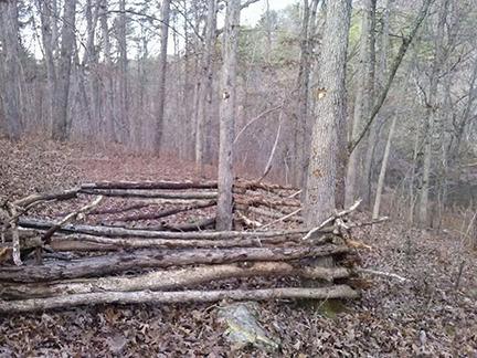

The Hide:
This stage spoiler is a hair out of sequence; I should have posted the "reticle ranging pitfalls" tips segment first as they both use the same base math. This stage also relies on some of the skill sets discussed in "Dave's devious dope stage," If you haven't seen that post, I recommend you go back and review it quickly.
This stage simulates setting up deep inside of a homemade hunting blind or other hides where the shooter is set back from a small opening in foliage or other obstructions. The stage will have a boundary area between point-blank and 5 or 6 yards (see the orange flag tape), with a makeshift wall with two small ports that the shooters must shoot through to hit targets between 900yards and 700yards. This is a true team stage, if the shooters operate independently, they'll probably time out.

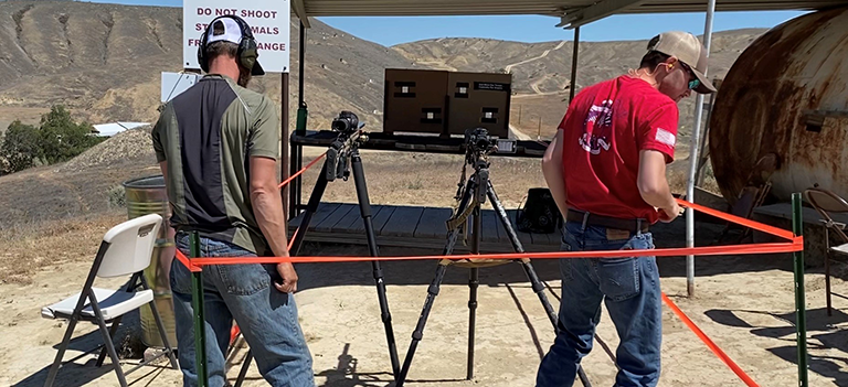

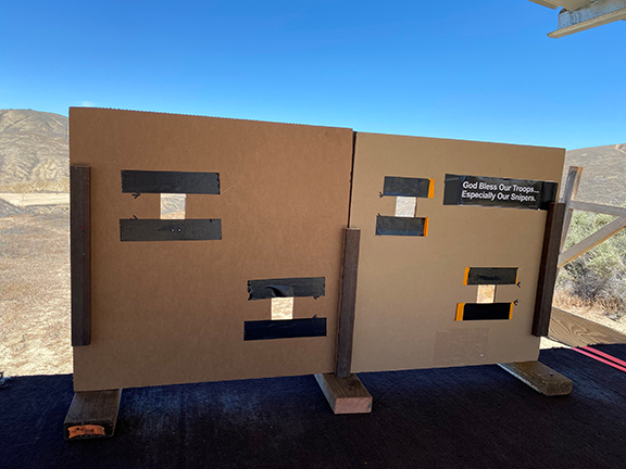

The stage setup and scoring:
The guns may be staged with the mag out and bolt back inside the makeshift room marked by the boundaries of the flag tape. Tripods and mags in hand, time starts. One shooter will shoot out of the upper loop, and the other shooter will choose the lower loop, shooters will engage two targets each at one of two specified distances and communicate to the RO their loop and target choice. The shooters may NOT use the same loop height as their teammate, and each shooter must shoot a different distance. There will be a small and large target at each of the two ranges.​
Shooter one will let the RO know what loop and target distance they choose, then engaged the small target first, worth 4pts for a first-round hit, 3pts for a second and third-round impact. Then the large target with the points value being 3pts for a first-round hit, 2pts for a second and 1pt for a third-round impact. Shooter two will follow confirming they are shooting out of the alternate loop and alternate distance using the same points schedule. This is a high-value stage, so that time management will play a key role. We will have a tape measure on site.​
What's the catch? Well, if there is any contact with the loop board or the tape surrounding the loophole that shooter will score a 0 for their stage, the other teammate's score will count as long as they shot cleanly without damaging a tape or loop board. The RO will inspect the tape and board once the team finishes their time. New tape will be installed after the teams examine and score their stage.​

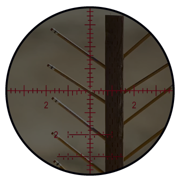

Above is what it looks like when you miss the loop window. If you look closely at the upper loop on the left side, you can see three bullets that clipped the loophole. The target might still have an impact, but this shooter zeroed his attempts.​

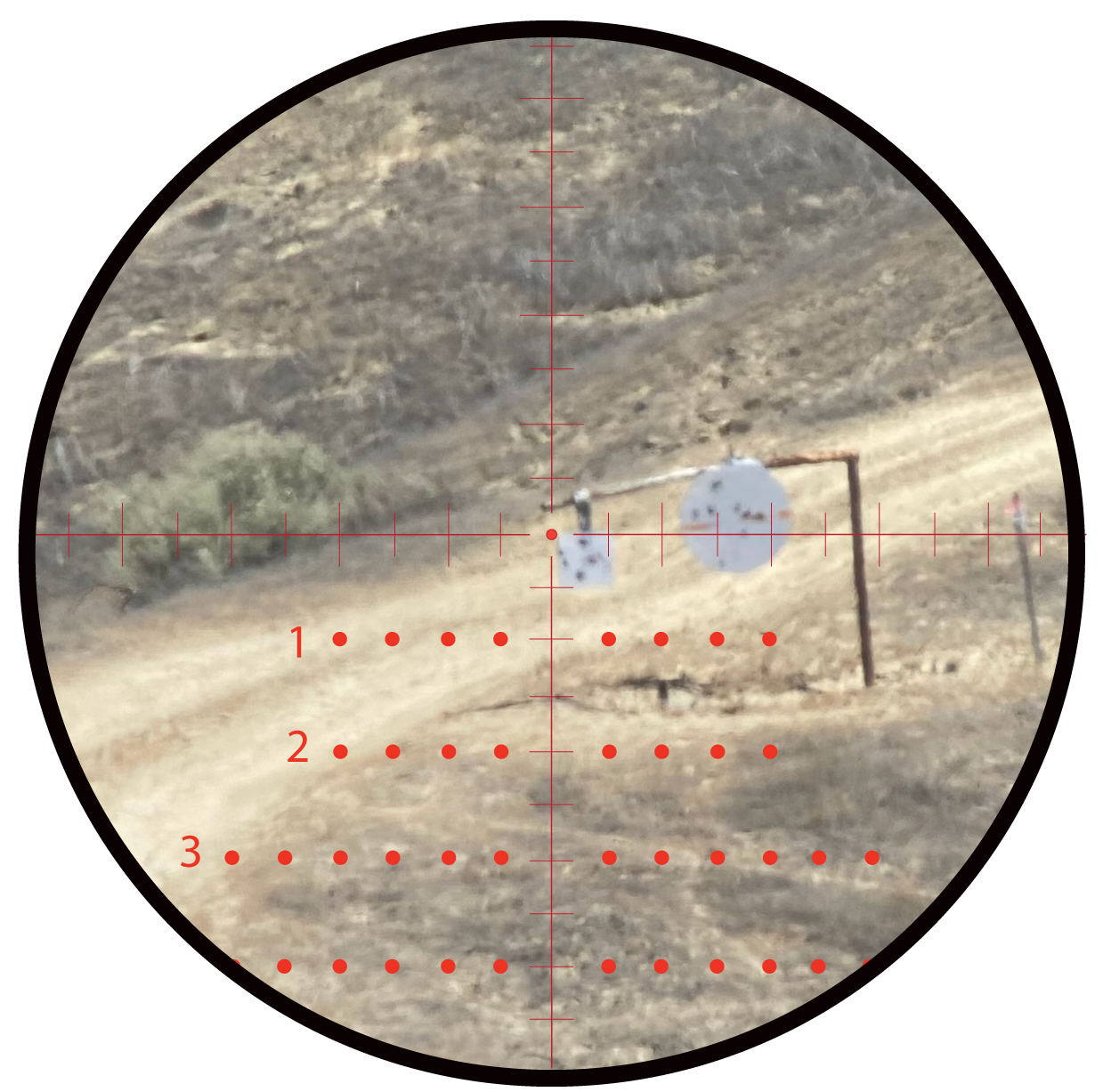

How does a loop Look through my scope? Below is a bit of over dramatic representation, but I think it helps illustrate a major issue.​

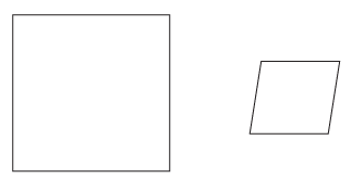

Parallax can be a huge issue and does not allow the shooter to see the boundaries of the loophole's actual location when you're not centered in the scope. An old school trick used to ensure your scope is parallax free is scope shadowing. It is super fast and simple, move your head back slightly until you see even shadowing all around the ocular. It can be useful in several real word situations even today. Be it a stage with poor body position containing both near and far targets without the time to adjust it to a long-range target where mirage makes it very difficult to ensure the parallax is correct. What's happening is the even shadow around the ocular is indicating that your optical path through the scope is lined up and centered, or make a pinhole in your cap. See more here: https://www.snipershide.com/shootin...allenge-match-11-22-2020.6980614/post-8556127
It would be best if you lined up correctly, and that parallax doesn't make you think the loop window is clear. The other issue you'll encounter is that you can not accurately scale the opening. In this case, We'll give you the opening size so you'll be able to work out the math if you want to understand what's happening.​
First, think of the loophole as a near range target with a secondary target at the end. So, let's use the very same base number for reticle ranging. 27.78 is the number used to mil range targets in the distance using inches of target height - (Target size in inches x 27.78) / Mils = yardage
1. Let's rearrange that formula slightly to get the mil size of a target. In this case, we'll use a 2" target (or opening) and known yardage.​
1mil = 3.6” @ 100y​
100mil = 3.6” @ 1y or 3’​
3.6” is 0.2778 of 1”​
100mil x 0.2778 = 27.78​
27.78 mil per 1” opening @ 3’​
At 12’ (3’x4) it is : 27.78 / 4 = 6.945mil per “ of opening​
2” opening at 12’ measures 13.89mils​
The formula shows us our operational window, even if it is too close to the reticle measure clearly via our scopes.​

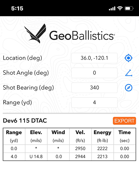

2. Using your solver, set the target distance to the distance of the obstruction. We need to find out what problems the distance creates for or SOB and the bullet arc at the distance to the loop wall. This will show you just how low the center of your projectile will be below your POA.​
Here I set my target distance to 12' or 4 yards so that I can see how many mils below my crosshairs the center of the bullet is.​
So I have 15mils let say 17mils for safety under my unaltered crosshairs to clear the lower part of the loop.​

Target @ 900Y = U6mils​
17-6mils = 11mils​
As long as I can see 11 mills under my targe I should be GTG - (remember the loop is 13.9 mils from that distance)​
But wait, some cases are not that simple, if the distance creates come-up that is larger than the bullet path is creating then you have to also be concerned about the top of the loop. Let's say I am back further and the target is further. Let’s use 10y; at 10y, I only need U5.2, let's say U7 for safety. With a target at 1400 yards, I’d need U13. Now your safety is also above the crosshairs with maybe 10mils (8mils + 2mils for safety), as well as below.​
4. Or you can use a program like FFS and all the math is done for you. But really the thread is about understanding a bit more and if nothing else, just to get you to think how all these parts work together.​
5. The entire key is in the tripod height setup.
If you set the target up like most people would, your sure to impact the loop's boundary.​
If we remember from the above sample we needed about 11mils of clearance below our POA in order not to clip the bottom of the loophole. The way to accomplish this is to set your tripod height high enough so the target is very close to the top of the loophole, not centered.​
Depending on distance to the loop and target distance, the image below is how the sight picture might look.​
The truth be told, for the set up we're presenting, if you do this and set up towards the rear of the hide, you'll do just fine without any math— just don't tell anyone you know the code.​
6. The Key is teamwork
The Key to this stage is how your team helps each other fine-tune their tripod heights to set up the sight picture like above and to fight the clock. When we used adjustable center columns, this was much easier to do by yourself. But they tripods were so wobbly the target needed to be substantial. It might be a good idea to go back to the tripod tips segment and see why I suggested always error on setting up too high. It is just way easier and faster to micro-adjust your height using gravity, don't try to fight it. Consent communication is going to play a role in your team's organization on every stage, but this one will take more than most. If you are moving the rifle in this stage OR making a tripod adjustment, the gun must be safe, unloaded, bolt back, and mag removed.
My approach would be (not the only way):​
1. Both teammates use their binos and line up their loop with their selected target choice. Ensure that the target appears near the top of the loop but in the center of the Binos. Each shooter should make a mental note of exactly how heigh their Binos need to be to look at the target correctly.​
2. Each teammate should reference the bino height of the other as well, so that when tripods are set you’ll have a second set of memories and communicate if you see your partner is setting up at the wrong height. These levels will be just about the same for your scopes. Again, if you are going to error, and you will, error on the slightly higher side.​
3. Both shooters start setting up their tripods at the rough height with the rifles still staged on the dirt, bolts back mags out.​
4. The shooter in the higher loop would get the most attention first; as soon as he thinks he's close to having the height, he should mount his rifle, noting the above safety rule (his teammate can help). On glass, the shooter, should be communicating to his teammate if he needs the tripod to go up or down. I would have my teammate helping make these adjustments. Once shooter one is ready, he should confirm with the RO he is making ready, firing through the appropriate loop and confirm the target.​
5. Shooter two should be on his tripod with his gun mounted (bolts back mags out) and adjusting solo while shooter one is shooting. When ready, he can tell the RO he is making ready. Shooter two should be on his target and ready, if not, shooter one will need to finish his COF and make safe before they can help shooter two.​
As I said, you should always be talking, shooter one should be giving wind to shooter two because shooter two can not see shooter one’s targets through their loop and probably will be setting up.​
The shooting will be relatively easy, the time management difficult. This is something as a team you can practice; you do not even need to fire a shot, so practicing at home is valuable. Time can slip away, again as a team; you should be watching your timer or watch. Remember, the smaller targets three impacts are worth a high point value; if the first shooter runs over their time, it might make sense to skip the bigger target and let shooter two bank points. That said, if you practice, you will have time.​
How does this apply in the wild?
Of course, if you make a makeshift Hide like above it is easy to see the application. Knowing your limitations and windows will allow you to make a more stealthy natural hide/blind.​
Shooting over walls, stumps, rocks, etc. that are between you and the animal is a good example of where you need to think about this very process. Hopefully, if nothing else this provides a bit of entertainment or maybe even inspiration to make a natural hide/blind next season.​
Back to the index of Tips and tricks:​
Ok - tested this out today at the range. Entertaining to say the least. Did not have a partner today (he is shooting a match of course) but figured out a very quick way to adjust tripod elevation alone safely. Question - Will we have to range through the loop hole as well?
Thanks
"This is not the real stage: We videoed this to help illustrate the need for close-range targets or obstacles (hint for another stage), be as accurate as possible from the muzzle to the target. Most people range a target where they stand then shoot from that spot; it's often more than a 1 to 1-1/2 yards from the muzzle. That said, I am the first one to say that under normal circumstances, who would care. But remember, we are using these examples/discussion points in the hopes of building up to another skill test or stage. With that in mind, if we set target 1 at 12 yards, on my rifle with an SOB of 2.3"; a 1-1/2 yard ranging error is .6mils. It sounds worse than it is because we are mainly thinking of longer distance angular results. But it would be about the width of the pencil at 12 yards."
Diver - this is an inane question about your ranging point above. But in some of my education on doing a tall target test there was emphasis on measuring the 100 yards to target at the turret of the scope as this is the actual point of angle creation when you dial turrets and angle the muzzle up for trajectory. Although I do agree that the barrel is going to be assumed to be perfectly straight, so the point of departure where drop starts occurring is at the muzzle.
Given that scope center to muzzle is about 26" (2/3 of a yard), and your point above is at short distance these small increments might matter, do you recommend ranging from the muzzle or scope center?? Just a curious thought.
last match for a few stages i dabbled in making range cards even tho not needed, just to get some practice, i did not do it on the clock i still felt some pressure to get em done, it gave me some insight.
Reactions: Diver160651
I end up ranging near the end of the scope not really the turret nor the muzzle. My point was, exaggerated a bit because most people will range standing well behind the butt of the rifle were they might stand before they lay down.
The gravity drops are from the muzzle, but the calibration is from the turrets. As long as your in the ballpark, you’ll be fine. it is actually an easy target if you don’t let the pencil get in your head
got it - thanks

3. I tried the small hole in my lens cap to see if the loop hole edges would be clearer. I put the loop hole at 8 ft (2.6 yds) and there was only very minor improvement - nothing like the clarity of the pencils in the picture. I assume there are limitations - like the object has to be 5+ yds or more or something?
This is fun stuff - a couple of questions......
1. You note that it doesn't matter which team member hits a target as long as the targets are hit to advance - but you also note that "if you hit a target other than yours, or too many targets" ?? Just clarifying - there will be other targets that the team could mistakenly hit if they aren't careful to be on the right target - correct?
2. Target 3 - the group on the Ace of Spades - does each team member take 1 shot - or can 1 team member take both shots? I would think 1 shooter has a better chance of placing both shots close from the same rifle/position.
#3 the pencils might be more like 25-30 yards and your trying to get parallax free with a scope that doesn’t adjust that low. Note that for the loop, your just trying to clean up the edges. If the hole is to large you’ll see little improvement, unfortunately for the smallest holes the scope will become very dark.

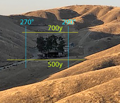

A: Mentally grid the lateral limits, start your terrain map even if just how your writing down the drop. I use 2" easy-peel masking tape with the ends folded to create easy to grab handles like tear-offs in MX racing.​
If this doesn't make 100% sense, lease go back and read Stage Debriefing Post #35 https://www.snipershide.com/shootin...allenge-match-11-22-2020.6980614/post-8485325
B: WORK THE FOV inside your grid AS A TEAM. In many cases, it is almost always better if teams split the ranging duties working simultaneously, with one member working the right lateral limit finding and ranging R-L. The other is working the Left lateral limits working L-R, meeting somewhere near the middle. Before you begin to set your gear, analyze the lateral limits decide on a glassing height based on the possibility of rolling terrain or other obstacles creating dead space that might interfere with you seeing and shooting the targets. Review Tip #10 Post #55 Under Tripod tips https://www.snipershide.com/shootin...allenge-match-11-22-2020.6980614/post-8495271

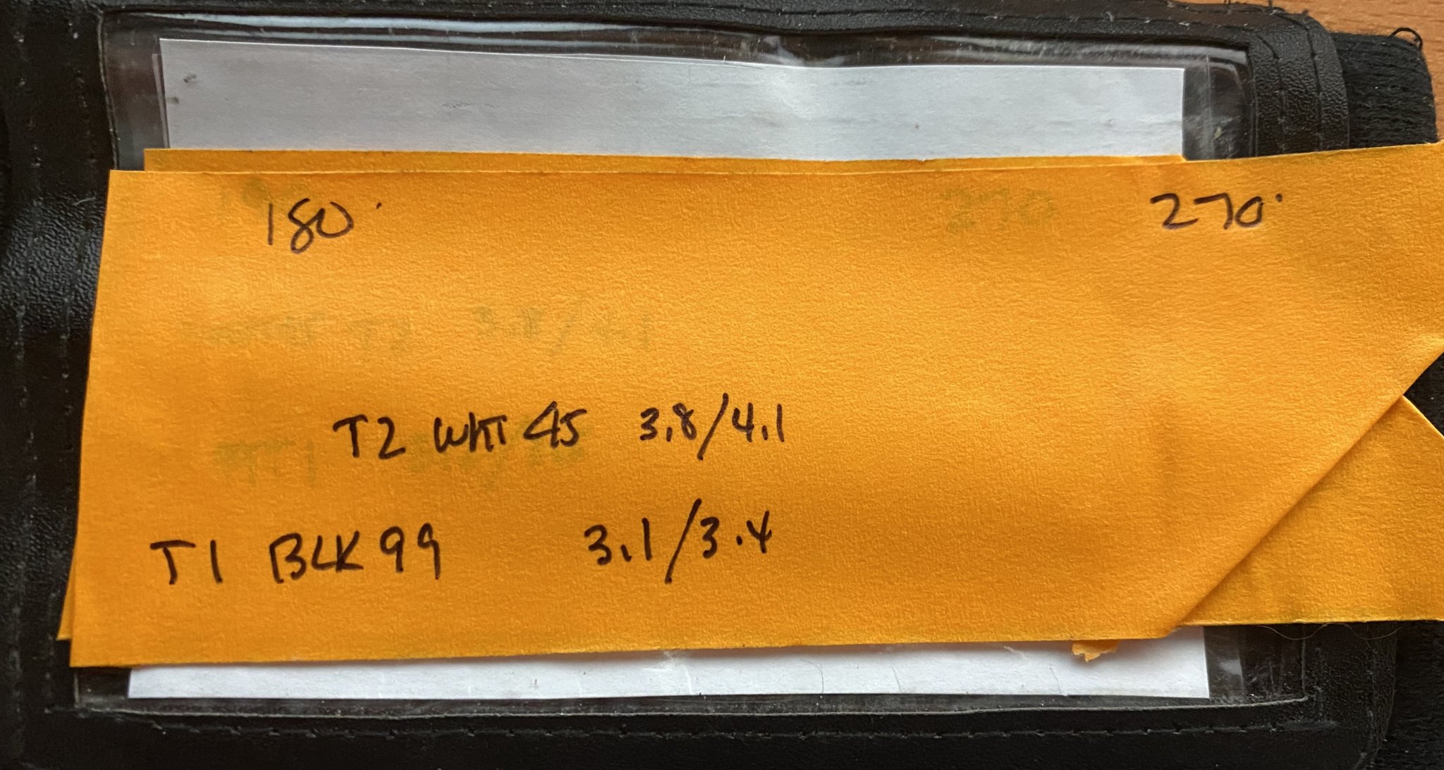

Partner one is ranging T1 and T2 ideally and the other T4 and T3. Let's assume their ranging device gives range only and will talk a bit more on how to deal with dissimilar dope further down. As partner one ranges T1, he writes down his dope and partners dope, then does the same for T2 and maybe T3 if partner two is not yet there. Partner two is doing the same. You might want to set up your lateral limits and targets on your armboard or whatever you use as the RO gives you the short brief. The steps might look something like range T1 is 630y I flip to my dope sheet and write down the drop of 3.2 for me and 3.5 for my partner, then I look for T2 and do the same, writing down 3.8 and 4.1. As I write down our dope, I do so in an ultra rough graphical format. I do this, so I don't lose track as we communicate.​
Assuming my partner found the other targets, his armbord would complement yours. When you and our partner share target locations and share your data, it is faster and less confusing only to discuss the target come-ups and not the yardage (it also keeps big ears at bay. When the team ranging is down, it would sound something like:​
Shooter one T1 3.4​
Shooter two repeats T1 3.4​
Shooter one T2 4.1​
Shooter two repeats T2 4.1​
Then shooter two would do much the same, finishing off shooter ones armboard.​

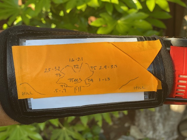

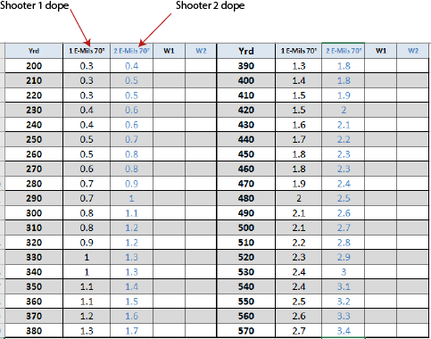

BUILDING A TEAM DOPE CARD

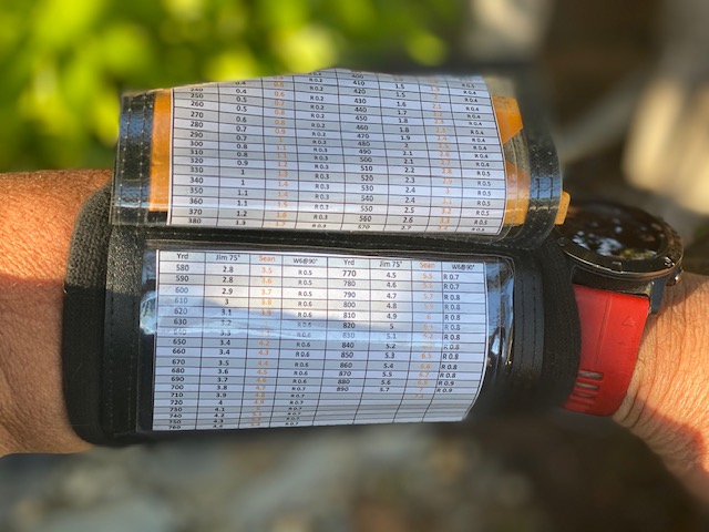

I've tried a bunch of different armboards over the years. I do believe that armboards or a whiteboard/clipboard attached to your tripod are great ways to go.
ARMBOARD:
INKJET PAPER:
I also recommend Teslin synthetic Inkjet paper. It is waterproof once the ink is dry. Right in the Rain, has not played well with my inkjet. For the Teslin you can get it also via Amazon. https://www.amazon.com/gp/product/B00449PRJ2/ref=ppx_yo_dt_b_asin_title_o01_s00?ie=UTF8&psc=1
DOPE PAGES:
Here is an example with teammates with vasty dissimilar dope.​
What you'll notice is that you can actually just reference either dope and get the dope for the other.​
This allows a Shooter one to range using the drop in an integrated bino and see 1.9 in their display, then immediately know their partner is 2.4; or even the other way with a comment from Shooter one like "I needed 1.3," Shooter two can easily see they'll need 1.7. This makes having to go to yardage over and over again a thing of the past and keeps your competitors in the dark. I don't usually add wind but can if the mph values are drastically different. I hope it is clear if your team has the same dope then your GTG and do not need to worry about this step.​
DOWNLOAD AN EXCEL Template: (Note that you can use 28.9inHg year-round and not see an impact issue.) You do NOT need to get lost in your kestrel to have a click accurate drop.​
print at 60% to match the wrist coach.​
PS: Expect all possible combinations of shooting sequences required by the shooters.

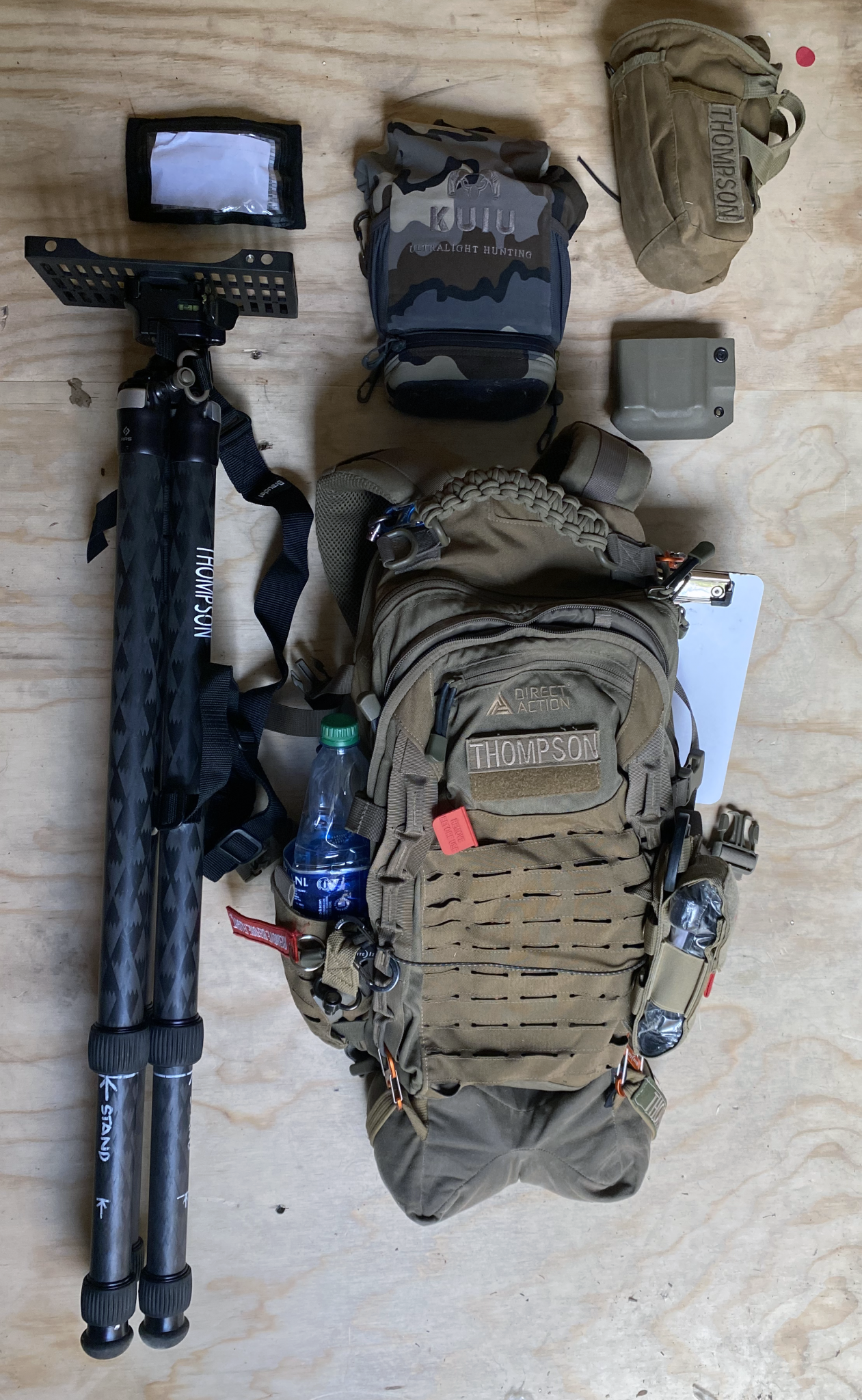

TIP: What to carry.
Well, the options certainly vary, and much will be a personal choice or basis, depending on the team. One thing is certain, anticipate that both shooters should have the ability to do all tasks simultaneously. While there will not be restrictions on sharing gear, other than repair tools and spare mags, except in some particular and limited cases, sharing gear will come with a huge time penalty. Each should have their rifle support tools, PLRFs, timmers, and arm boards or place to write dope and notes. Most of this part has been covered in previous tips and tricks. If you haven't viewed them, I'd suggest you go back to the main index and read through them if you have questions on these items. Here
Range finding, Target ID, and spotting: 1 each
Before we start, I wanna make sure that I get all of my biases and preferences laid out on the table. I believe that it's essential to be transparent in what works for me and why I do what I do versus what will work best for you.​
I have dedicated optics for bow hunting, long-range hunting, spotting, and match shooting, and I have not found one optic that does everything entirely well. I've also found that most optics with integrated rangefinding tend to be of lesser optical quality than high-end alpha glass. There are very few optics with stellar glass and integrated range finders; those that are optical equals tend to have ranging capabilities that are lower than available in dedicated PLRFs. Because for every continuous minute, I use a rangefinder, I spend many hours looking through the optic; I'm just not willing to give up comfort or optical quality for integration.​
The best option might be your integrated Binos, especially those that spitting out our dope. That said, something like the 7x Liecia PLRF has an apparent FOV of 6.6°, so other than magnification and optical quality, you're going to do just fine if that is all you have. As an example, I think @hic28 has won a UKD match recently doing primarily just that.​
Ideally, though, I use a chest rig by KUIU, with the binos and PLRF tethered, so I can drop and go if need be. It provides fast access, and I would say that while I have binos in the pack, 90-95% of the time, all I am pulling out is my PLRF. I generally eyeball the area during the brief, walk up to the FFP, still eyeballing targets, and it is always enough to know if standing is the only option; If I get really stuck, I'll pull out the binos. I set up the tripod and generally defaulting to the highest position, often just attaching the rifle and use the top of my scope as a support base for my PLRF.​
Here are my recommendations for ranging:
  1. Make sure both partners have a good range finder.
  2. If you don't have great binos or a PLRF. by all means, consider an integrated set of Binos
  3. If you use binos bring a chest rig
  4. Don't go out and replace our PLRF with range-finding binos if you have an excellent PLRF already- unless you're made of $$.
  5. Do NOT bring a dedicated spotter. In most cases, if there is an opportunity to spot, you'll be using your rifle scope.
  6. Review "Knowing your PLRF thread. Tips: PLRF beam verification techniques post #123
Images of chest rig - coming soon​

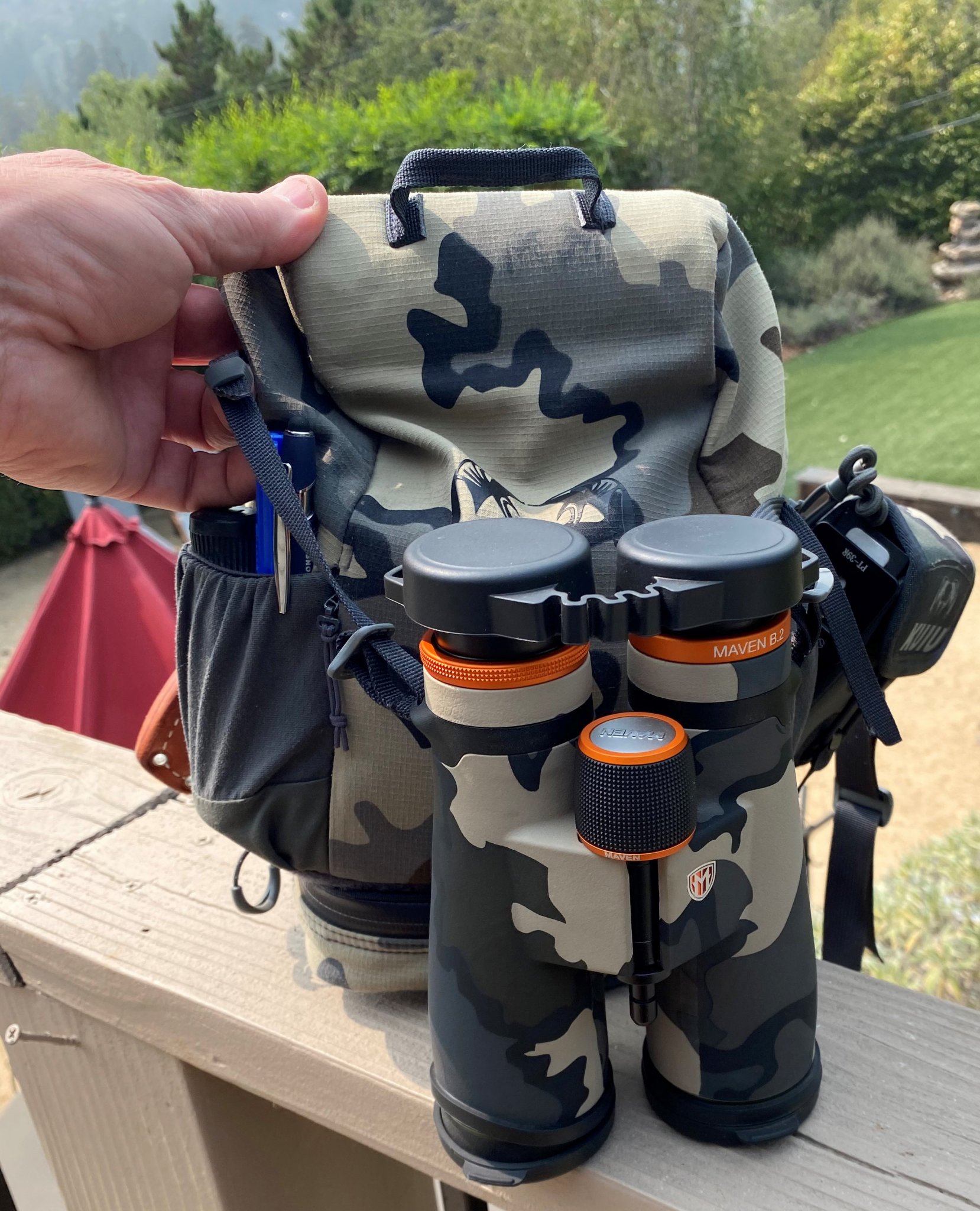

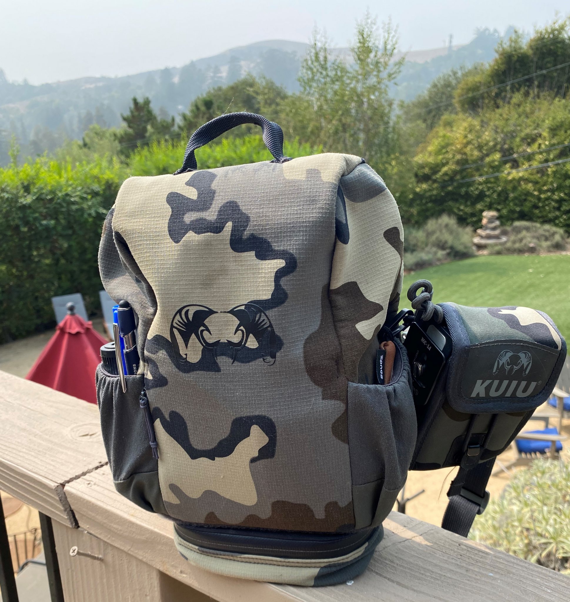

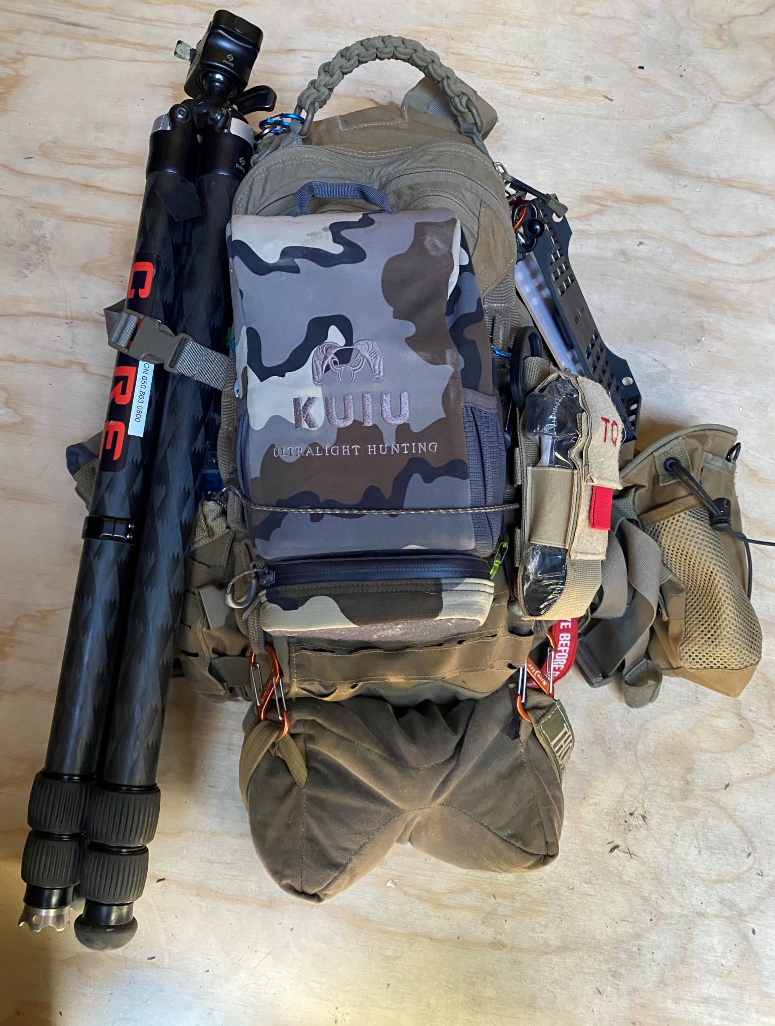

Here is a link to the KUIU Bino chest rig. It Flips open and ends up leaving a big bucket for fast access. There are many other brands like the Alaskan and Vortex, Sitka uses a slower zipper and I think needs a redesign.​
Below is one of my actual Bino harness populated with my favorite Binos for this type of stuff, Maven 11x45s. The eye box is impressive, and it feels more like looking at a widescreen TV than many other binos (similar to the ZCO image); these have replaced my older Swaro 10x-42s. I am not saying the glass is better, just that the image is more comfortable and natural to me. Not bad for about a third less $$. My PLRF is on the left side (right side of the image).​

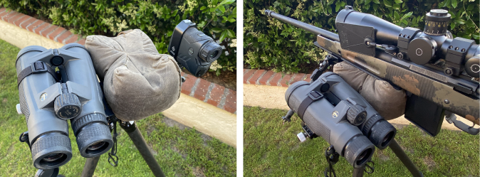

Rifle support
Of course, you are welcome to use any shooting support you use in the field, just as you might during a walk-in hunt where you expect long-range ethic kills. If shooting sticks are your thing and you are amazingly proficient, go for it. I am not an excellent long-range offhand shooter, for me, a tripod has become essential field gear for my rifle hunts. Hell, I need something for spotting anyway. If I take off my bipod, an RRS shooting tripod's net weight can be less in total carry weight, increasing my ethical range many times over for every position but prone. To that end, this match will simulate long-range conditions you might find as your hiking the central coast on a hunt.​
Whatever your choice, you'll need to manage all your gear, and you'll be shooting 8 or 10 stages, dropping gear, picking it up, and repeating that a couple of times per stage. A bipod is essential, unlike hunting, just to keep your gun clean and stored safely in a match setting, along with a sling for carrying it.​
You can use a tripod on 100% of the stages as primary rifle support if your tripod can stabilize your rifle from near prone to standing. You also want to make sure you are not lugging around all your gear plus a 6-9lbs tripod unless you're an animal; you will be hiking a bit. Most of your actual spotting is from your gun while on the tripod; the tripod will be an essential piece of your kit. Of course, you are welcome to use any shooting support you use in the field, stuff you might in walk-in hunting where you expect long-range kills.​
Decide on whether or not you'll be using the faster Able Table and heavy bags like a heavy Pint GC or Schedium; or you're going to lock into a head like the Anvil 30. If you're practiced, shooting a low recoiling round, it is super hard to beat the Able Table and heavy bag concept for pure speed. But, for me, it is less practical in an actual walk-in hunt as you're adding about 7-8lbs to your kit, over and above your tripod, and it does not suck up the recoil of light-weight hunting magnums like a directly attracted tripod. But then again, this isn't really hunting.​

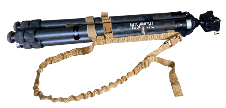

Above is @hic28 setup; if I use my Able Table, I usually use the binos and PLRF, left tethered to my chest rig. If you are going to use the table or hard attached optics, I suggest that you set them up on our tripod once at your first staging area and carry the tripod setup slung under your arm to and from the FFP. The last thing you want to do is time out setting up your tripod or have the RO brush you off because you're slowing trying to unpack and repack. I'd recommend carrying your tripod slung like in the image below regardless of what is or isn't attached, once you've made your first staging area.​
RRS makes super slick sling attachments as used in the above image, But there are other ways to add a sling. See the Armageddon Gear Sling below:​

I put a couple of quick links regarding tripods options.​
Recommended support gear:
  1. Rifle Sling - for transport (1 each)
  2. Tripod Sling - for transport (1-each)
  3. Bipod - for staging safety (1 each)
  4. Shooting Tripod: (1 each)

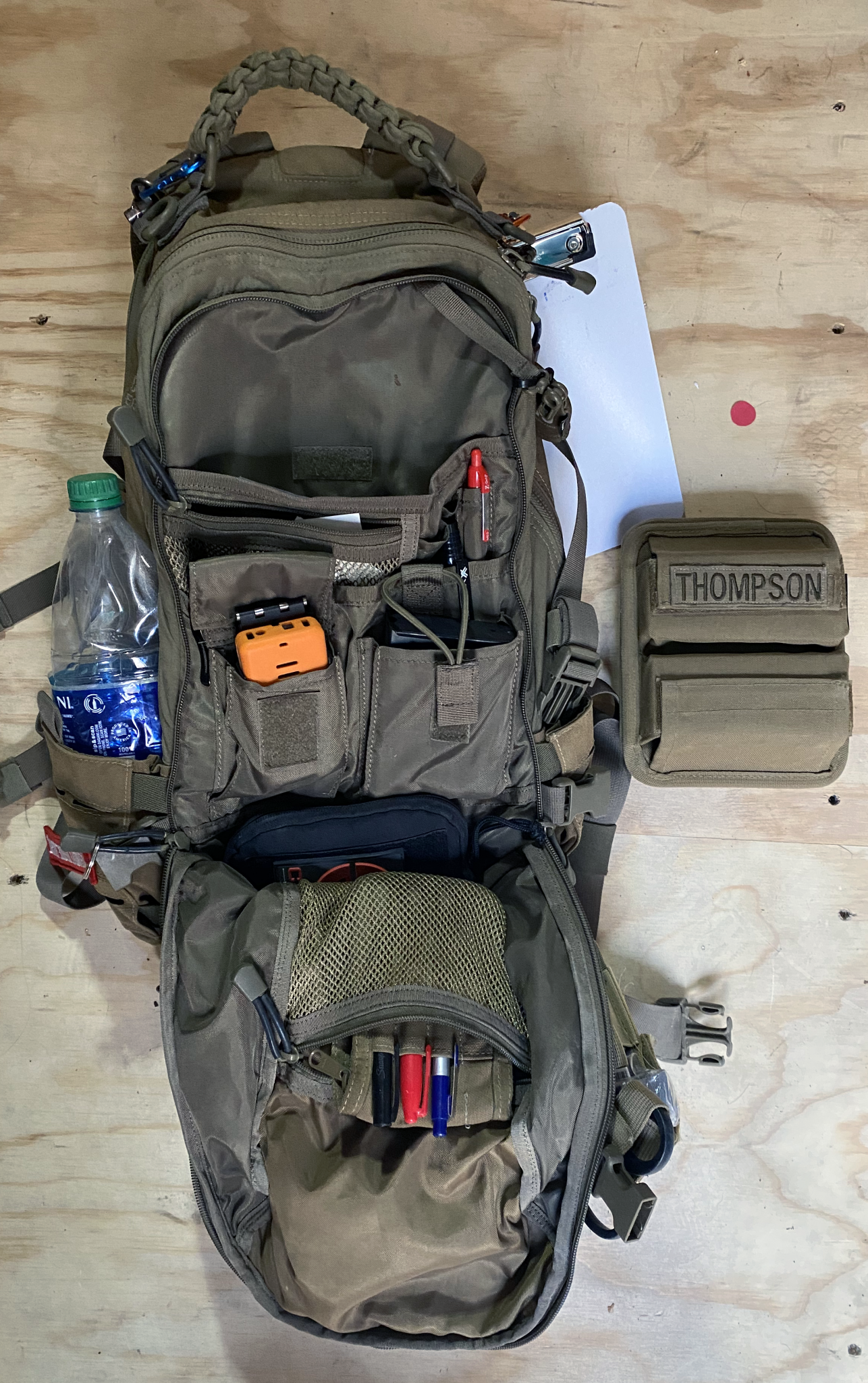

For the long hike to the opening stage or end of the day, I show everything with the most used items outside or on my hips and chest. Using a large bag and putting these things inside is a recipe for extra work and time. My son above is using a KUIU hunting pack, and below is my tiny PRS pack. Both packs styles will work well if you think through your kit.​
The image above is my match bag ready to carry to the briefing of the first stage. It is all the same as I carry for either type of match except I don't bring a rear or void fill bag (pump pillow), and for PRS type matches, I do not use the chest rig; It stays attached.​
Here the items are taken out or unattached from the bag That would get carried on my body between the FFP and Staging areas.​
  1. The tripod is set to the kneeling position, for standing all I need to do is fully extend the lower legs.
  2. I use the sling and sling it under my arm between stages.
  3. The Able table is attached
  4. Chest rig with Binos and PLRF is on my body
  5. I run a mag holder and shell cache bag, it makes the make-ready and stage clean-up way easier. My ECI goes in the shell cache during the make-ready.
  6. Dope is on my arm
I leave the pint of Schedium bag on the bottom of the pack, clipped for easy removal. Water, whiteboard, and a trauma kit with Tourniquet are attached.​

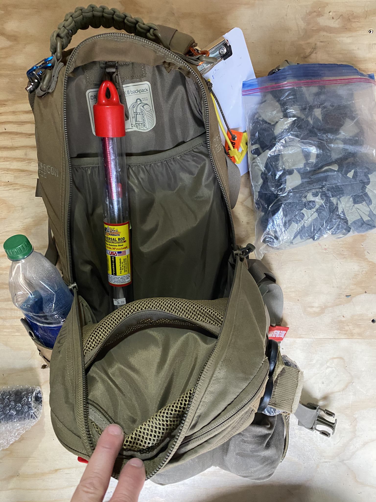

In the fast access compartment, I keep:​
  1. A note pad, pens,
  2. Arm board stage inserts
  3. Stage timmer
  4. Spare mag timer
  5. Double-sided ammo carrier. The ammo carrier on the right hold 80 rounds and with a spare mag and mag on the belt, I have over 100 rounds. If I need more I add a have section or another double in the main compartment. This is enough for this match.
  6. Full tool kit
In the main compartment, I keep, lesser-used items​
  1. Ultra-Light Packable rain gear - if it seems at all possible
  2. Full-length cleaning rod. Man, this has saved a lot of people's matches removing stuck cases to case head separations and cleaning rifles after a mud or debris has entered the brake or barrel.
  3. Lens shade
  4. Extra stuff like ammo or handgun if not on the hip can go in here.
  5. Snacks
What gear to share if space or weight is a concern.
  1. Cleaning rod
  2. Tool kit
  3. timer
  4. white-board / tablet
  5. IFK/ trauma kit
A closing note on Transporting, staging, and at the FFP
Remember origination and team communication is the most important after safety. Carry your gear so you maintain control of your muzzle's direction at all times, do not flag anyone or your going home. Get to the staging area, carefully unmount your rifle ( people get flagged during this step a lot), place it as indicated in a safe direction, unloaded, mag out, and ECI in. Set up our gear in the staging area so you ready to rock as you walk up to the FFP. You will get a short brief and the RO will start the timmer. I know this sounds dumb, but if this is your first UKD Team tripod-based match, I suggest that you practice at home with your kit moving from spot to spot, setting, and picking up your rifle tripod until you feel butter smooth.
Back to the main index>

Diver I see in the pic of your tripod it looks like you have a combination of metal feet and rubber ones. Am I seeing that correct? Can you school me on this?
It serves no functional purpose day to day, on concrete, it is a feature that takes away from the performance. But, this is for the hunts, late rifle, often with mud snow, or ice. If I am lucky enough to be able to add weight from the mountain and carry a heavy load and on steep hills without my poles, I'll extend that one leg and use it like a really stable hiking pole. It has saved my ass side-hilling and on the descent.
I usually carry a set of 10oz Carbon Z-poles, but it is often faster just to use the tripod
It serves no functional purpose day to day, on concrete, it is a feature that takes away from the performance. But, this is for one hunt a year during late rifle. If I am lucky enough to be able to add weight from the mountain and carry a heavy load and on steep hills without my poles, I'll extend that one leg and use it like a really stable hiking pole. It has saved my ass side-hilling and on the descent.
Thanks, never thought of that.
Hope to post - Reticle ranging issues, what to look out for and why it is a legacy skill for Precision rifle by the end to this week.
We will have on stage using the reticle; we will use 2-M0A* ish sized targets, and we will create scenarios that will test your awareness. All the tips and hints will be in the upcoming thread/
* Reticle randing works for mil targets because of the large size vers the distance, as an example, an IPSIC is 7.16MOA x 4.3MOA @ 400 yards. This makes reading errors less likely and certainly a much lower % of the total target size.

The problems with Reticle Ranging for Precision Rifle:
If I ask you why you use an FFP (first focal plane) scope for precision rifle shooting, what would your answer be? I'd like you to pause and answer it out loud.
If one of the top 3 reasons is reticle ranging, I hope to change your mind. If we could agree on an FFP scope's true value, I think you will appreciate why we are doing what we are on the reticle ranging stage of the UKD Team match. I also hope it will become easier to see the broader applications and real value, such as hunting at longer ranges.
Again, being honest with ourselves, unless we had a mentor, our first purchase of a modern subtensioned scope probably resulted in you trying to figure out whether a MIL-based or MOA-based scope would be best. In large part, most likely based on what you thought would be the easiest to use with a ranging formula. There is nothing increasingly wrong with that idea, just that it illustrates placing purchasing priorities in the wrong place based on poor information out of the gate.
I will come right out and say it; reticle ranging small targets at long ranges just does not work well. As we go on, I'm going to cite examples that defeat these scopes' ability to range with acceptable accuracy for our shots, especially considering the proliferation of cheap, accurate PLRFs. But first, let's take a step back and create some contextual guardrails. Without them, my examples and our tips on what to look out for on this stage and the targets we use will seem to make less sense.

Angles are a reality:
Below are representations of two targets BOTH are at the same distance and BOTH are 14" squares. Can you tell me how that is possible??​
If the plate on the left is tilted down 45 degrees, and away 45 degrees and far enough away, the plate will appear about half the size. If you do not know the angle and the angle is compound, this of course now makes a know-sized target, unknow and almost useless to reticle range.​

Thanks. The Field Tips section mentions a car tire and t-post that are on the range. Since many of us will be arriving at the range the morning of, will there be a chance to see or measure the tire or post before the start? I know there is a wide variance in tire sizes between my little sedan and 4x4 truck. :)
I gave a few items, the things you might find on a standard National 500m Silhouette Range as well as 55 gallon drums and T-posts. Long story short some are just diversions.
cough, I would absolutely take the time to either look up or measure the silhouettes. Although I am not a complete dick - smart teams will have access during the stage to measure a reference; if the recognise the value in ranging a large item vs a tiny target

Image of me looking thru Adam's rifle as we proof the final loophole stage. The hills of Avenal is a great venue for Feild style shooting!
