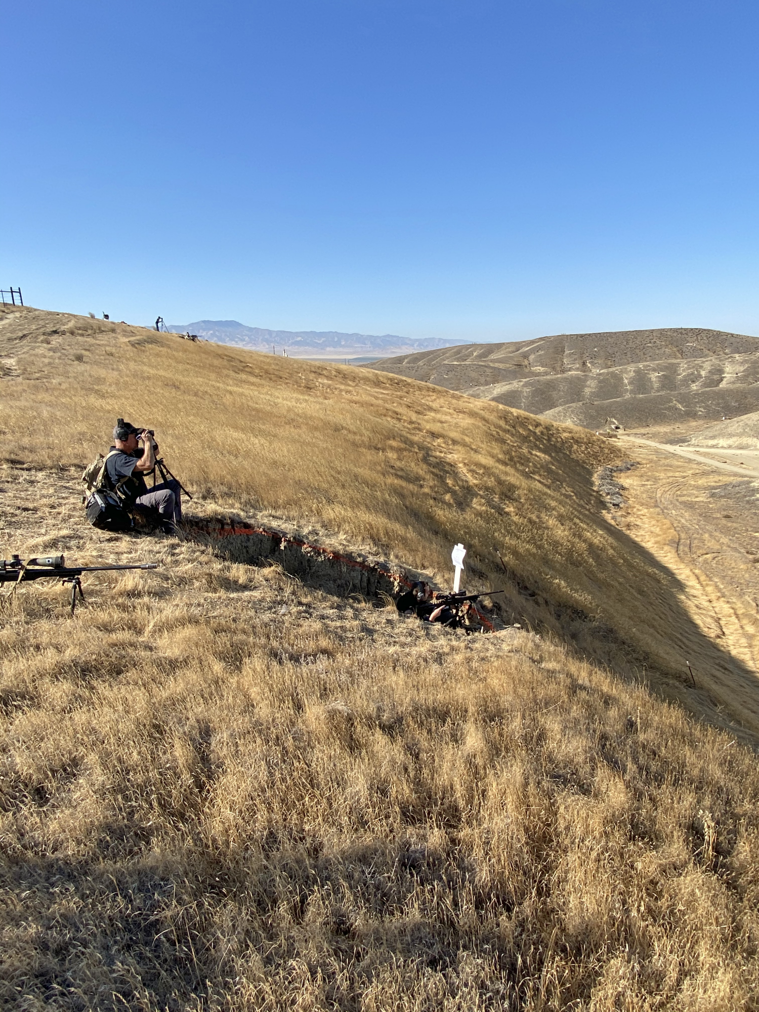

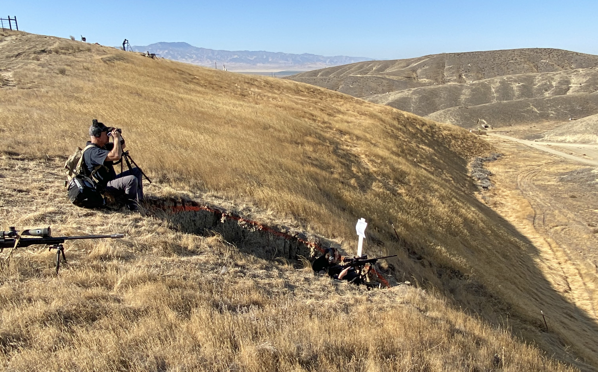

Below is the first stage Debrief, Others will be added.
Stage 5a Dave's Devious Dope:
Pencils & Dots with unlimited ammo, how hard can it be?​
This stage draws its inspiration from an excellent shooter who, for his 22 matches, was shooting matches, literal match sticks. But what does that have to do with field hunting? We'll, knowing exactly where your bullet is when hunting in dense vegetation is a skill many people don't often think about or know how to account for the possible obstructions. I've had friends and heard many stories of people clipping near twigs and branches, missing animals as a result.​
If you know your distance to the obstruction, you can calculate where the bullet is simply by entering the distance as the target. The come-up, plus the mil/moa of the bullet, minus the dope you need to dial, will give you an idea of how much clearance you need to see in your scope when aimed at your target to miss the twig or limb. This is the same concept for the loophole stage. But that is not the end of the skill set; these close items cause massive parallax issues moving all over in your scope as your position changes. If you don't have enough parallax adjustment, the only way to ensure the image is in the correct place is to make sure your eye is in the exact optical center of the scope. The solution is to use scope shadowing. If you don't know what that is, please co back and look at the Stage Spoiler for BT's One-Shot Team Challenge - Dave's Devious Dope Test. Spoiler Tip.https://www.snipershide.com/shooting/threads/field-match-tips-tricks-and-stage-examples-for-ukd-team-field-match.6980614/post-8556127
With the pencils set relatively high, we created an acute angle that, if shot from a low prone (small rear bag) with a tall bipod, scope alignment would be challenging. Improper parallax would easily contribute to a miss. We envision the easiest solution to be a high prone, bet suited with a tripod, upfront in the bipod position. This then was the very same solution for the dots. As an unlimited round stage, both partners should have been sling lead at the 10 dots simultaneously, and both should be set up high prone as illustrated in the image.​
The solution we had in mind of setting up high prone off a tripod is far more stable than a bipod at the same height. While it isn't the only way to get the stage done, but it is probably the easiest and part of the test of knowing your gear and using it in a variety of ways. Unfortunately, we did NOT see one team utilizing the uber stable tripod method. That said, the winning team of @todd and @sfogold smoked or "aced" this stage!​
The dots only had a very tiny position on the very left of the FFP where a typical bipod on tall would work. This was also a SOB test; what looked like a beautiful low prone set up at first glance was not. A target set a bit lower in elevation, a gentle rise in the dirt, and people were skipping rounds all day long. The other reason for NOT using the lowest prone possible is that the 1" dots are more affected by heat shimmer and dust from the brake. Teams that saw the low prone issue seemed to default to sitting, and as a precision stage, it added way more wobble, longer resets, and less accurate than needed, but it worked.​
Understanding the SOB, your dope, and how angular units work were part of this challenge. For the dope on the pencils, you need to remember that a 6.5 projectile, at 23y where the pencils were set is 1.1MOA; the pencil 1.04MOA fo a 2.14MOA/.62mil impact window. That means if you had a good trigger pressed and missed; then you missed by a lot! If you had this understanding, you could use your Kestrel that only goes to down 25y and get a rough difference per yard to target, then add that 2x to the target.​
For instance, my come-up with my SOB at 2.4" is 1.41mil @ 23yards using Cold Bore.
I can get that from a Kestrel, but need to do a few mental steps.​
25Y is 1.23mil​
26y is 1.15mil​
Resulting in .08mil per yard or .16mil for the 2 yards in question.​
Adding the .16 mil to the Kestrel's 25y 1.23 = 1.4mil solution.
Without a calculator, you could have shot the post to get actual dope, or pulled the bolt and bore sited. remembering you have a 2.14MOA/.62mil impact window. That means if you dialed .1 or 1.9mils you would have impacted the pencil. If you had a good trigger press, you'd manage your misses, just like you do when you miss the edge of the plate. You don't adjust back a tenth or two to the edge of the plate you adjust all the way back at least to the center. So go .4 or .5 in one direction, then try the other. These were very easy if you set up high prone and did NOT have parallax issues or solved them by using the proper techniques.​
Hopefully, if you're reading this and timed out or struggled this will expose you to a solution you might apply in the future.​

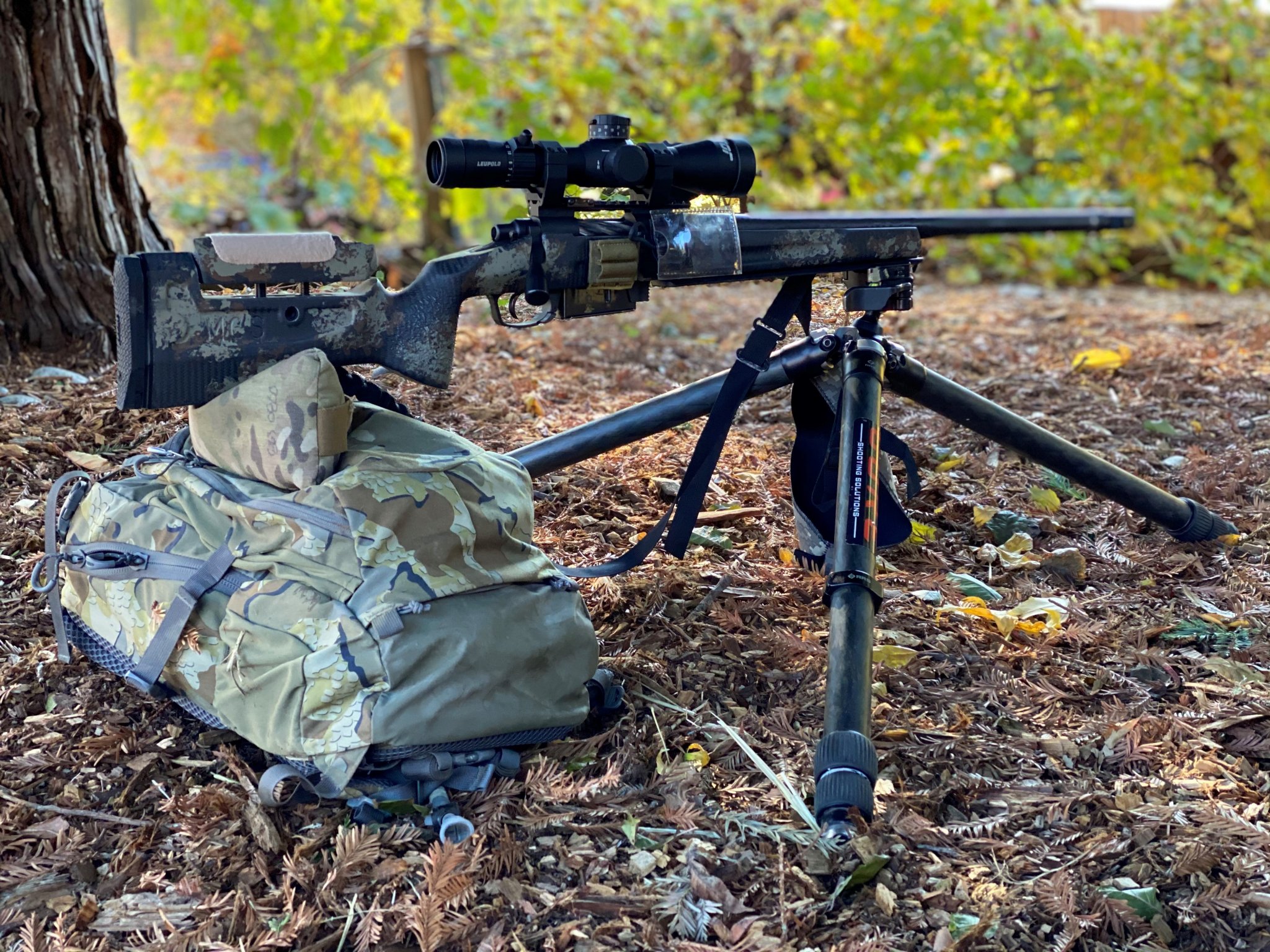

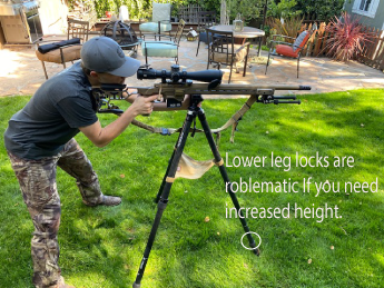

Added a quick clip to the Trip Tips and tricks thread after talking about how I felt the off-hand stages in PRS matches were out of place in light of the tools we use today. Many of us carry a tripod when hunting, I usually pre-stage my height once approaching an area I think might be useful at the FFP.
Anyway, the classic seating, kneeling and standing offhand, at a large 400y target as a stage in PRS/NRL; seems way out of place on our BR weight 6mms. With distance comes the opportunity to set up and since we have the tools why would we not use them?
I have not seen anyone shoot this way (using tripod legs as front support) as a time-saving measure, but it works great; much like using the tripod as rear support, you either rest your forearm on your front hand, grasp the bipod for more recoil control or shoot it like any classic hunting rifle resting against a small tree or branch.
I am shooting left-handed on a right-handed PCP to illustrate this (it has about the same recoil as a 6br). BTW It is much faster if you use the correct gun.
Either way, the point is you just not need to shoot a long-range target off-hand; this method is certainly capable of very good accuracy.
Here is another way to do almost the same using the tools we carry anyway. (This was already in the tips thread)

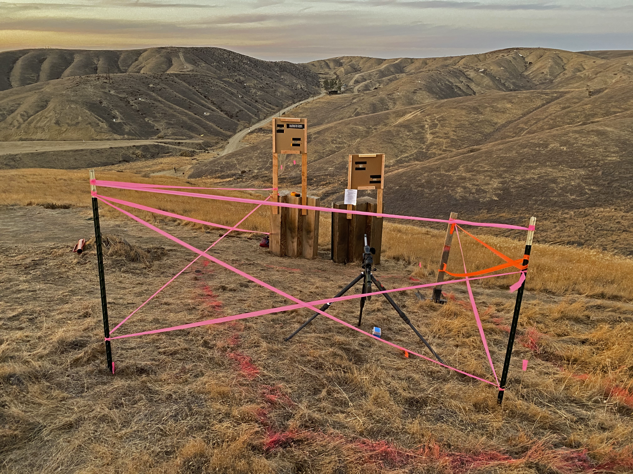

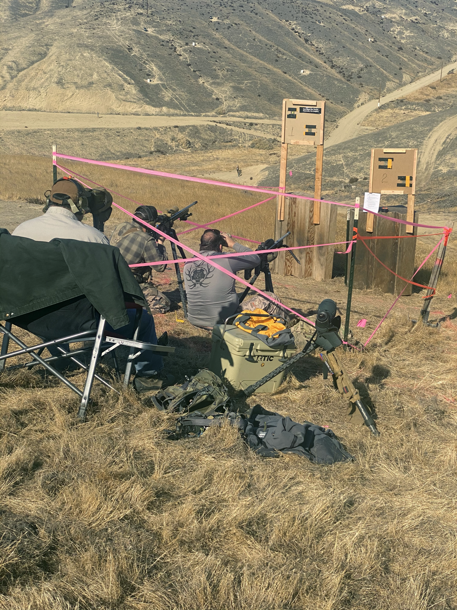

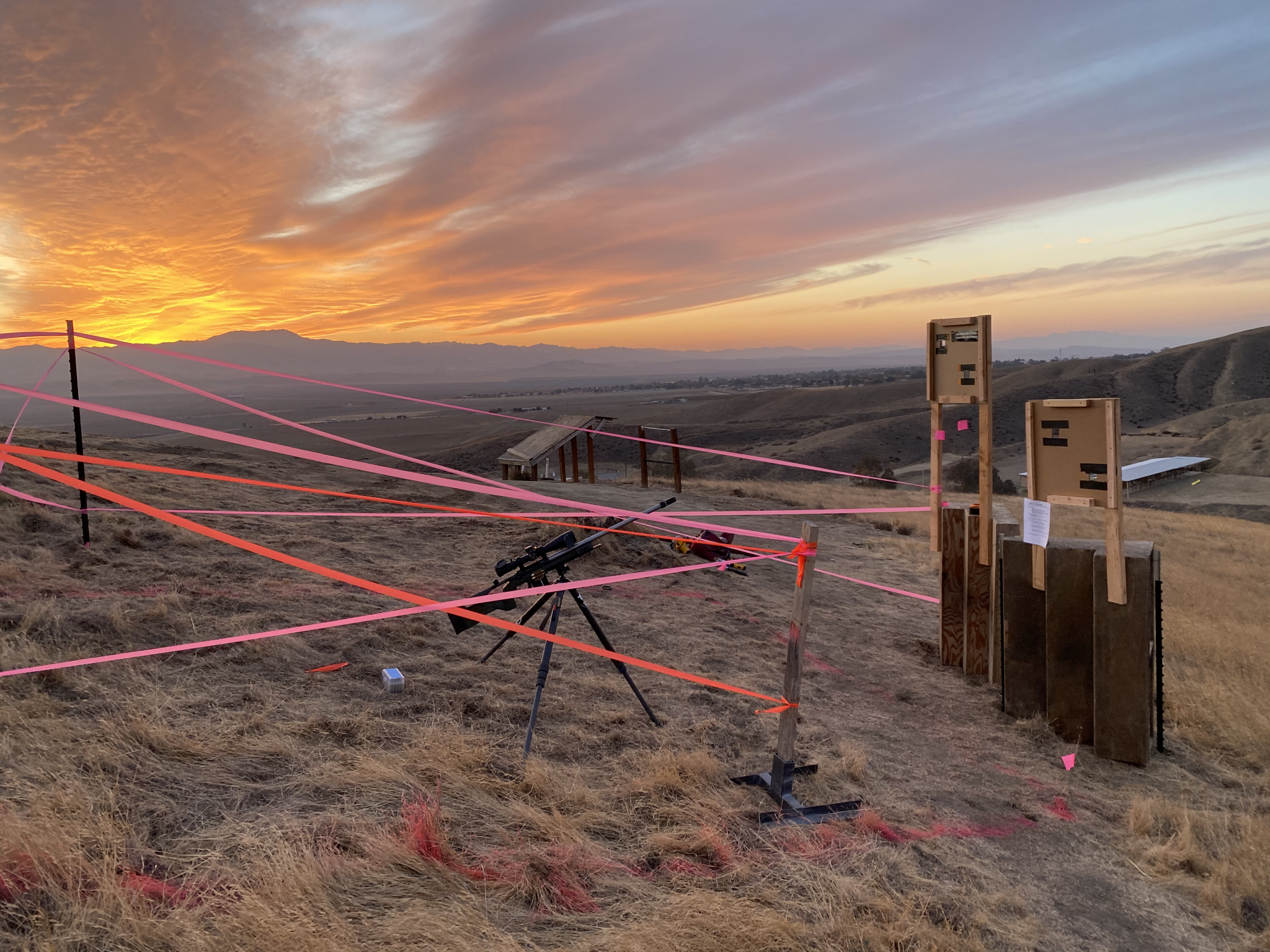

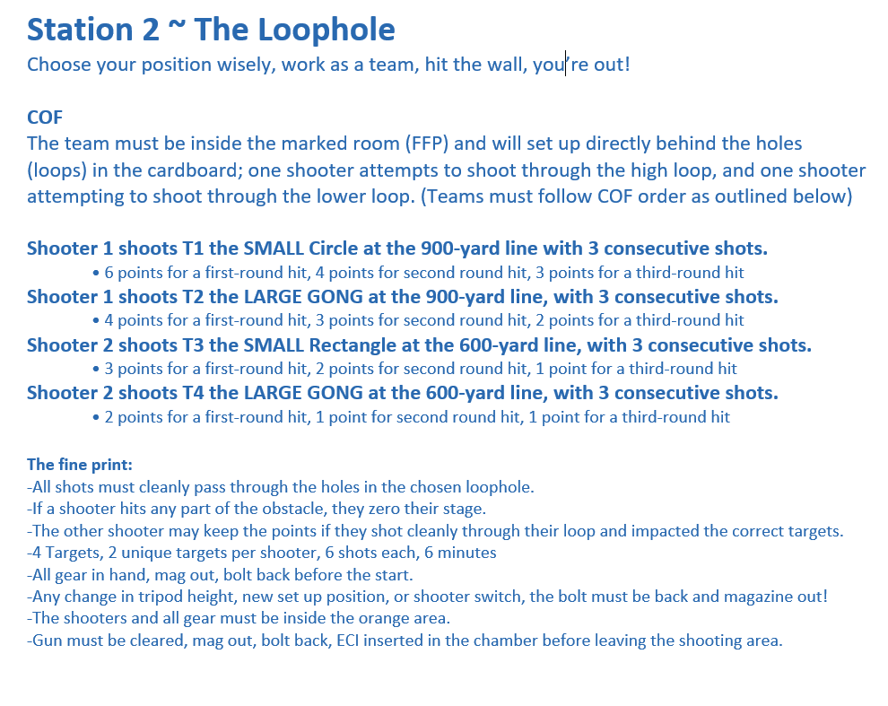

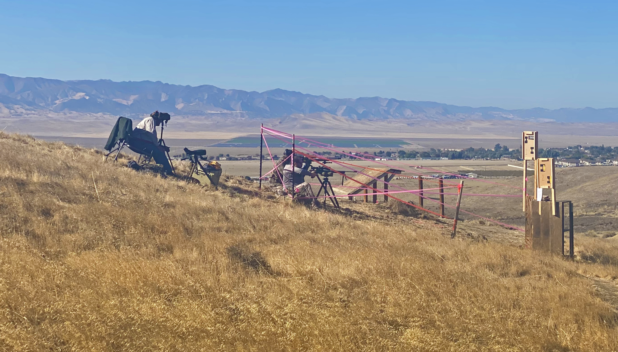

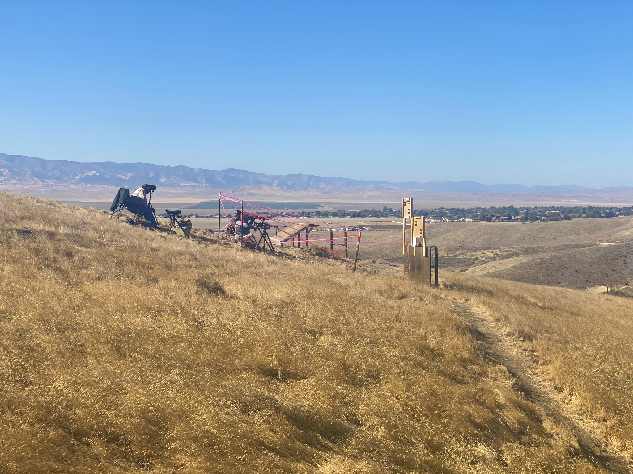

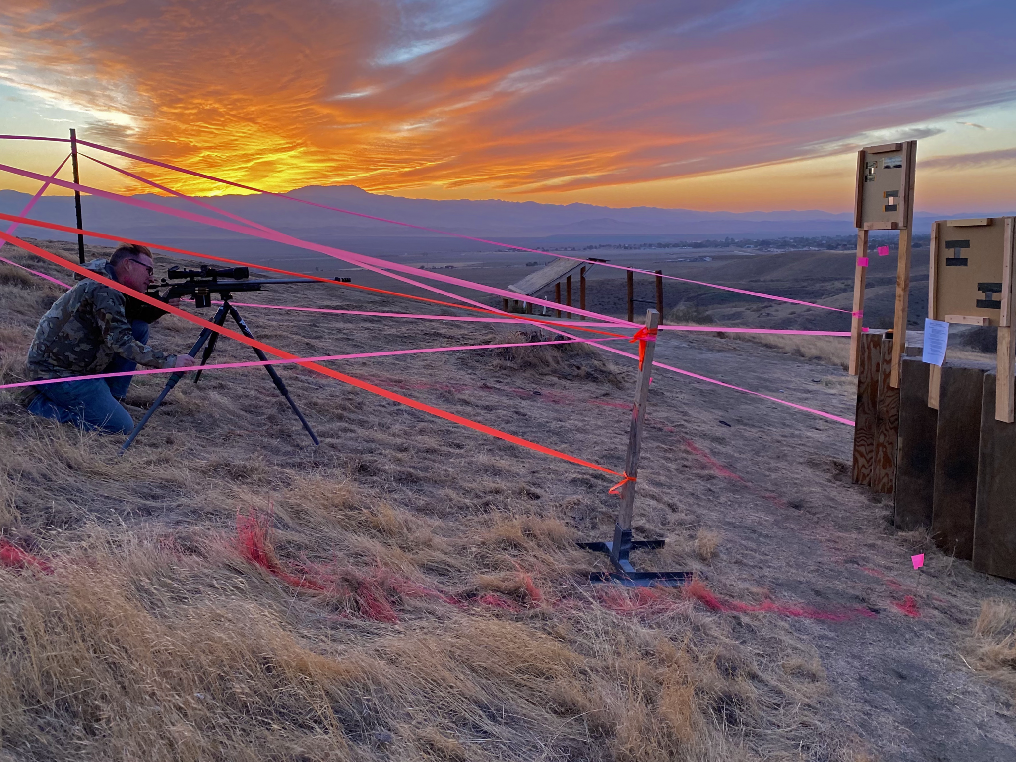

The Loophole stage and how we envisioned the easiest way to shoot it as a team~
As I write this, we are getting reasonably close to 20,000 views; if you're reading this and haven't read the opening post with the index of field shooting tips and stage examples and briefs, I would encourage you to do so as it will help put this in context. Index of tips here
I'll address the actual mechanics for near range interference clearing or loophole shooting near the end. The loophole in the cardboard was the distraction, not the real test of the team. It's worth emphasizing that other stages in this match utilized the team skills best used to conquer this stage, just as this one used skillsets from the other stages like the pencil stage. The goal was to assess the COF, the FFP and implement a strategy using tactics that would result in the most team points. This stage had the simplest COF in the match; only one distance for each shooter and their two targets were side by side, and the RO gave the location, allowing for a lot more setup time. The stage was worth 32 points, the same as all other stages, but shooter 1 accounted for a whopping 22 points. Below are images and COF the RO issued.
Click on the images for larger view
As mentioned before, we are trying to use a time element to induce a bit of stress, simulating a real-world adrenaline situation. In these situations, especially like hunting as a team, the adrenaline can kick in and have the shooters forget small things that result in a blown shot. So once teams entered the makeshift room of orange and pink construction tape, more often than not, the teamwork and analytical thinking stoped. With 69% of the points weighted on shooter 1's performance, most teams understood that their "Strategy" should include getting shooter 1 as many hits as possible and choose their best and fastest shooter as Shooter 1. However, there was room for other variations such as skipping shooter 1's small targets and get hits on the larger 3MOA plates and putting the better shooter as shooter 2 to clean all closer, easier targets. For the sake of this debrief, I am going to discuss the tactics associated with the strategy of having shooter 1 attempting to maximize their points.
Strategy: Being analytical, working as a team focusing on shooter 1's points first.​
  1. Challenge - Know where to set up: Most teams got this right!
    • Know your SOB and the issues it can cause <60-yards. Past 60-yards to your 100-yard zero and a hair beyond; most fast-moving PRS style systems are not going to get into too much trouble as long as you make sure you have a couple of 1/10ths of clearance under the POA. Parallax could cause the shooter to think they are clearing the loop when, in fact, they are not.
    • Tactic-Solution: Set up as far back as you can, allowing the bullet path to come closer in line to your LOS for your POA. Place the target near the very top of the loophole and make sure you use scope shadowing to ensure your looking through your scope centered. (I'll address the general idea behind the math later).
  2. Challenge - Choose the correct loop stations: Missed by almost every team!
    • We counted on teams focusing so much on the loophole that they would skip being analytical, ignore the actual problems, and not use the tactics needed to achieve their desired results. Human nature seems to dictate that we put the person who will shoot first on the left side, but in this case, it was the more complex and taller of the loops to shoot through. The first breakdown was not having shooter 1 in the lowest, most stable seated position.
    • Tactic-Solution: Shooter 1 should have been in the seated position on the right side; it's faster to set up and more stable.
  3. Challenge - Know your setup height BEFORE you set your gear: Some teams struggled.
    • Many teams rushed into the FFP, looked at the loops without looking through them first, and set up their tripods, in some cases several feet too tall, wasting valuable time.
    • Tactic-Solution: You need to aline the target in the loophole with your eyes before setting up your tripod. Make a note of that height and set your tripod so that the gun's scope should be at the same height you spotted through the loop. Using your partner as a visual aide is also helpful. Well, I've repeated this, spot from the height you're going to be able to shoot from if there is any chance you'll find an obstruction along your bullet path or LOS once on the gun. You don't need to do your actual glassing from, let's say, a prone position, but you do need to do a final spot from that height before you set up, ensuring that you do not have either LOS issues or obstructions that would render your position inadequate. You use this same tactic hunting and in many field matches.
  4. Challenge - Set your gear up as a TEAM: Missed by almost every team!
    • Six minutes, even though each shooter effectively had only one target to shoot, as the two were right next to each other, setting up the tripods to clear the loop takes time; working as a team was essential. Several teams timed out without shooter 1, even getting their gun on target.
    • Tactic-Solution: Shooter 1 needed to be the team's primary focus. Shooter 2 should have helped shooter 1 set up their tripod, helping with height adjustments as shooter 1 was on their scope, making the final adjustments. Shooter two had the close larger MOA targets and could have easily set up while shooter 1 was shooting. If shooter one finished before Shooter 2 set up full, then shooter 1 could help with 2's final tripod adjustments. Communicate clearly and efficiently to your partner as they make the adjustments.

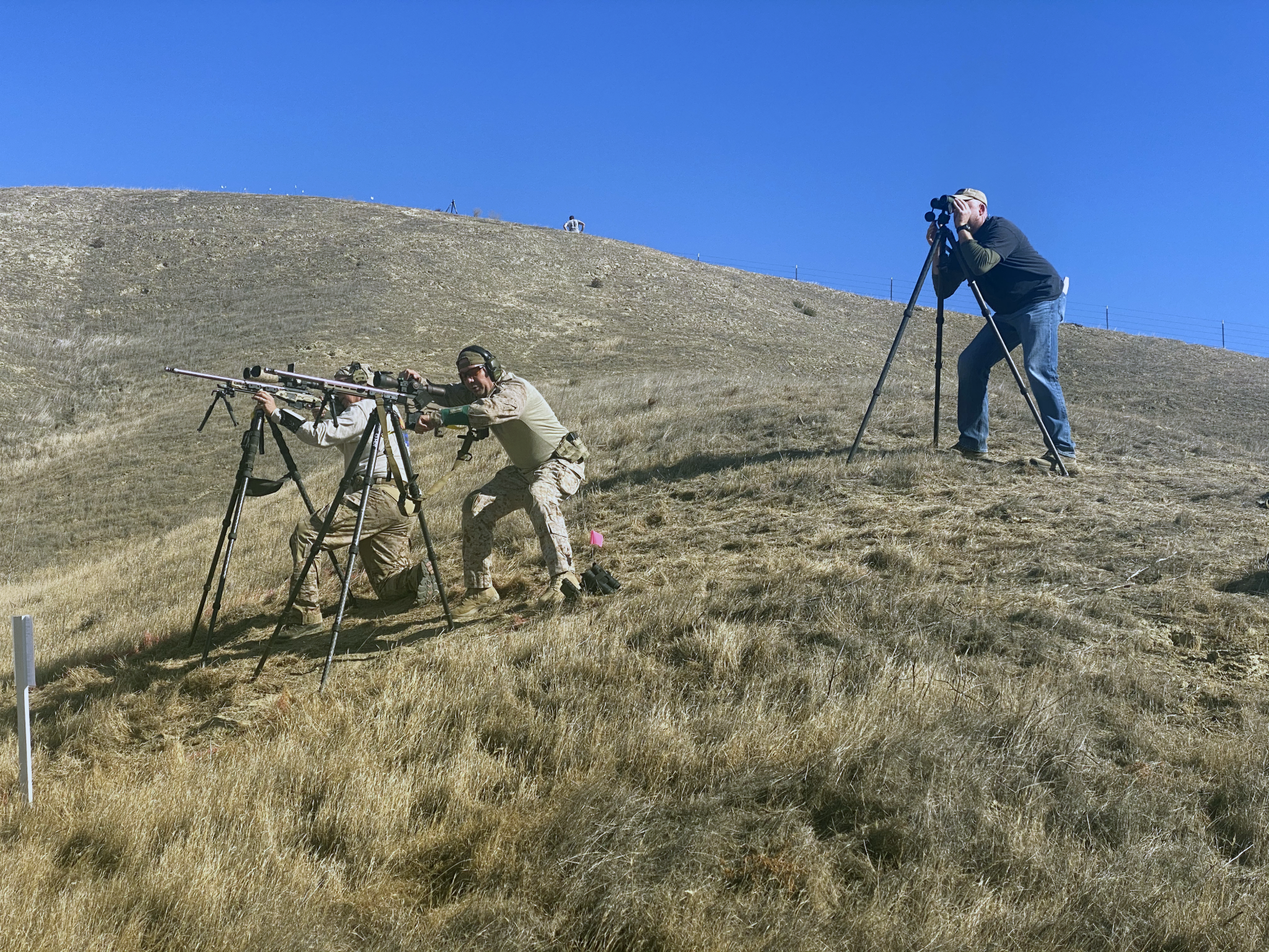

  5. Challenge - Know your tripod: Some teams struggled.
    • Shooting to avoid near range obstacles involves precise tripod movements. This is the rare case where a tripod with a center column is beneficial as height adjustments are easy. In this case, part of the workaround is to use your partner to help, as mentioned above. But how you set your tripod is the key.
    • Tactic-Solution: This is a case where a rear-facing tripod leg is beneficial. If you haven't, check out Tripod field tips here and see where, when and why a rear-facing leg, is helpful. In this case, like the others, it all about speed to fine-tune your tripod height. It's is easier to reach, easier to adjust, and more than two times as fast.
The take-away for future team matches: Listing to the ROs, analyze the FFP, think as a team, and look for problems outside the obvious. Ask the ROs if you see a solution to a problem not specifically listed, it just might be the key to the stage.
The application for the hunters: Communicate your plan before approaching your FFP, look for near range obstructions like limbs or tall vegetation that might cause bullet at interference, especially under your LOS. Either way knowing the rough path of your bullet will generally give you more confidence to shoot through small openings in trees and vegetation.​
The goal of the stage, reinforcing the value teams working as a cingular unit, is to get the shooters to visualize the effects of angular units on our everyday shooting.
The math basics were covered pre-match, in the Loophole stage spoiler but I am reposting it here again.
First, think of the loophole as a near range target with a secondary target at the end. So, let's use the very same base number for the reticle ranging stage. 27.78 is the number used to mil range targets in the distance using inches of target height - (Target size in inches x 27.78) / Mils = yardage
1. Let's rearrange that formula slightly to get the mil size of a target. In this case, we'll use a 2" target (or opening) and known yardage.​
1mil = 3.6” @ 100y​
100mil = 3.6” @ 1y or 3’​
3.6” is 0.2778 of 1”​
100mil x 0.2778 = 27.78​
27.78 mil per 1” opening @ 3’​
At 12’ (3’x4) it is : 27.78 / 4 = 6.945mil per “ of opening​
2” opening at 12’ measures 13.89mils​
The formula shows us our operational window, even if it is too close to the reticle measure clearly via our scopes.​
2. Using your solver, set the target distance to the distance of the obstruction. We need to find out what problems the distance creates for or SOB and the bullet arc at the loop wall. This will show you just how low the center of your projectile will be below your POA.​
Here I set my target distance to 12' or 4 yards to see how many mils below my crosshairs the bullet's center​
3. Account for your bullet width.
At 12 feet or 4 yards, 6.5mm bullet is .264" or 1.83mils thick; we need to be concerned with the bottom half in this example.​
6.5mm at 12' is 1.83mils​
1.83mils / 2 = .915mils​
4. Account for your bullet width.
The loophole wall AKA near target distance is set to 12' or 4 yards to see how many mils below my crosshairs the bullet's center. The solver is saying 14.8mils. Then you need to ADD 1/2 the bullet from above, plus a bit for safety​
14.8mils + .915= 15.72mils​
let’s just say 17mils, for safety under my unaltered crosshairs to clear the lower part of the loop.​
5. Subtract your come-ups from your intended target from the bullet path.
Target @ 900Y = U6mils​
17-6mils = 11mils​
As long as I can see 11 mills under my targe I should be GTG - (remember the loop is 13.9 mils from that distance). That means you need to set up so the target appears in the very top part of the loophole.​
But wait, some cases are not that simple; if the distance creates a larger come-up than the bullet path is at or about your LOS, you have to be concerned about the top of the loop. Let's say I am back further, and the target is further. Let's use 10y; at 10y, I only need U5.2, let's say U7 for safety. With a target at 1400 yards, I'd need U13. Now your safety is also above the crosshairs with maybe 10mils (8mils + 2mils for safety), as well as below.​
Or you can use a program like FFS and all the math is done for you. But really the thread is about understanding a bit more and, if nothing else, just to get you to think how all these parts work together.​

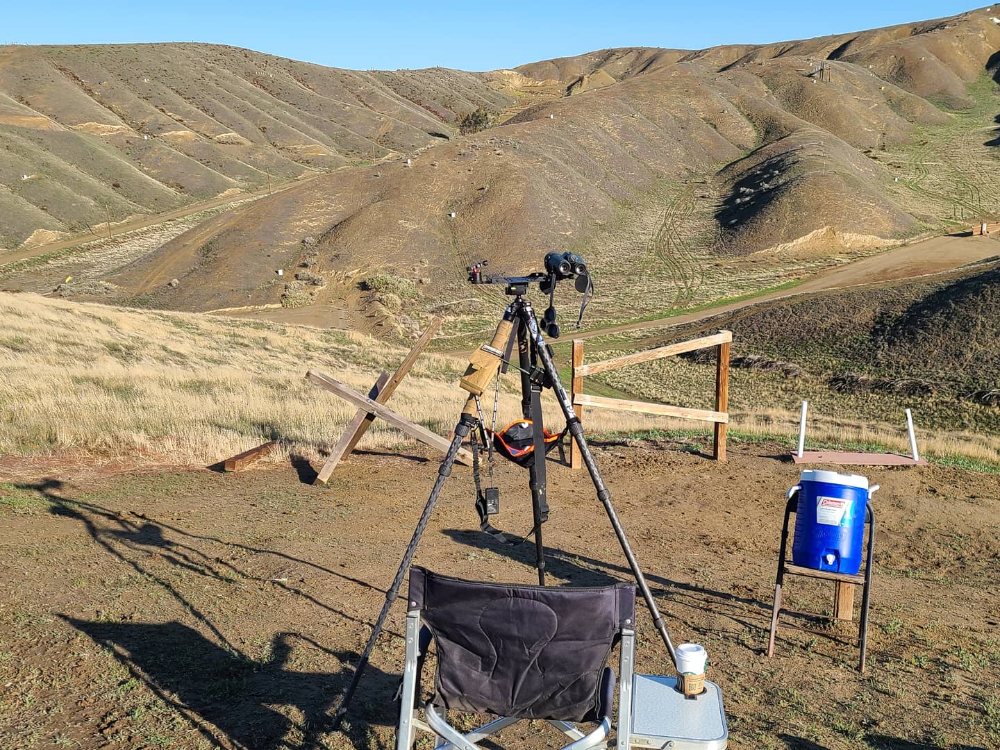

Although not a team match, this is the first true field match I've seen in deep Southern California. Might be worth checking out
Contact @hic28 for more info. He's a content contributor on this thread and a very experienced field shooter! They are going to have a novice classification and will encourage coaching!
Reactions: lash and hic28
Ranges go out to 1900yds. A desolate place, but very nice place for LR shooting. A metric shit ton of steel targets scattered out amongst the ravines, ridges and gullies....

Tip 2: Adjust from the top
All micro height adjustment, especially if a rifle is on the tripod, should be done with the uppermost leg section. All other legs need to be fully extended before the top leg section. I can't tell you how many times I have seen a person with the rifle on the tripod, realize they need more height adjustment, dangerously, and slowly try to perform a three-handed change because the only leg available are the ones at the bottom. The chance of dropping your rifle, having to take your eyes off the target, and just being ultra-slow is not worth any perceived stability enhancement with our modern large legged CF tripods.​
It is always hard to adjust up with a gun on the tripod. You must remain in 100% control of the rifle.​
Below is not the way to do it!
If you are using the middle legs fully extended and you need extra height, the INCREASE adjustment must come from the bottom leg, and now it is a complete mess, and you'll no longer have control of the weapon system.​
In truth, you generally only have to increase the height on a single leg. If you only had to adjust a single leg UP or down, the two rear-facing legs are easy to reach, with the shooter still facing the target. The safest way is to remove the gun. The videos adjusting all the legs are to illustrate the point.​
Choose a leg height that works in multiple positions. Many people might be surprised that standing, kneeling, and sitting can share the same leg adjustments. Your tripod may only accommodate two of the three, but finding that sweet spot will save you a bunch of time. To do this, extend all your legs; adjust only one TOP section to find your "perfect standing height." With most 3 section tripods, simply collapsing the remaining fully extended legs will result in a stable kneeling position. Often then just widening the legs by unlocking the leg locks will work for a seated position. The idea here is that standing is the most critical to get correct, and the other two shoot well with more flexibility. If you find time to micro-adjust the kneeling or sitting, it should be so close already that it takes little time. With a bit of imagination, you can see that setting up with the legs super-wide, legs extended for a seated position, is really stable and perfect for a day at the range or maybe from inside a Hide. But getting in and out of that position to shoot super-wide seating, might take more clock time than it is worth. Vegetation and topography also can limit the ability of super-wide setups. If you can find a set up that works for standing, kneeling sitting, you'll be surprised how fast you can go between them.​

It's all a balancing act, generally, keeping your gun as close to the magazine well as possible without causing lever or mag interference on one of the legs, is going to be close to the balancing point, and that is what you are after. It is generally the most stable and a bit more resistant to the shooter's erroneous input, as the shooter side lever arm is as small as can be. But there are other reasons sometimes not considered.​
For those that run their mounts far forward of the mag well, they'll get more height variation with significant angle changes. With my match rifle and my typical standing setup, by only moving my legs together and straightening my back (while not ideal), allows me to shoot from approximately -21% (downhill) to +32% uphill on a knee as the butt of the rifle swings 19" when completing its arc. On that rifle, mounting just a 6" forward creates 5" more vertical movement, resulting in 21% less range of motion.​

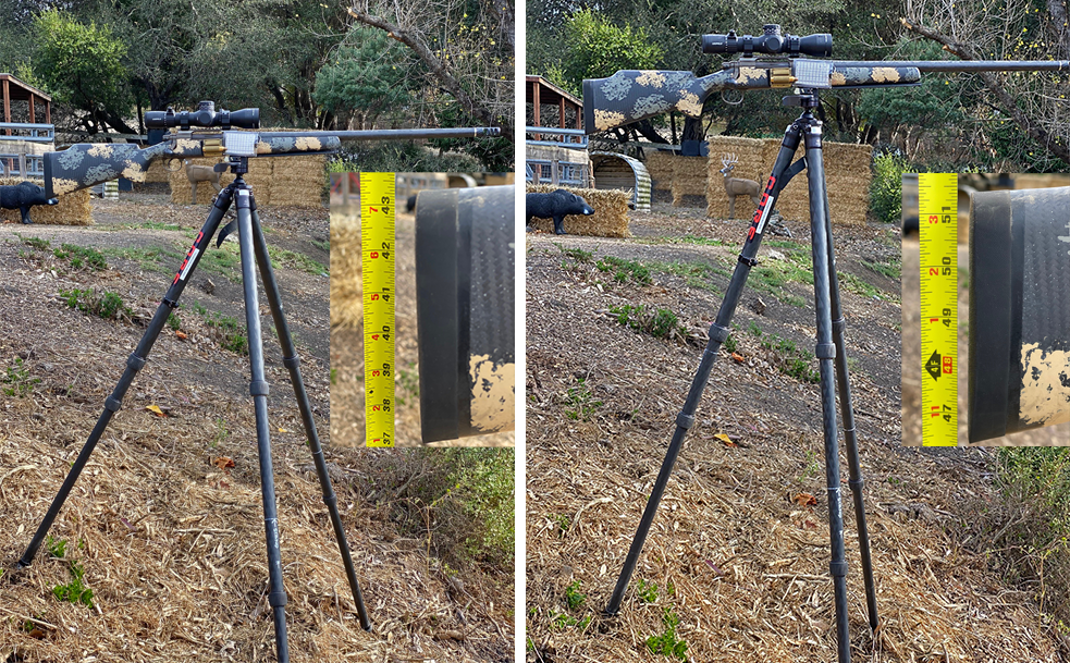

Tip 5: You're High
People often set up higher when standing than they should. Make sure even with your feet spread at least shoulder-width wide, with a nice bend at the hips so that your back tilted forward and all principal body parts square; you are comfortable on the gun. An excellent place to start is just about with the top of the tripod at sternum height. As an individual, you'll need to experiment.​
If you set up too high, you'll lose much of your range, especially if you need to shoot at an angle lower than you planned for during your set up. See Tip 3.​

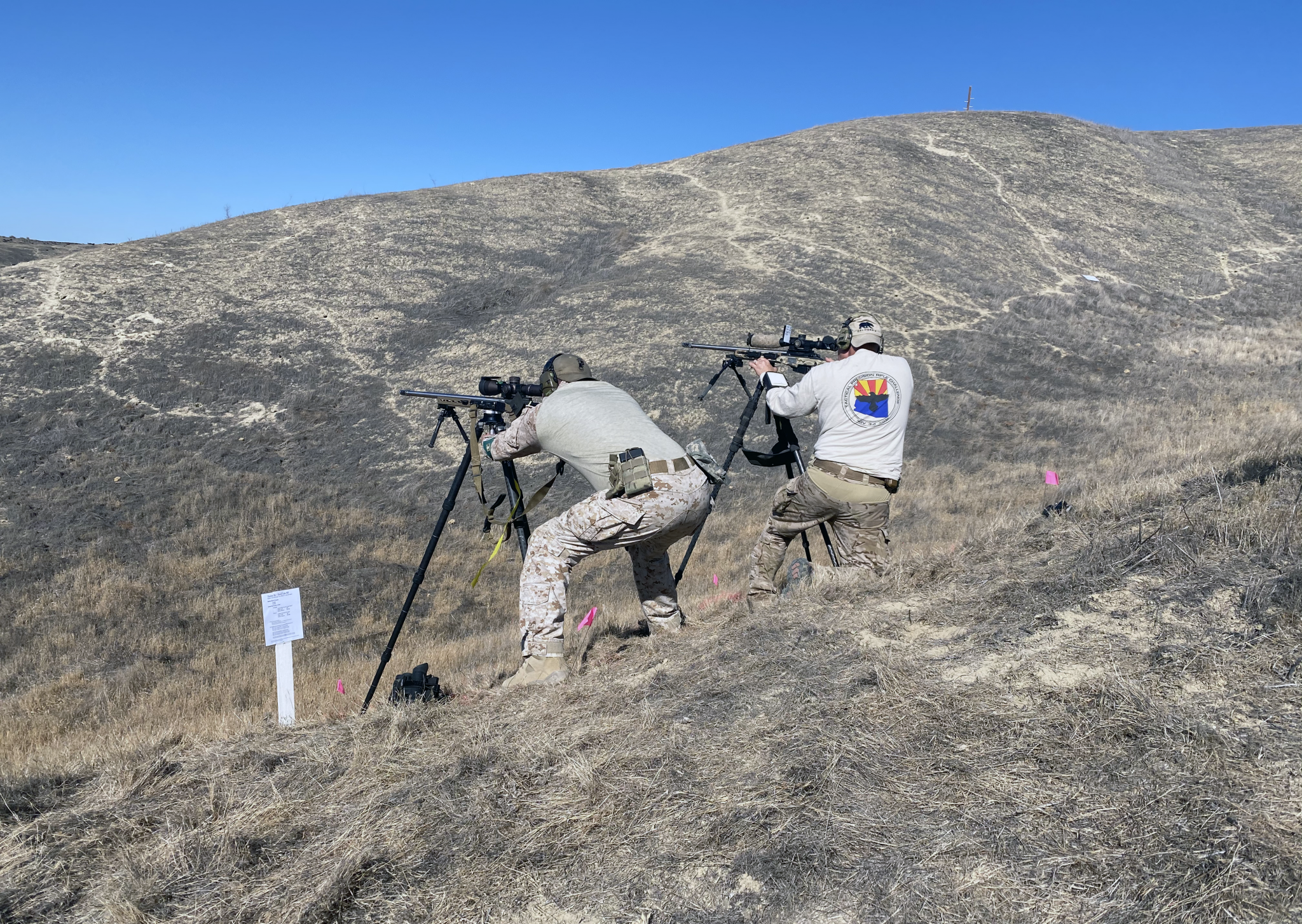

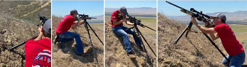

Tip 7: Work the angles

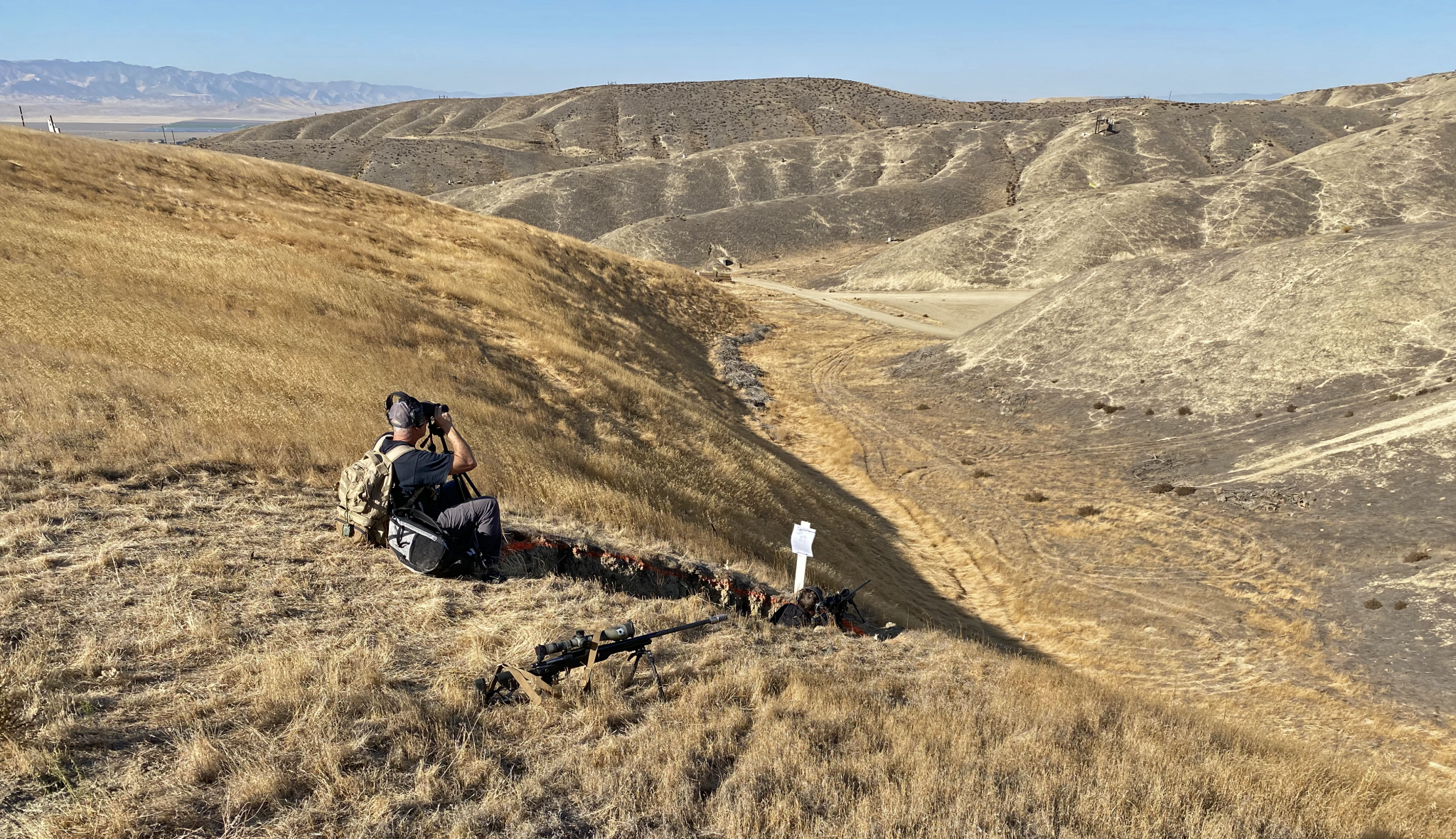

On an angled slope, not only do you want to adjust the legs to be at the correct height, but often will run out of adjustment, especially if shooting from a lower position. Don't forget to use the additional angles the leg catches at the apex provide to enhance your tripod's flexibility. It's often better to reduce the effective height of a leg by actually extending it outward, by unlocking the apex leg lock and drastically opening up the leg. The mistakes people seemed to make at our last match, was becoming confused with the initial setup height.​
When shooting from a slope set up higher than you think. Because you probably can't set up your body as stable as you can on flat ground, sitting is usually hard or impossible from some of the positions. When shooting downward, modify the above lower, and when shooting upward, modify your tripod lower. Angled, shooting often dictates a rear racing leg for speed of deployment, micro height adjustment, and simplicity.​
On a downslope, the shooter on the uphill side, you need to set up higher than you might think because the distance where the gun mounts, with the length of the buttstock, moves toward the slope as the slope rises. See the image in Tip 9. When shooting on a steep uphill, the opposite is true, but you're not going to be stable sitting on your ass. The same is true for a steep sidehill position; you'll need to modify your legs and, in turn, your position, to keep from sliding down the hill.​
Hills sloping away with cross canyon shots are often another problematic scenario if you have a bush or other obstructions that require you to take a standing shot. With the down legs fully extended, most tripods will still be too short if the shooter has to stand on the uphill side; essentially the slope makes the shooter much taller than the tripod. Both images below have the downhill tripod legs extended 100%. The image on the left has a maximum height that would be very uncomfortable for a standing shot, while on the right, it provides almost another foot of elevation. Comfort aside, this might make the difference between making a shot or not having a clear bullet path. It's straightforward to gain extra height out of your tripod without adjusting your trip leg locks; just like in Tip 3, where we bring our feet together to get more shooter elevation, you'll do the same with the tripod legs. You may want to utilize this even on flat ground if you notice you set up a hair too low and need to get the bullet path to clear an obstruction quickly and quietly. It's not quite as stable as the legs set to their maximum width, but we're talking about hasty field positions throughout this thread. If you're on a slope, you'll need to also extend the uphill leg that was not fully extended, to keep the apex level.​
While I've talked about the most efficient way to shoot off a tripod, is generally with two rear-facing legs; not all situations are best served by trying to force this setup. You've probably noticed when I display pictures where the ground is sloping or where I tend two need to make a height adjustment quickly; I will use a rear-facing leg so that I have to adjust only one leg rather than two. It will give you more stability in some situations, but primarily, the ease of setup is worth the trade-off.​
For high angle shooting, it is ideal to have a full-length rail. It allows the shooter to micro-adjust the gun by sliding the mount more forward if needed to find the perfect setup height and fit. Even if the angles at not at the FFP, maybe just a small obstruction that requires high or medium prone that a bipod can not accomplish; the full-length rail is key to the field shooter as it provides the ultimate in flexibility. High prone below, two lower positions are easily possible, I no longer carry a bipod when hunting.​
Personally, I run Henderson ARCA rails on all my hunting rifles and field guns. the 12" version is just over 3.5 oz and actually lighter than some 3" rails and a pic front mount.​
Low prone below: It's about the same height as an Atlas or Harris in the standard position - there is another position in the middle even before pulling the legs out and getting all funky​

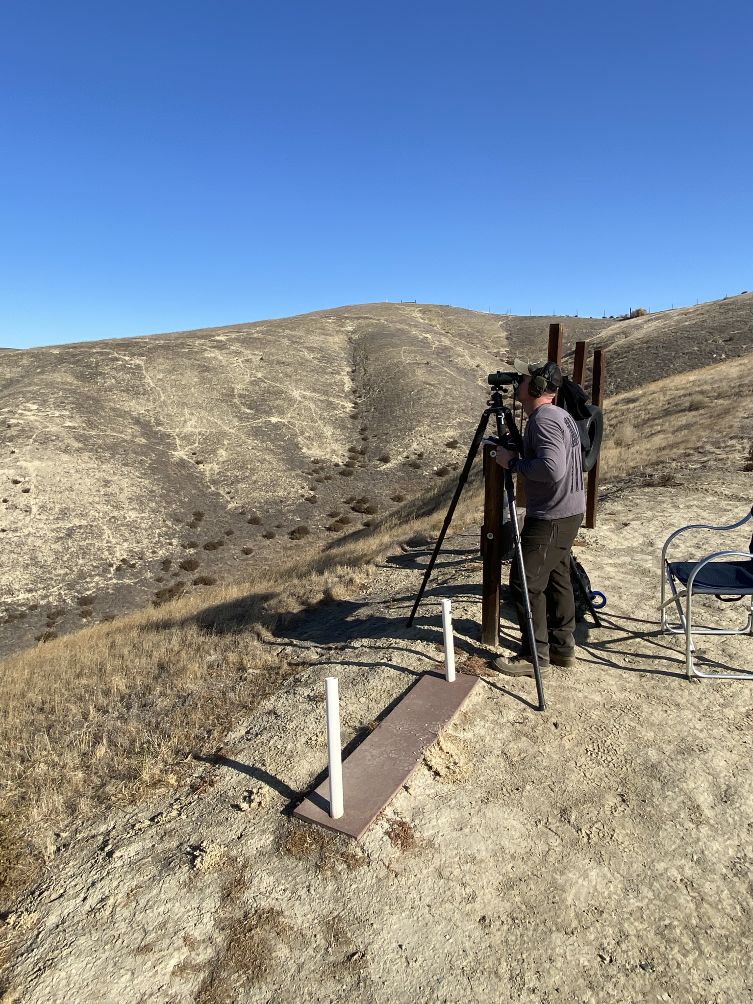

Last year it seemed shooters set up their tripods before they found all the targets. Many of them set up in the most stable positions rather than spotting and shooting from a more reasonable level. They often ended up timing out trying to adjust their tripods back to a standing position. Remember, it is much harder to adjust UP with a rifle on the tripod than it is down.​
In the image shown, the tripod is too low, see the "red arrow" in the picture. Make sure you set up the tripod from where you are going to shoot. The shooter has not noticed the issue with the slope causing an impossible position to shoot from, because the shooter didn't build the tripod position from where he planned to shoot, nor took notice of the significant difference in his and his spotter's height. More to this, see Tip 10.​

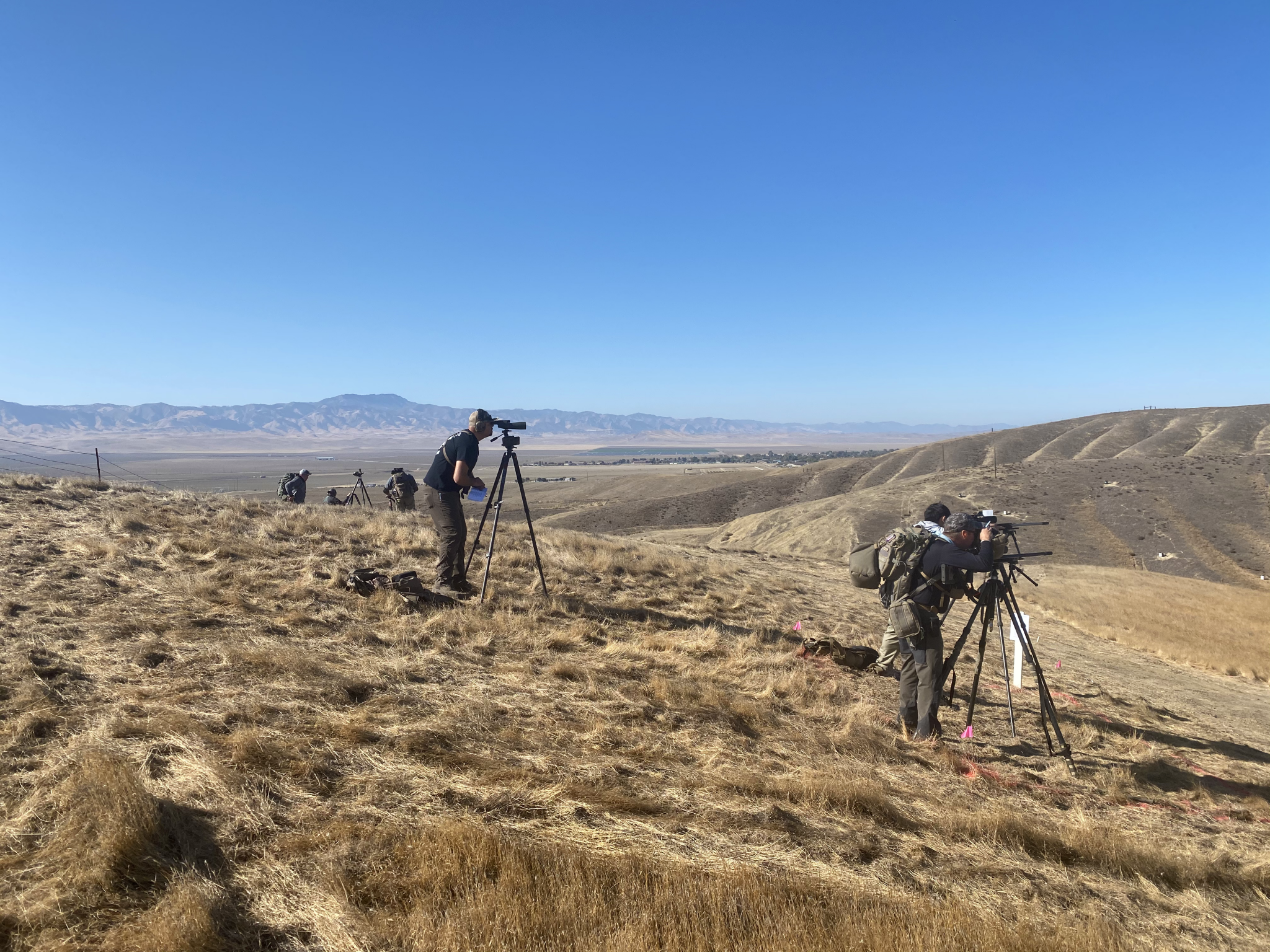

Tip 10: See what your spotter sees
When glassing, especially with a teammate, don't set your rifle to low until you know you can see the targets from your intended height. Vegetation, ridges, or slight ground height differences could create dead space and hide the target even though while glassing standing, the target was visible. The same can be said the other way if your shooting under or in trees. If your glassing by yourself, the same principle holds true. If you plan on shooting seated, you might as well glass from that same height or decide to set up your gun higher to match your glassing height. If you are glassing from a position that differs from where you plan on shooting, pay particular attention to anything in your peripheral vision that might present a visual obstacle from the shooting position. If you are unsure, pop your binos off and take a quick peek from the other height.​
Just like above, I saw many teams with one guy standing glassing and the shooter setting up kneeling or sitting at our 2019 match. There is no way the shooter setting up is going to be able to see at least 1 of the targets from his low position. The glassing teammate should notice that a ridge between the FFP and target, is relatively close to the LOS from his position. That would be a huge RED FLAG. The two shooters have a LOS offset that is about 5'. (side note: The RO missed that the spotter was outside the FFP before time started, this is a stage DQ in our UKD Team Match.)
