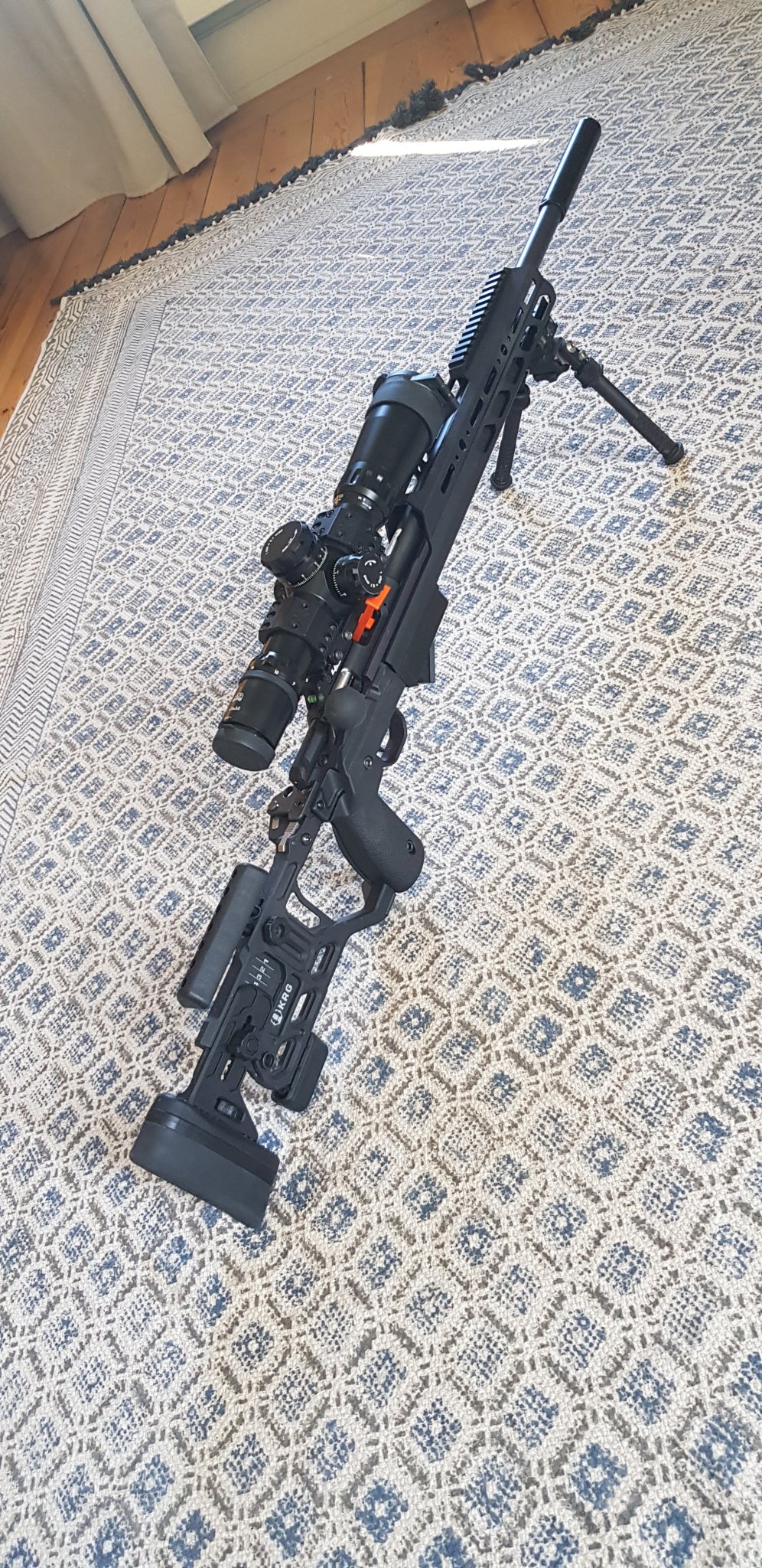

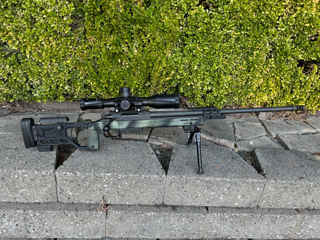

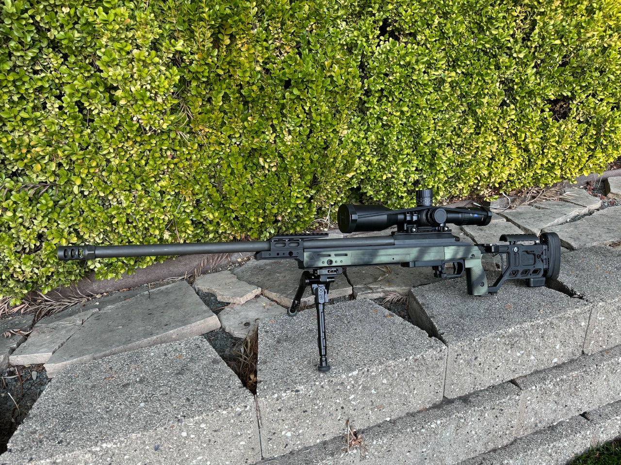

Thank you. But times change so it's on my CZ now.
The TRG got new clothes:
Just had to try.

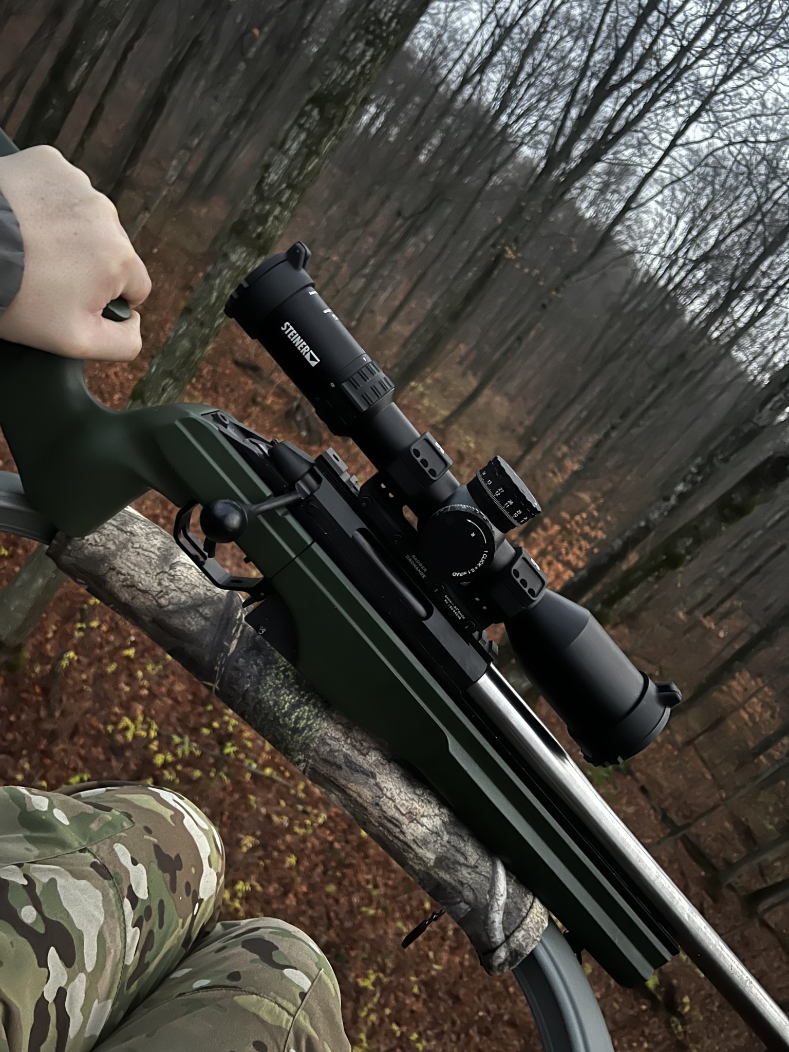

Recently added an ASE SL7i. Didnt shoot it yet, looking forward to it though.
The more i shoot my TRGs, the more i drift away from my AIs. If i had to make a choice right now i'd go with the TRGs. The ergonomics fit me far better than the thumbhole stock of the AI. Honestly expected it to be vice versa in the beginning.

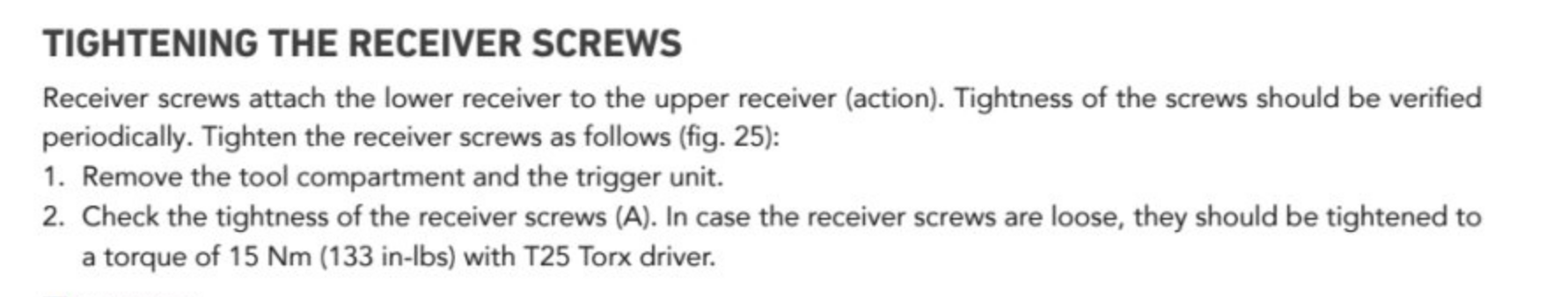

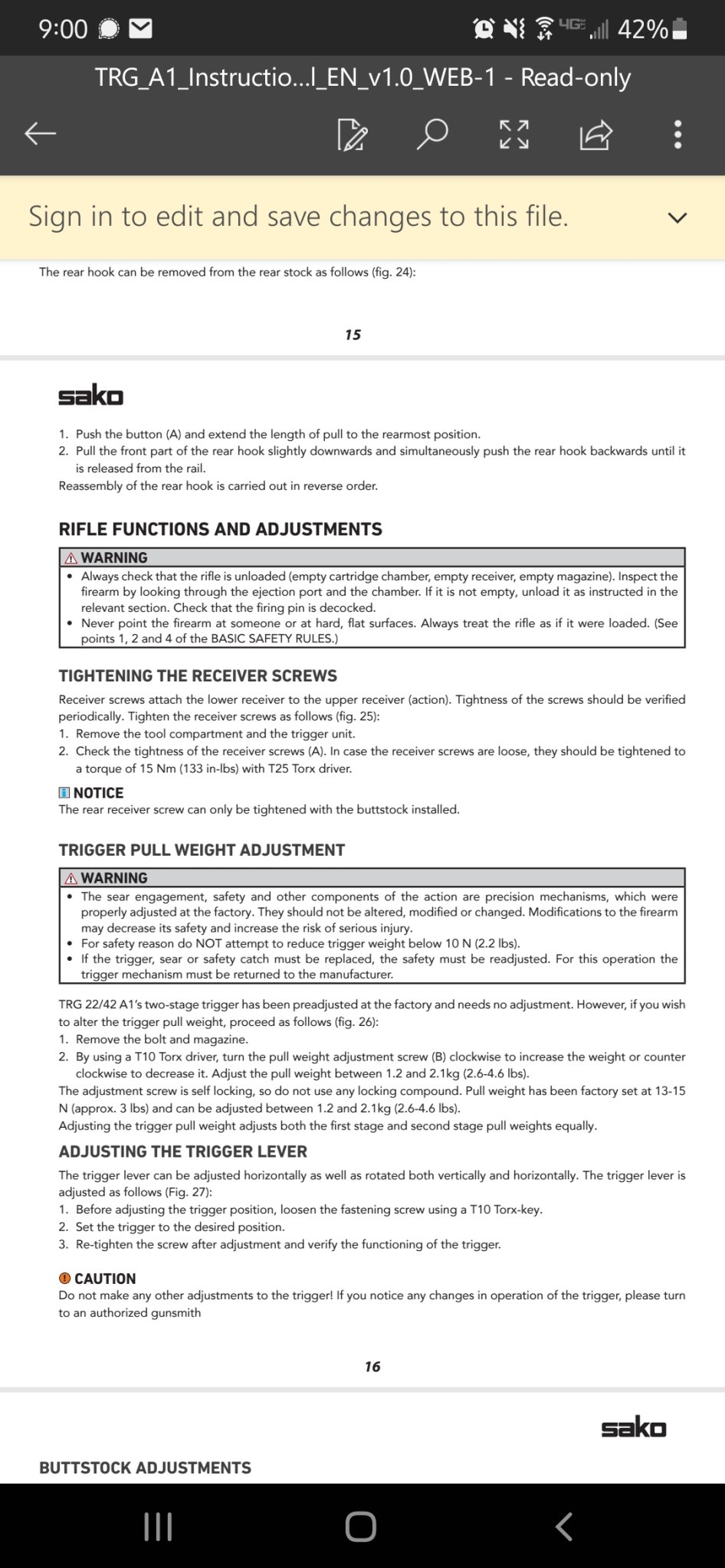

Just to add to the spice here....Beretta contradicting itself....

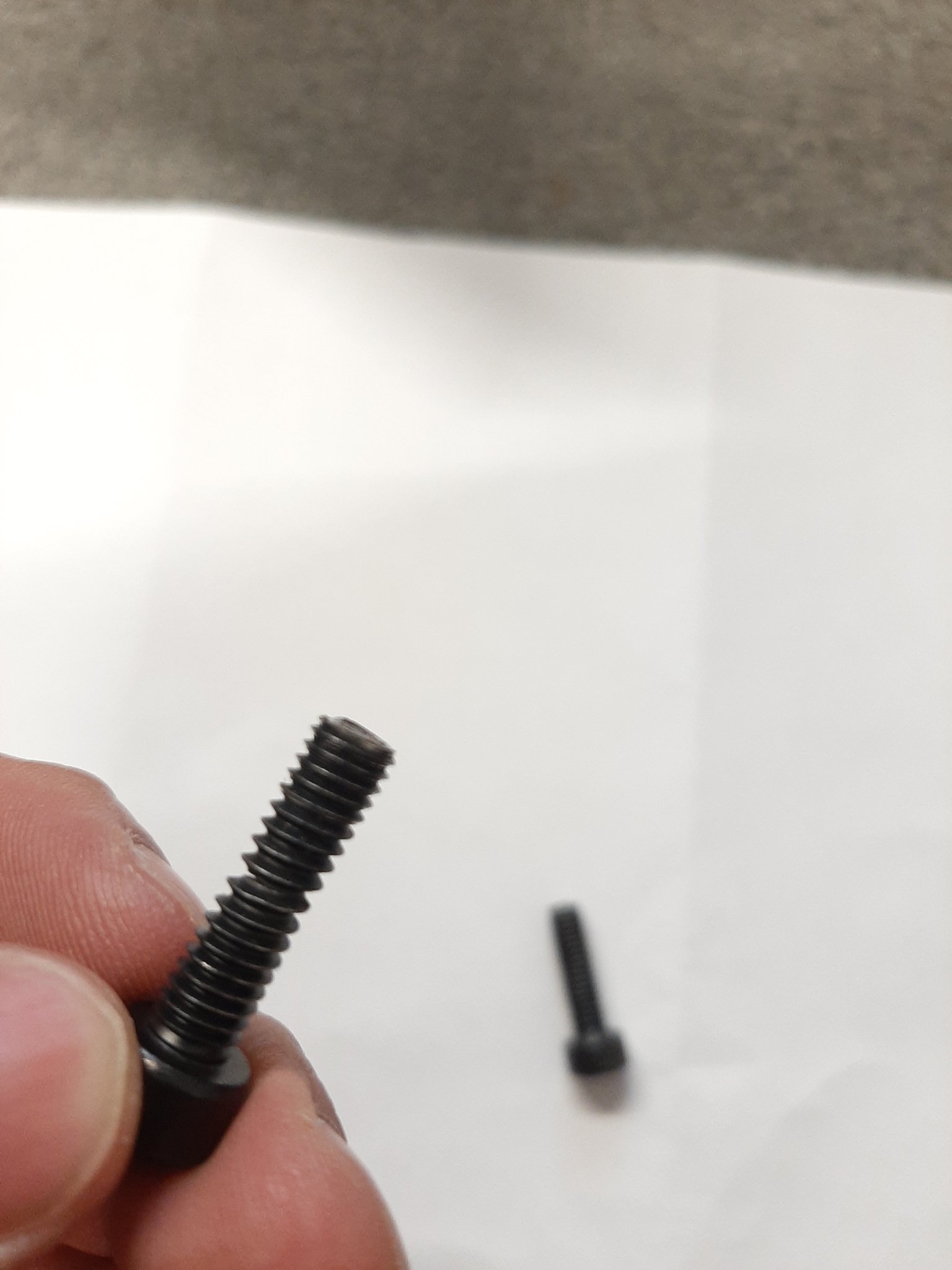

Action screws on my A1 were finger tight or less so I tried doing the ridiculous 133inlb and the screw stretched and cracked at 80. Tried to get replacement screws and that's the response I got. Picked up 3 from tractor supply and torqued to 65 and will test the accuracy this weekend with they're own trg 175gr ammo.
  • Wow
Reactions: DKN83
Yeah there’s no way a bolt that size is taking that torque, I don’t care what grade of steel it is haha. I’ve always just snugged by hand with a screw driver . Never had mine come loose.

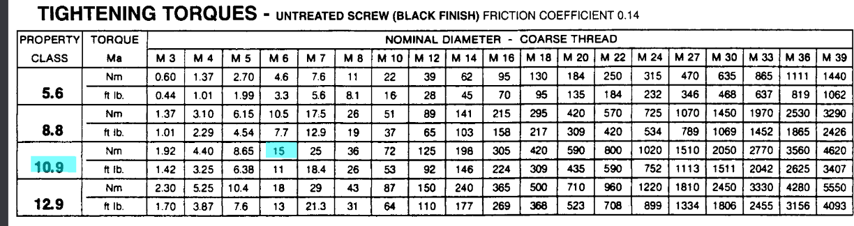

Standard application torque for m6 x 10.9 class (high quality) screw is = 15nm or 11ft lb. In-lb equivalent is 11ft lb x 12in/ft = 133in-lb. Here's the manual, which repeats this verbatim:
No way m6 "quality hardware" snaps in half under these loads.
Note that alternative and/or low-quality installation hardware has potentially much lower load ratings. If something has snapped its likely not original/10.9 spec parts. ETA - this includes substitution of stainless steel scews, which even when good quality, are typically a downgrade in tensile strength vs the 10.9 spec.
Other potential issues to rule out would be out of spec torque-wrench, or incorrect thread condition, etc.
Reactions: DKN83
View attachment 8516216Standard application torque for m6 x 10.9 class (high quality) screw is = 15nm or 11ft lb. In-lb equivalent is 11ft lb x 12in/ft = 133in-lb. Here's the manual, which repeats this verbatim:
Yeah that’s recommend max torque before failure in that thread lol. There is no need to go over 60-70 inch lbs I don’t give a shit what they say. I don’t belive they even had a spec in the old models manual. They was an older thread about it in here someplace.
There was and I referred to that thread and they were also told 133inlb but most torqued to 45-65. I don't believe hand tight is enough but 133 sounded insane. I attempted 133 only because the book called it out and Beretta told another member the same spec. Trying to eliminate all things Beretta can throw at me before I try and send it in for accuracy issues. I'm putting money on the screws tightness though. We'll see Saturday.
Yeah I get that, and it’s just my opinion but I think it sounds crazy for a m6 bolt even with the supposed grade the fasteners are. Who knows maybe I’m the moron
There is virtually zero chance a 10.9 m6 is going to snap-in-half at 15nm.
A out of spec or mis-dialed clicker-type torque wrench would do it pretty easily tho.

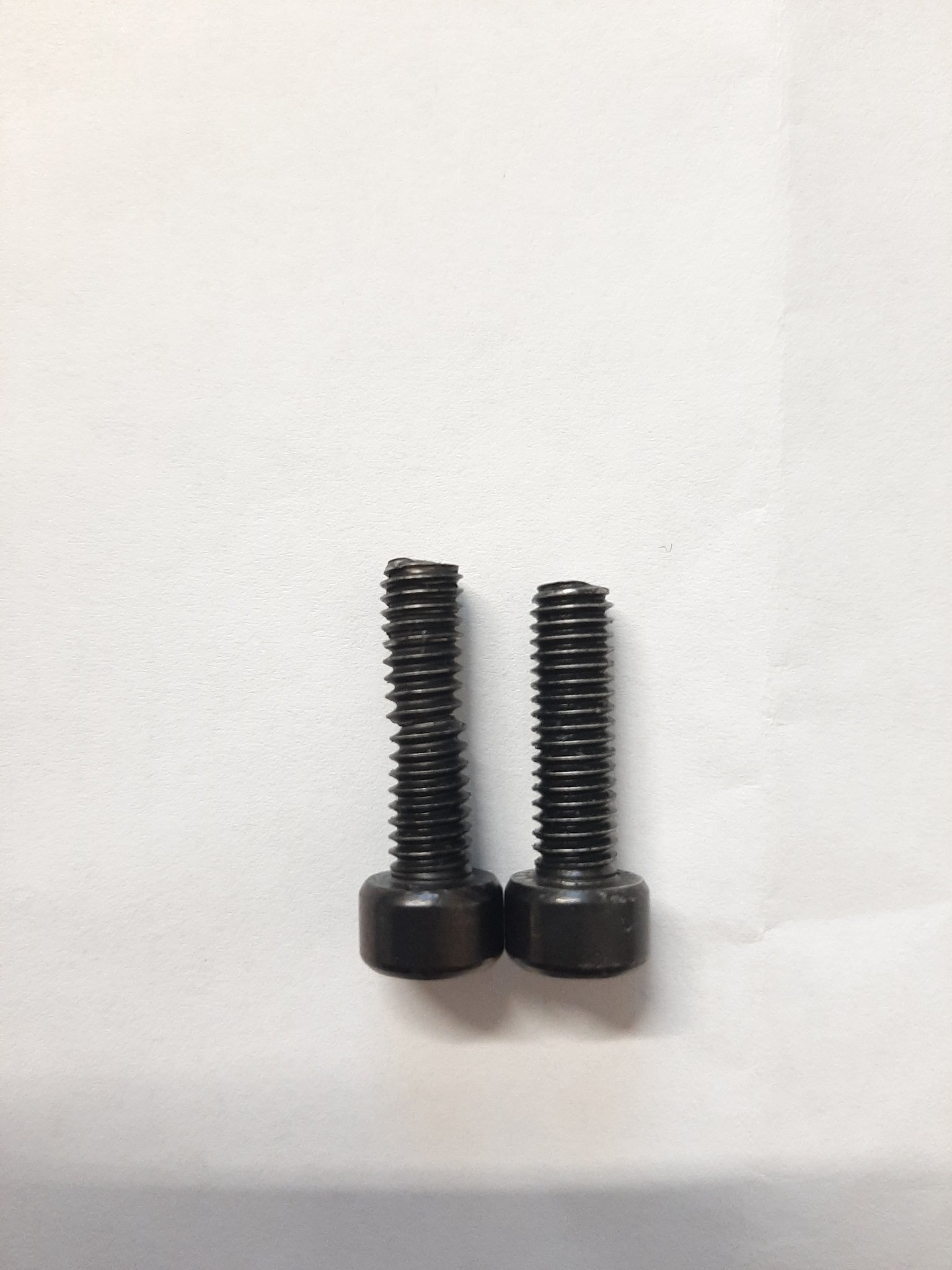

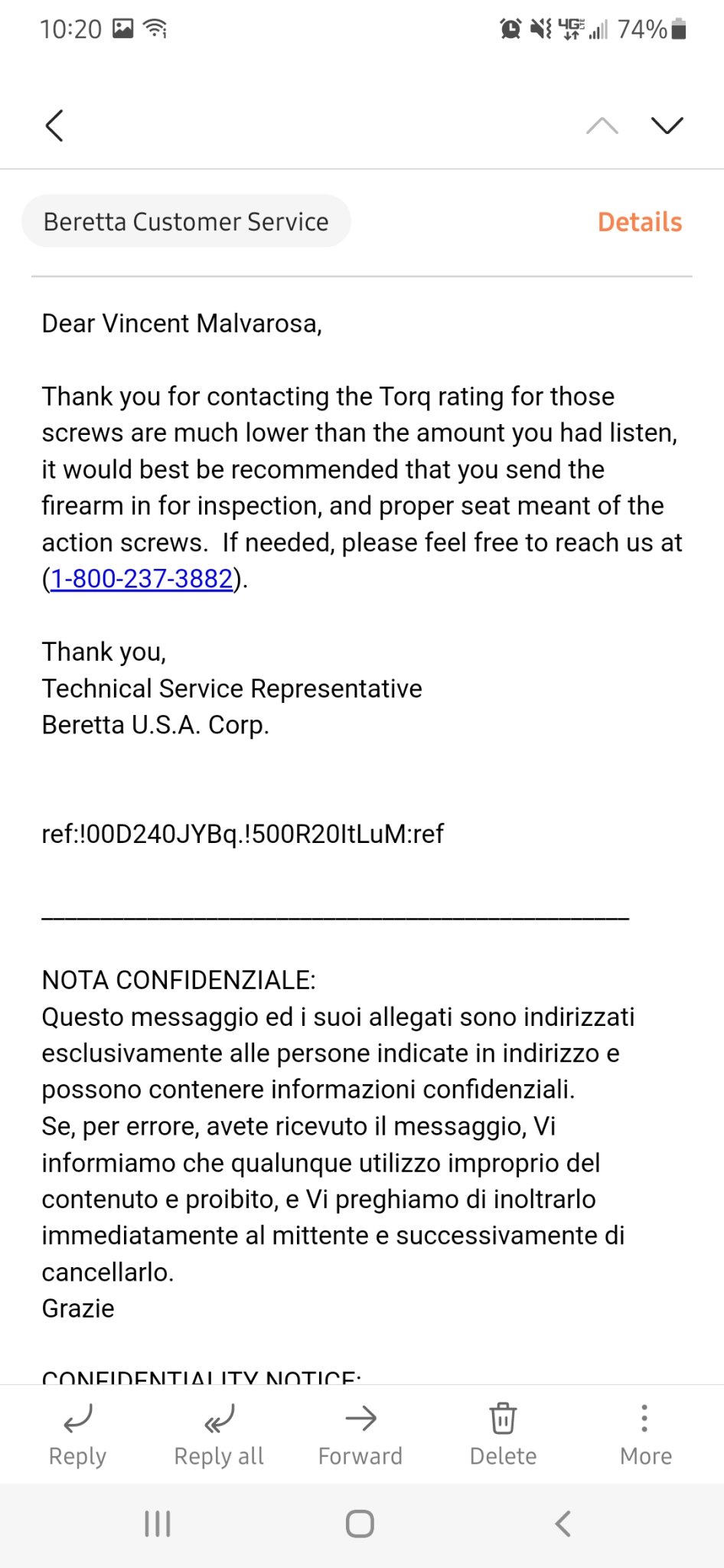

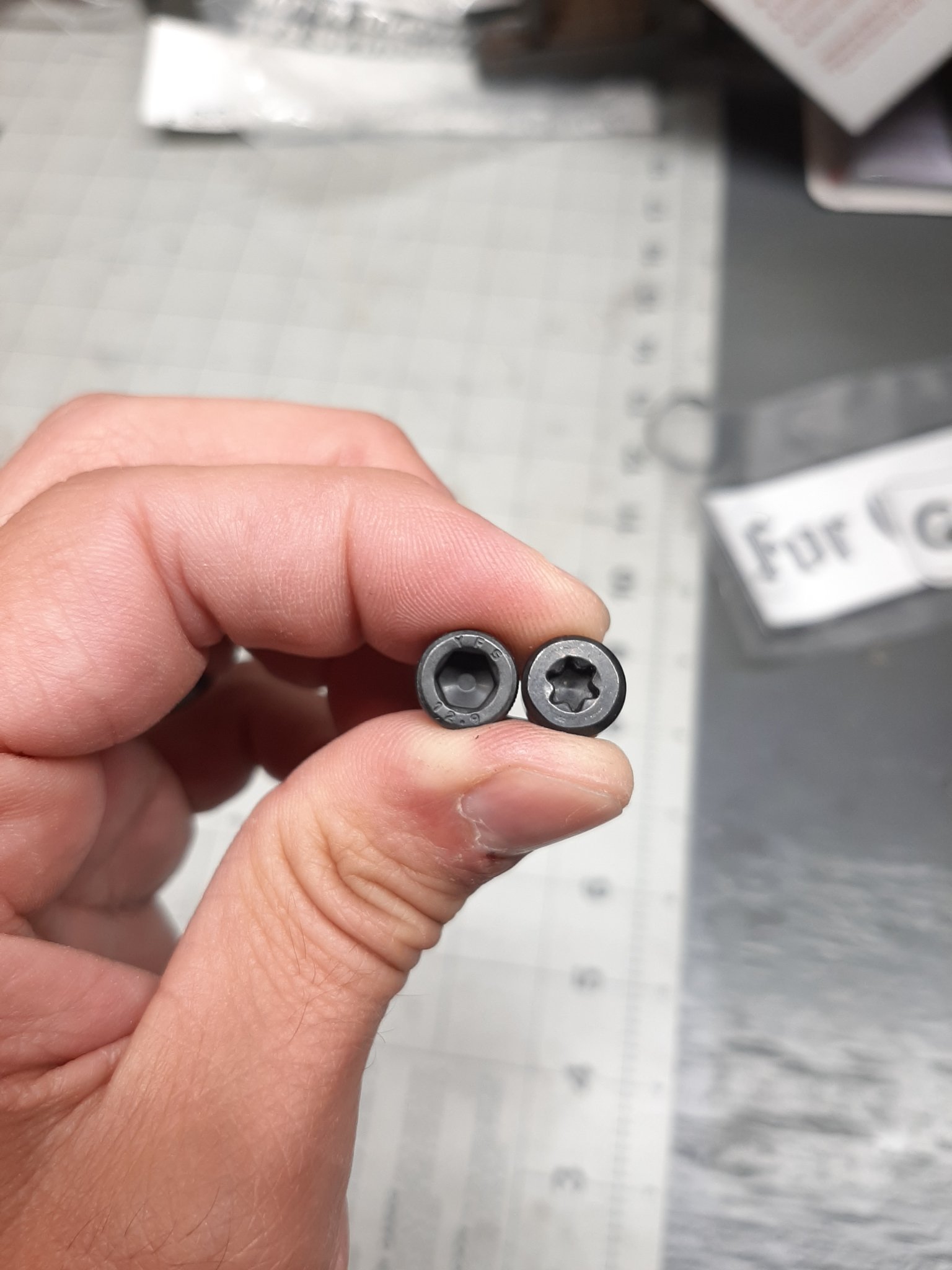

I'll post the pic I plan to email Beretta.
@CerebralDistortion thankfully I was able to back the screw out and no receiver threads damaged. I have good enough sense/ feel to know when I bolt is about to let go and saved it enough to not lose it completely.
You can see the crack a little better in the second pic and you can definitely see the stretch compared to a normal one.
As for the torque wrench I'm not going to pretend it's high dollar BUT I do take it into work and test it side by side with a snap on digital on a low end and high end of the rating a few times a year. It's never been close to 1ftlb off and maxing out at 80inlb, even if it was 1ftlb off is still under the 133inlb.
View attachment 8516541View attachment 8516542
Is there a "head stamp"(?) any kind of markings on the screw head?
Also. Standard torque for a 8.8 M6 screw is 10 Nm, ~7.4 foot pounds.

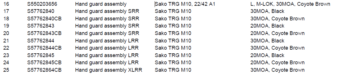

Are there different M10 forends? Saw someone mentioning you could get them with the same forend as the A1 series.
Just asking because i would like to use the sako bipod and noticed an adapter on the TRG 62 A1 Video. It looked better than the one from finnaccuracy. Seems like its from Sako maybe.
There are. Not sure which is standard nowadays, but I was under the assumption that the current M10's ship with a M-Lok fore-end.
The adapter on the video is indeed made by Sako and attaches to M-Lok vs. picatinny with the FA one. Don't know the part number but should be this one.
Exactly the info i was looking for. Thank you very much!

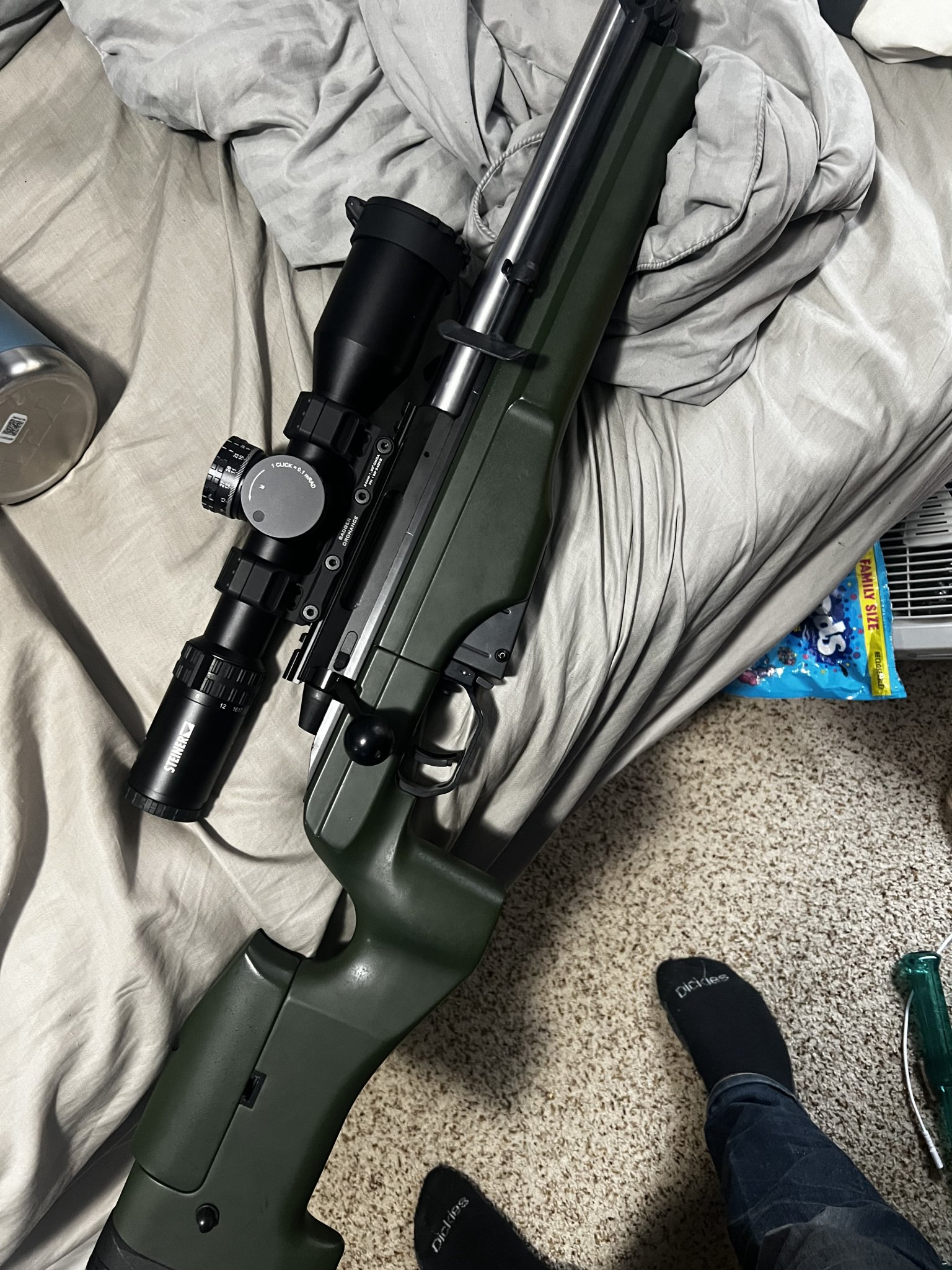

Just an fyi you can order m7xi for 2699 through b&h photo if anyone is looking for one I know many don’t like them. My new 24 sample is very nice. Not much optical falloff like some of the early ones.

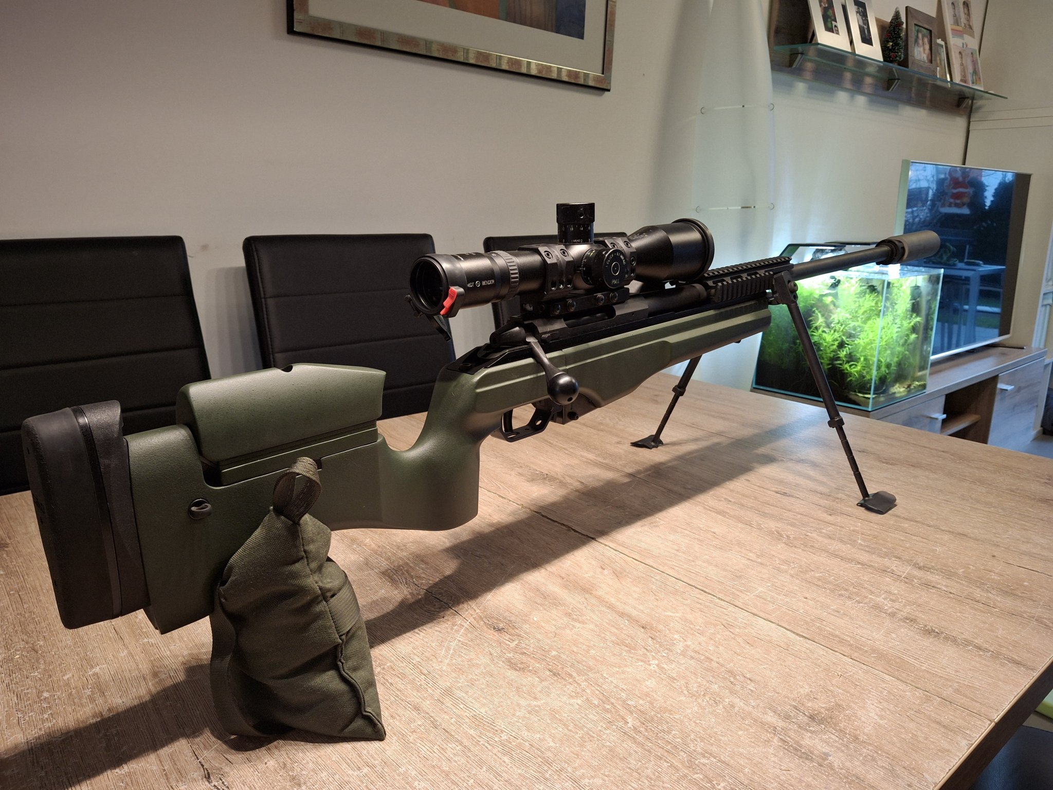

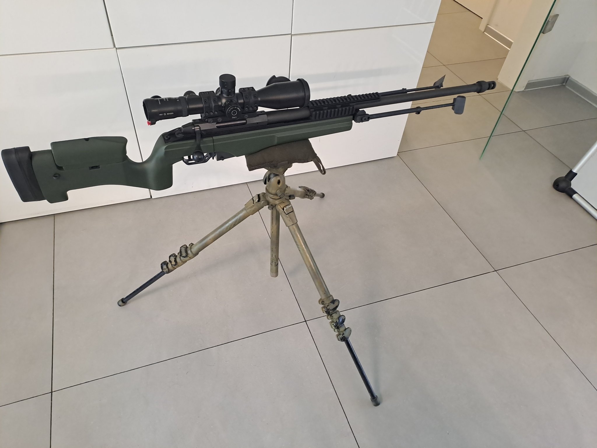

Ready for rattle can. This is the final configuration of my classic TRG 22.
PMII 3-12x50
ITRS rail for night vision
Spuhr Mount
ASE Utra SL7i

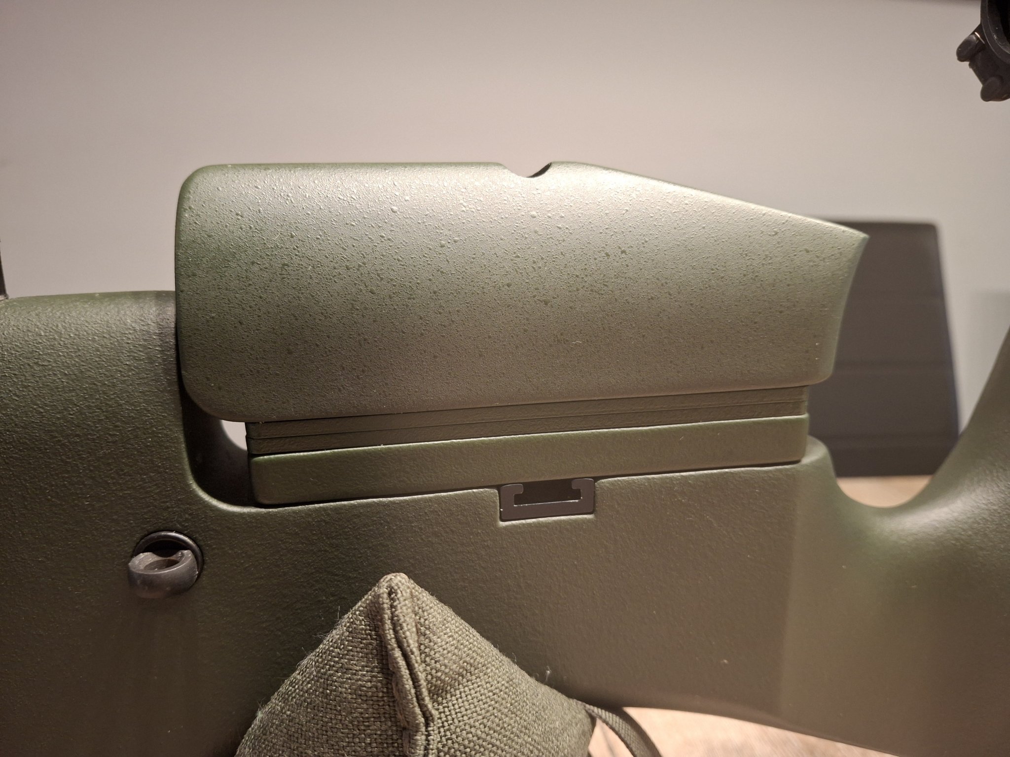

Went back and forth concerning adding more height to my cheek piece since i am unable to remove the bolt that way.
Tried it today and almost all my reticle jump dryfire problems i only had with the TRG disappeared. They were very few but i noticed them, beside neck fatigue.
Incredible what 2 small plastic pieces can do for your handling. 70 Euro...wtf, in the end it was worth it. Only had the big spacer before.
My go to gun for comps and hunting. Pretty much doing everything with that setup.

View attachment 8570423View attachment 8570424
Fellow planted tank enthusiasts i see!
3-12 isan excellent choice. Myfavorite scope ever.
Reactions: DKN83
The few cash that is left after shooting runs into aquascapes and shrimps🤣
The 3-12x50 has the best eyebox for me up to this day. Phenomenal glas!
What surprises me is the fact, that most TRGs i see even in military use dont even use a single spacer. Makes me wonder if my shooting position is weird or i am missing something...
