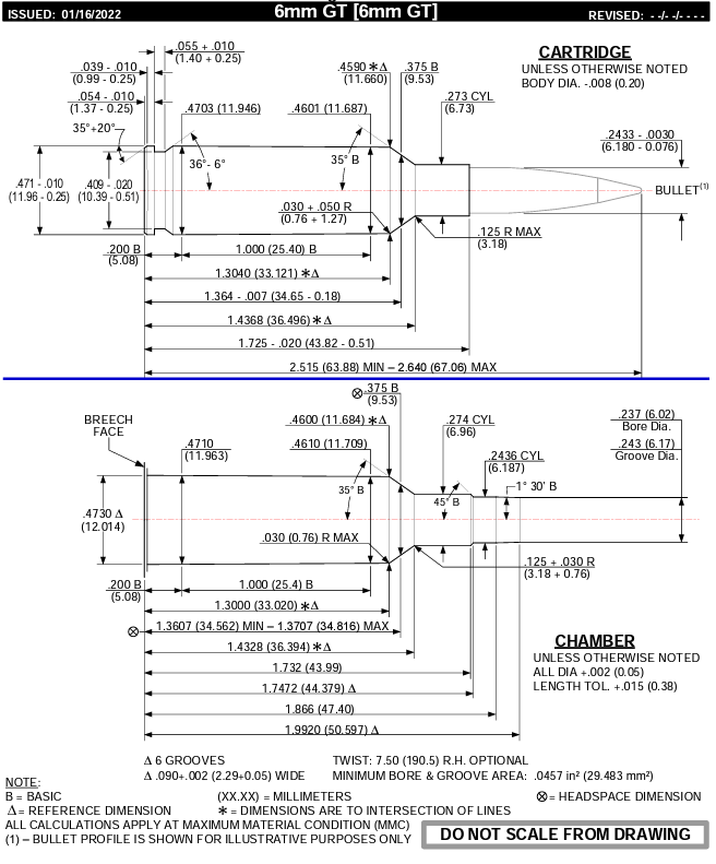

    6GT Alpha Munitions OCD brass. SAMMI recommend trim length for 6GT is 1.7250. In past attempts to trim with my Lyman, and admittedly having little experience trimming, I have a few at the recommended length, but others are at 1.760, 65 and 80.
    On the short side, I have some from 1.7220 to 1.7245.
    Is there an acceptable range, or should I try and be spot on? How might consistency possibly be affected being dead on vs. within the possible range?

    Look at the SAAMI spec drawing. Note the -.020 after the nominal case length.

    Thank you. Had this printed out but wasn’t sure what I was looking at. Looks like the acceptable range is 1.705 to 1.725 if I’m reading it correctly. I don’t imagine the difference in the two would be enough to have a noticeable affect on consistency in a PRS setting, or am I wrong?

    If you study reamer prints versus the SAAMI specs, you will see there is some variation in how much margin they leave for case neck length. Brownell's carries little tools you can slip into a piece of brass and force into the chamber that helps put numbers on that length margin.

    For now, try not to let them go longer than the MAX (1.7250) on the specs, and you don't need to go all the way down to 1.705 but it isn't like hitting a wall where your tune stops working.

    Your trim length should be in the middle of the SAAMI spec range; e.g., 1.715 inches. With practice, you should be able to trim consistently and quickly to within plus or minus a couple of thousandths of your target length. Make sure you resize your brass before trimming, and annealing after a few firings is beneficial, if not required, for best case life and velocity consistency.

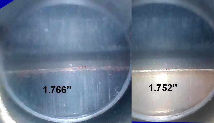

    What I would say is most important is to trim to a consistent length, as there are a couple of things to consider, besides the SAAMI specs.
    If trim length varies by quite a lot, one can have an issue with the carbon ring building up. Let's say most of your brass is trimmed to 1.725 and as you fire them where the carbon builds up in from of that. Then you chamber a cartridge that is 1.765 where the carbon ring has built up substantially, that carbon ring can cause the mouth of the case to pinch the bullet causing a spike in pressure that can be seen on a chronograph as significant increase in velocity. It's not necessary a safety hazard, but more of throwing your shot off because of that increased velocity. On the opposite side, if most of the cases are long, the shorter ones will not have this issue.
    When a cartridge is being fired, the case begins to expand and the bullet begins to be released and as this process at its early stage the blow-by increases a lot when when the bearing surface clears the case mouth and chamber pressure rises rapidly. The timing of this is effected to a small degree for the difference in case's trim length. The effect is a small thing, so whether it's important to you or not depends on what discipline of shooting you do (like competitive bench rest shooting vs just hunting).
    The trim length you decide to use can depend on what bullet you're using and how you intend to seat them. Trimming them long helps with the seating the bullets longer (an issue that can be important if one has a rather long freebore). But, you don't want to let them get too long so that there's room enough for variance between the freebore length and the case length.
    I like to keep my cases .010 short of the maximum length of the freebore so there's not so much carbon ring surface to clean out AND I tend to load all my bullets long in a long freebore. Since consistency is very important to me, I trim my case to length every time after sizing.

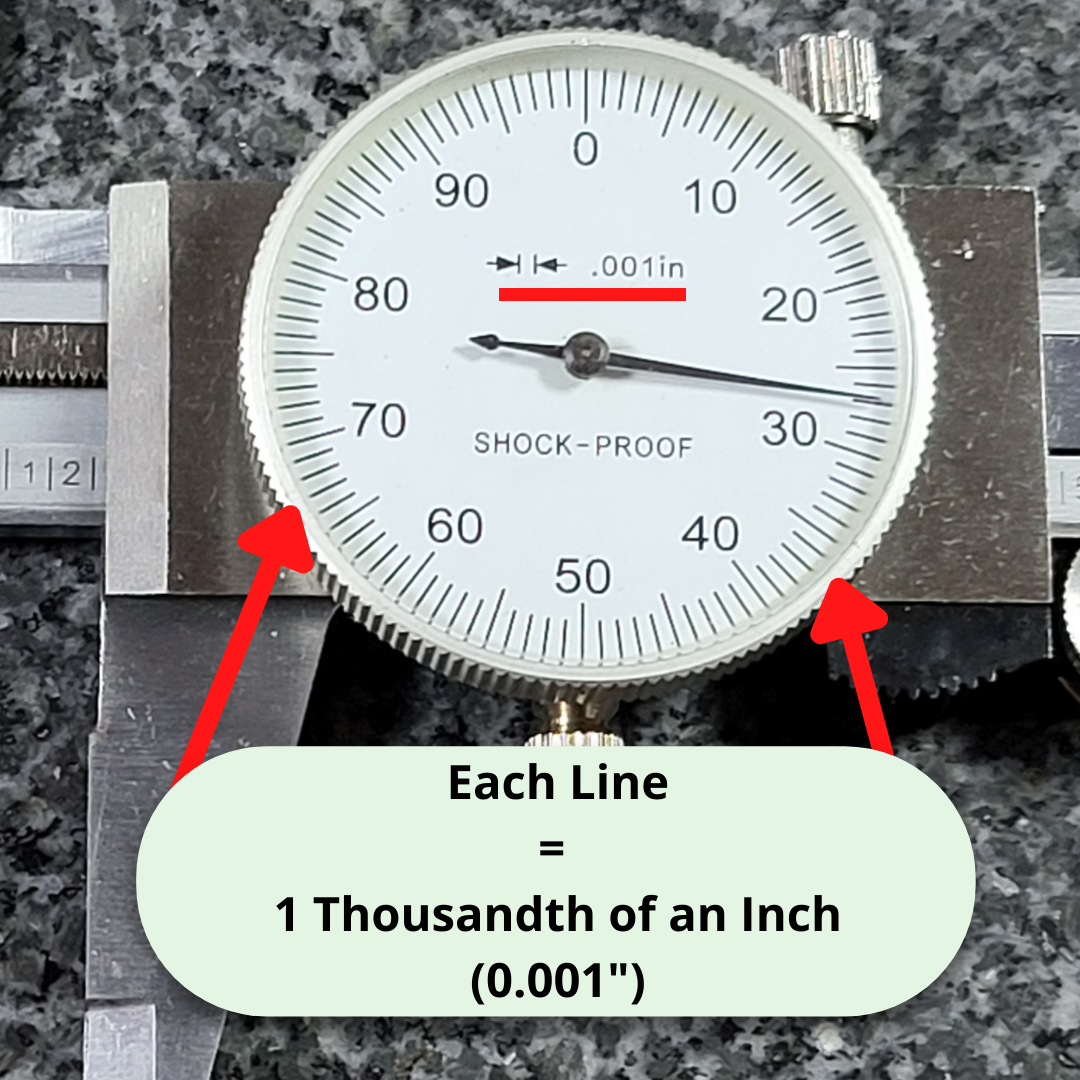

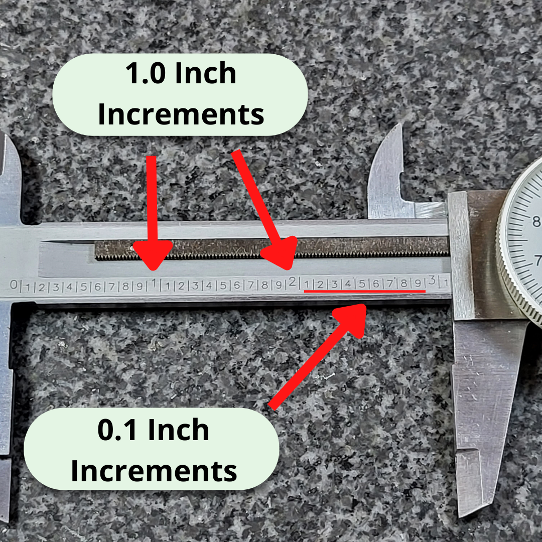

    The 3rd number is thousandths. (.300) a decent dial caliper should have no problems reading that to the single thousandth. The 4th number is ten thousandths. (.3005) Dial calipers are not designed to read that, you need a micrometer. In any case, going finer than a single thousandth I wouldn't imagine would be necessary.
