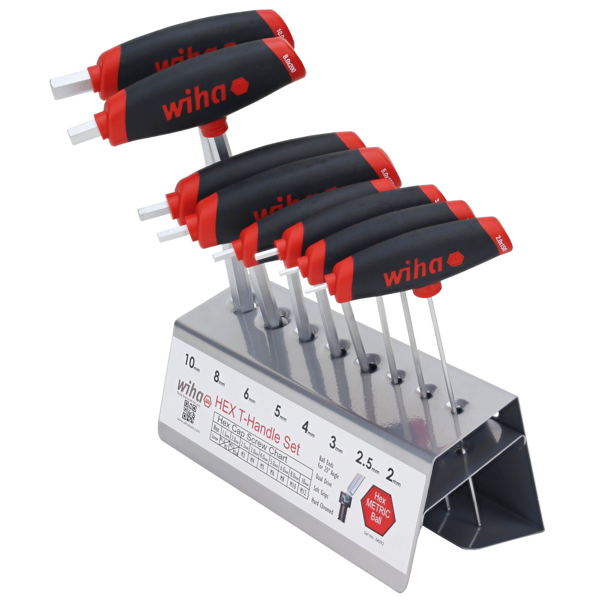

I have a set of Bondhus ball end drivers and a set of Wiha ball end drivers. The Bonhus are cheap and junky. Being made to size is the lowest hanging fruit. The Wiha are more durable without being torsion springs whereas about half the Bondhus ball ends are broken off.

I have T handles too. The point is that Bondhus isn't very durable compared to Wiha. Wiha makes T handles also, and I'd take them over Bondhus all day. Bondhus is effectively a low cost Amazon brand which is laughable if Snapon is using them as a supplier.
