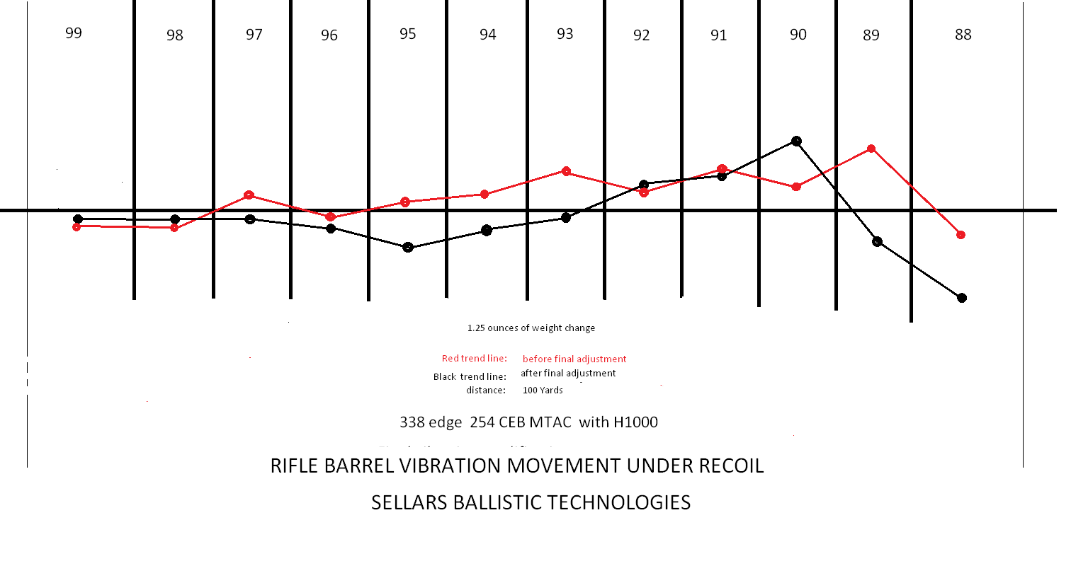

Alex, A heavy weight on the muzzle can increase accuracy and it can decrease accuracy ,but does not necessarily create less amplitude, sometimes it can increase the amplitude ,I am referring to weight in front of the muzzle. The weight behind the muzzle leverages the muzzle differently. The weighting in front of the muzzle is delaying a reaction at the muzzle so the angular bending which naturally wants to bend down when the rifle assembly bows up in the middle. Lets address some of the things you mention but I am primarily speaking of the modes that will effect poi and after ignition and before the bullet exits. Anywhere from .9 MS to 1.8 MS. You mention harmonic bending with frequency. I agree there is no single plane in High frequency vibration which is the vibrational mode driven by the case slapping the chamber wall and bolt lock and pressurization upon firing. This is a powerful transverse wave that will hit the muzzle approximately 7-8 times before the bullet exits. If the high frequency is at the muzzle upon the bullets exit it will create a random dispersion , I have found this to be true upon testing a specific powder charge the groups will open up excessively in a random dispersion pattern. If this high frequency is at the muzzle when the bullet exits then the bullet can actually carry some of this high frequency with it causing some slight instability with it but the primary effecting factor was the muzzles extremely high cross tracking velocity created from the high frequency. This effect was also noted with 16 inch naval guns in a white paper report I had read from a Navy lab. The fix was to simply change exit timing or velocity. On a rifle this would mean a change of .5 grain on a 300 Win Mag would change the exit timing enough to exit at a time with a stable muzzle and with a much slower cross tracking velocity , so there is a window of exit time that the HF will not be there so then that mode is completely non effecting on the poi. As to the second mode which is the forced deformation driven by the recoil force combined with the weight offset of the rifle. if the stock weighs 5 lbs and the scope and mounting weighs 2.5 lbs then the amplitude of the bending will be enough to see it bending around the heavy side. it will bend around the heavier weight bolted to the barrel action assembly. This mode is vertically oriented foregoing torque as a very small factor in the horizontal and does not have a frequency necessarily , sometimes it resembles a frequency but other times it is erratic from one movement to the next depending on the weight . This is the movement that a tuner will correct or make worse and is why it is vertically oriented. Here is graph showing a very wide window of the vertical movements showing poi change which is a direct trace of the barrels movement though various exit times. This was under highly controlled conditions. A weight change of only 1.25 ounces changed the pattern noticeably smoothing out the movements . The cross tracking velocity of the muzzle is very slow while moving up [gun shoots well] but when the muzzle is moving down the cross tracking velocity is about 5 times faster affecting the bullets stability as well. so reducing the downswing is good , certain weighting can also tune in a parallel muzzle pattern if desired even with thin barrels. A adjustable weight will speed up the pattern by moving the adjustable weight rearward and forward to slow down the movement relative to the exit time of that bullet. The weighting 3-8 inches behind the muzzle I would suspect will have much less of a effect but I have not tried it. This graph is the only way to accurately measure movements of the muzzle as of now but if you can do it with piezo sensors and relate it to the target it would be interesting to try it.
do you speculate that muzzle weight is shrinking vertical dispersion,
or it shrink dispersion in every direction because of high frequency vibration, so it will shrink whole group?
Both . I have not measured the specific amount of reduction but bear in mind the high frequency is only at the muzzle at one particular exit time within the whole loading range of powder charges , so if the groups are excessively large to begin with then the weight would help , but not eliminate the dispersion . The only way to know if it is in fact HF at the muzzle is to change the powder charge a bit to confirm , if the groups are considerably smaller upon the powder charge change ,then go back to the bad powder weight then add weight to gauge the amount of reduction .
timintx
Alex, A heavy weight on the muzzle can reduce accuracy just as it can help it but does not necessarily create more amplitude, sometimes it can reduce the amplitude.

I actually did say reduces amplitude. I don't see a physics mechanism that would cause it to increase amplitude other than chance constructive interference by causing different harmonics to overlap. Even then, the additional mass would probably overcome even that.
You mentioned having the weight backed off the muzzle. I saw a 50 caliber gun with the tuning weight that simply clamped down on a bull barrel with 4 bolts. In one case the guy had it about a foot and a half from the muzzle to get the desired effect. Again, this was a weight that looked to be a few pounds of steel. Heavier barrel is going to take more of a change in mass distribution to alter the harmonics that a pencil barrel.

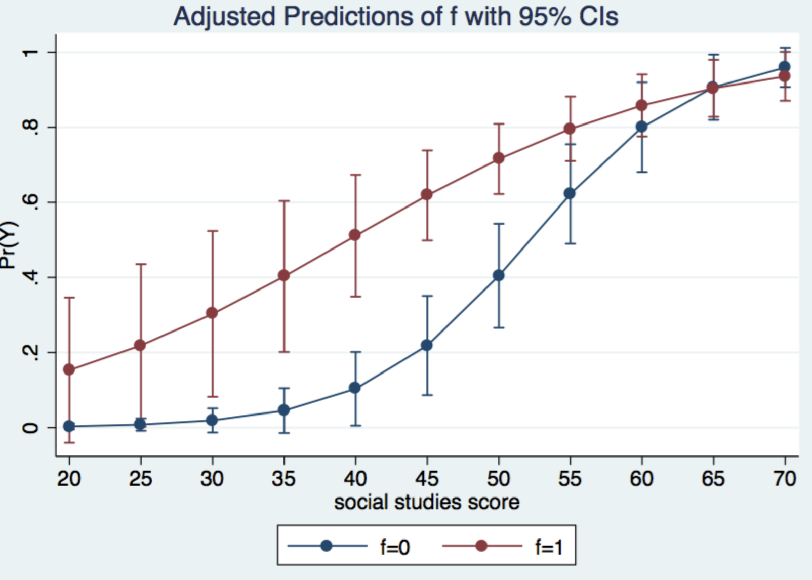

Can you show error bars on your graph?

Sorry I said it wrong , I flipped the words around wrong ,the point was it can increase amplitude not just reduce it . This has to do with positioning of the weighting . Not sure what you mean by error bars . The gun was extremely accurate in loads and barrel though . And conditions were highly controlled . Yes lasers could possibly measure but you have to separate the various movements and relate them to the target which is a tough one to do . No military labs could do it . But I am still looking for a way to do it .
timintx
error bars per data point show the (usually) 95% confidence interval. When comparing data like this they are good to demonstrate that the difference is real. When the error bars for two data sets overlap then it is a good sign that the differences may not be real.
