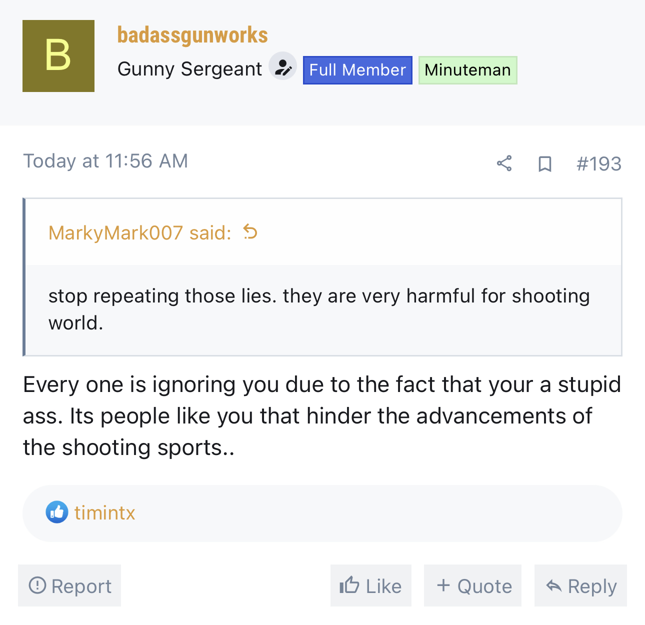

Every one is ignoring you due to the fact that your a stupid ass. Its people like you that hinder the advancements of the shooting sports..

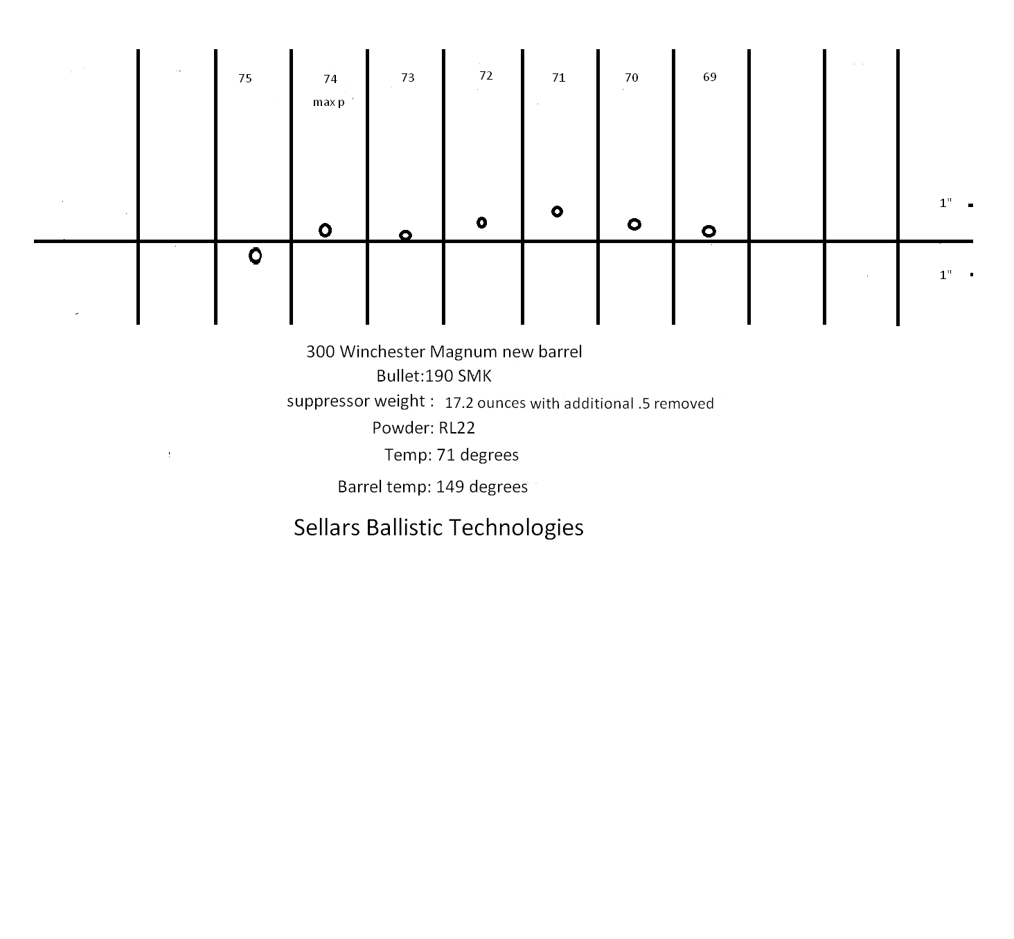

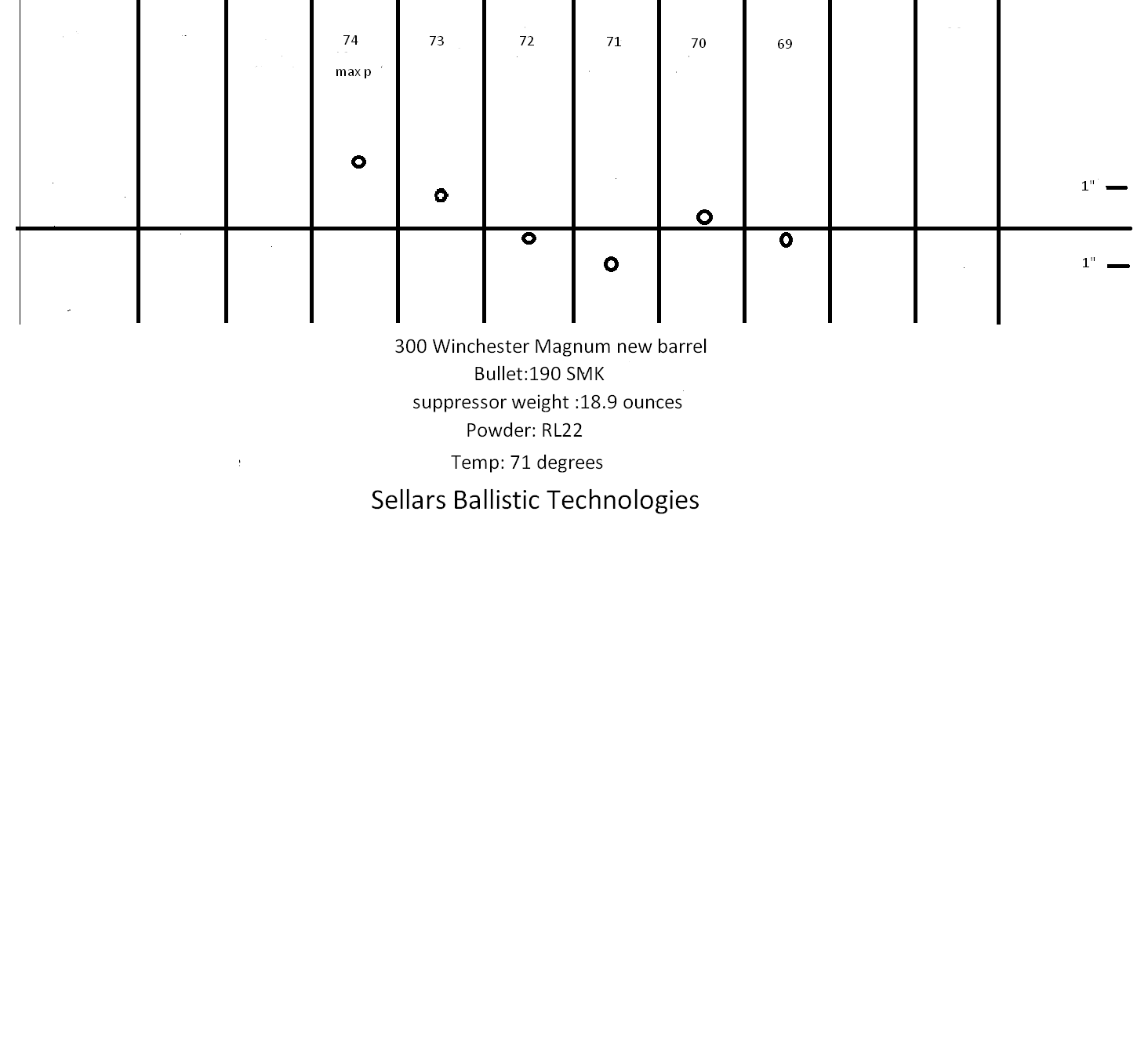

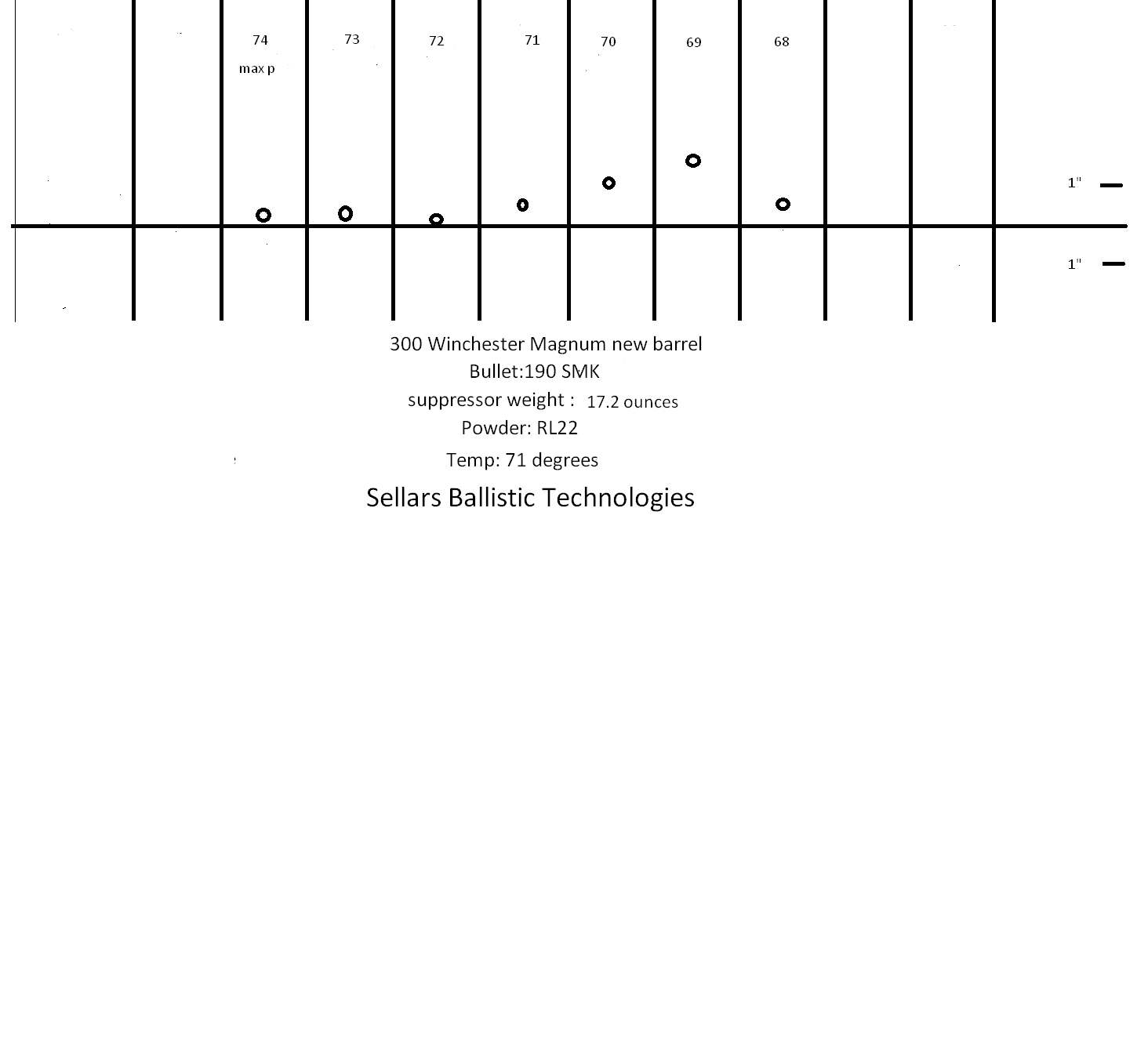

Phiegethon here is a example of too much weight on the barrel and heat on the barrel as well , the first graph shows a sharp downswing of the barrel which will cause excessive vertical because the barrel is moving sharply down as the bullets exit. Most guns have this negative compensation. We want to reverse that movement at minimum level it out , after a weight change on graph 2 we have positive compensation where the slower bullets are exiting higher at a specific rate , the normal load exit time is at 71 grains which remains unchanged with a hot barrel indicated on graph 3 ,but the slower end or right side of the pattern flattens out. if I were exiting at 69-68 grains area setting a tuner it would have changed after 8 shots or so depending on the ambient temp which determines how fast the barrel will heat up in a given amount of shots, so I do not shoot back to back groups ,instead I will shoot 5 graphs with one shot in each column to manage the heat factor .The barrel is cooled between the graphs and they do repeat now I know how they change which helps and I know that my normal exit time or load is not effected by this change.
Timintx

are you now saying that tuner can correct internal ballistic?
first: positive compensation does not exists. second: our best commercial chronograph (labradar) is ±0.1% precise = ±! 3 fps at 3000fps MV. ~6 fps interval in which you dont know what is REAL velocity.
When something changes unexpectedly I will stop and find the variable before I continue . With that said , when I ran ladder patterns , the patterns changed , why ?barrel temp . Every ladder I test with the exact same barrel temp . When I shoot the ladder I am shooting 1 shot of each powder charge side by side with each shot logged in with the barrel temperature .Then the barrel is cooled completely to maintain the exact same temp throughout the next ladder . Once done I will overlay all 5 graphs for and average to gain confidence in my test with low round counts .

I think the shooting sports are more hindered by those who bring insults instead of data to discussions.
