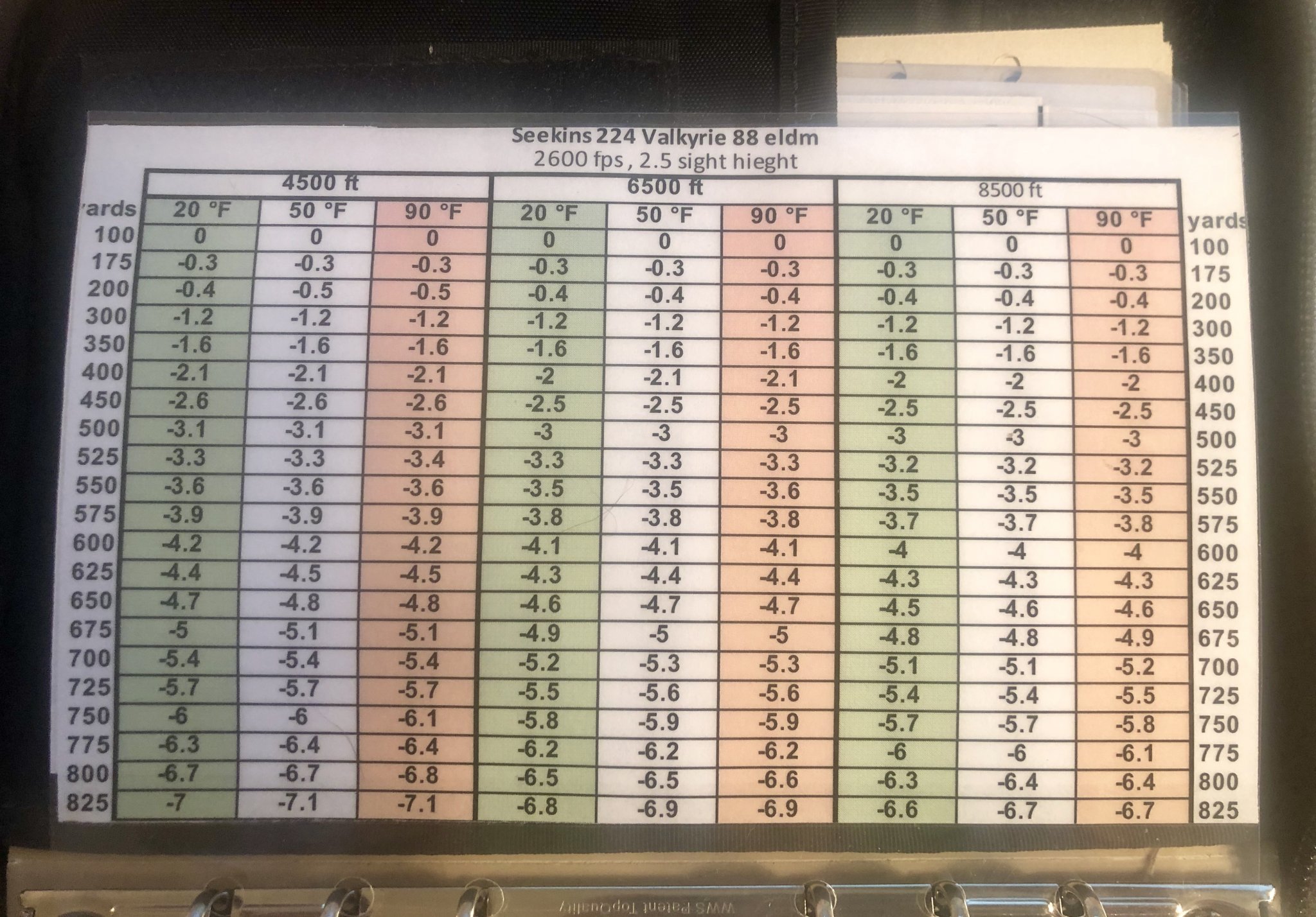

There’s really no way around verifying your dope cards other than sending bullets downrange. It either hits or it doesn’t. I’ve always just printed off a good number of them using JBM to get a range of cards, found the ones that line up best, clearly label and laminate. Do the same for every new locale you can shoot in, and be sure to record all pertinent info.
Used to be, you’d see shooters with dope cards taped to their rifles, and that was the norm. There are other ways to do everything, this is just what I did/do.
Ballistic computers have made this stuff a hell of a lot easier.

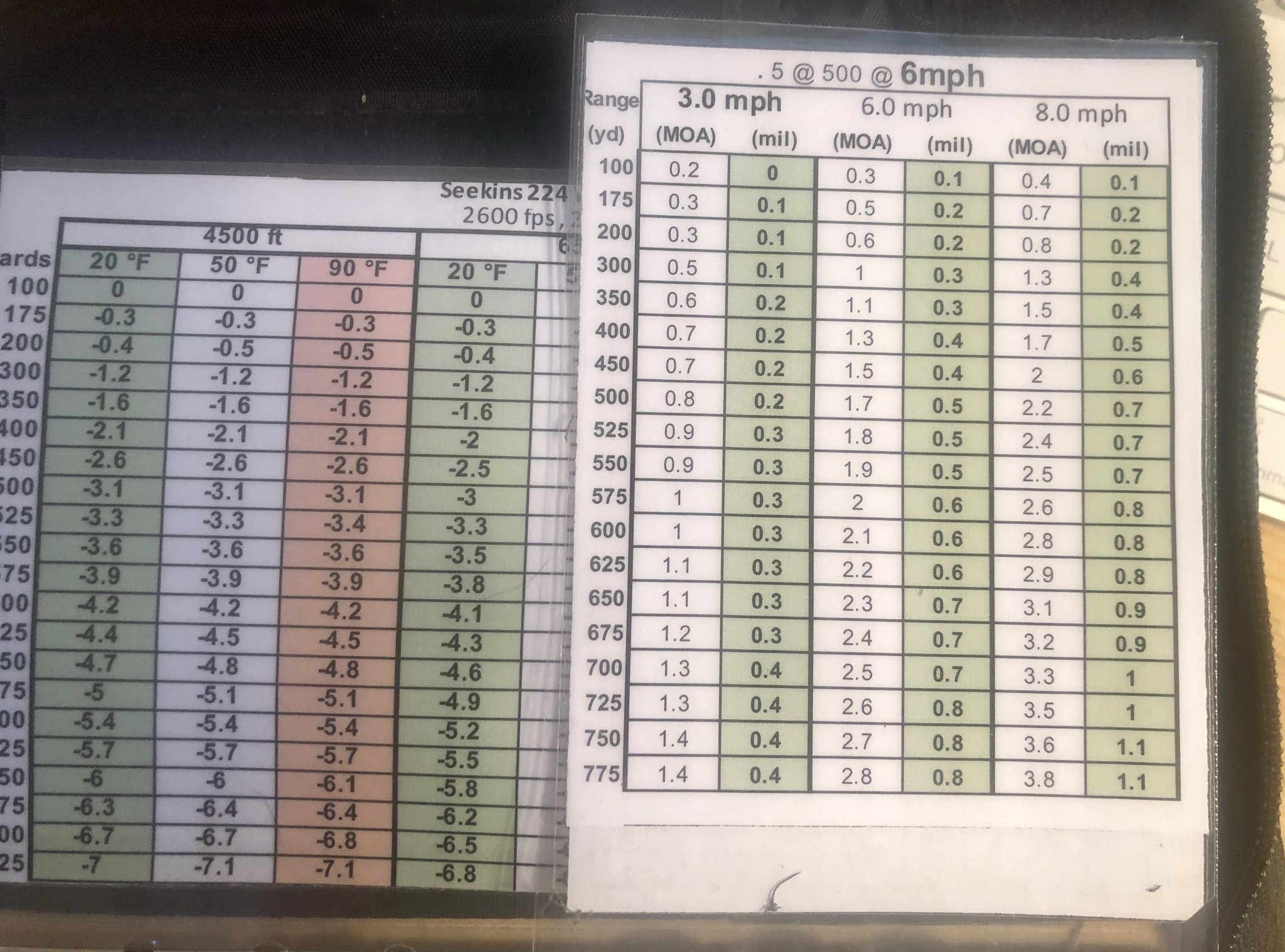

For club matches I use a dope card that has multiple elevations and temps. I created it in JBM use trued data for one elevation and temp. I keep updating with actual dope over time for other elevations and temps. For bigger matches I’ll creat a custom card based on actual predicted weather.
I keep a wind chart for different mph guns in MOA &MIL helps if calling wind for others.

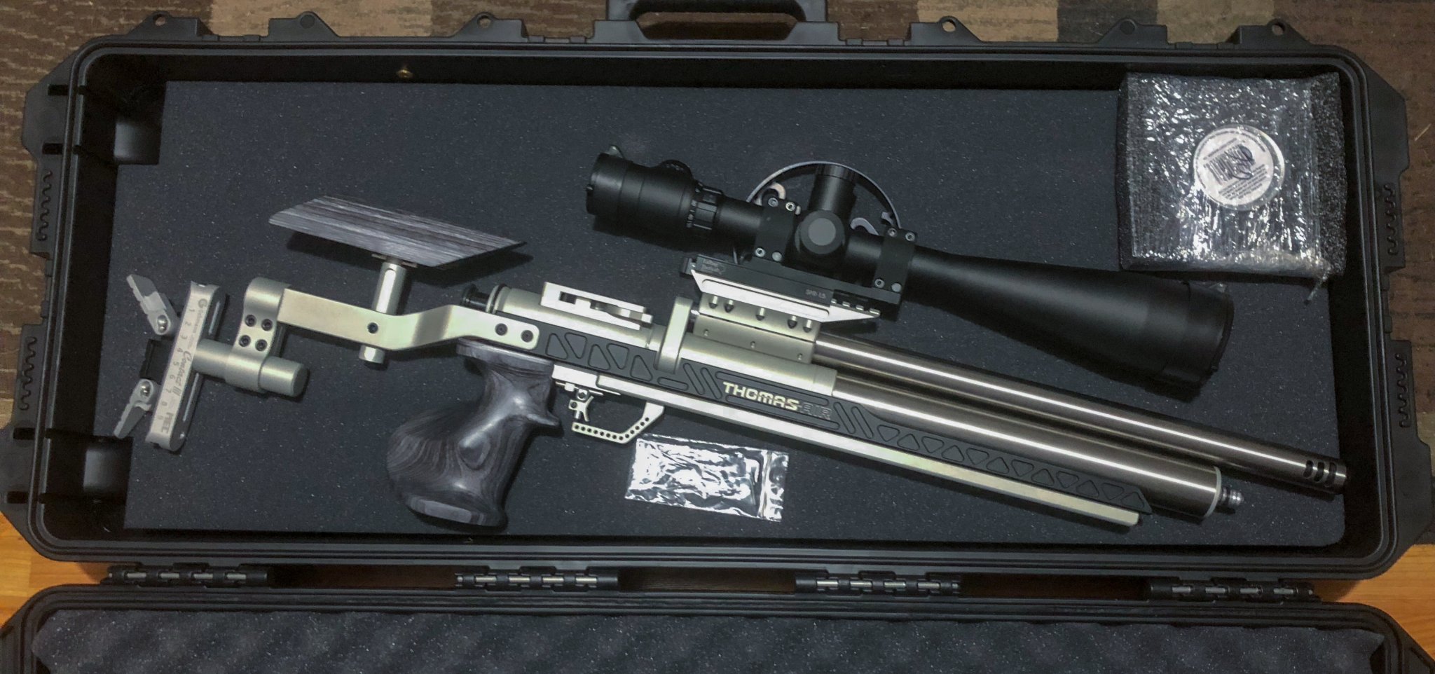

If permitted in field target, which does not allow laser range finders, I think the ASLI may make a good addition to my FT rifle, shown below.
The main issue is that focus ranging requires a labeled focus wheel like the one shown below, which is mounted on the left side of the scope. I think it would get in the way of mounting the ASLI. Suggestions?
