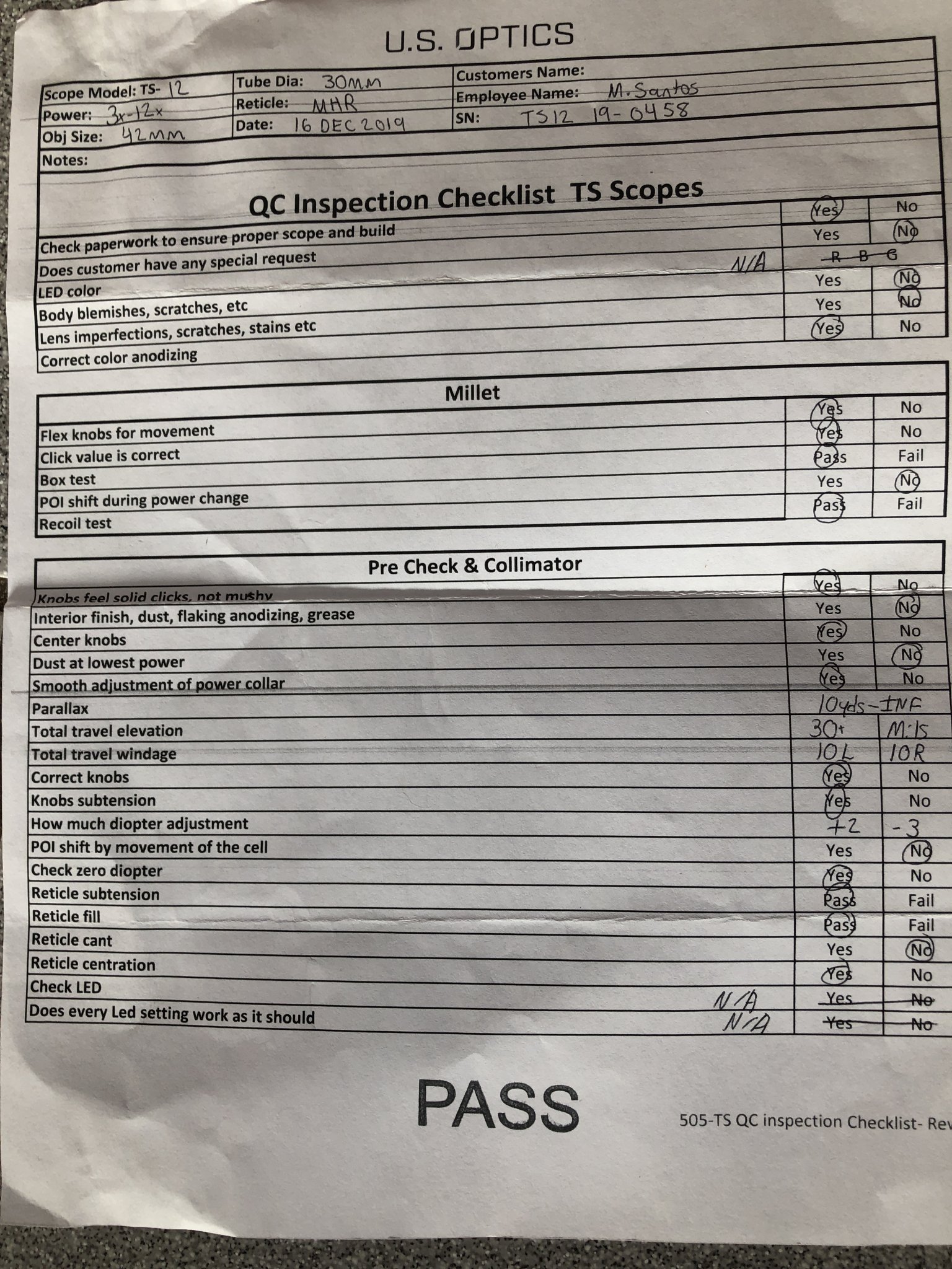

This is the uso checklist that came with the scope. Fit and finish, attention to detail and quality control is super important. If uso has an employee actually do these tests seriously, it can make all the difference in the world. Definitely worth the expense of being gone over by a pro. That’s what we shall see with the vector. I will give 3 strikes
Reactions: Frankr
I wonder what percentage of these USO returns back to china? How does that work with a scope that is defective from the original manufacture, do they replace it with another to USO?

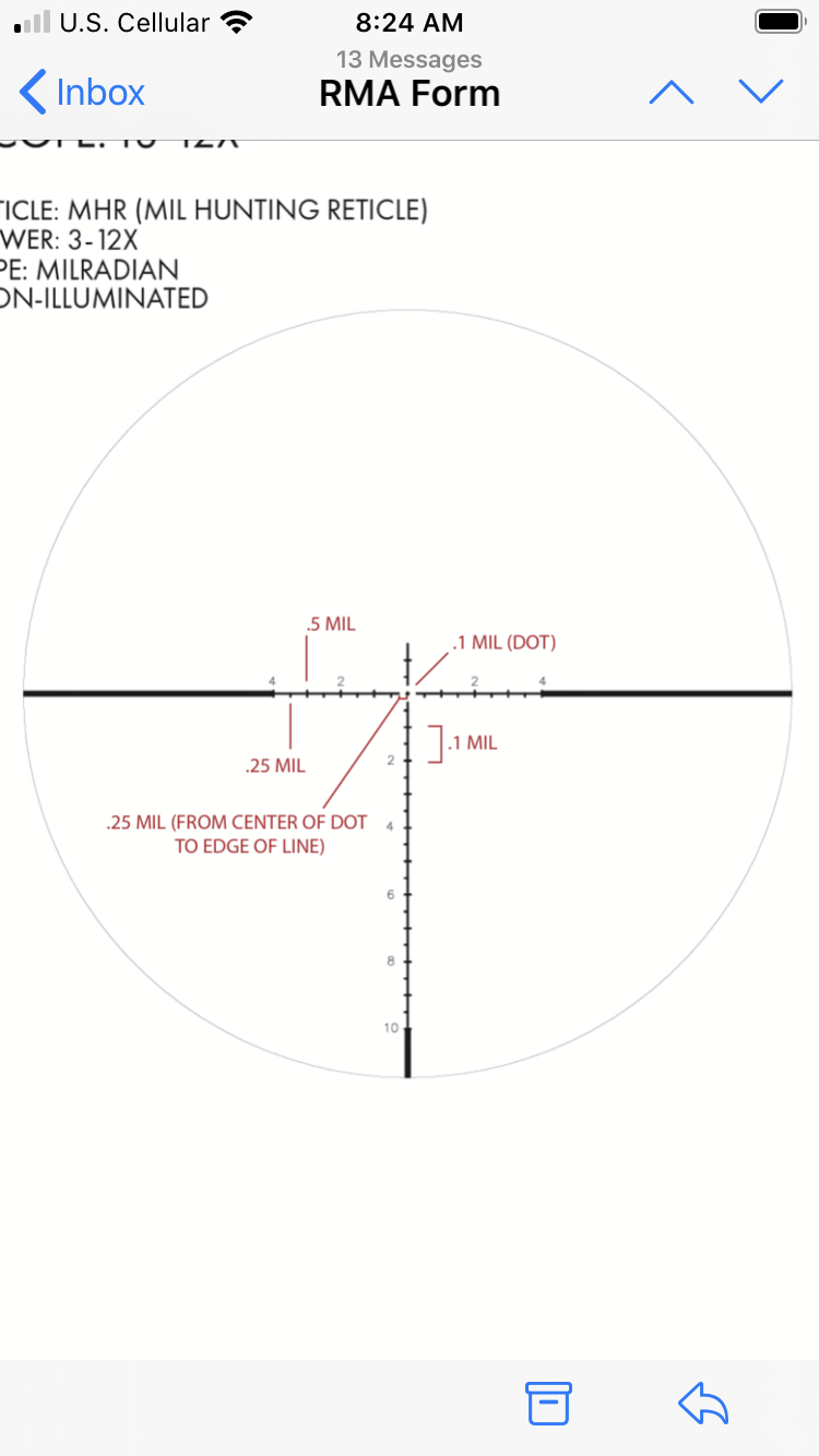

I like it a lot so far except for the fact that I can’t get any information on what the reticle substensions are. I’ve been shooting at different distances between 25 and 310 yards, with repeatable results clicking around with a .22.

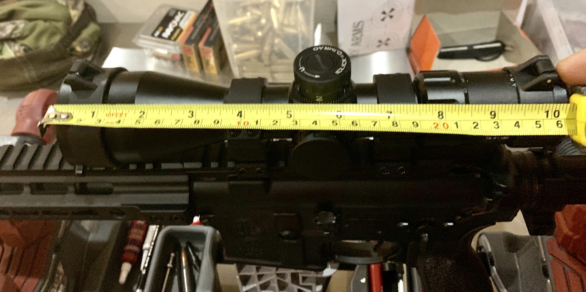

It is more challenging to mount a scope that short. I cut the front off of my 419 mount off, so I could mount it lower.
I have two questions for anyone with one of these in hand:
1. Would you be willing to post a picture of the scope alongside a ruler? I want to see the length of the mounting surfaces.
2. Does the elevation dial have a rev indicator?

I really like the scope so far, except for the fact that there is no zero stop or way to tell how how many revolutions have been made. USO sent me the reticle substensions. This is a nice hunting reticle.

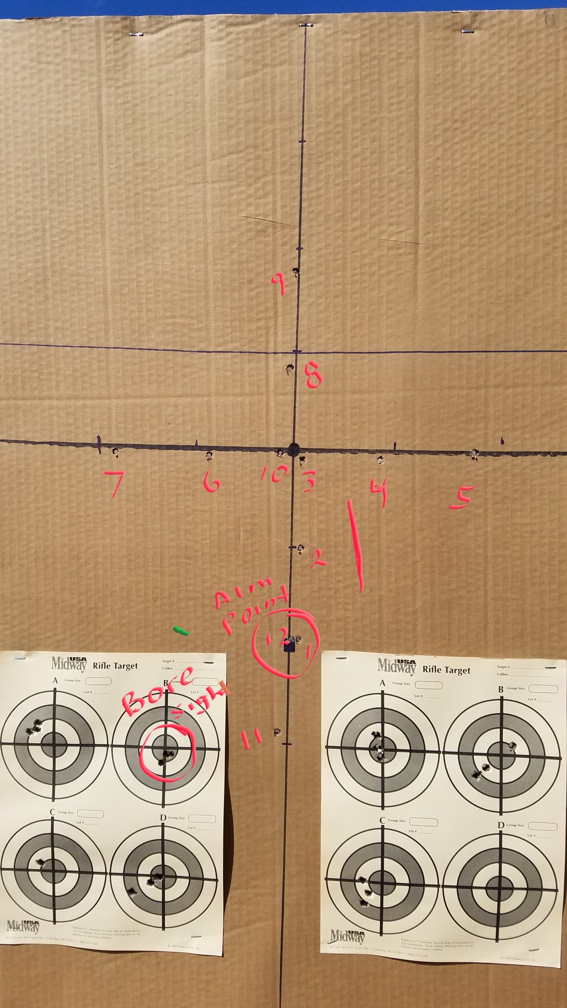

Got to spend some time behind one today and did a tracking test for @TampaBud
The first thing I noticed was the clarity and resolution.

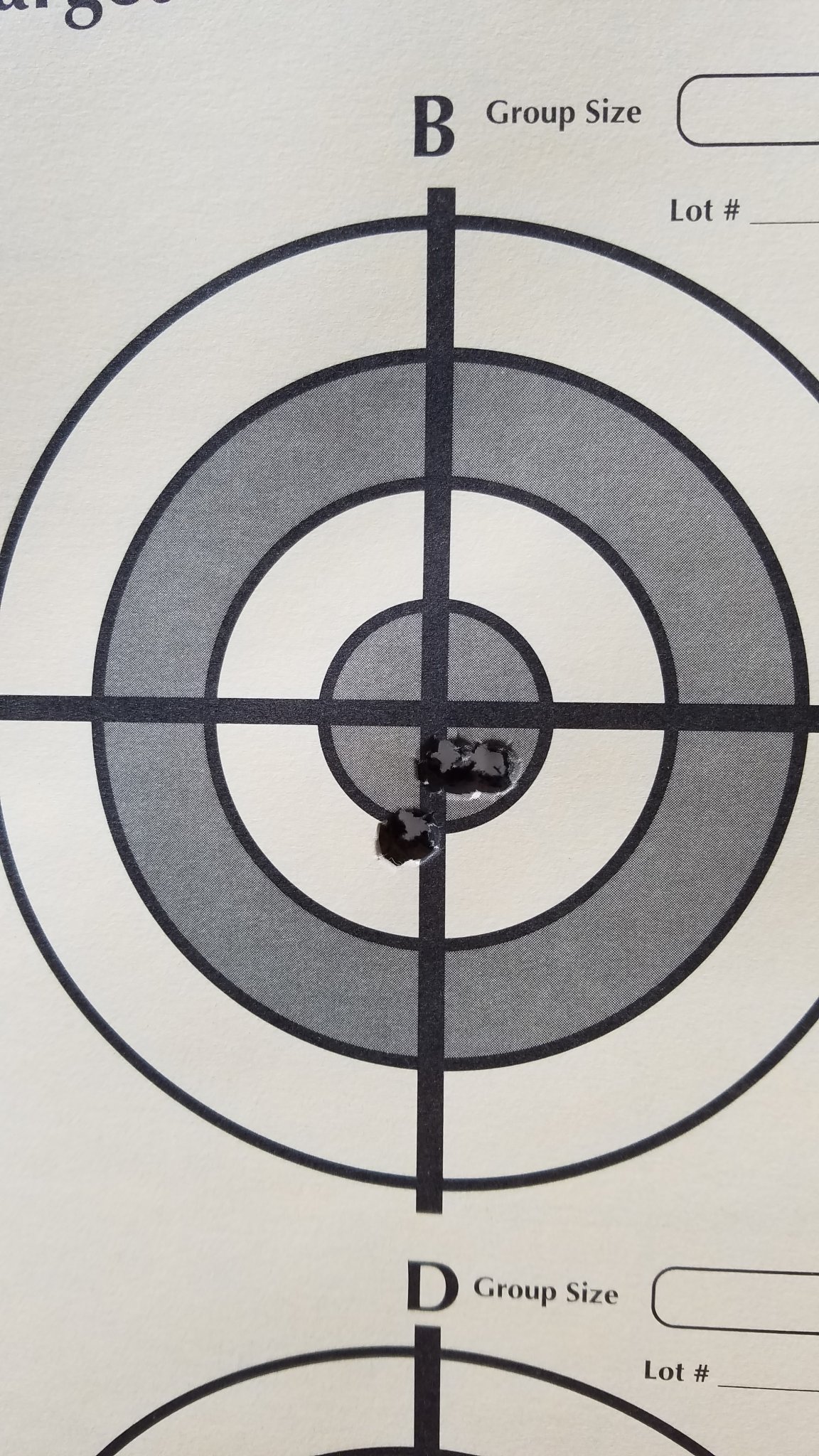

Bore sighted the 6 BR at 96yards and these were the first three shots.
Made the correction and went to the tall target.
Since it wasn't exactly 100yds, the sub tensions on the reticle didn't match the lines I drew on the cardboard.
No biggie, since I had the same issue while testing my Ares BTR.
The winds were 7-11 mph so there is some impact point error. However, this scope tracked exactly how my Ares tracked and the bullets landed on the sub tension lines/marks that were shown by the scope.
I shot 12 rounds and held only on the aim point of the first round.
I'd say it's very good at tracking, I just needed a true 100 yards for the reticle and the target to match.
Also note that it finished right back on the original POA.
I'm impressed.
Btw, the other targets stapled to the bottom have a bunch of 6.5 holes from testing a Remington that seems to have bedding issues...
