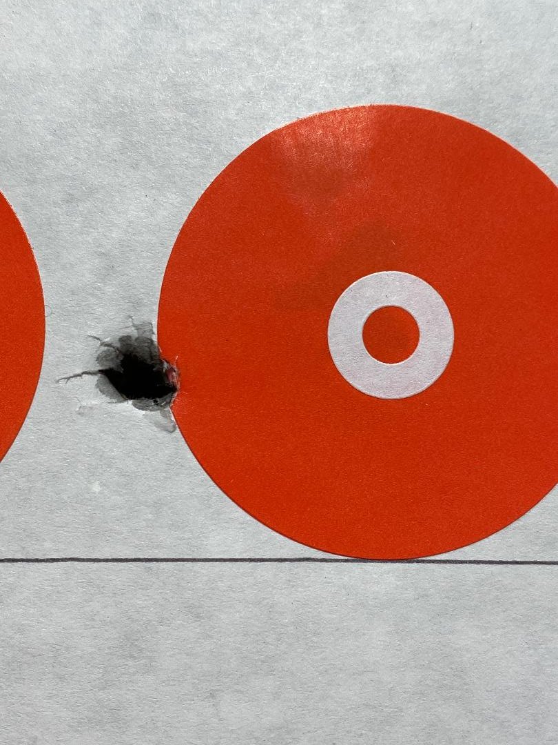

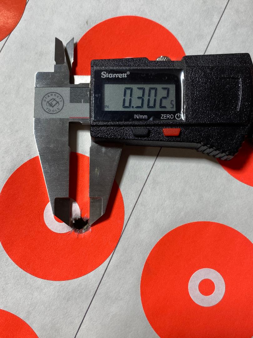

The Vapors shoots darn good as the Hybrids for me, during fireforming Lapua brass, it shot into the .1's @ 100 with virgin brass. Tested at 725 yards, shot into a 1.75 inch group on steel. After fireforming all 200 pieces, I redid the load development, added an extra grain of powder and shoots .060" @ 100. Going to order 1000 bullets from Tom. A little cheaper than Berger Hybrids, after finding a sweet load, I may not go back to Hybrids.

The Vapors shoots darn good as the Hybrids for me, during fireforming Lapua brass, it shot into the .1's @ 100 with virgin brass. Tested at 725 yards, shot into a 1.75 inch group on steel. After fireforming all 200 pieces, I redid the load development, added an extra grain of powder and shoots .060" @ 100. Going to order 1000 bullets from Tom. A little cheaper than Berger Hybrids, after finding a sweet load, I may not go back to Hybrids.View attachment 8375441
How fast are you running them?
nice groups. what caliber? and have you tried longer distances?
