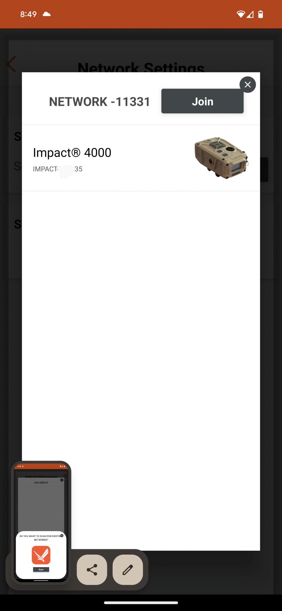

However, my unit displayed two new issues in the cold.
1) after ranging, I would get the range and then a few seconds later the screen would update again to give me the hold. BUT, there were a handful of instances where the HOLD WOULD NOT UPDATE. I would have to range the target once or twice again to get the data for the hold to show on the screen to match the distance.
2) Likely not a cold weather issues, but my unit kept syncing to my buddies phone. He also has a unit. The only reason I would catch it is I would range at 1110yds and get a hold of 11.3 mils which was wildly different than the 9.9 mils I had shot it at 20 minutes prior.

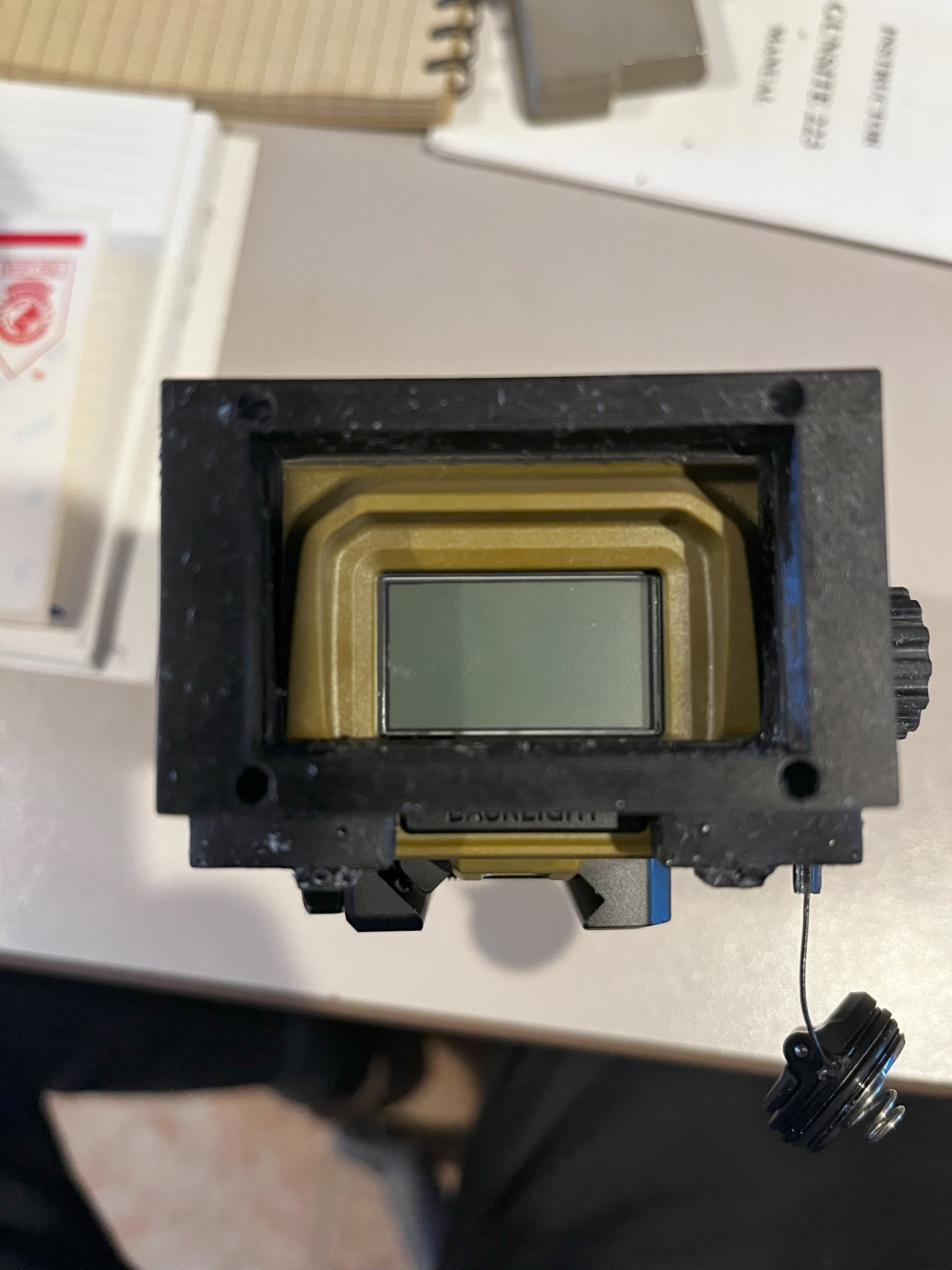

If there’s a way to have some sort of seal to keep light in the cavity that would be awesome. Some type of low density rubber or similar comes to mind but I’m not an engineer
I was thinking a simple O ring to make contact would seal it fine, otherwise some adhesive backed foam.
@CoryT I think that idea has a lot of potential. I’m using the film over the display, but it is a PIA during the day. My stands for yotes begin in mid afternoon and I then roll into the night. I’d like to see the prototype, but I am most likely in for two.
I just couldn’t get the film applied to my liking. I was used the LED dimming stickers, but getting them cut properly and mounted without air bubbles was trying, but do able. The hard part was just reading the display during daylight.

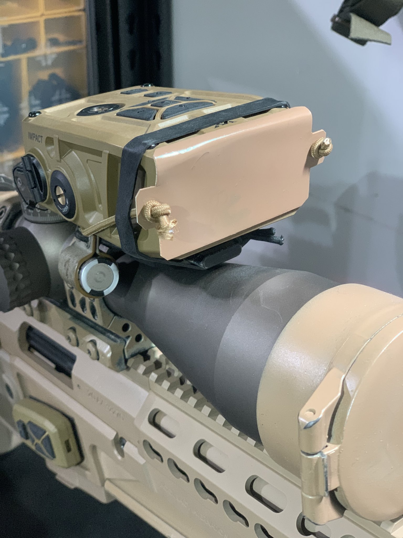

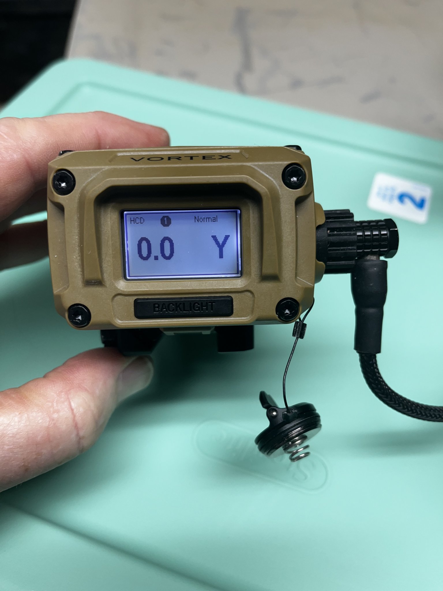

Old library card and shock cord = poor man’s mkm cover

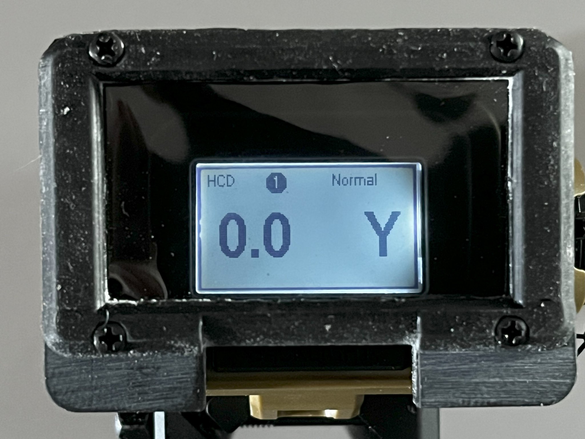

Prototype came off the printer looking pretty good, some minor adjustments and I'll print a usable version tomorrow. Magnets hold on the four corner screws, a frame with four screws hold the filter material. That will let you select what density of filter you want and make it replaceable in event of damage. Probably just include these in the power supply kit. PM if you are interested in being on the list, I should be able to deliver everything by mid-January.
This will give you a rough idea of what I'm building. It's on the printer now to resolve some minor sizing issues and the actual best print orientation, once that's done I'll round off the edges and mount some film. Right now, I expect these to cost no more than $25. The power supply cable system should run about $300, maybe less if I can get a bulk price on the Lemo connectors and spring contacts needed.
I should probably point out that the magnetic attachment is likely to make the compass unusable, though at night I'm not sure it matters. Since all the hardware is magnetic and it's attached to a big steel rod, I question how well it works in the first place.

OK, functional prototype is done for the power supply. Production is now just waiting on some wire and connectors. Based on the current draw, a 5K mAh USB pack should run this for 10+ hours. Those of you running a thermal sight that has external power can order a customized splitter cable to run both systems off a single USB pack. The filter holder is ready to go, I'll start production of those tomorrow, the magnets arrived today so I can do final assembly.
Prices include shipping USPS
Remote power supply standard Lemo single port cable, 10" long will be $275, for $15 more I'll include a filter holder. Custom cable, prices vary according to length and connectors required.
Filter holder with 2 ND9 and 1 ND6 filter $30.
I'll provide payment instructions via PM as these become ready to ship, so send me a note to reserve what you want. If you already sent a PM, you are on the list.
Anyone have issues with connecting to the Geoballistics app? I hit the + in the Bluetooth settings menu and I get a 'connect to network dialog' box' w/ my units serial number shown. Then I hit Join, get a prompt on the Impact that I select "Yes" to allow the app to connect to the network but after that nothing happens. The app doesn't show the bluetooth icon connected, and nothing in the app seems to change. I have location services enabled and I tried on both my Android phone and Apple Ipad and get the same results. Not sure what i'm doing wrong here, maybe someone else ran into the same issue and knows what i'm doing wrong?
I manually setup 1 profile to be able to get out and shoot tomorrow but I'd love to have the App connected to be able to setup more profiles much easier and do all the cool app stuff.

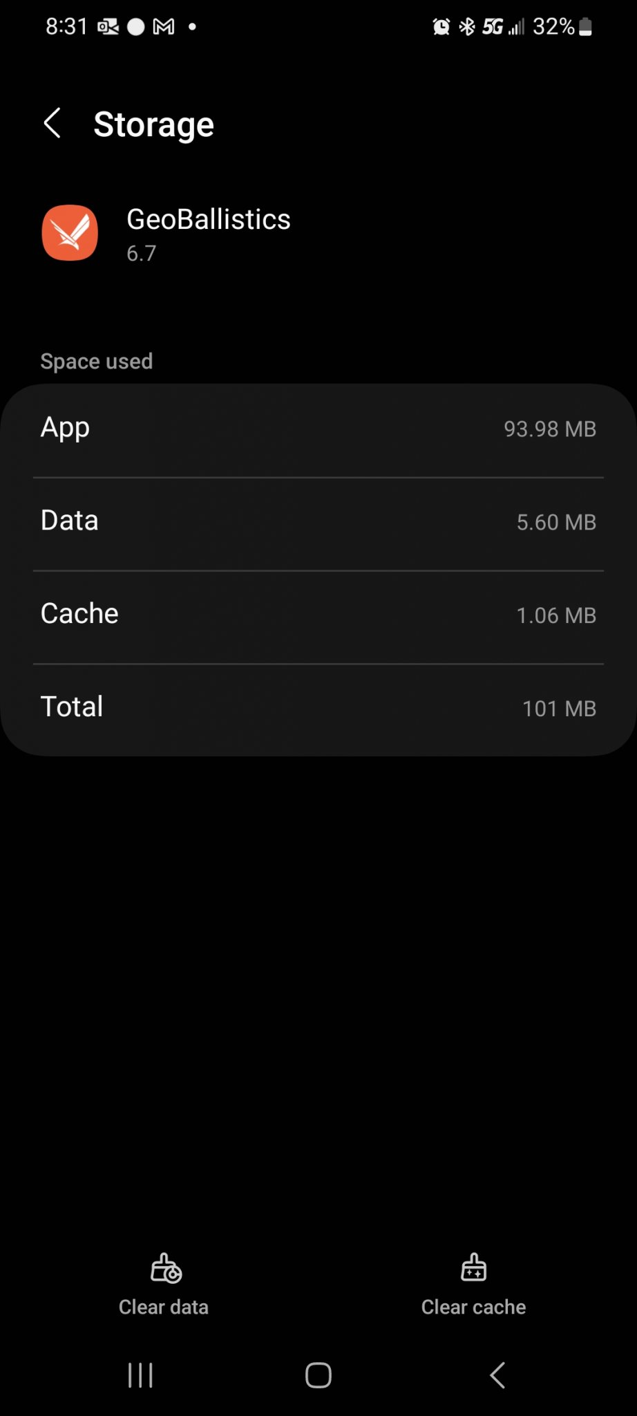

I'm really only familiar with Android. So let's try something with the Android phone. Go into app settings and choose "clear data" for Geo ballistics app. After you do that go ahead and see if everything connects then.
I attached a screenshot of where the clear data icon is in my app settings.
Please let me know if that works for you.
V/R

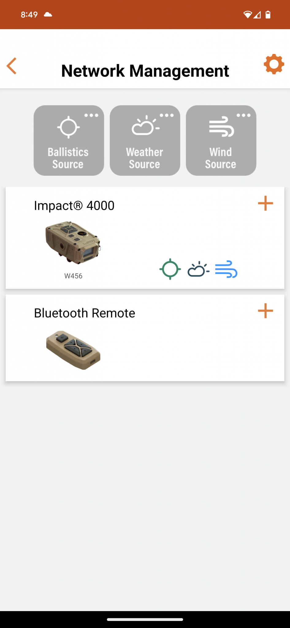

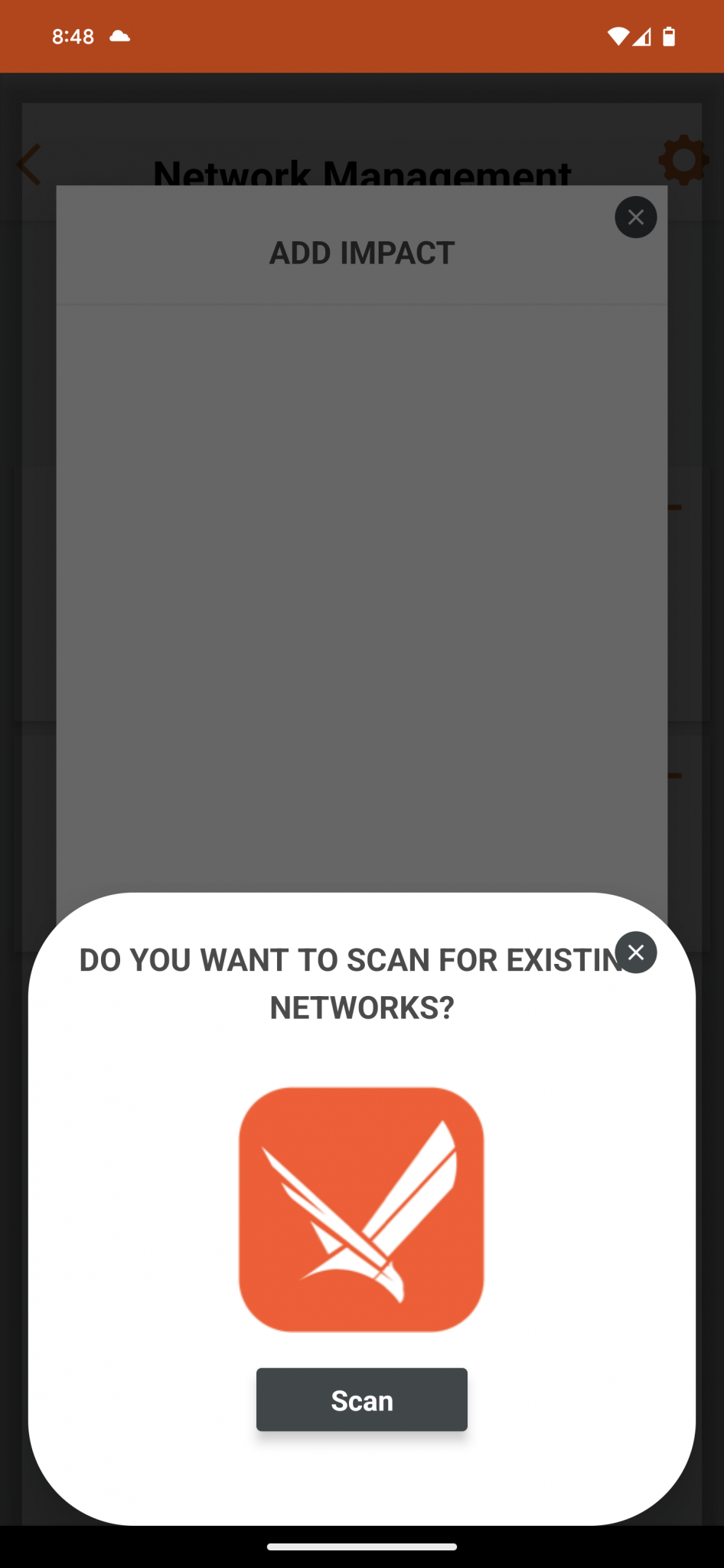

Here's what I'm trying and seeing Everytime I try to connect on either device.
I add Impact and allow it to scan for networks.
It finds my impact and I hit this join button at the top of the screen.
And then I select "Yes" on the impact to allow the app to connect. Then the app shows nothing happened and the profiles aren't synced in the app. No Bluetooth icon next to the impact, data select buttons are all grayed out. The connection doesn't seem to work. I've probably tried 20x and get the same results each time.

*EDIT: I was able to get the Impact to connect to the iOS app. The trick was that I had to first use "remove" on the impact under devices. Then once that was done it would successfully connect to the iOS app. I haven't had success yet with Android and I'll try again later but for now I'm just happy to be able to have an easier way to setup all my profiles vs. having to use the keypad on the device.
Thanks, I tried clearing data and cache on Android and I just installed the iOS app just to troubleshoot the connection issue so it was a fresh install.

OK, 8 of the ND filter holders are ready to go. If you don't need a power cable, or don't want to wait a couple more weeks for those to be complete, you can order one if these now. If you are already on the list for a power cable, I'll let you know when they are all done and you can add a filter on then. Send me a PM and I'll give you payment options.

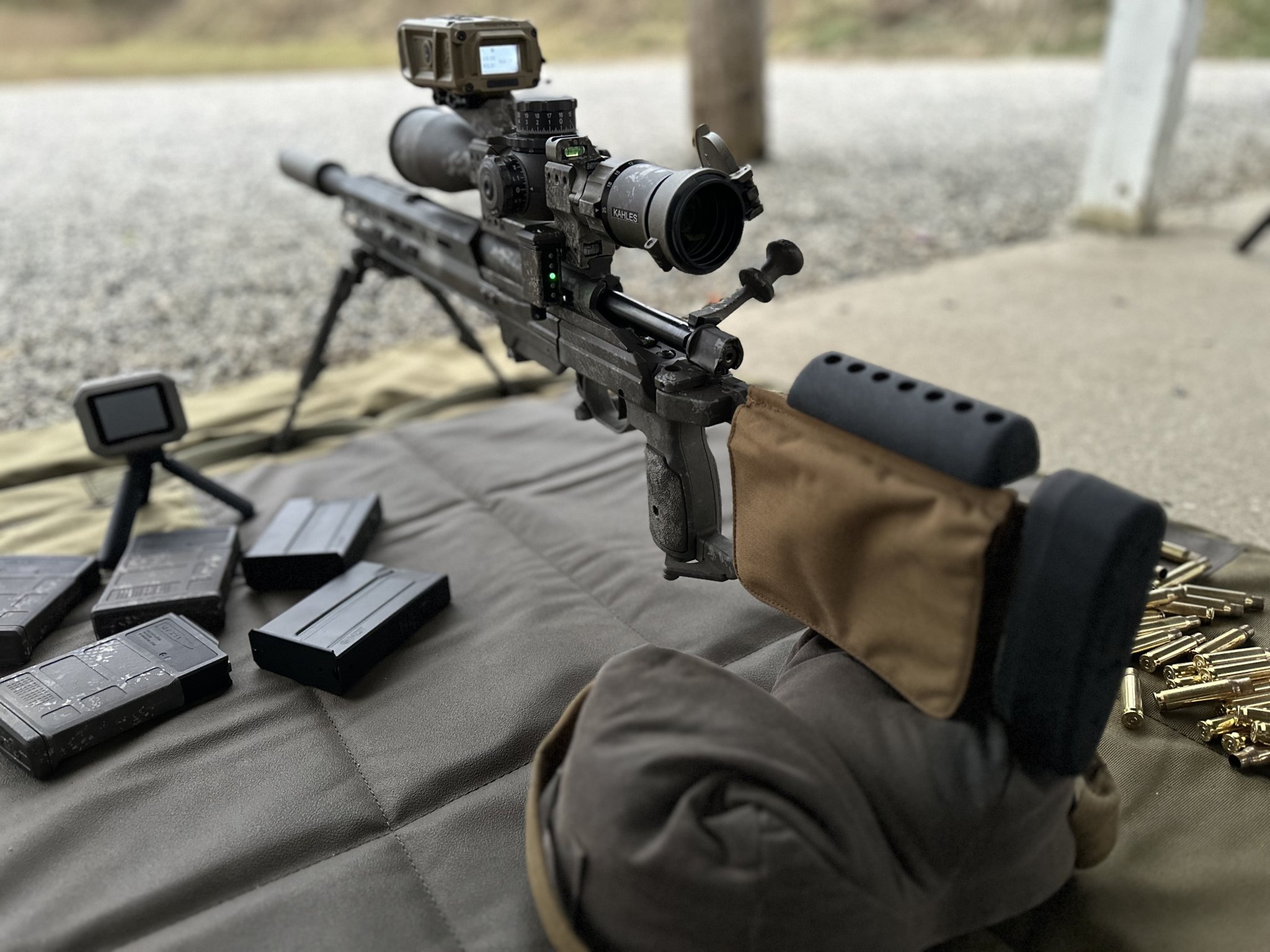

Update on battery life.
I was out with a buddy in 25*f temps last night and both units shut down on low bat after 15 minutes. The Panasonic battery in mine had ~4hrs of use in +45* temps. His was brand new.
We put in fresh Surefire's from my ammo bag in the back of the truck and quickly had low bat indicators and they both shut down before the 10 minute mark.
I'm going to try keeping a warm battery in my pocket and rotating them between stands I guess.

Just turned on with the remote linked up. I ranged maybe 10-15 things. After it shut down the first time, I waited a few minutes and was able to power it up and and it ran about 5 minutes before powering down again. I repeated that cycle a few times until it would only power on long enough to get 1 or 2 ranges.
The next day after being inside it powered up and stayed on with no low bat indicator on the same Surefire battery.
Ready for orders and payments on all items.
Filter holder with 2 ND9 , 2 ND6 and 2 ND3 filters $30.
Cables will be built to order, 10" OAL is the default, let me know if you need something different. Filter holders are ready to go, cables 4-5 days to build.
