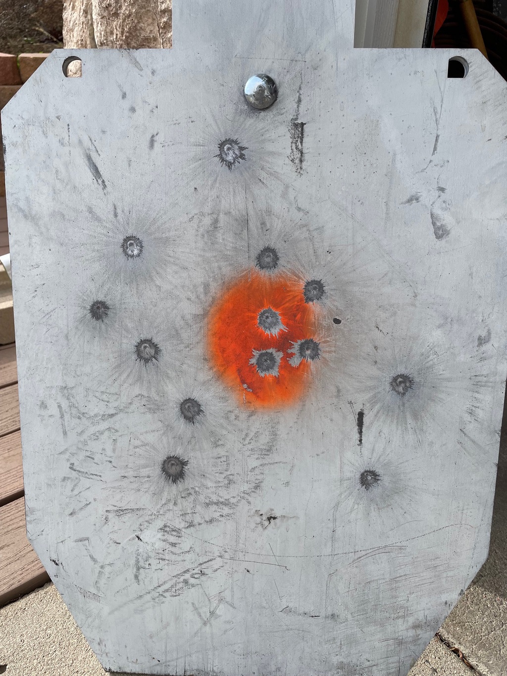

First 5 shots on the orange at 500 yards. Vortex solution given was 2.06 Mils up so dialed in 2.1. First shot was a little high. Dialed down to 2.0 and it started hammering. Wind was fairly high at 20 - 25 MPH so not too shabby!

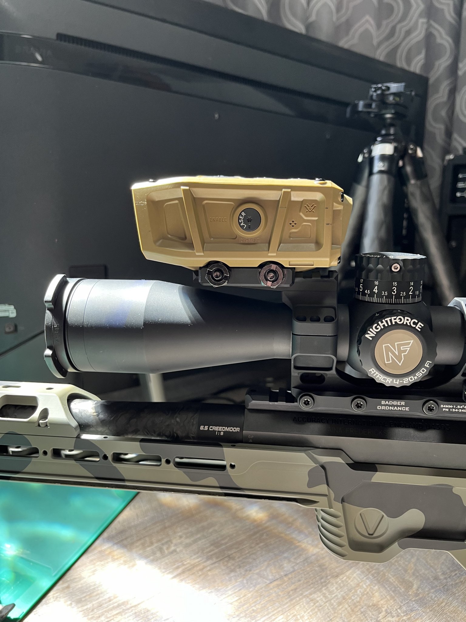

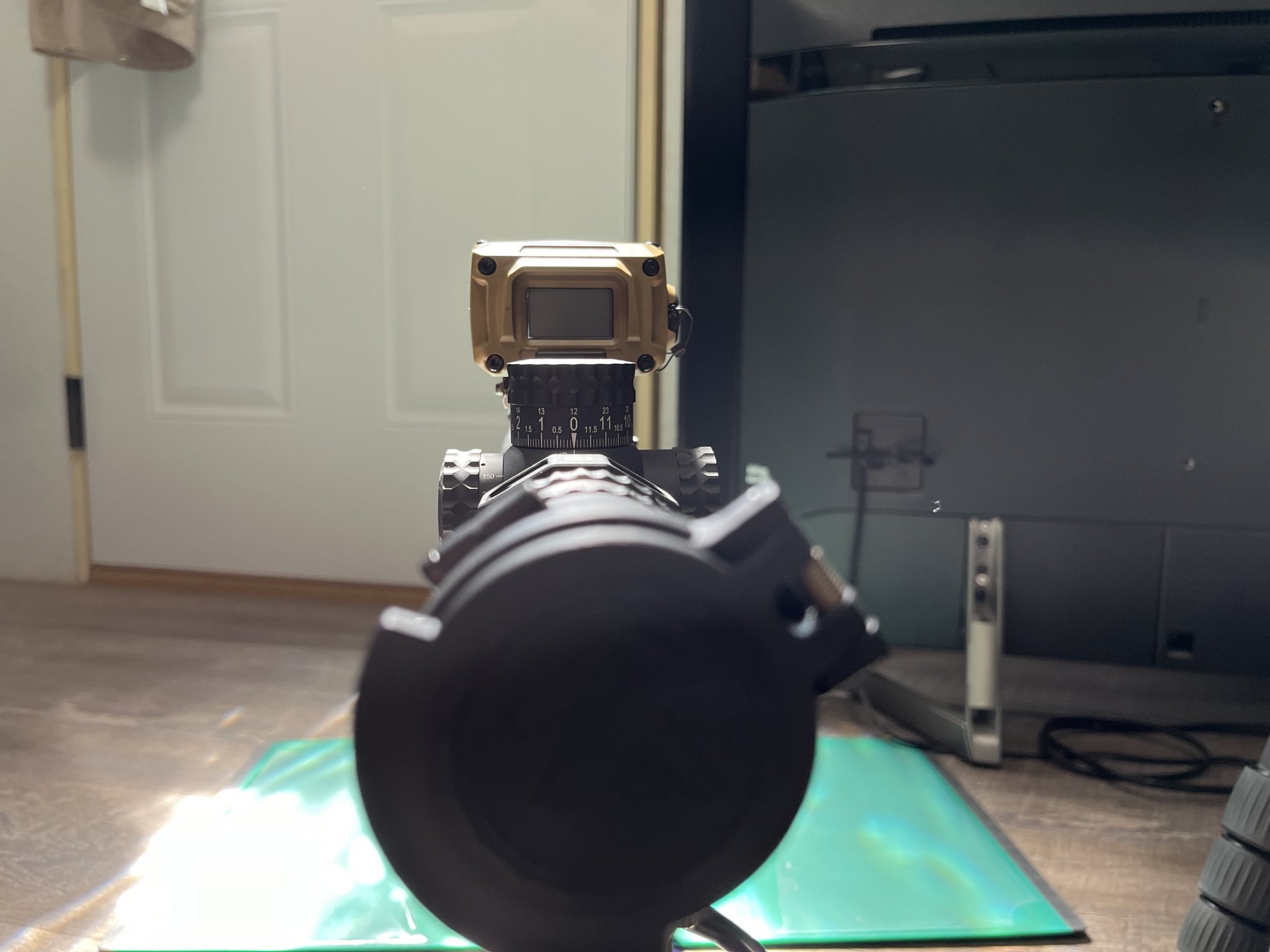

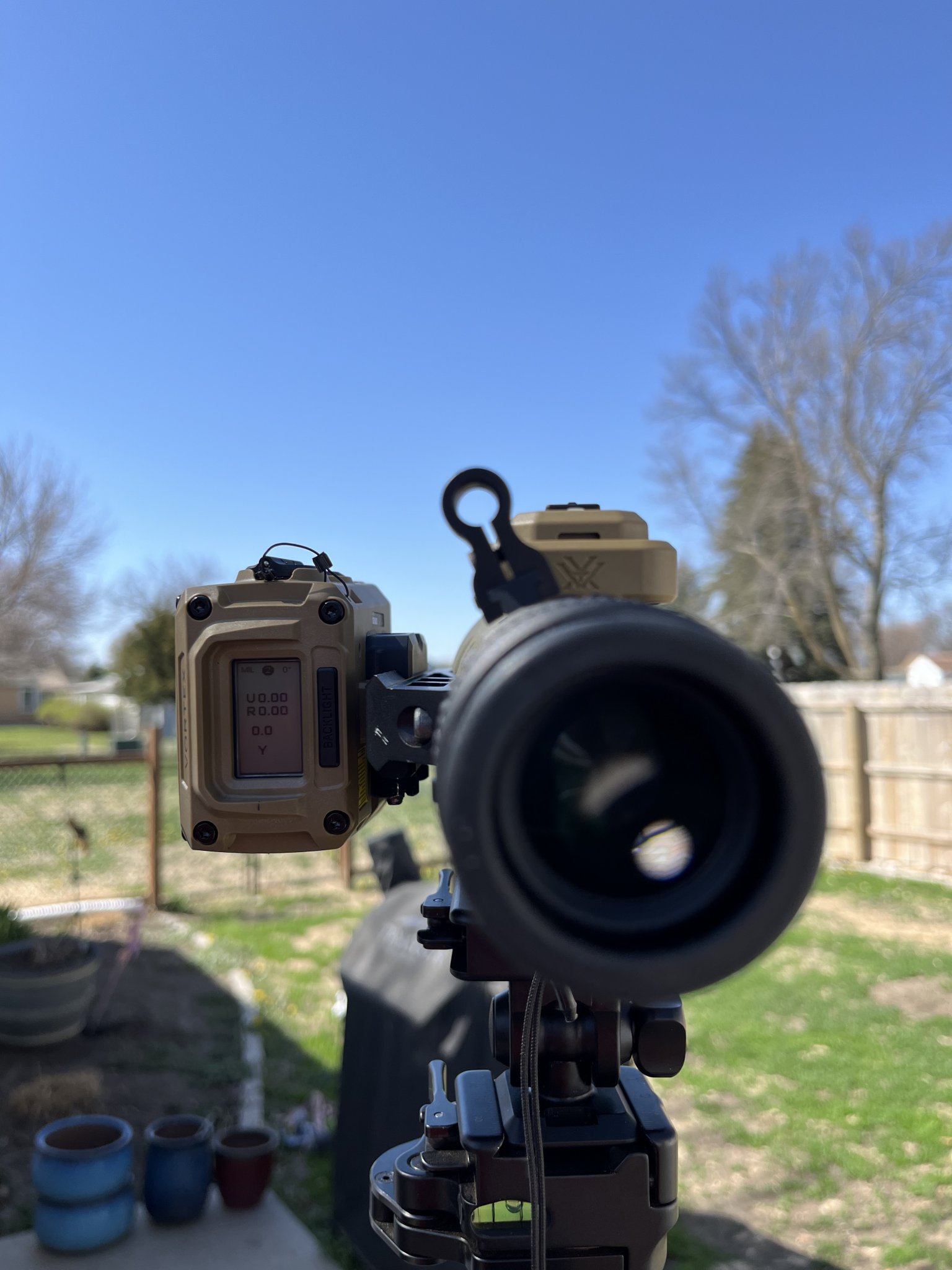

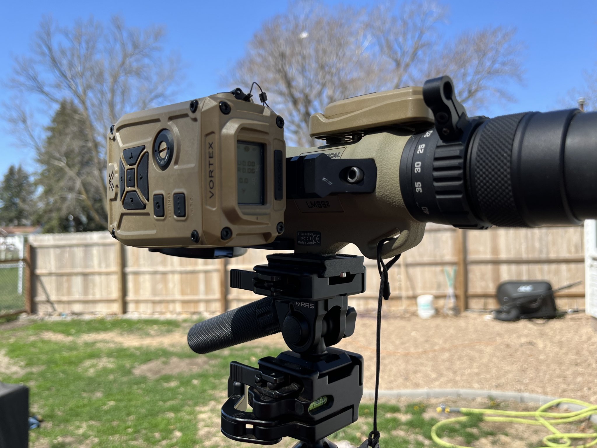

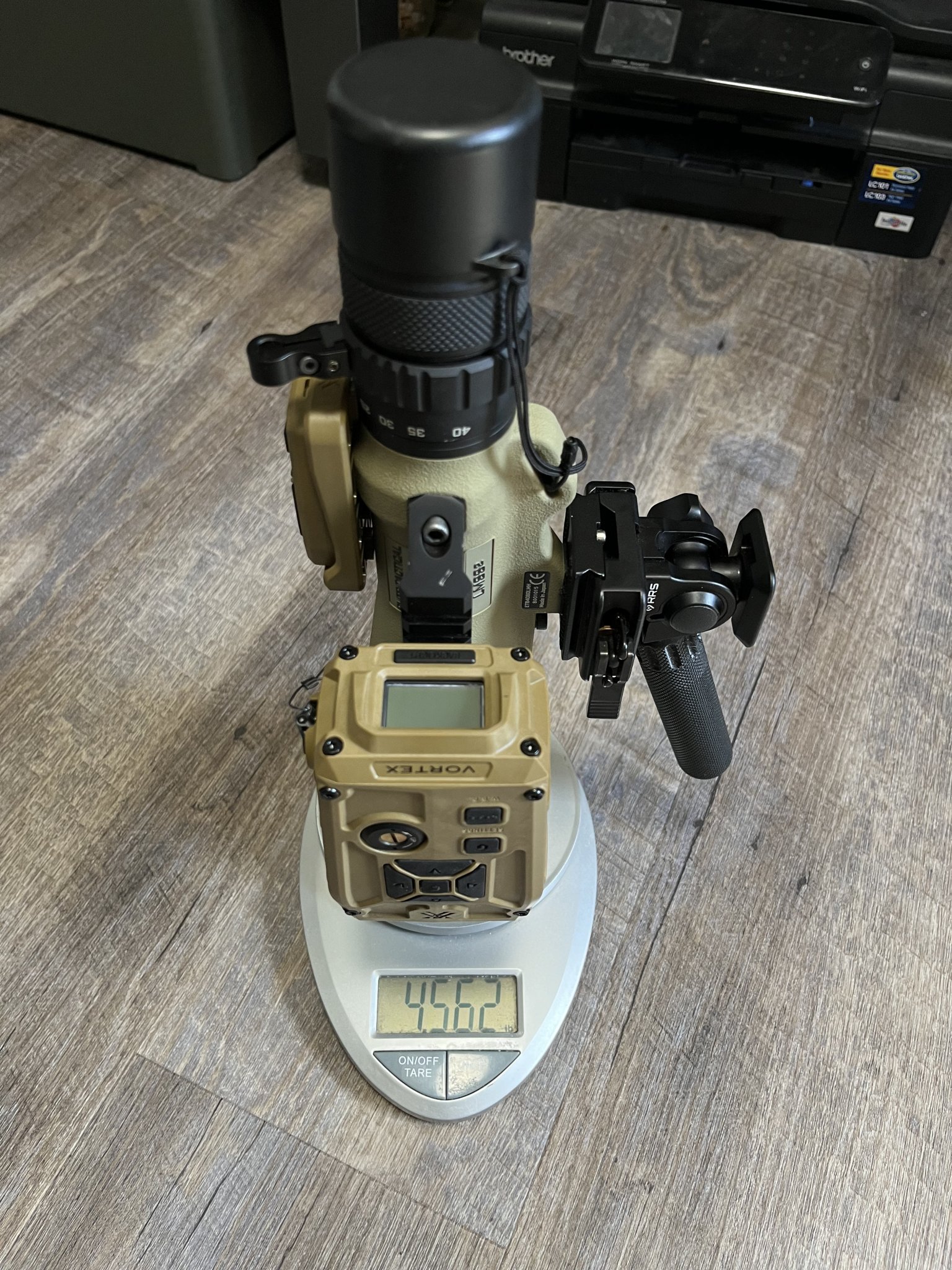

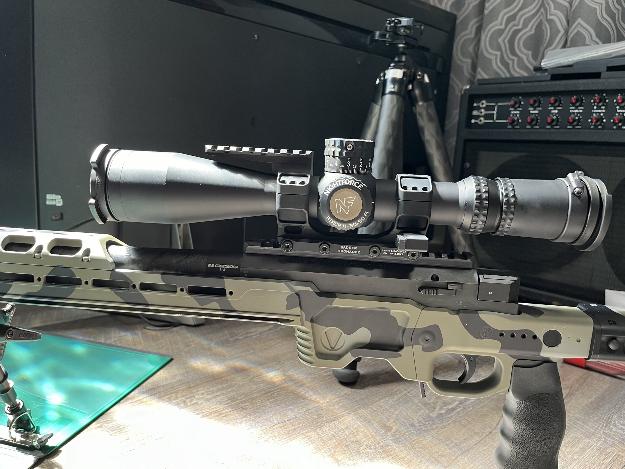

Finally getting my Impact setup. I think this is how I’m gonna use it. Seems pretty handy with this 8-40 LMSS2. Mounted on the side you don’t have to come off glass to see the display. With 90% of the use I’ll have with it, having it paired with the spotter makes the most sense vs running on the rifle. Especially, where I haven’t really found a solid solution for mounting the remote to my Vision chassis.

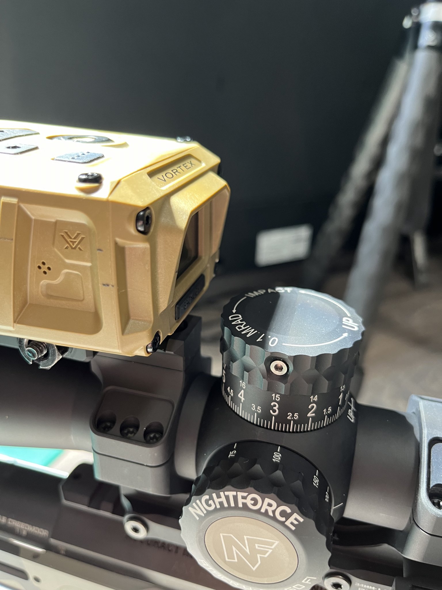

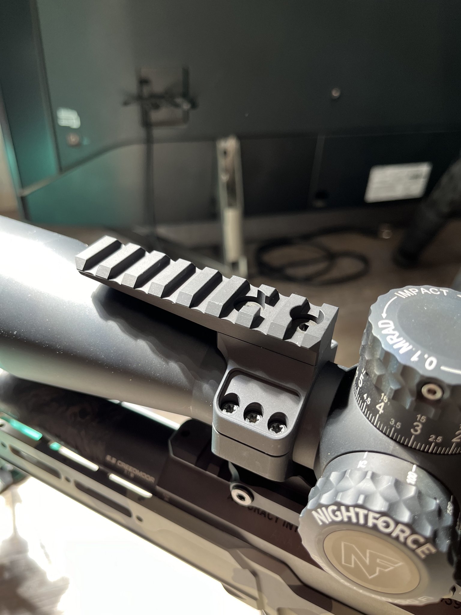

When does the wind and weather info get updated when paired with a Kestrel weather station? I have the Kestrel 5500 with a vane setup to feed wind and weather info into GeoBallistics. From the manual I see where you can update the wind info from within the GB app. Is there a way to pull updated wind data in by hitting the wind bearing button on the Impact itself or is that only able to be updated using the GB app which then feeds into the Impact?
Is anyone moving one of these around different setups? It seems like the laser would be off if they didn’t share the same height over bore. Is my understanding correct?
Yea the laser would be “off”, but I don’t think the impact of vertical is practically important regardless of zero type (convergent vs parallel). Windage differences from system to system though could be an issue.
My understanding could be wrong, but the laser optical center is a fixed (not angular) distance from the scope’s optical center in a parallel zero. In a convergent zero, assuming a zero many hundreds of yards out, the optical center between the scope and laser decreases until your zero distance then increases in a directly opposite angle. So for instance in one system you might be 3” over scope center and diving boards can vary about ~1” between low and high. So long as your scope isn’t dialed up or down, what’s 1” at 8,9,1000 yards?
I think I would agree with TheOE here, is the difference enough to make a difference? What would be good is to use NV to confirm actual zero of the LRF unit at distance, then swap to different platforms using different height - so one scope/mount is setup at 1.5" from center of scope to center LRF, the other is 2" from center scope to center LRF and so forth. Sadly I sold all my cool NV gear a few years ago and haven't replenished yet, but I'm assuming plenty of night junkies out there could do this (@wigwamitus I'm thinking of you brother), and maybe already have done this...

Hello,
The short answer is yes, you will need to align the Impact to every different rifle/scope set up you put it on before using. This is for the same reasons you need to rezero your scope when you move it to a different rifle.
Since the riflescope reticle becomes your lrf aiming point you have to align the laser and reticle.
Hopefully I understood the question correctly and hope this helps.

I'm running into issue with mine maintaining zero, specifically windage is really bad
I know that the adjustment screws have some "bounce" so when I swapped the unit recently, I lightly tapped it with my knuckles to get the laser to settle. What I found astonished me.
The laser bounces vertically with about a 0.5 up/down shift, about 0.2 mils in either up/down direction. Meaning I would tap it once, the laser would be 0.2 low, then tap again and it would jump past my zero up to be 0.2 mils higher than zero.
The windage was way worse with 1.0 of divergence, meaning the laser could shift left/right of zero by 0.5 mils. If it tap it and it goes 0.5 left, then tap again it can bounce a full mil back to the right.
Tia effectively means that my laser is moving 3.5' at 1000 yards and 1.75" vertically.
Anyone else seeing the same thing?
