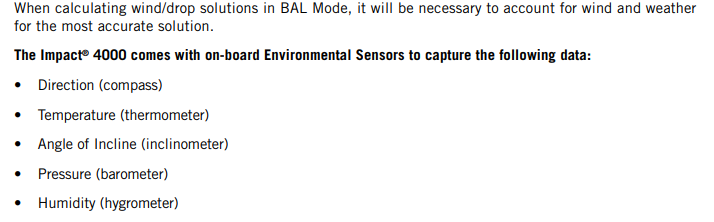

Doesn't the impact pull atmospherics from the environment each time it ranges?
Not that I'm aware of. The Impact itself definitely doesn't get it's own wind information. That has to be manually entered or input from a Kestrel.

Based on what is stated in the manual you have to press the green button in the GB app to get the weather info from the Kestrel into the app.
From the Manual:
The Impact 4000 manual states the Impact has onboard weather sensors so you do not have to pull weather from the app, you can also use the wind bearing capture function for wind direction and adjust the wind speed as you see fit. The wind bearing capture is a better feature than connecting to a Kestrel as your wind downrange may or may not be the same as what you are capturing at your position.

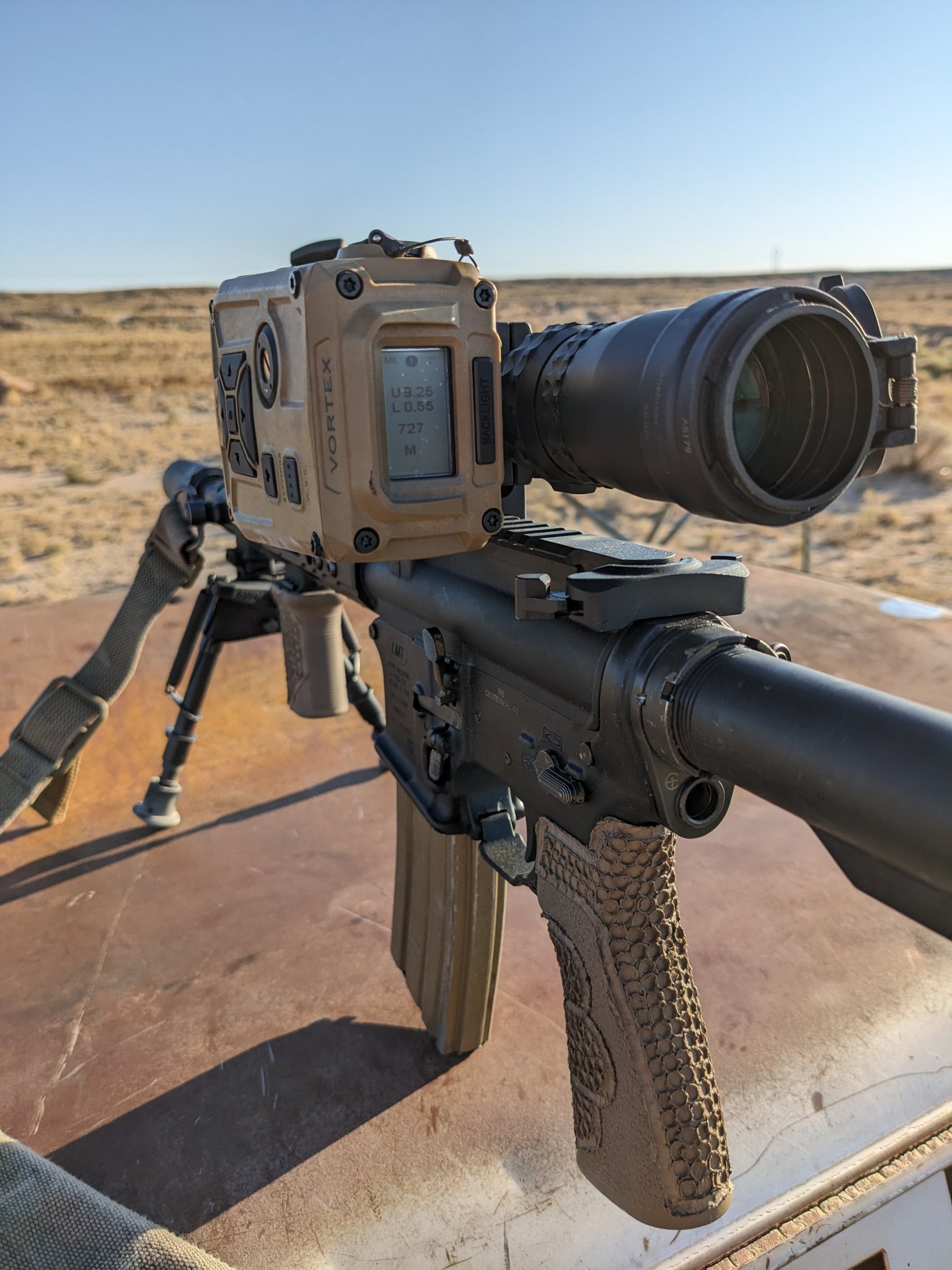

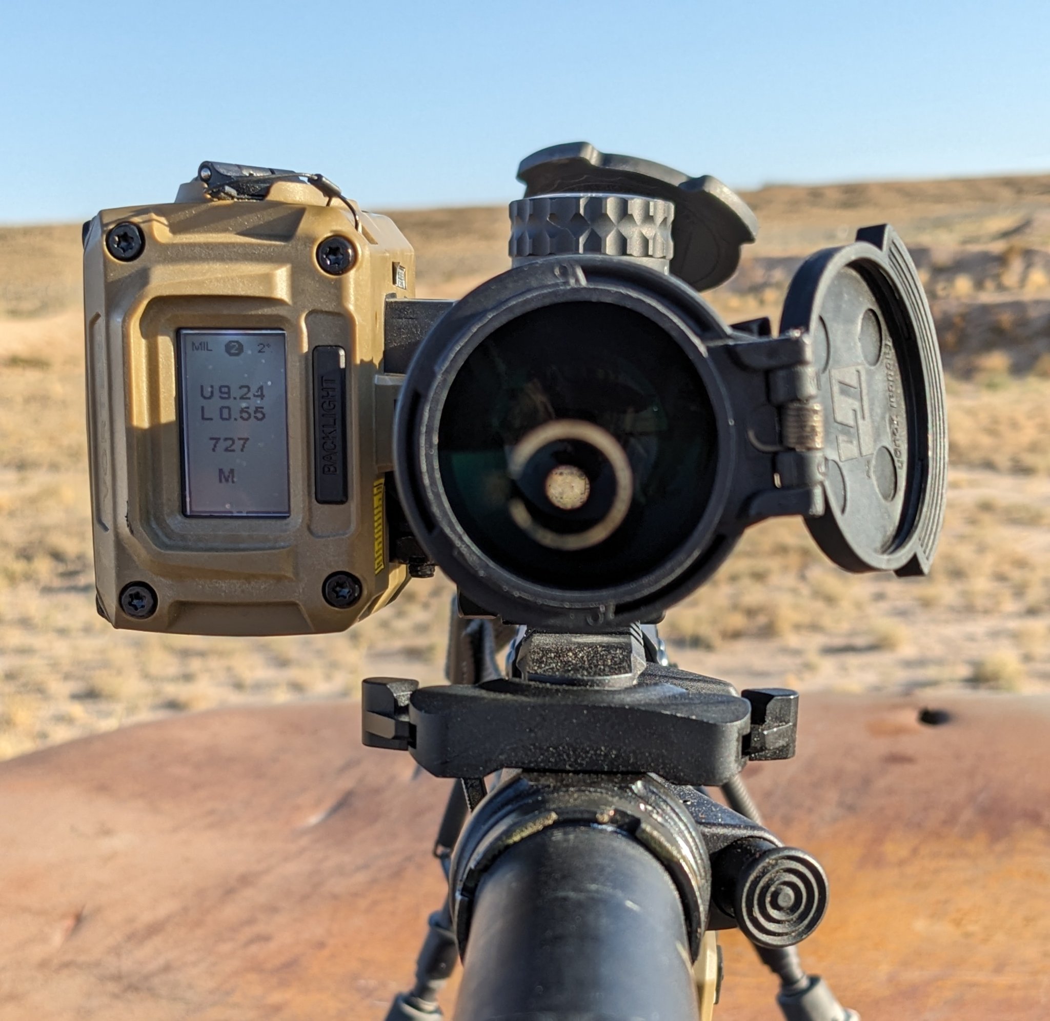

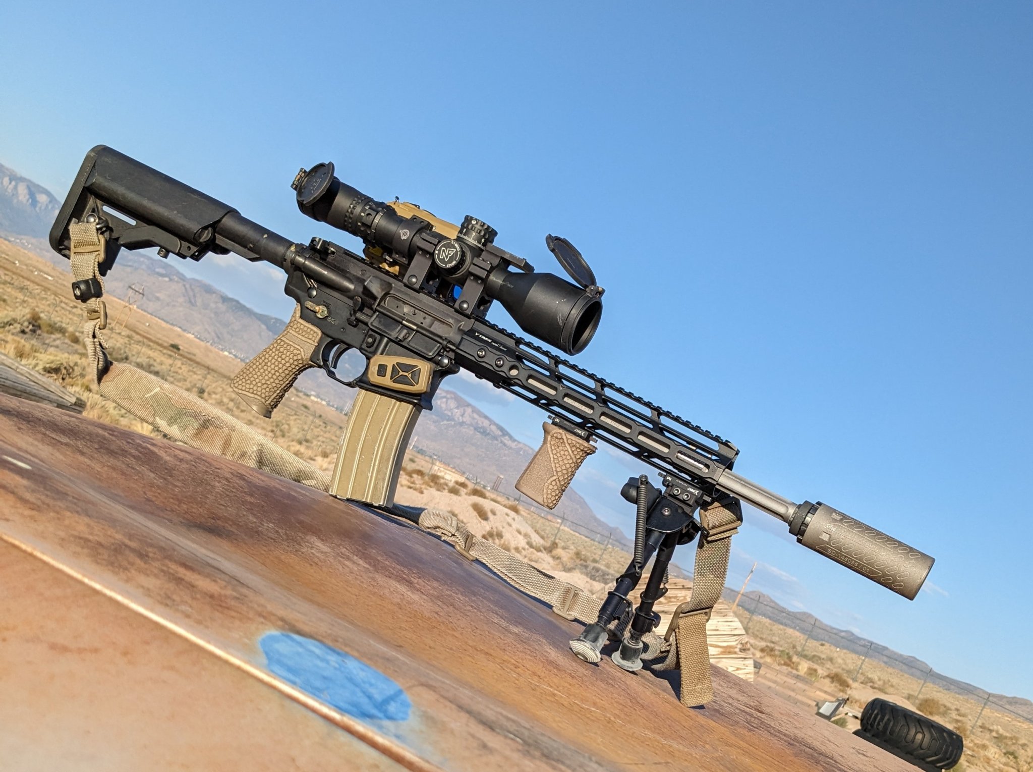

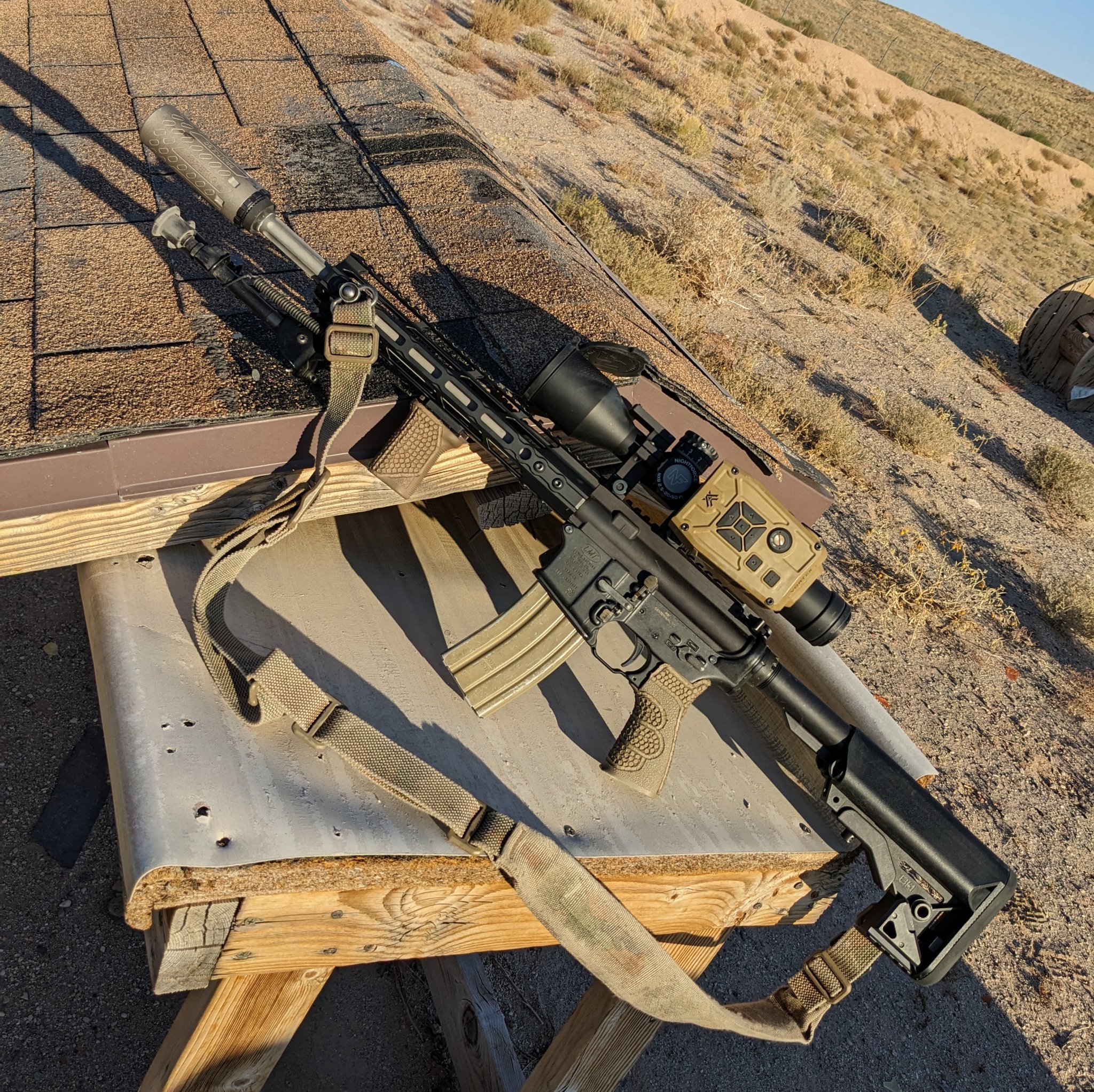

Been enjoying my side mount 9 o'clock mounted Impact 4000 on my 14.5" 5.56 SPR
Easy quick hits out to 800 yards.
Any chance for a release of a smaller remote that is just a single button to turn the unit on and then fire it? The included remote is just a bit too large for the side of an AR-15 magwell in my opinion. Also firmware update for more brightness settings and perhaps a few more auto off timeout times?
But overall this is one of the most innovative well executed pieces of kit I have ever used! Definitely liking it.
What kind of LRF mount is that? And who makes those beefy-ass rings? Wow
a set of area 419 match rings or their one piece mounts will let you mount the impact infront of your parallax knob to make it easier to get to. i had my impact side mounted for a while , first with their match rings and the accessory 1913 rail then swapped over to their one piece mount for some added height. i had the impact mounted to a unity tactical riser with an adm qd lever so i was able to take it off and remount it easily
That side mount kicks ass. I was worried about mine being too tall, but not a problem. I’ve got an ARC M-Brace to mount it on.
looks like a nice place to shoot , good looking rifle also :cool:

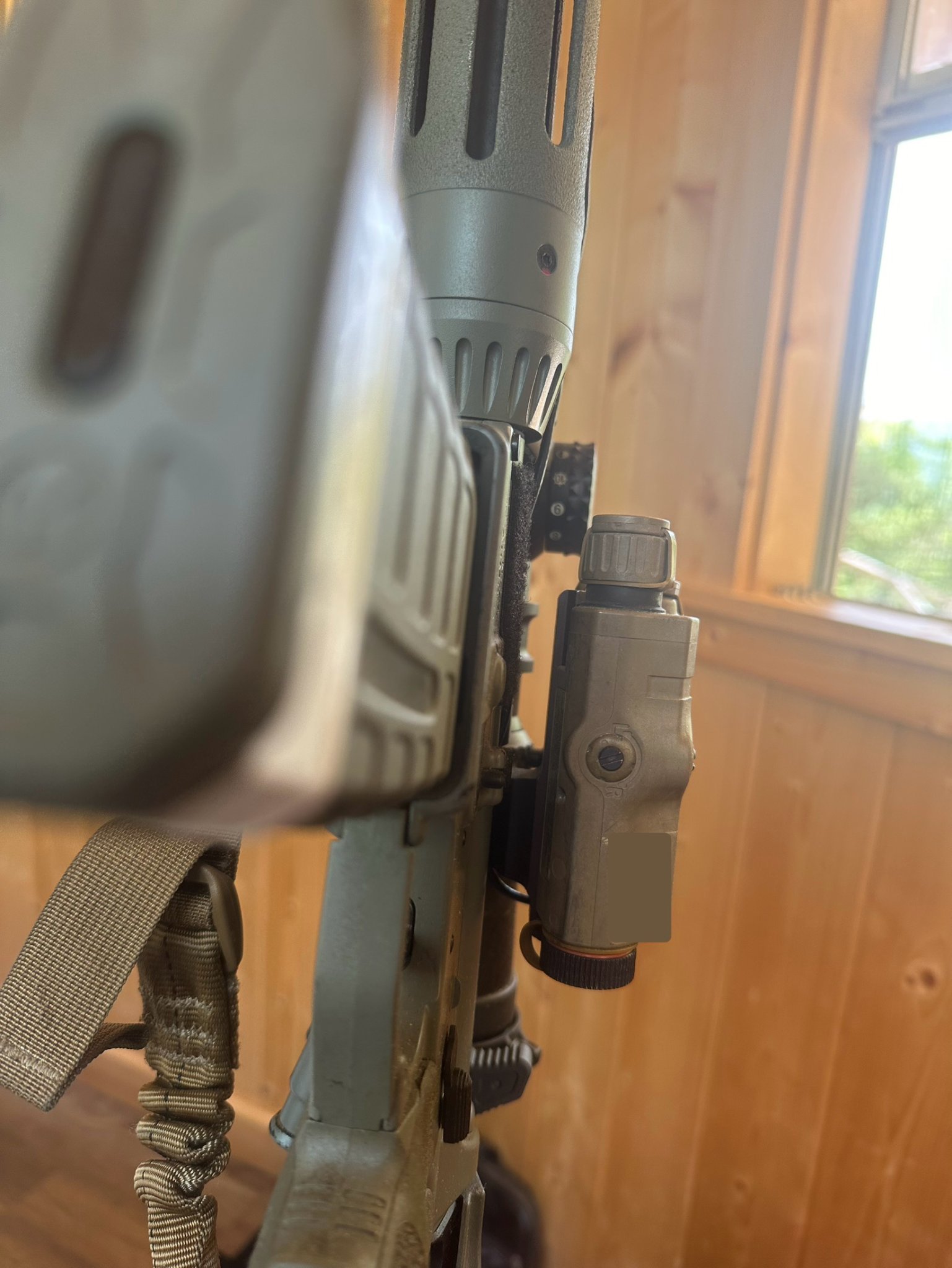

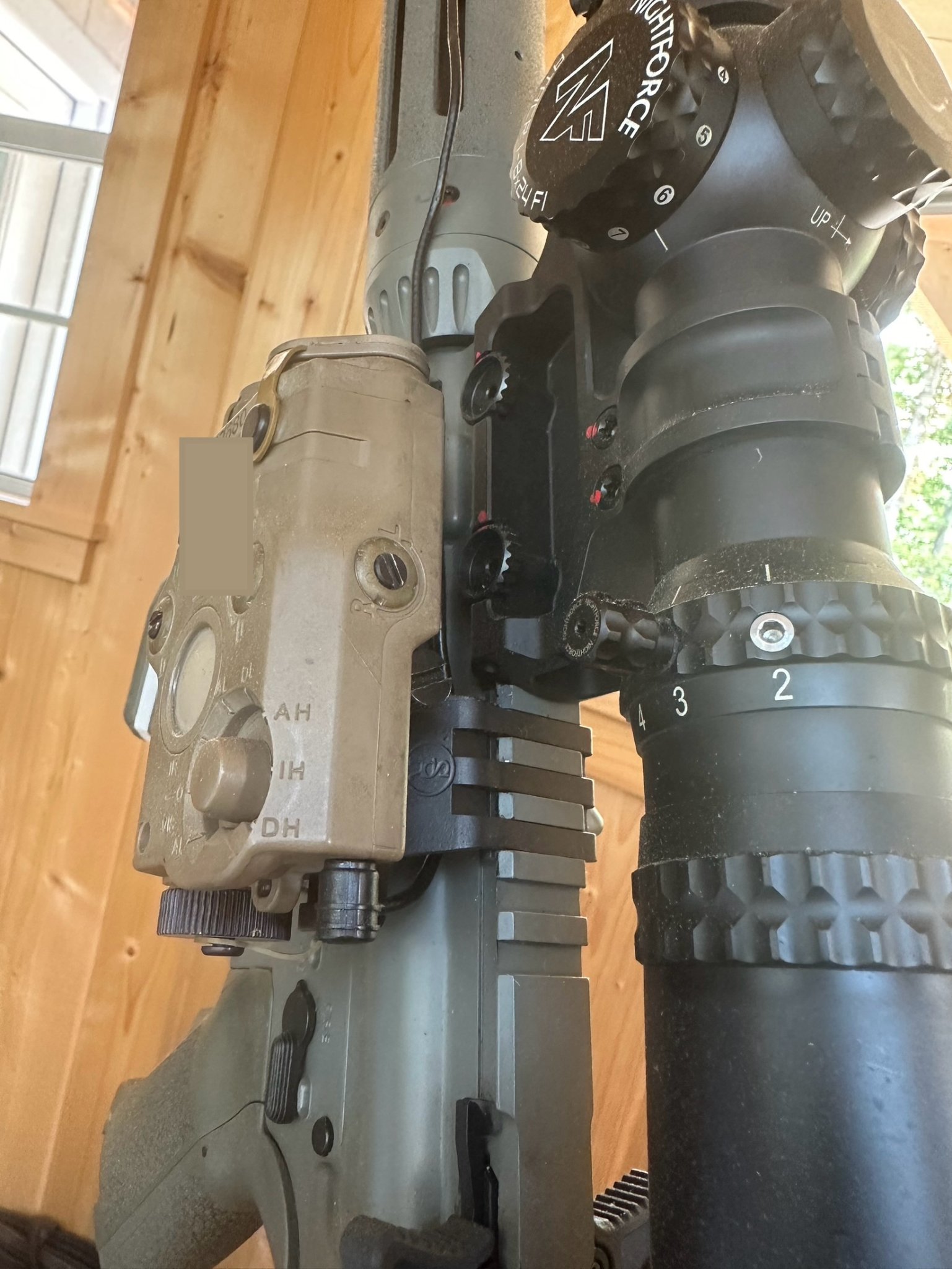

Ooohh that’s interesting. So you added one of these to the side
Then attached this to the above 419 pic rail
And then attached the Impact to the unity?
Sounds like it stays zeroed?
Nice thing about your solution is that one can dismount the phat impact to fit the gun into a soft case.
yes those are the parts i used. the pic rail attaches to the lower ring on the 419's so that was nice to take the weight off of the top ring. with the impact torqued to the unity mount there were no tools needed to mount or dismount it. i didn't shoot it much in that configuration before i moved to a one piece mount and diving board but it seemed to hold zero fine , especially for the number of times it was removed and reinstalled. the adm qd lever's are my favorite qd for rtz
it was really nice to have it on a qd for a handful of reasons with it mounted at the 9 o'clock position ;)

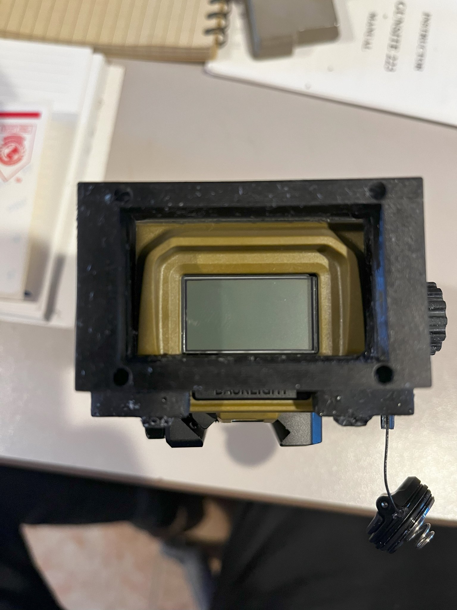

Dumb question: there’s no reason why that same setup (minus the pic rail and using the 419 diving board) doesn’t work at 12 o’clock, right?
Does the side mount have the same level of stability as the top diving board mount? It looks like it has a different attachment style so the diving board can’t be mounted on the side, but the side appears to still have more than just the screws holding it to zero
it should work on any pic rail , but it does raise the overall height. i believe adm has a picatinny to picatinny qd that is lower if you don't need the added height or forward cant of the eotech riser. it would probably be the lowest solution to make the impact "qd"
at 9 o'clock the added height and cant was nice as it allowed the screen and backlight button to clear the parallax knob
Wait it has cant. Guess not a big deal just more adjustment when going to other platforms
Are you referencing one of these adm mounts?
Might as well ask what’s the best QR / QD (whatever you want to call it) repeatable system out there for a WMLRF?
Are you referencing the other of these adm mounts?
yes the adm170 , you can get 3 slot , 5 slot , or 13 slot pic rails that attach to it. the 5 slot would probably be best for the impact , i don't think 3 slots is enough. the sf riser is a littler lower but i think it's only available with 3 slots

This will give you a rough idea of what I'm building. It's on the printer now to resolve some minor sizing issues and the actual best print orientation, once that's done I'll round off the edges and mount some film. Right now, I expect these to cost no more than $25. The power supply cable system should run about $300, maybe less if I can get a bulk price on the Lemo connectors and spring contacts needed.
