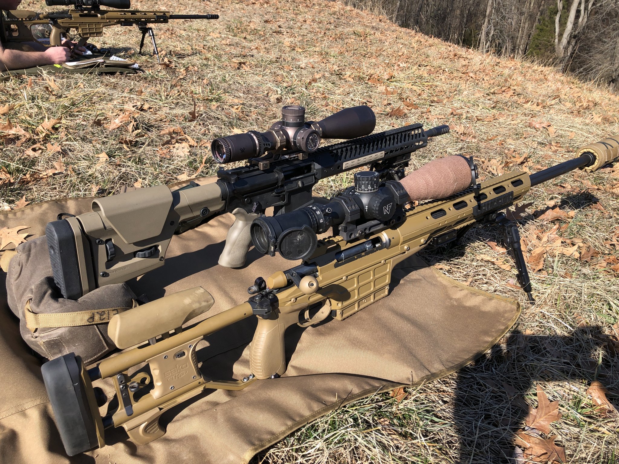

Had mine out to 800y last week next to my NF 7-35. DOF seemed just slightly better with the NF. Very impressed with it so far. The reticle is a huge improvement to the 7-C and the main reason I upgraded from the Gen II.
One of my biggest reasons for the move also. Granted the MR4 is eerily similar to the 7D but I just like consolidating systems throughout my rifles. I really like the 1/2 mil lower hash on the ERB7C and D. It helps me denote quickly where I am. I wish it was on the vertical stadia of the tree also that would be perfect. I still think the Mil-XT is the best designed tree reticle on the market, even if a little cluttered for some. Wish NF would sell that to horus and put it in other scopes lol. I could buy more NF but then I have to put up with rotating eyepieces which annoy the piss out of me.

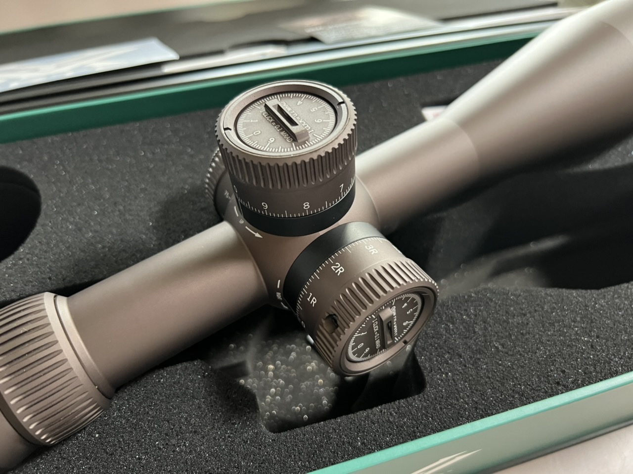

My Two Hours with New Gen-III
I spent a couple of hours on the range today getting acquainted with my Gen-III. I ordered it from EuroOptic Friday afternoon and it showed up here in central NC midmorning today (Tuesday) - fast service. Here are a few initial thoughts - again, all this is based on two hours of range time and things may change with more hands-on time.
  • Weather was clear, temp 55F, humidity 25% (dry!), station pressure 30.3, wind calm to light from 2 o’clock. Light went from afternoon full sun to deep shadow after 5pm.
  • Clarity is excellent, as has been noted many times. It seemed to me that the image was a bit dark at full magnification in the late-afternoon shadow 45 minutes before sundown…. But this will be reexamined in comparison to my Gen-IIs and ZCO.
  • The turrets…. Well, they work and the skin is still on my fingers, albeit a bit raw. Turrets make a little noise and they kinda have a tactile click. Mainly they feel like they’re full of… something… that makes them gummy and way too f'ing hard to turn. At this point, the Gen-II turrets are VASTLY better. @Rob01 and I are going to get together in the next several days to compare the various controls, especially turrets. I do hope they loosen up with use. Note that there are no external caps over the “zeroing dial”, and the recessed elevation dial will rapidly fill with water in the rain - could the stiffness be associated with additional waterproofing?
  • The single-screw Gen-III zeroing lock is much easier to adjust than the 3-screw Gen-II design.
  • Does the turret lock inadvertently get pushed to lock position? My answer comes with a caveat: I have pushed the elevation and windage turrets to “locked” on ALL my scopes (three Gen-II Razors and a ZCO) while on the clock. But, with the Gen-III, I pushed it “on” multiple times because the turret was so damned hard to turn. I’ll put an o-ring on asap.
  • Are the marks on the turret aligned with the index mark on the scope body? Yes on the elevation turret, close enough on windage but not perfect.
  • Tracking: Seems fine; I dialed out to 400 today (21.3 mils) and back several times, and it put the 35-yard shot(where I'm zeroed) on the 3/16” dot reliably.
Other notes:
  • The new adjustment tools are an improvement. The previous gen’s tool has plastic “bits” to engage the caps and zeroing dial, and I discovered how easy it is to damage said bits if caps/dials are tight. The new tool has a metal “bit” which won’t be damaged as easily but caution must be taken against scratching the scope.
  • It’s good that a nice metal throw lever is included now as well as the sunshade. I love my ZCO 5-27x56, but I’ll stick a cardboard tube on my $4k scope before I pay $65 for a sunshade that ought to come in the box.
Summary:
Lots to like with the Gen-III Razor 6-36x56 except the stiffness of the turrets and parallax knob. I hope they loosen up… if they do and become comparable to Gen-II feel (I have two Gen-IIs and sold an MOA gen-II), it’s a solid upgrade to the previous generation. But I think a lot of people are going to, um, feel strongly about the Gen-III controls to the degree of their stiffness perhaps being a showstopper.
My $0.02.

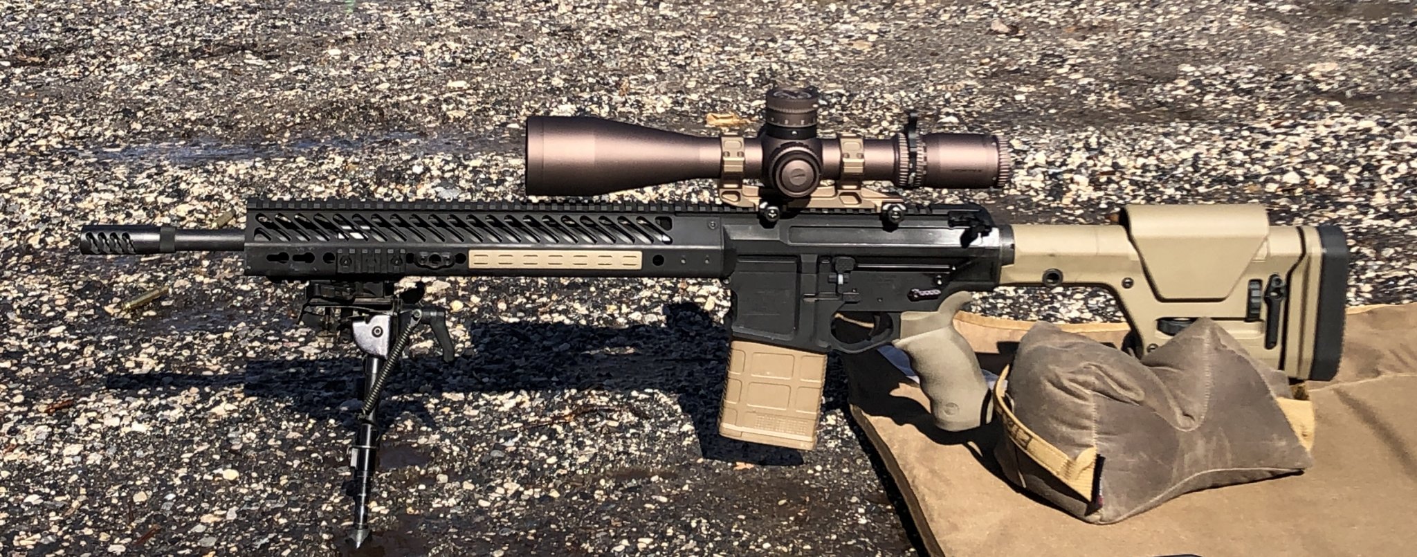

So, some dude dressed all in brown trespassed my property today and threw this thing at me…
I need a good 0-MOA cantilevered mount for it that will support a Raptar. I have Spuhrs, Scalars, Badger C1, Geissele, ADM, and others. I want LIGHT with Raptar and offset RDS capability, so I think I’ll pass on Spuhr for this go-round.
Thoughts?
  • Love
Reactions: 5RWill
I think if you’re gonna be stacking all that stuff on there you might as well go Spuhr. Maybe their hunting version would be an option

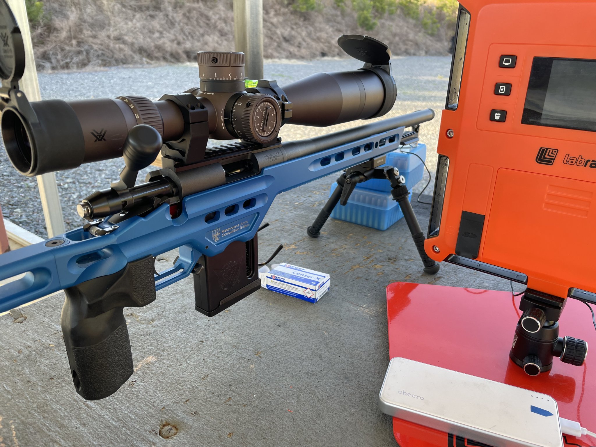

I guess its my turn to throw in my two cents, probably worth less than that though. Came out to the range beautiful bright sunny day but windy af. Shot 50 rounds of 6.5 CM for about 2-3 hours at various distances from 1335 to 425 yds and brought along my ZCO 527 for comparison.
Reticle- perfect am really liking the 7D and I will say that I like it better than the MPCT2 on my ZCO, it’s just designed better IMO
Optics- Let me start by saying that I know nothing about optical quality except for what my 40 year old eyes tell me, I have no tools or special targets to compare to but I’ll say this, compared to my ZCO image quality was pretty damn close (I just don’t want to say same). I spent some time looking at a target at 964 yds at 20x with both scopes and it was really hard to tell the difference, this makes me happy. I was able to shoot targets at 964, 1100, 1160, 1255 and 1335 yds with the gen 3 and image quality was great and I was able to spot all of my impacts and misses with no issues.
Parallax-was great and even all the way at 1335 I was still able to get a perfect clear picture without dialing to infinity, in fact I spent shooting from 550-1100 yds in between the 500-1000 mark with no issues.
Zeroing- awesome and easy I have never owned a gen 2 so can’t tell you about what’s best.
Tracking- I really didn’t do a full on box or tall target test but from dialing all the way to 1335 back to 425yds repeatably it was on every time, take that for what it’s worth.
Turrets- absolutely atrocious, hate them. Stiff to the point that they hurt my fingers, clicks are hardly audible only tactile when dialing fast If dialing slowly they’re pretty mushy. Dialing elevation while on the rifle causes the whole thing to move and it’s really uncomfortable. I didn’t have issues with the locking feature. People at the range told me that they have spun gen 3 turrets on 2 other scopes and they were bad but not as bad as mine which leads me to believe that I might have gotten an extra shitty pair and consistency is not there, considering contacting vortex.
To summarize, this scope was purchased as an upgrade from a MK5 and optically it has delivered 100% so am happy about that since I didn’t want to drop more money for another ZCO or “better”, that being said if this turret thing if not fixable either through warranty or use it would be a real deal breaker.
