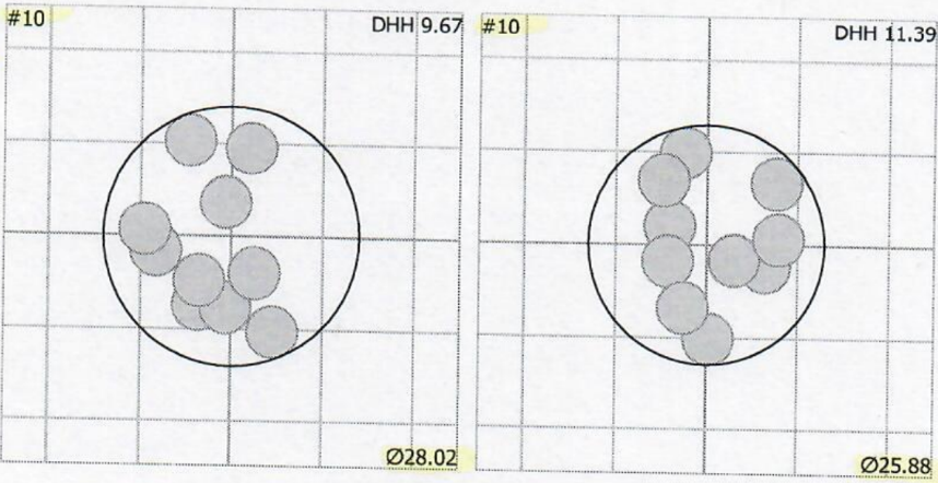

.42" group with 20 shots at 50m
These were the 10 shot groups at 100m
.88" and .80" 10 shot groups at 100m.

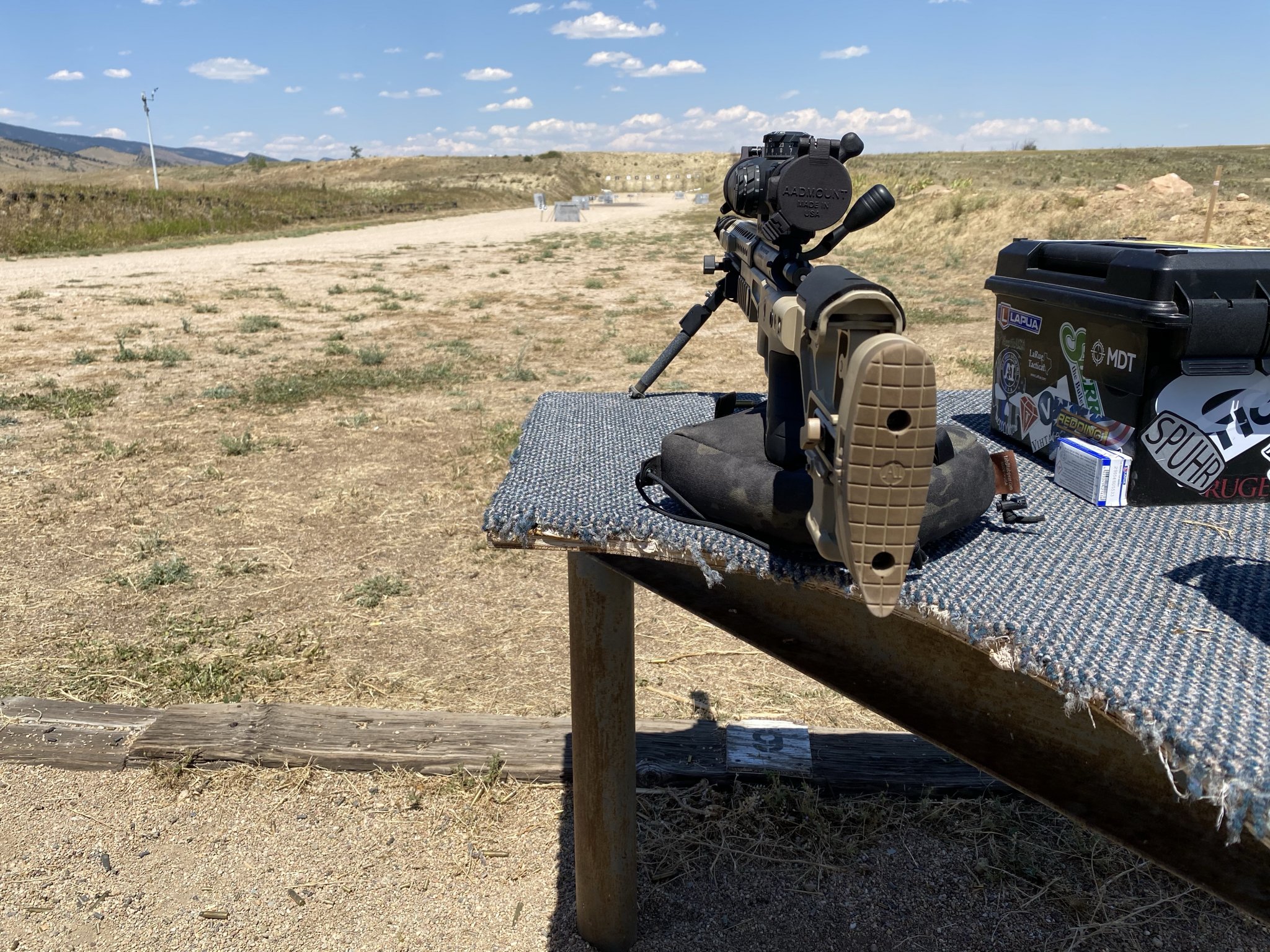

Shot a match today with the ol girl and placed fourth. Nothing to write home about but I’m pleased given the switchy and random wind we had and the 90+ degree weather.

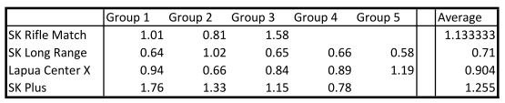

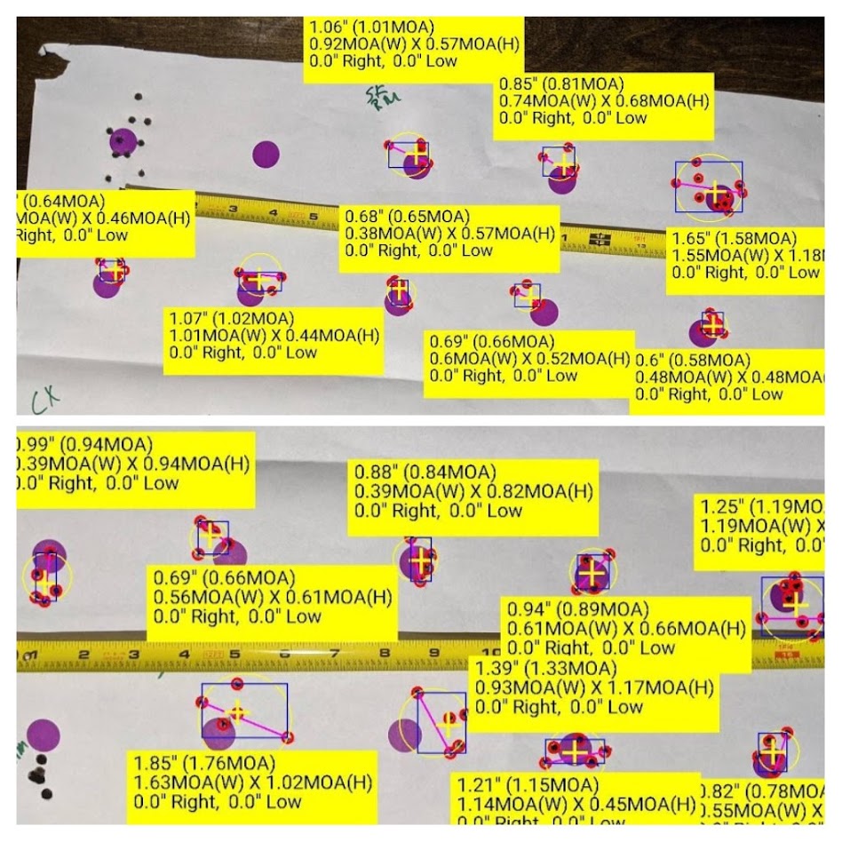

Small sample size, but seems consistent with my past outings. I dont know if it is this lot of SK Long Range, or all lots are this way but my V22 loves it. The below are 5 shot groups, with one 10 shot per ammo type (less SK Plus as I ran out). All shot at 100 yards.
Reactions: marctolate and STex

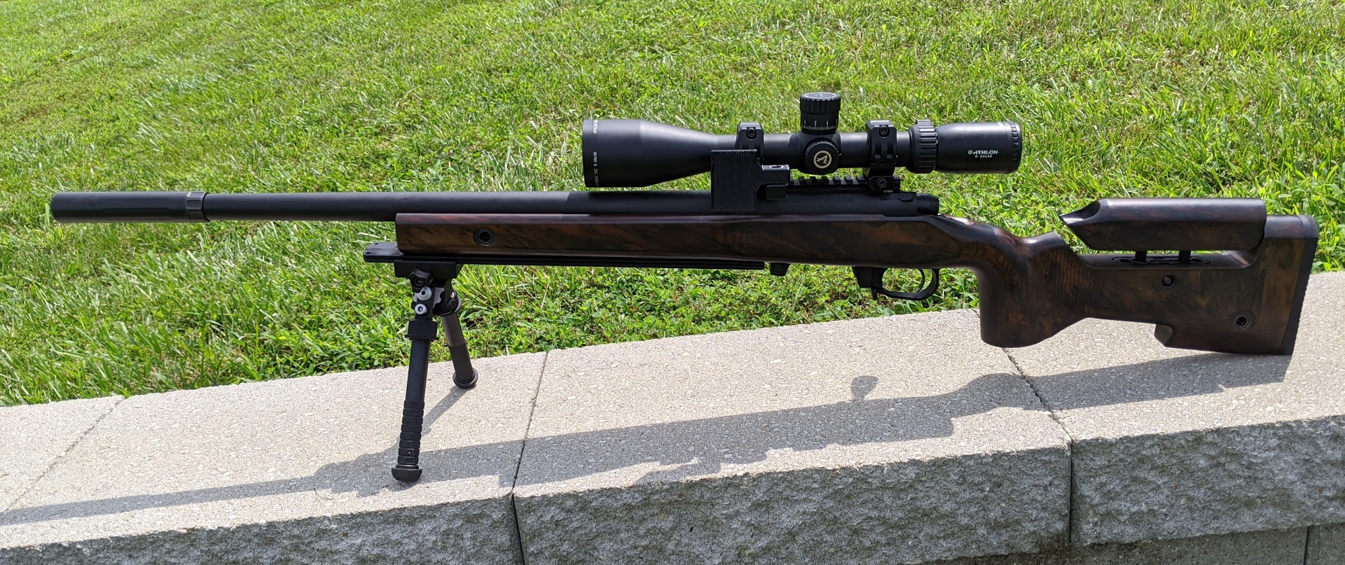

What's the height of the scope rings you're using and how much clearance do you have with the barrel?
They are the "low" height. Clearance - somewhere between 1/8" and 3/16".
Should also note it is the 30 MOA base and M24 contour if you're wanting to get exact on a build.
10.8 with the zco in a Spuhr
Awesome thanks. That’s about 1lb more than my kukri/zco/arc combo.

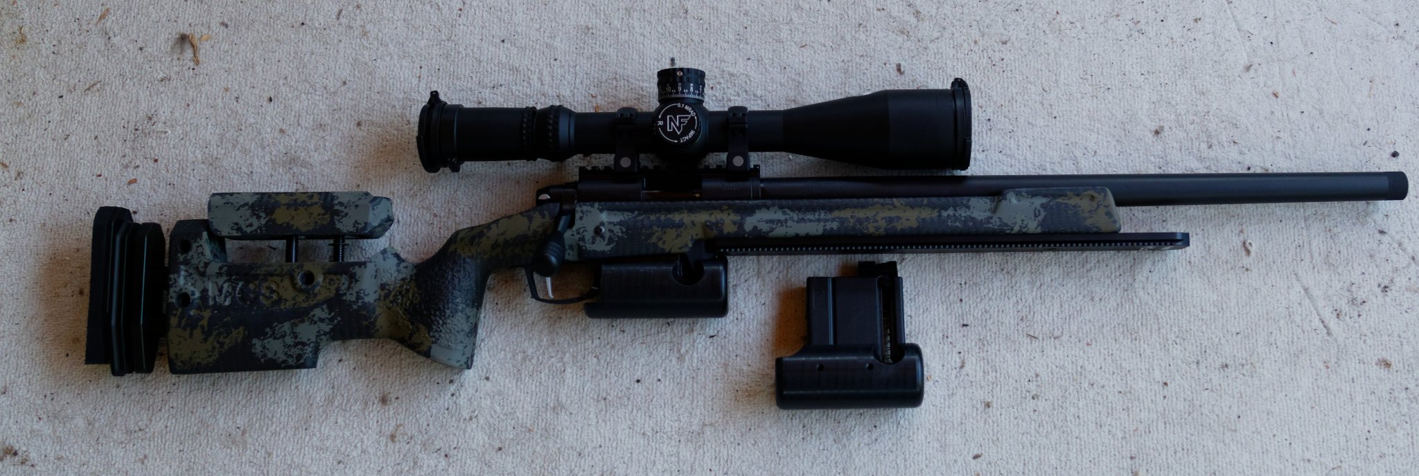

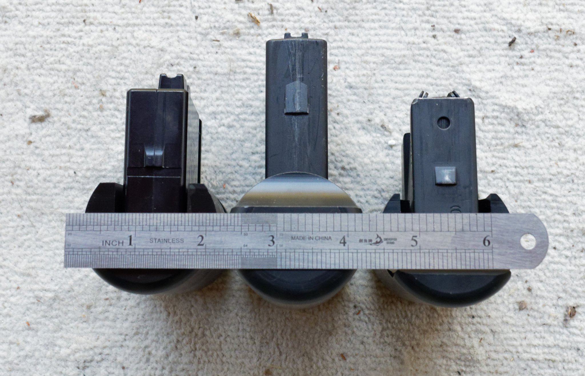

In the photo the mag on the left is the Vudoo 5-shot Al, the center is the Vudoo 10-shot polymer and the right is a 5-shot .223 Rem Accurate Mag.
The weight of the Vudoo 5-shot Al mag is 0.49 lb alone and 0.81 lb with the palm swell. For the Vudoo 10-shot polymer mag it is 0.21 lb and 0.66 lb.

The groups/measurements I posted a page back also showed a favoring to SK Long Range as well. They were all shot with a suppressor on and were good enough for what I want at 100, but to the above point I've not tried without the can.
