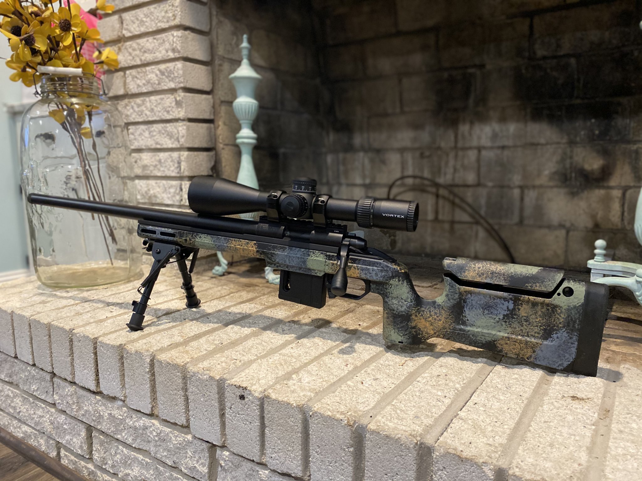

And I just put my new 1:9 twist Vudoo in an AI AT with AX buttstock. I want this one now.

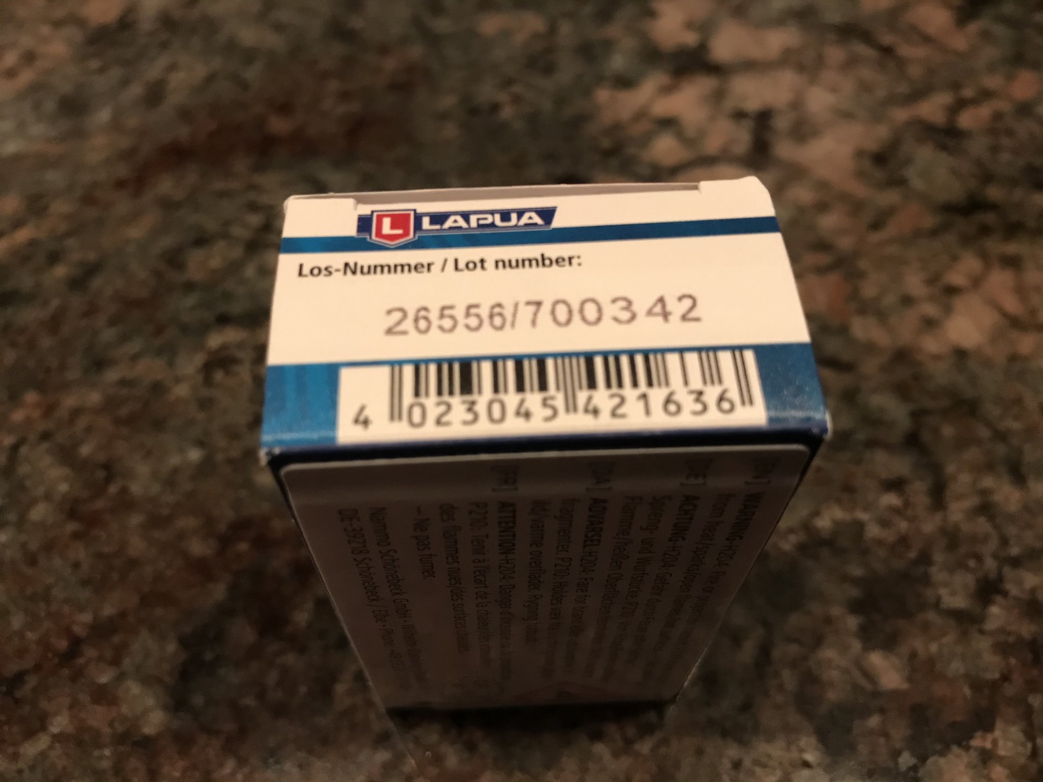

Yeah, thankfully they only had 3 boxes left by the time I ordered or I would have a lot more on my hands to deal with. Thus the post - mostly a "heads-up" for anyone that has purchased a large quantity. They may want to try it out sooner than later as this seems to produce groups 3X the normal compared to any SK or Lapua that I have tried.
I'll attach a pic of the lot number in case anyone is interested.

The 1K rounds I got from CC has from Lot # of 22556/700446, so different from those listed above. I'll try to shoot some Tues and will share findings out of my VGW.

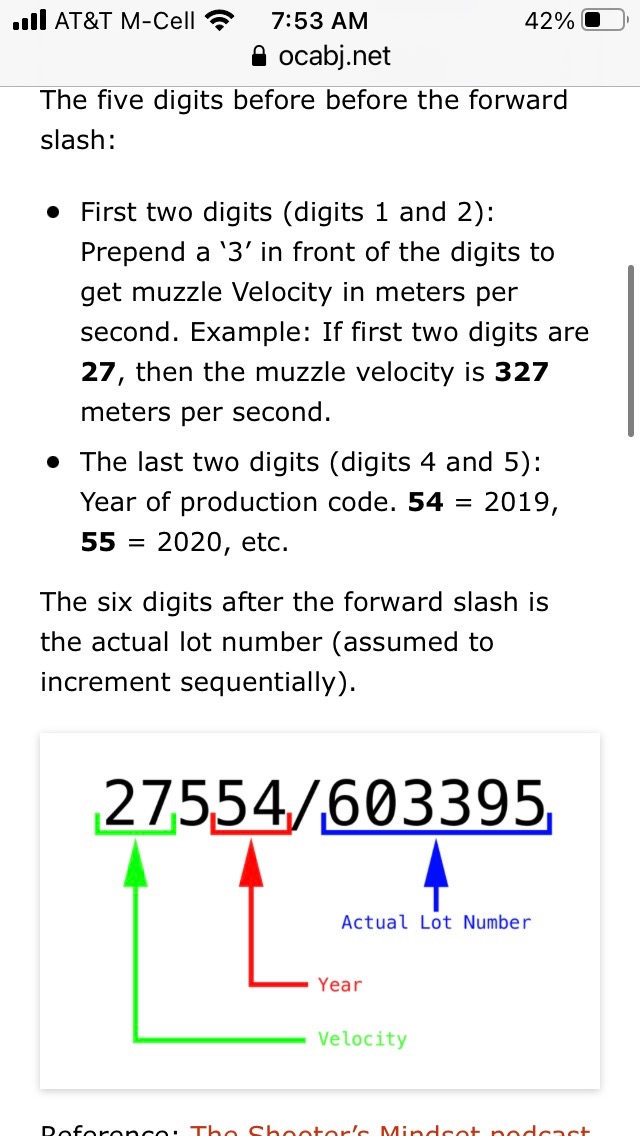

One question for you pros. What constitutes a "lot number'? The entire number or the portion left of the slash? Thanks.

I also seem to remember reading that a portion of the lot number represents which machine that particular lot was produced on (first digit of the lot number, normally 5, 6 or 7 in my lots?), while a portion is the actual/sequential lot number (maybe the last 4 or 5 digits?). Can't remember for sure.
