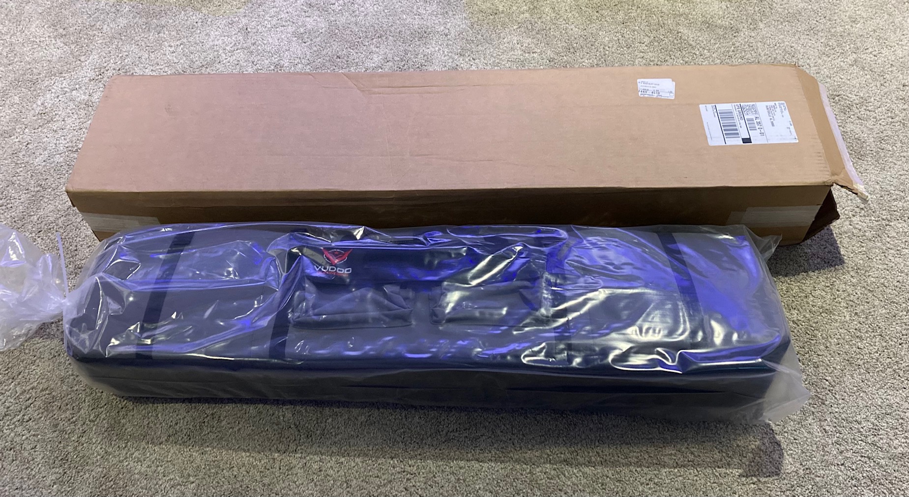

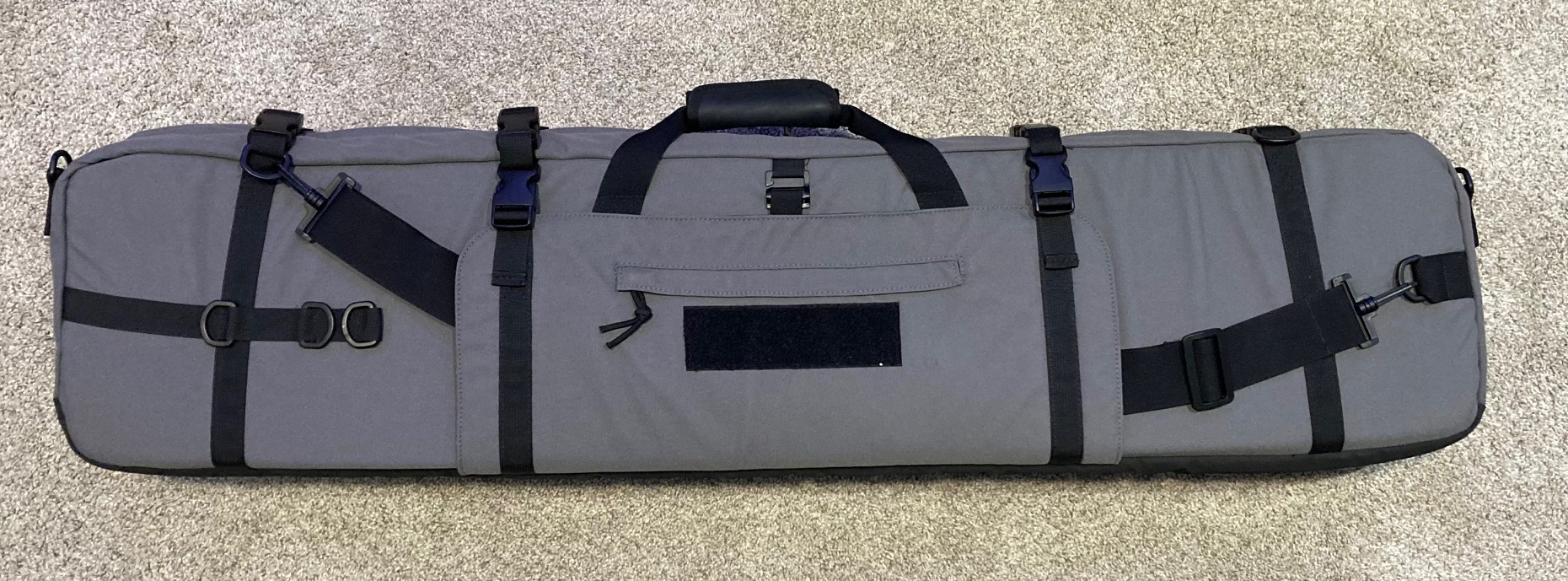

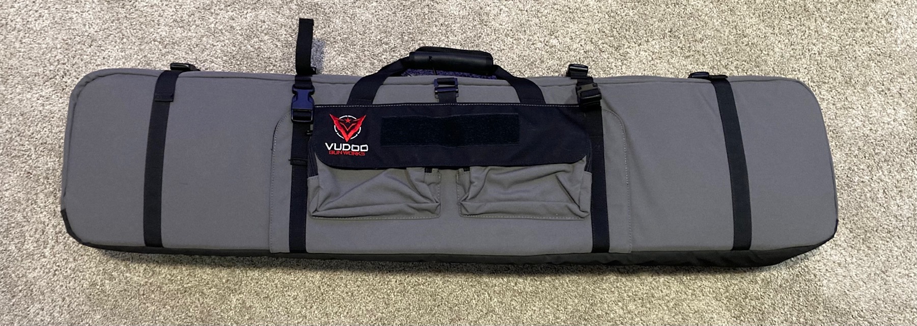

OK, the VUDOO Rifle Bag arrived today. It is clearly intended to be a premium rifle bag system -- and justifiably so. Materials are first class, stitching looks excellent, and it has plenty of padding. I've put money into hard cases, such as Pelican Storm Case and others, for my guns that I needed to ship or travel in airline cargo, but I've never spent close to $400 for a soft bag before, since I really only use soft bags for trips to local gun ranges and matches and don't have to worry about rough handling. So for me, this bag set is a "luxury"... but I don't have any regrets.
Now to the details, with photos.
1. The small bags, panels and accessories came inside the main bag. There's a reason that this was shipped full-length and not folded... the side panels have 1-inch thick moderately dense foam, providing as much protection as you would hope for in a soft bag. The inside of the main bag is 42.5" straight across... an easy fit for my V22 Ravage Ridgeback with 20" barrel. Plenty of vertical space for my Vortex Golden Eagle scope.
2. The front black flap is the only place you'll find a VUDOO logo embroidered.

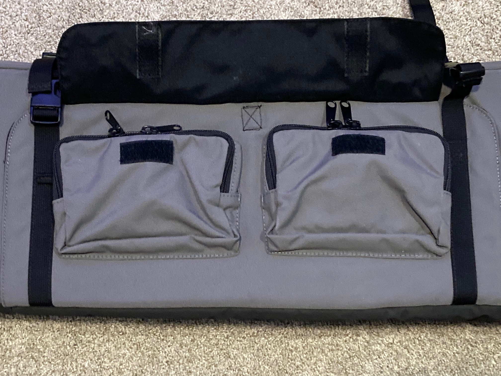

3. Underneath the front flap are two zippered pouches, each of which hold three Vudoo mags comfortably (each with 2 side-by-side, plus one laid down so that the zippers easily close). I carry six loaded magazines to most matches, so that's ideal for me.
4. The rear side of the bag has a flat-ish pouch and several D-rings for choosing where to attach your shoulder strap. The outside bottom panel of the bag has a rubberized coating, which could be helpful if you put the bag straight down on a damp surface. The wrap-around center handle has a similar surface.

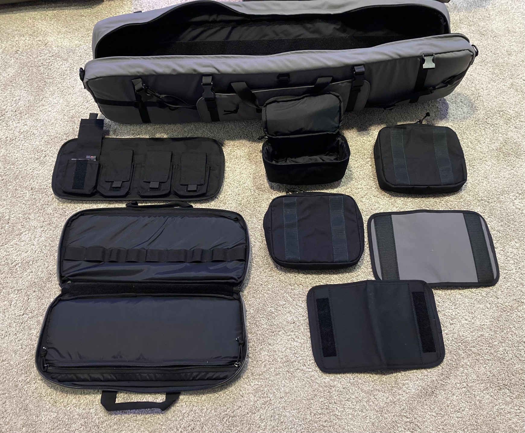

5. Inside the bag were four smaller bags of various types, and two separator panels (one gray, one black) with Velcro for organizing the accessories and bags to suit the owner. The two small, flat bags almost look like they'd be for pistols. The small but taller bag is well-suited for ammo; standard size bricks such as SK or ELEY fit easily, and even the elongated brick boxes of Lapua Center-X or Midas+.

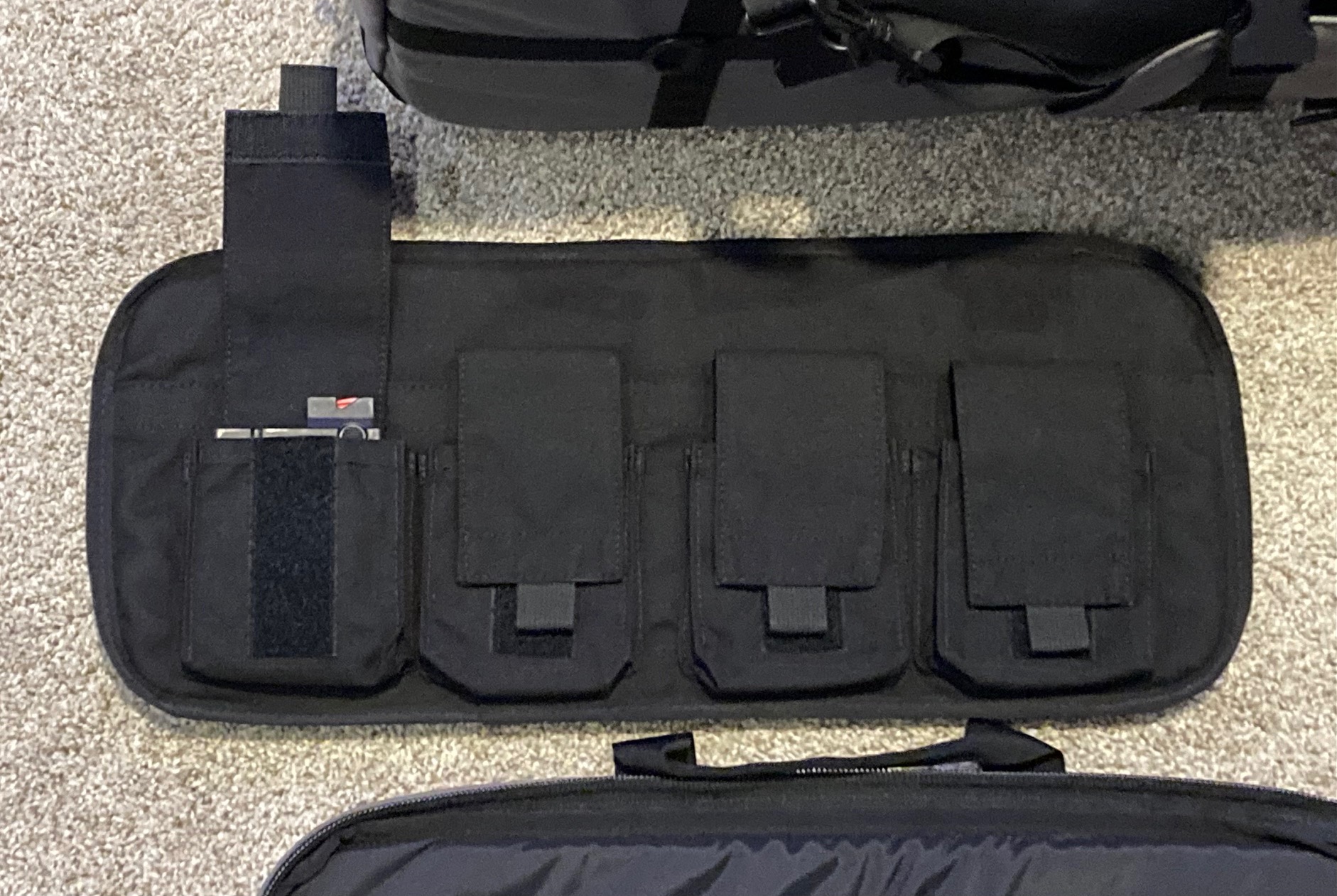

6. The largest of the interior bags has a removeable magazine pouch panel, and each pouch will hold only one 10-round Vudoo mag, giving a total of four... they're not deep enough to double up the mags like the built in pouches under the main bag's front flap.

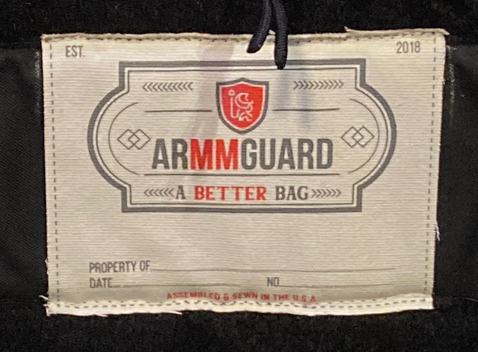

7. This shows the bag's inner label. A google search doesn't come up with any results for "ARMMGUARD" though the label says established in 2018.
I don't know if I'll get any more functional use out of this than my MidwayUSA-branded padded "PRO" bags that are about 1/4 the price, but I'm still very pleased to have it and I expect that I'll find more uses for all the other bags, pouches and panels as time goes on... Besides, none of my other soft bags have that very special red "V" logo!

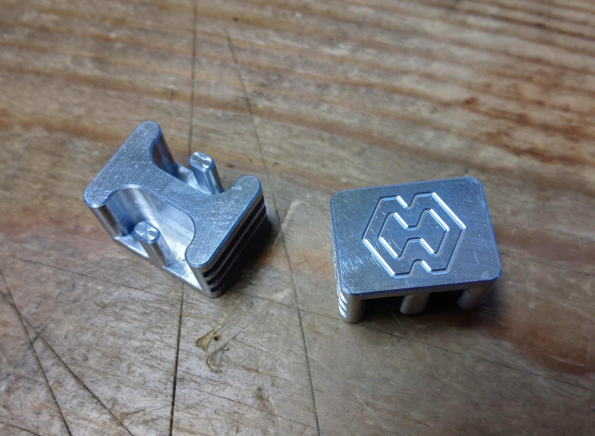

.22lr AICS Loading Tool
Posted a quick review of a new product coming from Marginet Metalworks in Canada; an aluminum version of the 22lr AICS Loading Tool. Only tested on Vudoo Polymer mags, but should work well with B14r or RimX mags. Makes loading these mags much easier.
Check out www.mmwgear.com if interested.
Also have have some footage from our own NRL22/ORPS matches we run up north for people interested on my channel.

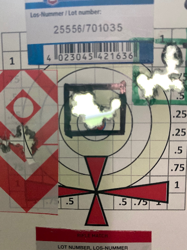

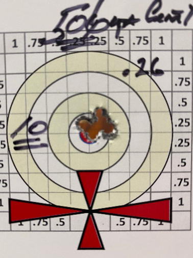

It’s true. If you thread the barrel it will shoot like garbage. This is all I could do at 50 yards with 5 shots. Trash!!! And that’s a barrel with thousands of rounds on it. Will probably keep opening up. Lol
