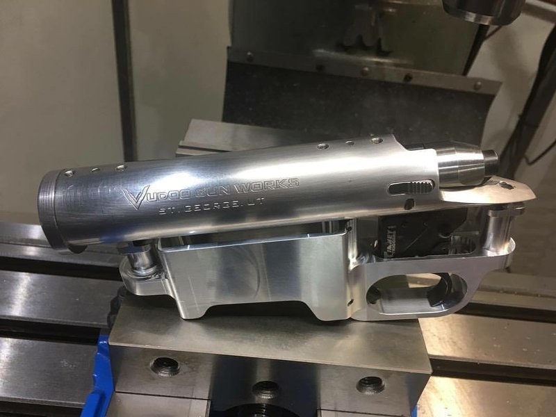

Getting ready to order a Jewell HVR for the V-22 - hard to tell for sure from the photos I've seen online, but it does look like the action has a bolt stop on the left side. Need to know for certain before placing the order for a trigger. Any of you guys who've ran this action who care to reply, I'd appreciate it.
Flat, there's a bolt release on the left side of the receiver (for the right hand action). No need to buy a Jewel with the bolt release or just remove it from the trigger.
