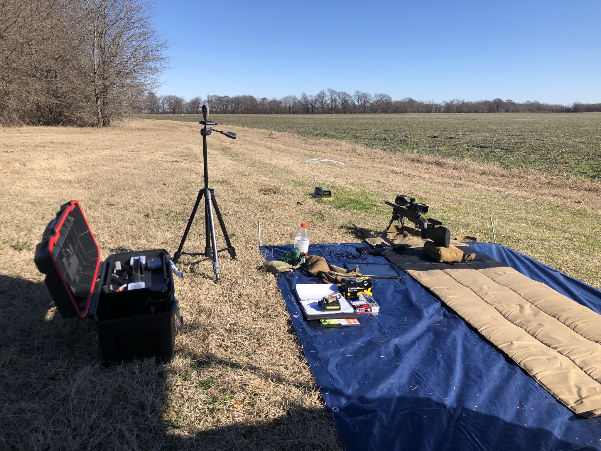

Got some much needed trigger time today. Although the wind was pretty brutal it finally let up enough the last couple hours of day light to gather some useful data. Was shooting steel gongs at 200, 300, and 400. Man what a blast hearing that steel ping almost 2 seconds after you pull the trigger. The more I shoot the gun the more I love it! I did learn, at least with my Vudoo, it will shoot lots of ammo great out to 200+ yards. Once you get to the 300 & 400 range the Center X really starts to shine. At 400 I could hit the 10“ gong with about any ammo I threw at it, with good consistency. But with the center x the 8” and 6” gongs were ringing every time I sent a round at it. The 8“ was almost boring. The 6” was a little more of a challenge with even a slight breeze. I’m still learning to read the mirage and today was a great learning experience. That being said, I do have a question. I’ve been using StrelokPro with my weatherflow meter and really like the combination. I’m getting pretty good results using the truing feature on BC. I’m just curious as to what drag function most are using on strelok. I have heard that G1 and RA4 are exactly the same under a certain velocity. I’m getting different results between the two. They are close but do differ. So, is one better than the other or just use the one that gives the best solution? Sorry if this is a dumb question and I know it’s been asked before but I didn’t see anything recently. I’m fairly new to the rimfire game and still soaking up all the knowledge I can. Thanks for the help and thanks VGW for such a fun gun to shoot!
