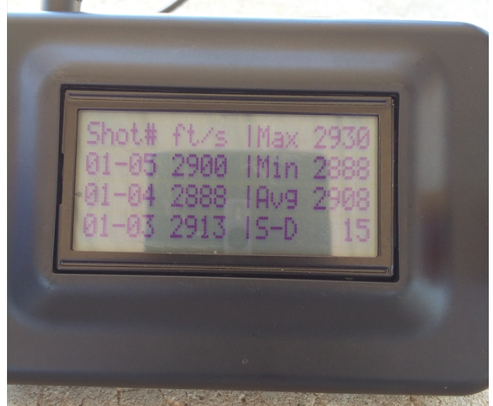

WC857 continues to impress in the velocity department. Tested 72.0 & 72.5 grains with the Berger 180's. 72.5 ended up as follows:
Mission accomplished to safely break the 2900 fps barrier. Tested RamShot Magnum to 69.5 grains and got the following confirming again its slightly faster:

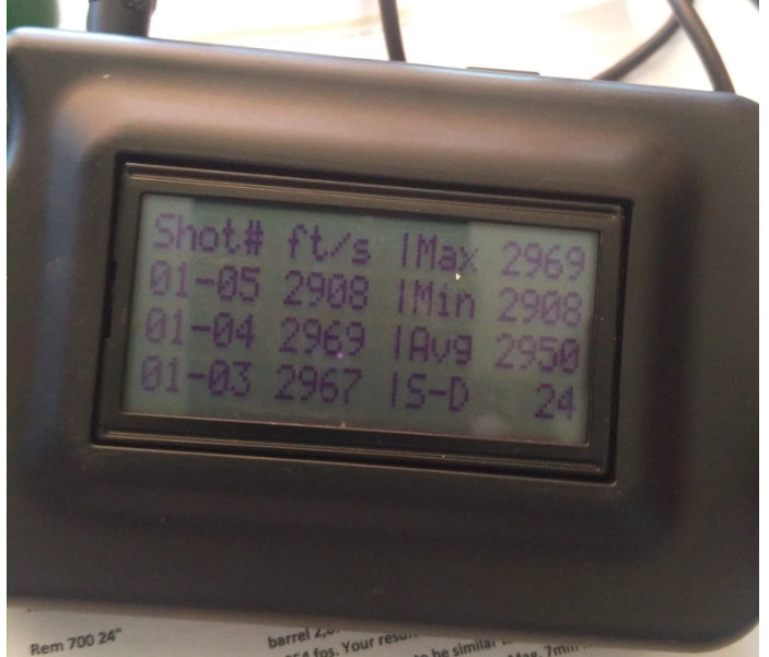

So finally got my new 27" 7mm mag 1-8 twist barrel in last week. Initial chrono test done today after about 50 round through the new tube. Only got a roughly 40 fps increase. Thought it would have been a bit more with 3 extra inches, but is what it is. Maybe I'll pick up a bit more speed after more use. Did get a better SD value. Once I get 150+ rounds through it I'll test again.
Berger 180 LRHT, avg 2949fps, SD=4, 72.5gr WC857

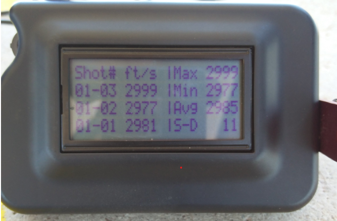

Did some more experimentation today with this powder in my new 7mm Mag. Round count now totals 121. That same load (Berger 180 LRHT, avg 2949fps, SD=4, 72.5gr WC857) now produces about 35fps more:
I also upped my load by .3 grains to 72.8 . While that definitely put me over the 3k mark, rounds became too difficult to extract. In my rifle with new PPU brass 72.5 +/- 1 grain is about it.

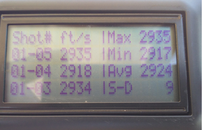

The real surprise was finally testing the Berger 190 LRTH. Accuracy was VERY good out of my 1-8 twist and already getting well over 2900 fps with no bolt lift problems at 71.3gr of WC857. Can easily go another .2 grains, maybe more.
