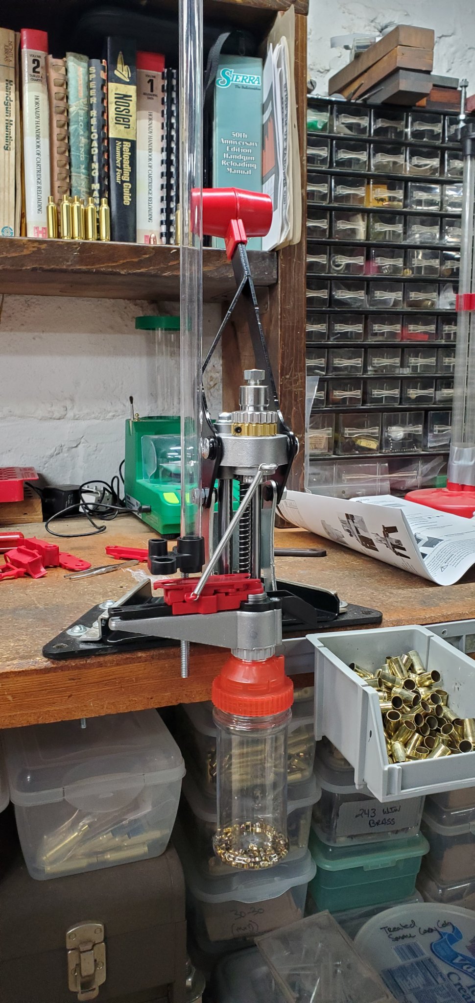

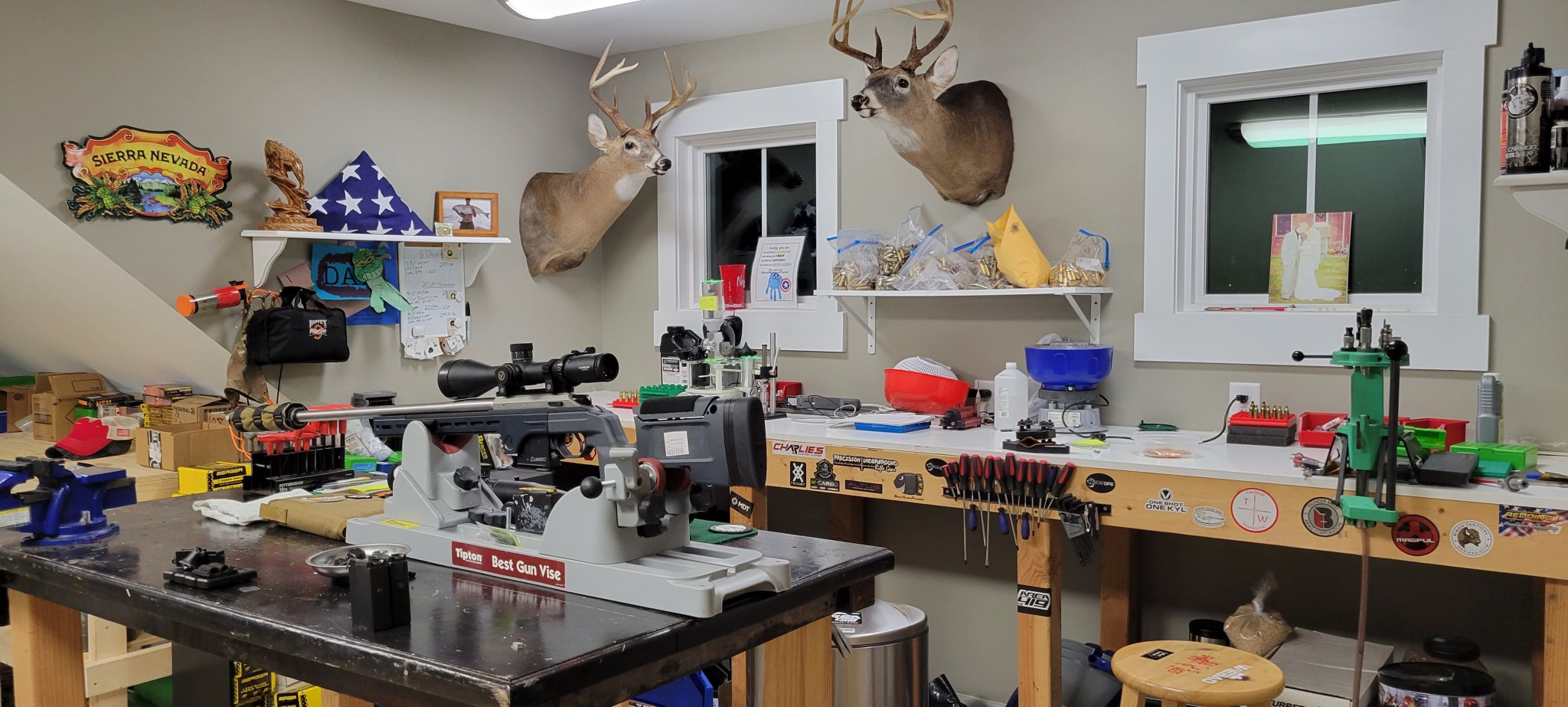

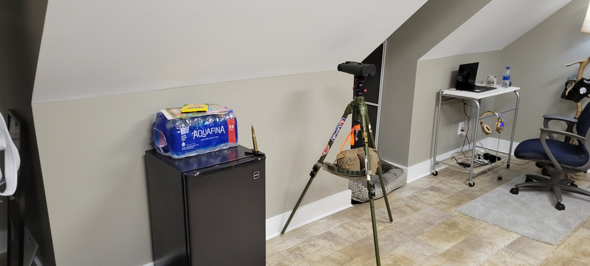

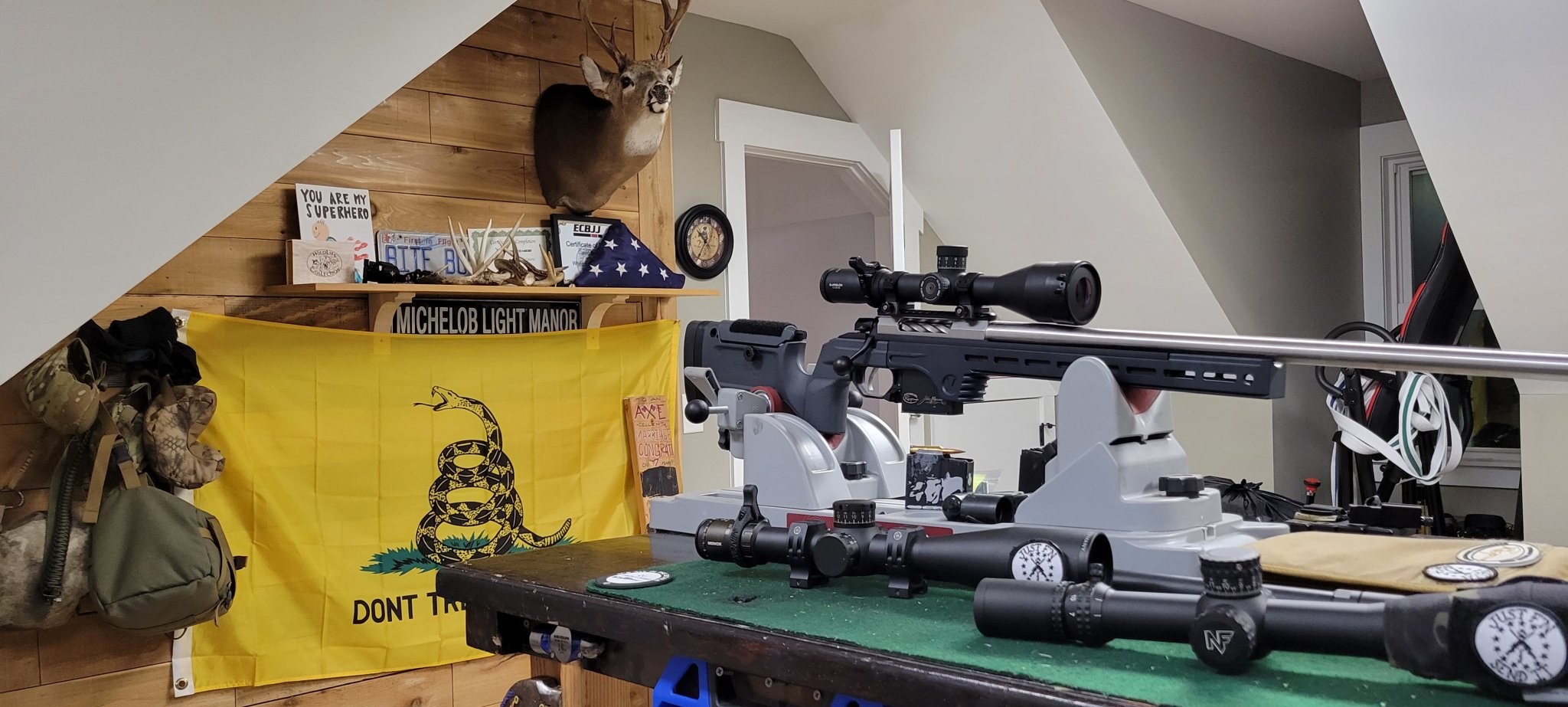

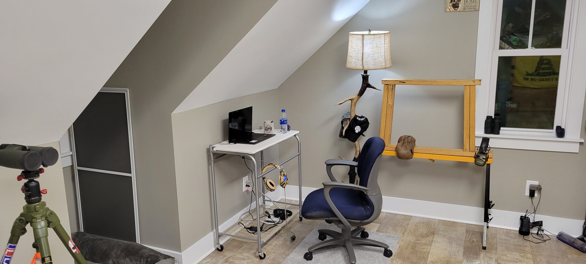

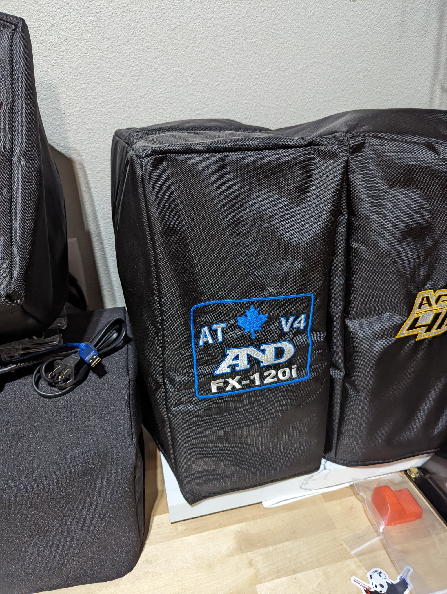

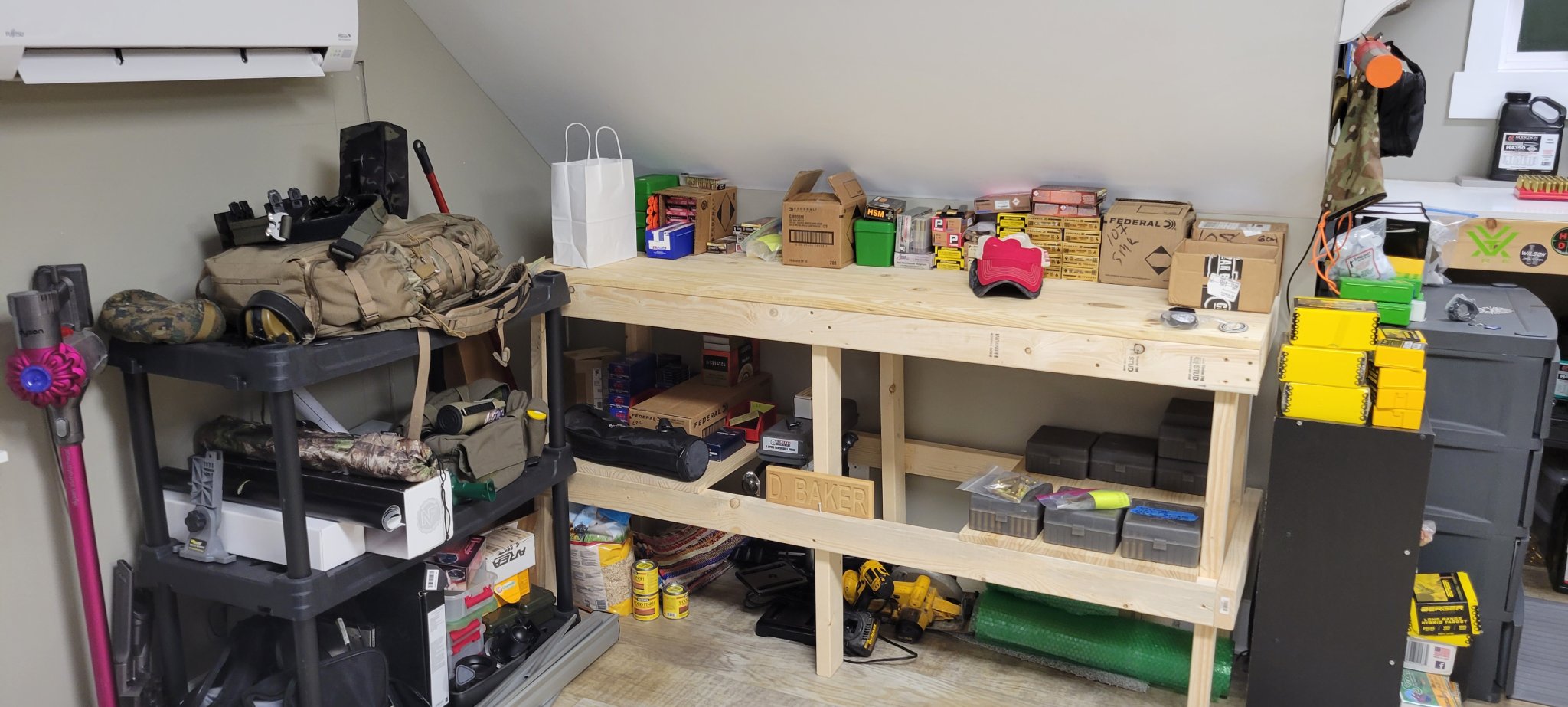

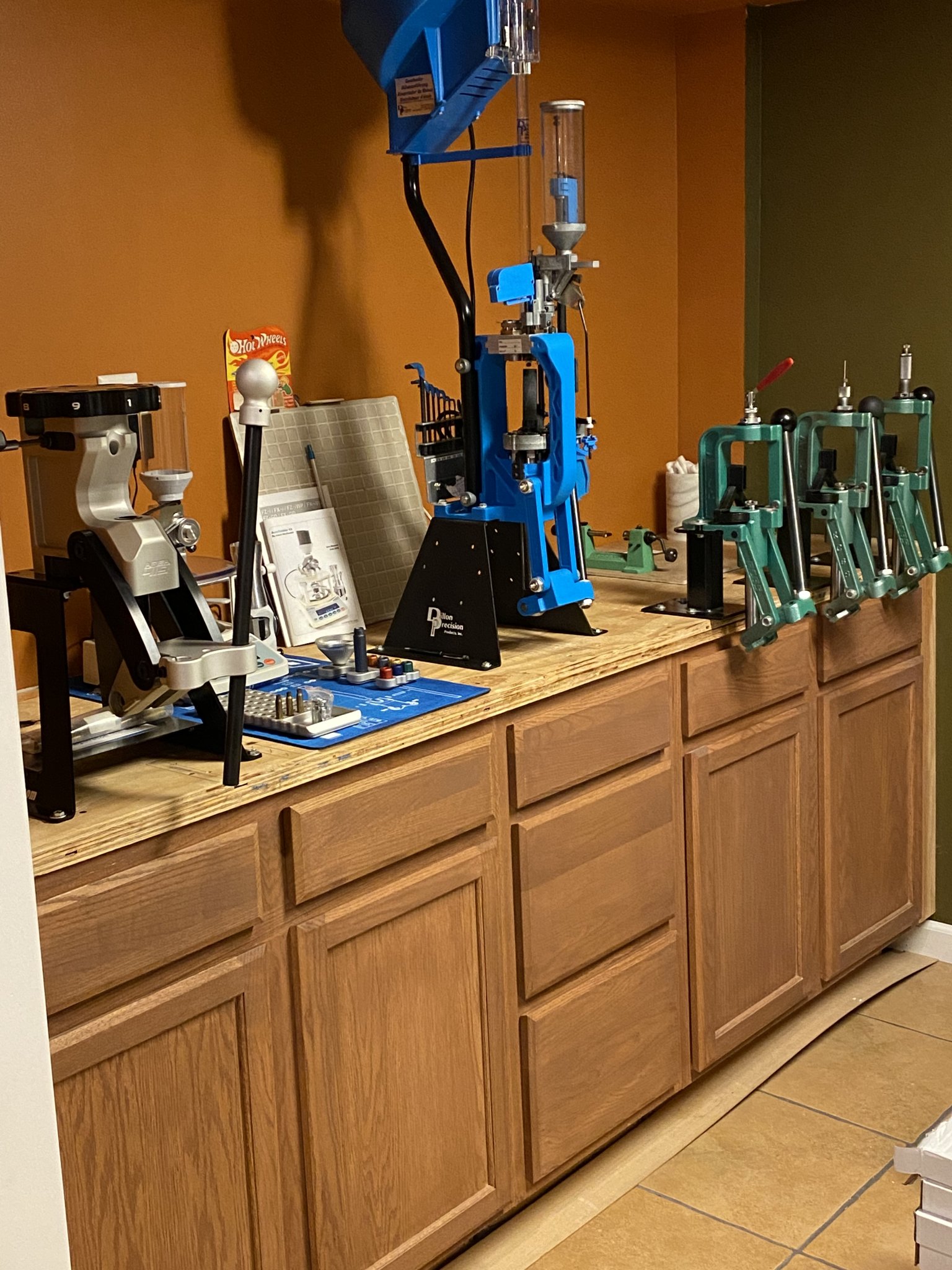

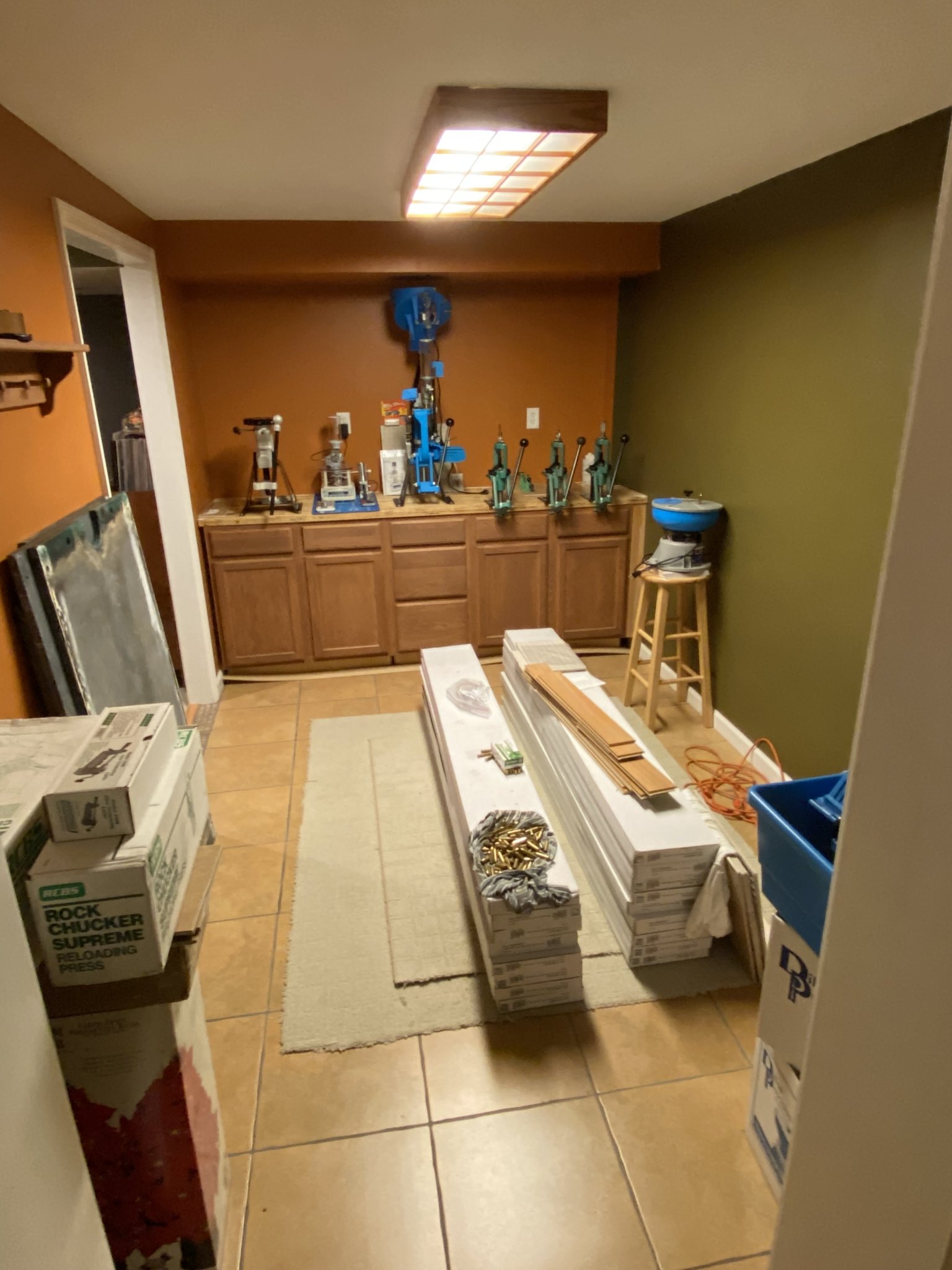

Finally getting time to rearrange my presses to add the zero and the v3 (v4 will be a 2nd option soon). Gonna make another counter top on the green wall for 3-way trimmer, tumbler, barrel vice, and other prep work area.

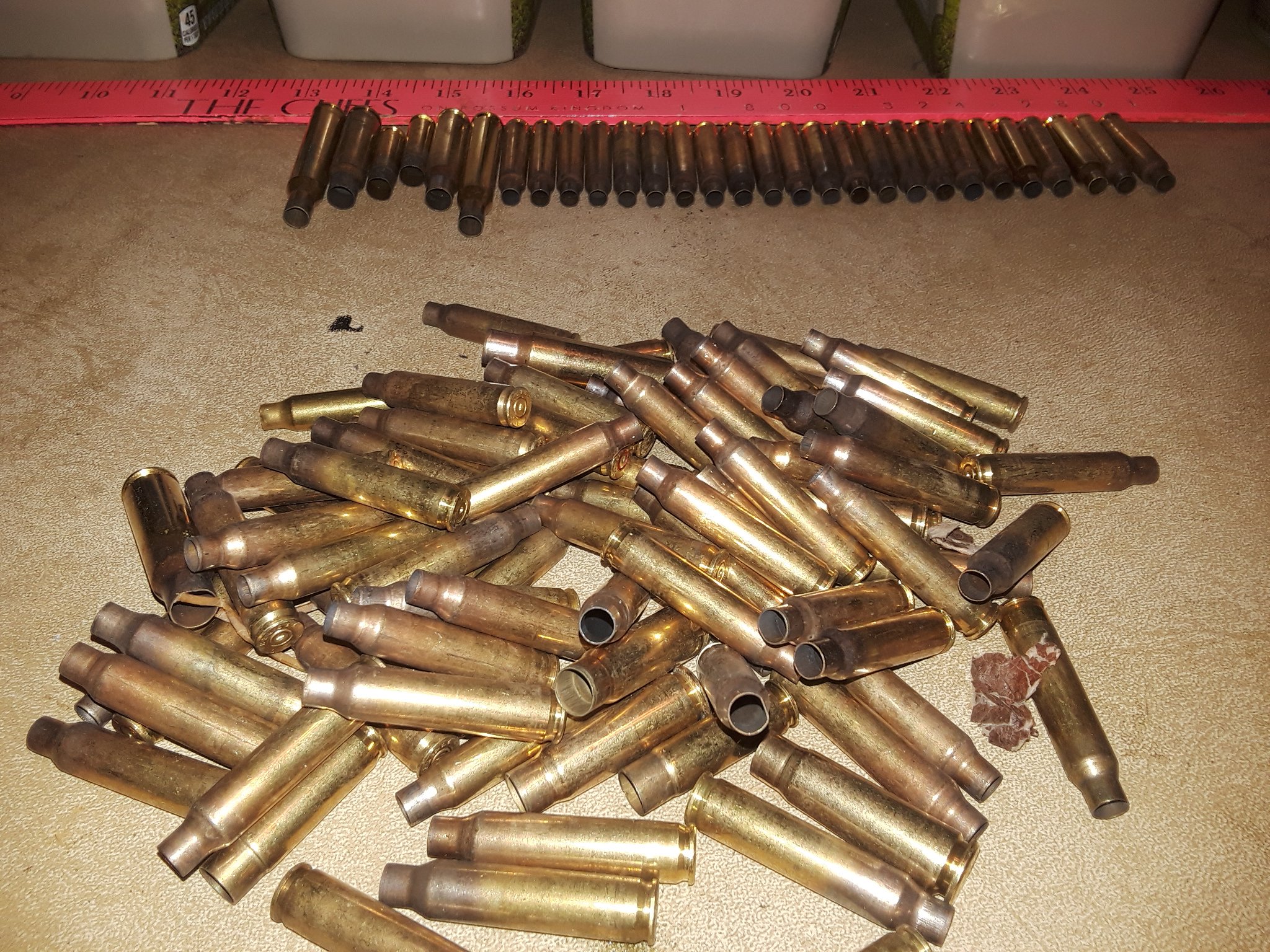

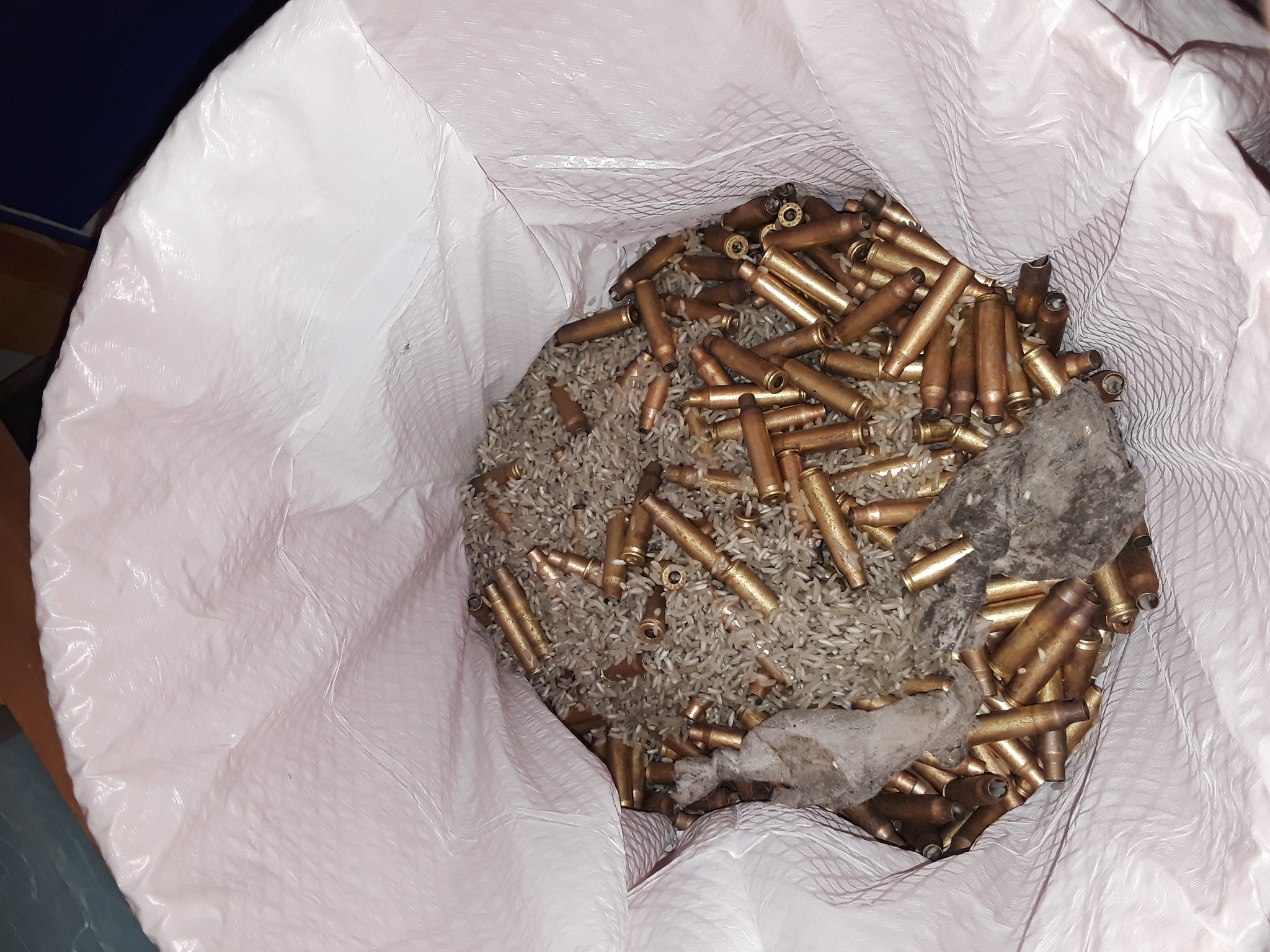

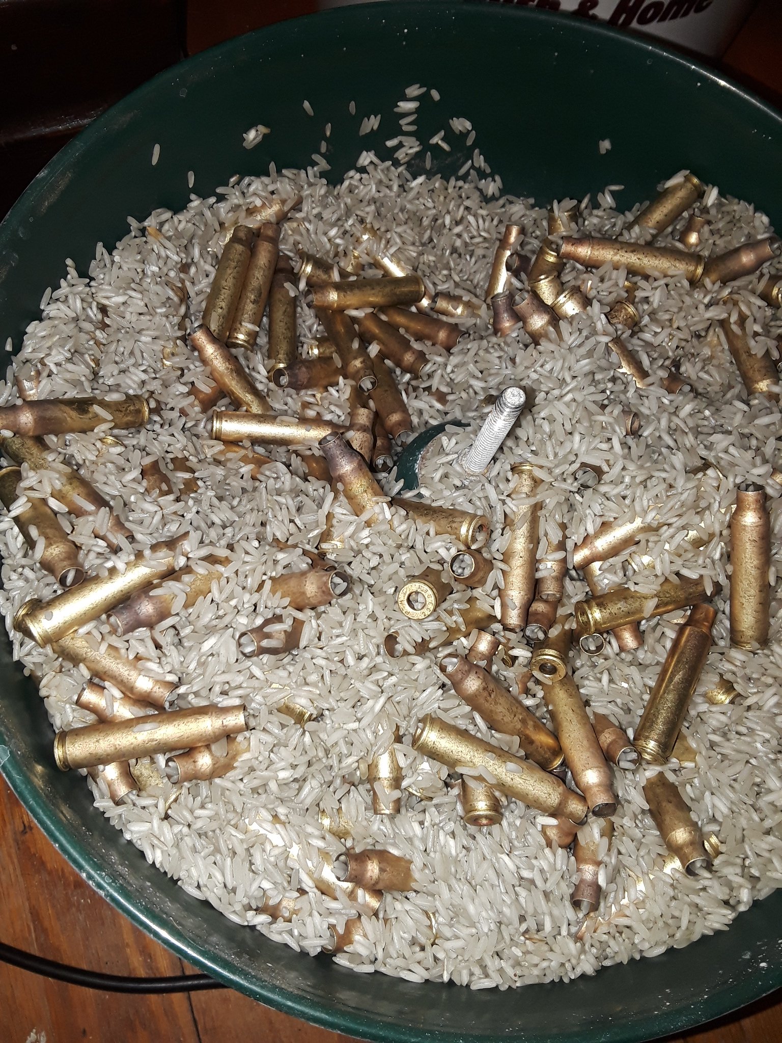

I have come to a revalation !
Liquid car wax and rice make better concrete than a tumbling media.
The car wax and mineral spirits released the starches in the rice and turned to concrete before flashing off. I know, dry works.
I wanted a slicker wax buildup.
Back to pet bedding wallnut for me.

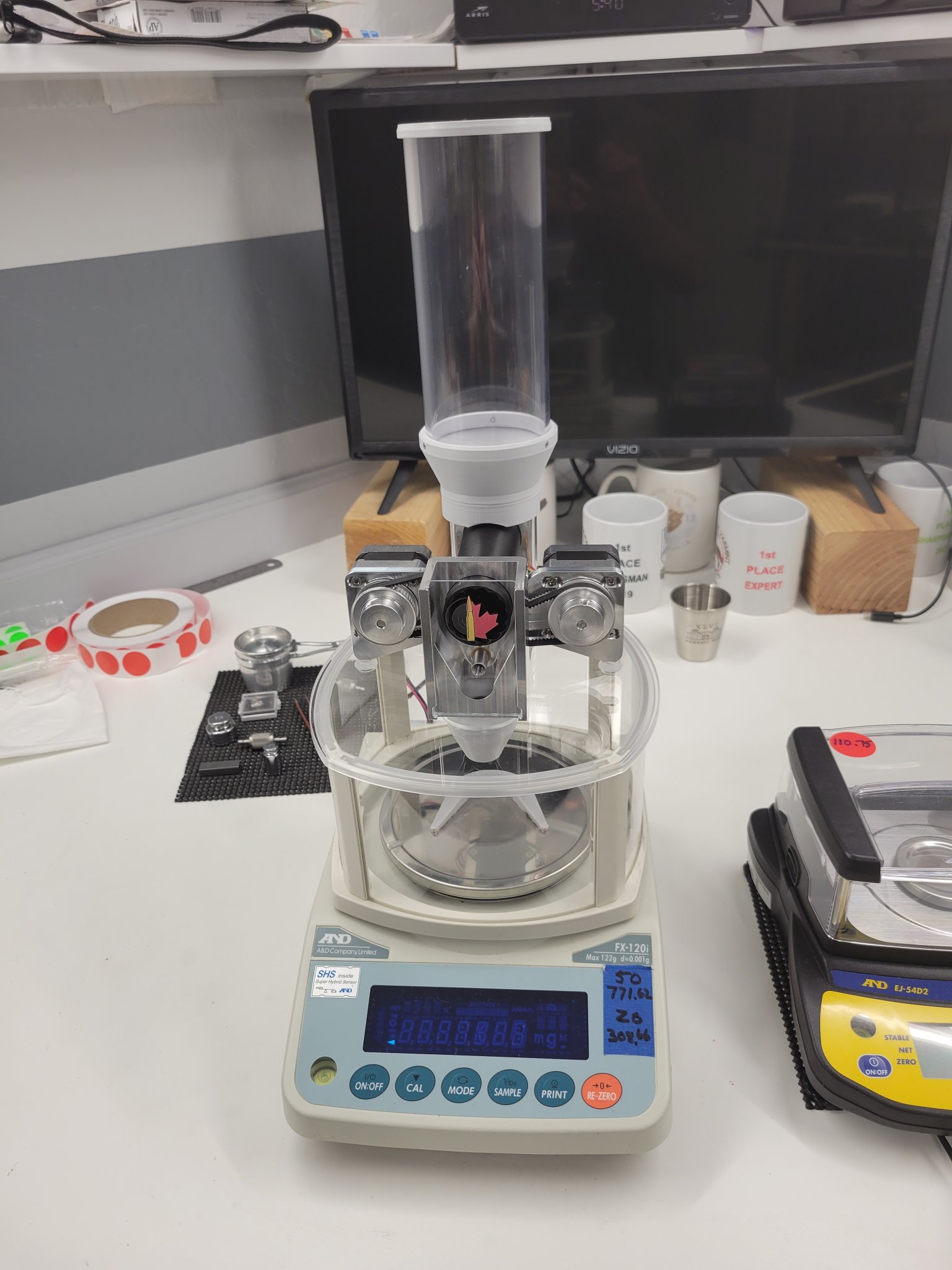

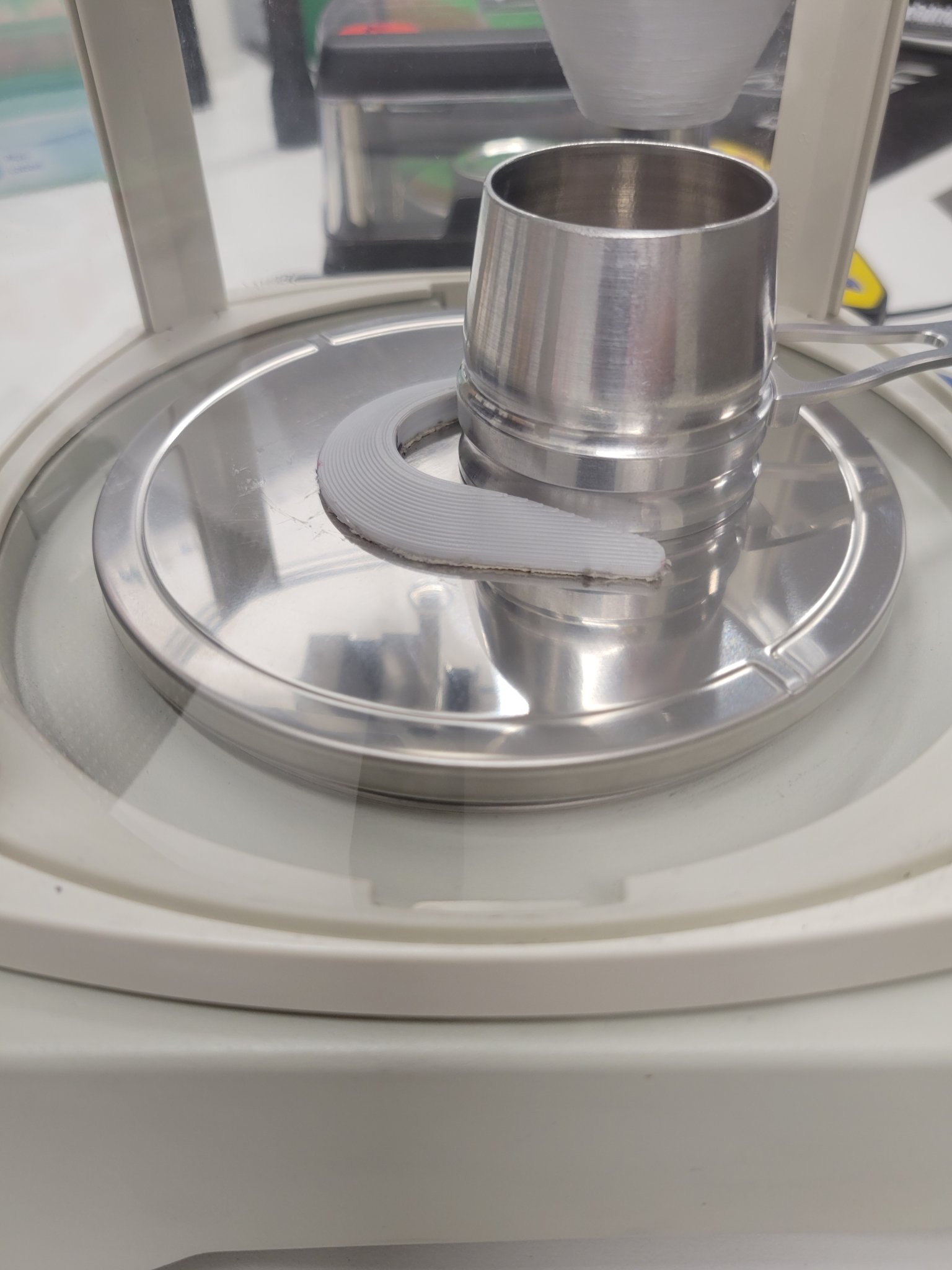

You put the platen guard that far back? I honestly like the V3 more... Lol. It's way faster.
Yes. And the hole is set back a bit so it is dropping off center. I had to dial mine in. Check under settings and see what the flow rate is after calibrating. Mine was .08. I shimmed the back rubber under the hopper with another thinner piece of rubber. Recalibrated and it was at .17 for flow rate. Set large wheel to 5 and small wheel to 7. Runs a load every 6 to 10 seconds. Which is a little faster than my V3.
Tried a few, gave up.
It was range pickup brass.
Only investment was pickup and deprime so not a big loss.
Disappointed in my judgment.
So many people using it thought I would try.
I'll stick to my standard, I like the outcome. Bullets seat butter smooth.
I figured I owed the guys a good laugh.

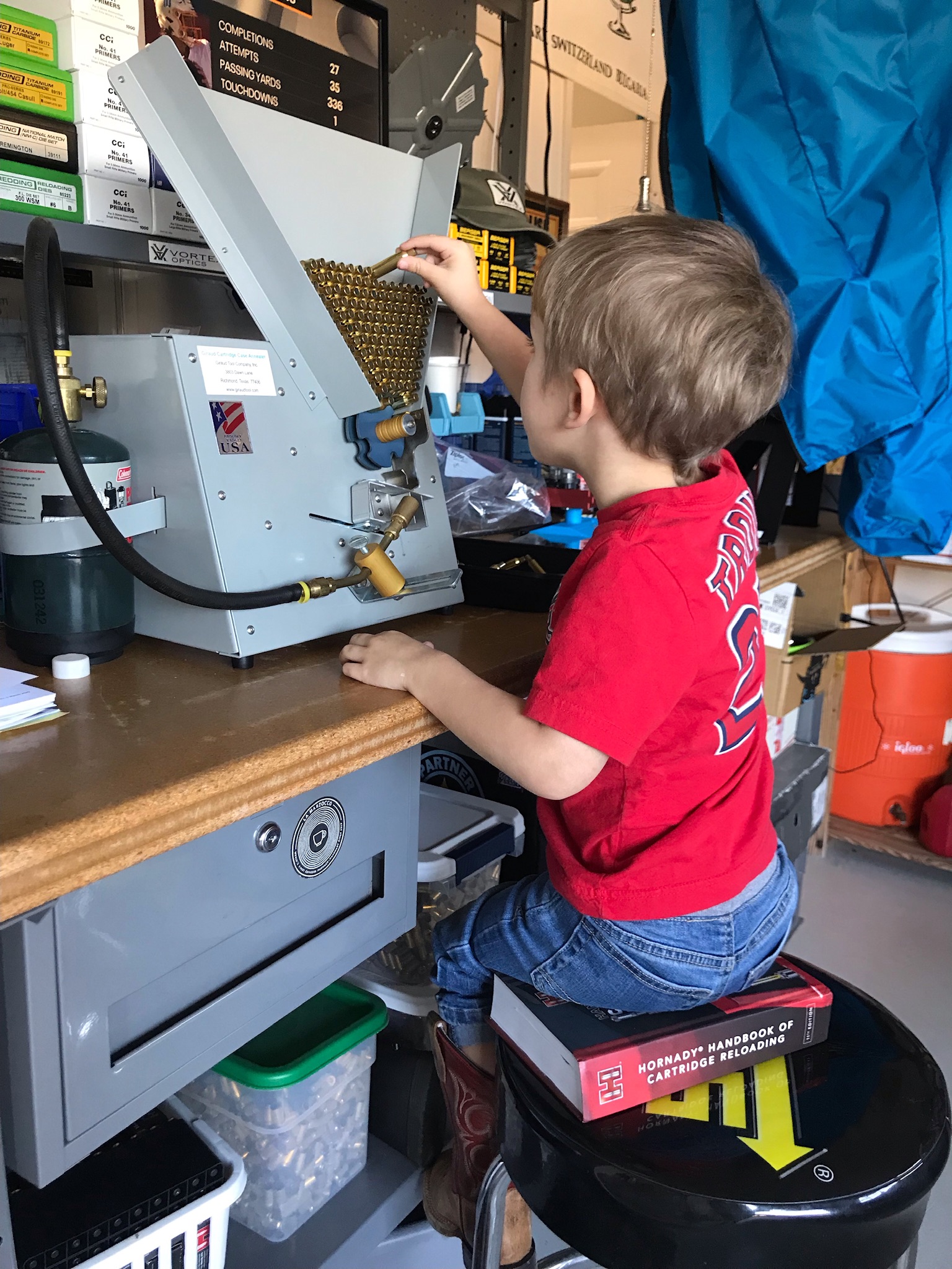

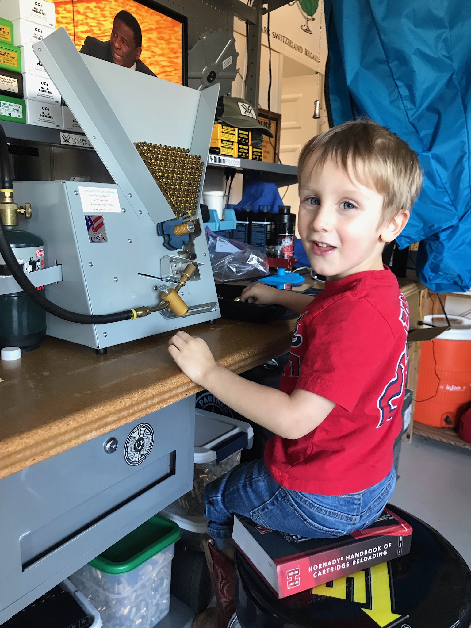

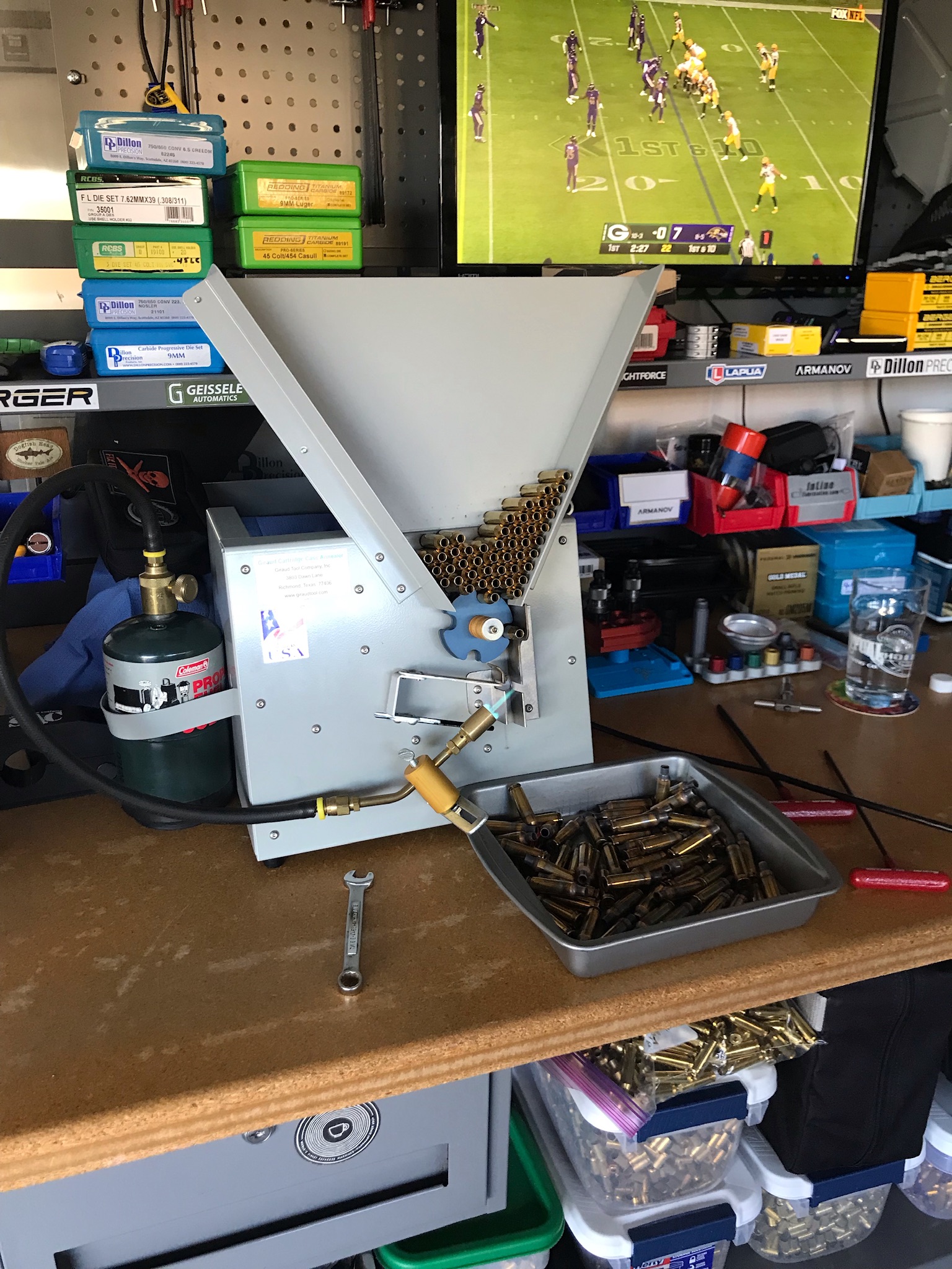

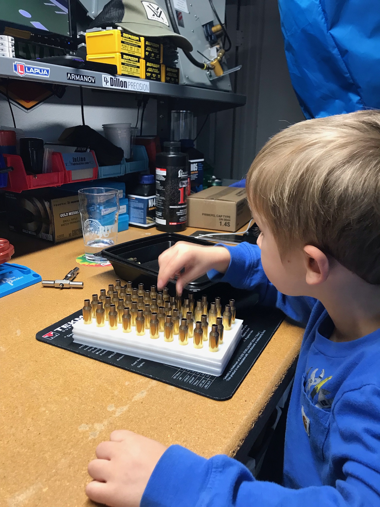

Got some annealing done…
Recruited my grandkid to help…
Grandkid really like helping so had him load the hopper for me while he was visiting today. Had to get a booster seat so he could reach.
He counted to thirty all by himself so it has turned into a very educational endeavor.

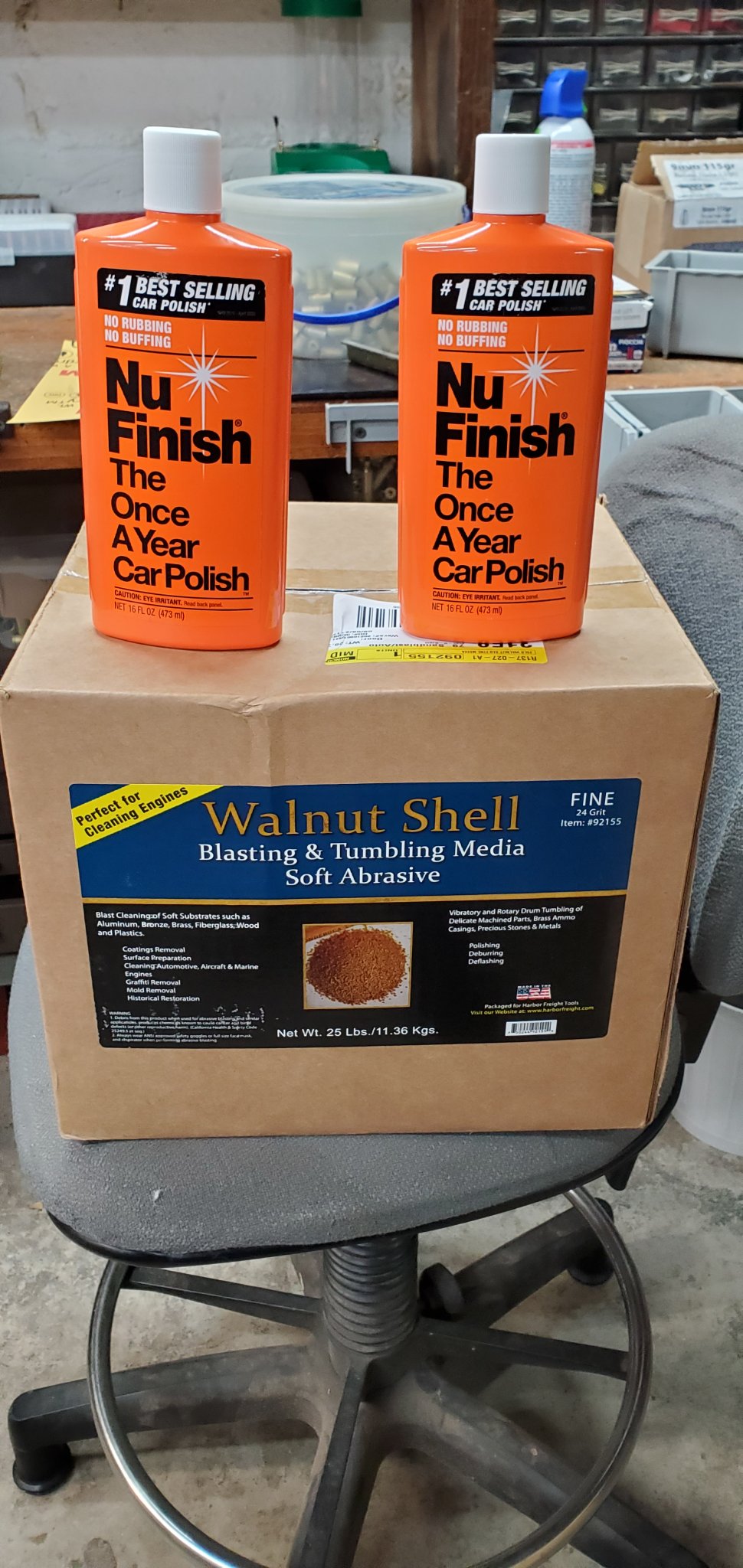

Restocked the tumbler media and added an APP for 9mm processing. What a marvelous little gizmo.
Is that wallnut small enough to pass through flash holes?
I use lizzard pet bedding and the same nufinish with some mineral spirits to cut it.
After it flashes off dry it will poor through flash holes.
I use lizzard pet bedding and 5he same nufinish with some mineral spirits to cut it.
I have not had any problems with this media getting stuck in primer holes. I make sure to get the 24 grit (fine). The medium grit will pack the pockets full (don't ask me how i know lol). I thought about going to pins and wet tumbling and then abandoned the idea...... dry has always served me well enough.

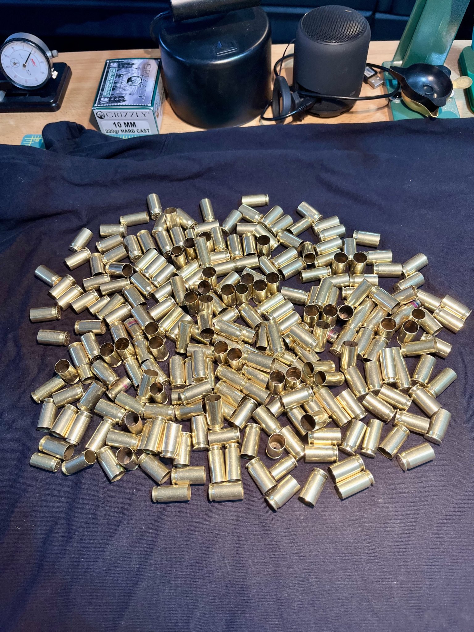

So I dorked around a bit with the swage system today. It's pretty neat. I kept thinking it was about to fail since it basically sits on a flat plate, but it works. I actually bought mine for a similar reason. A friend had Covid, and decided to do something nice for me, so he cast me a bunch of 10mm bullets, but he forgot to size them because he had a fever for a week and his brain was off a bit. I didn't want to ask him to do it, so I bought this. Glad I did.
