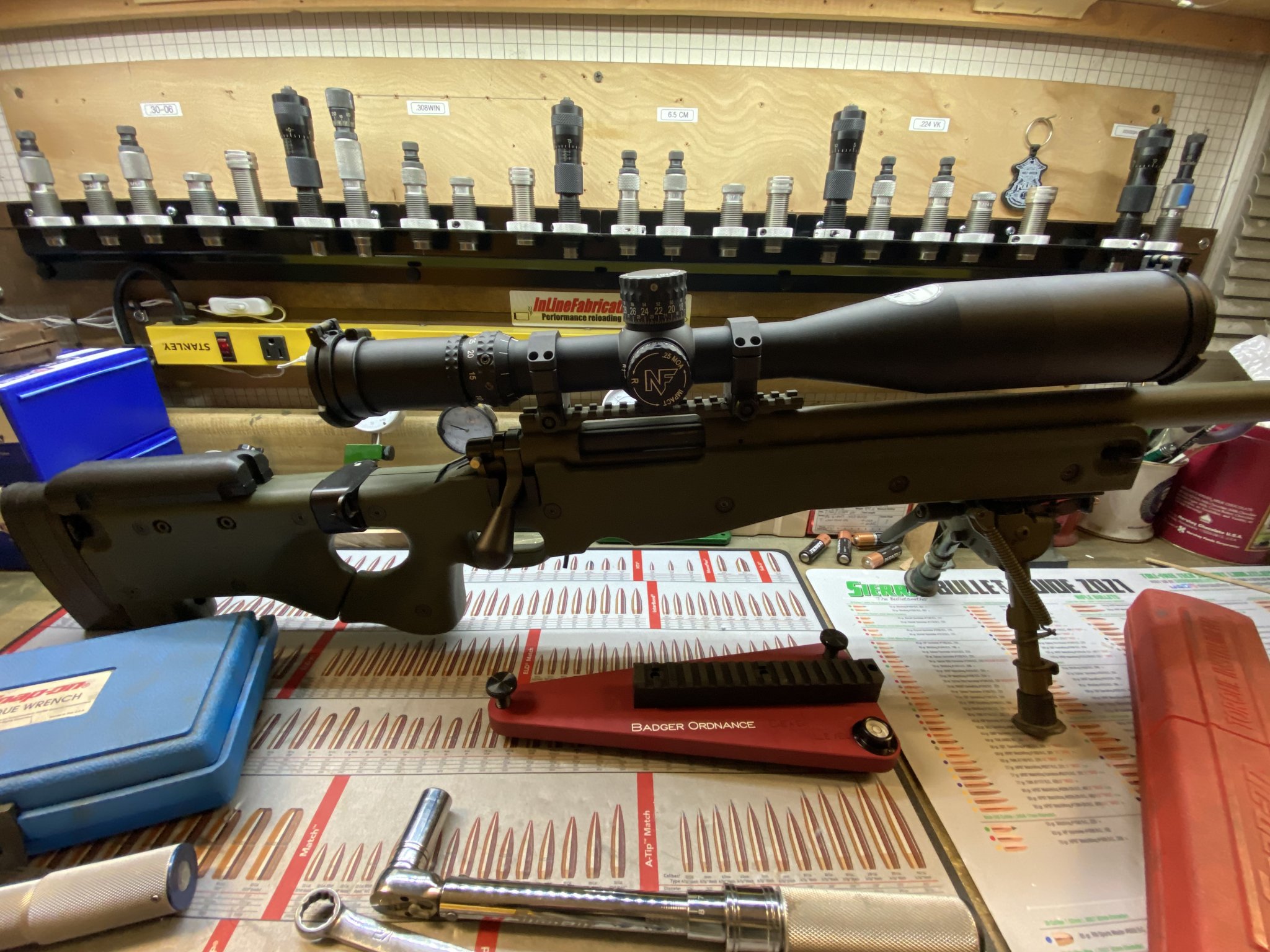

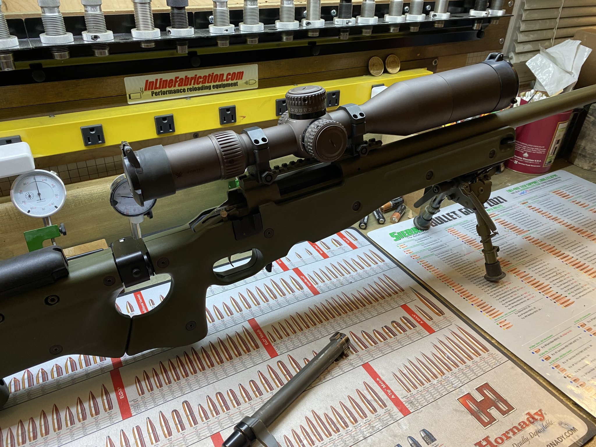

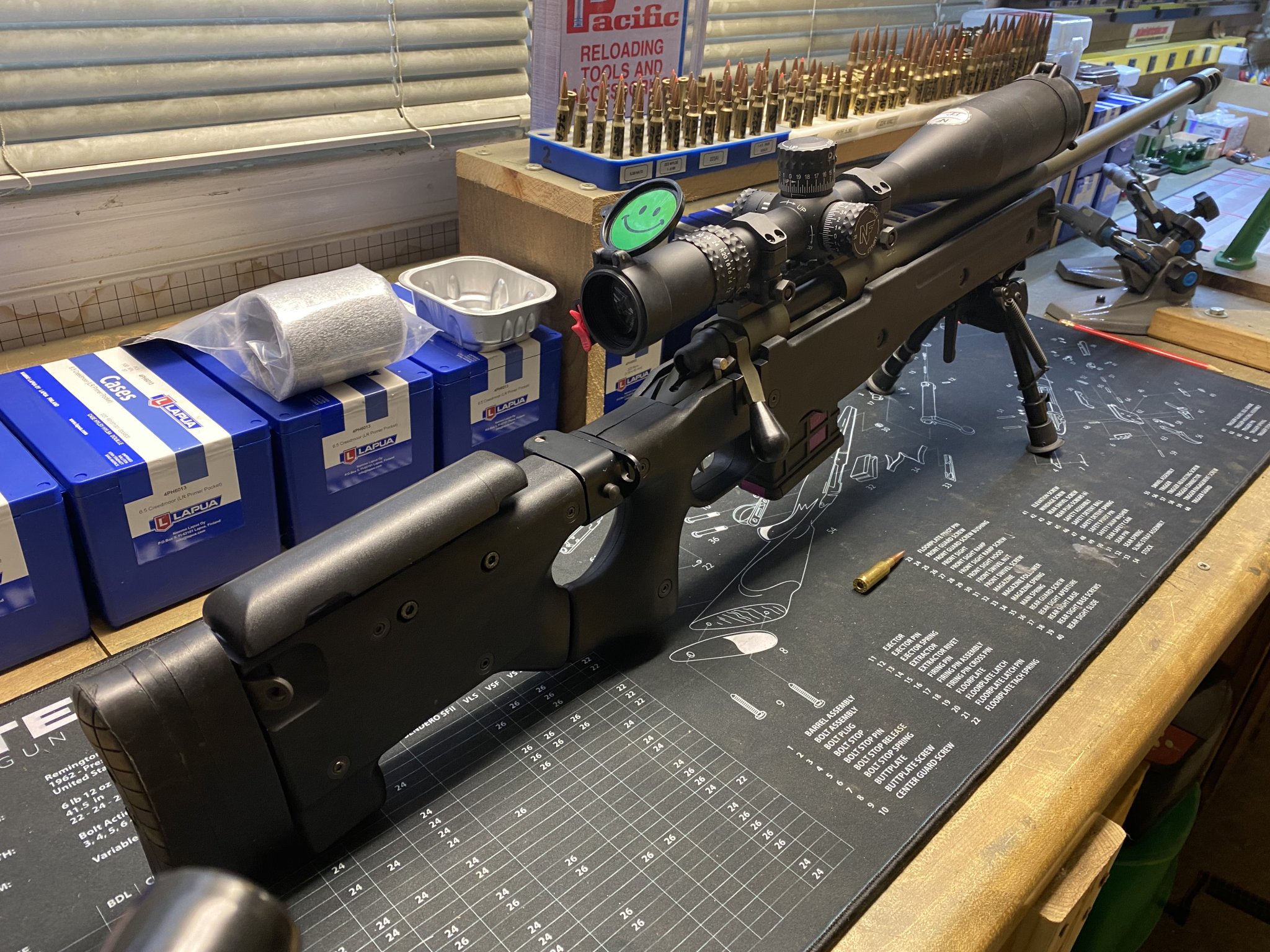

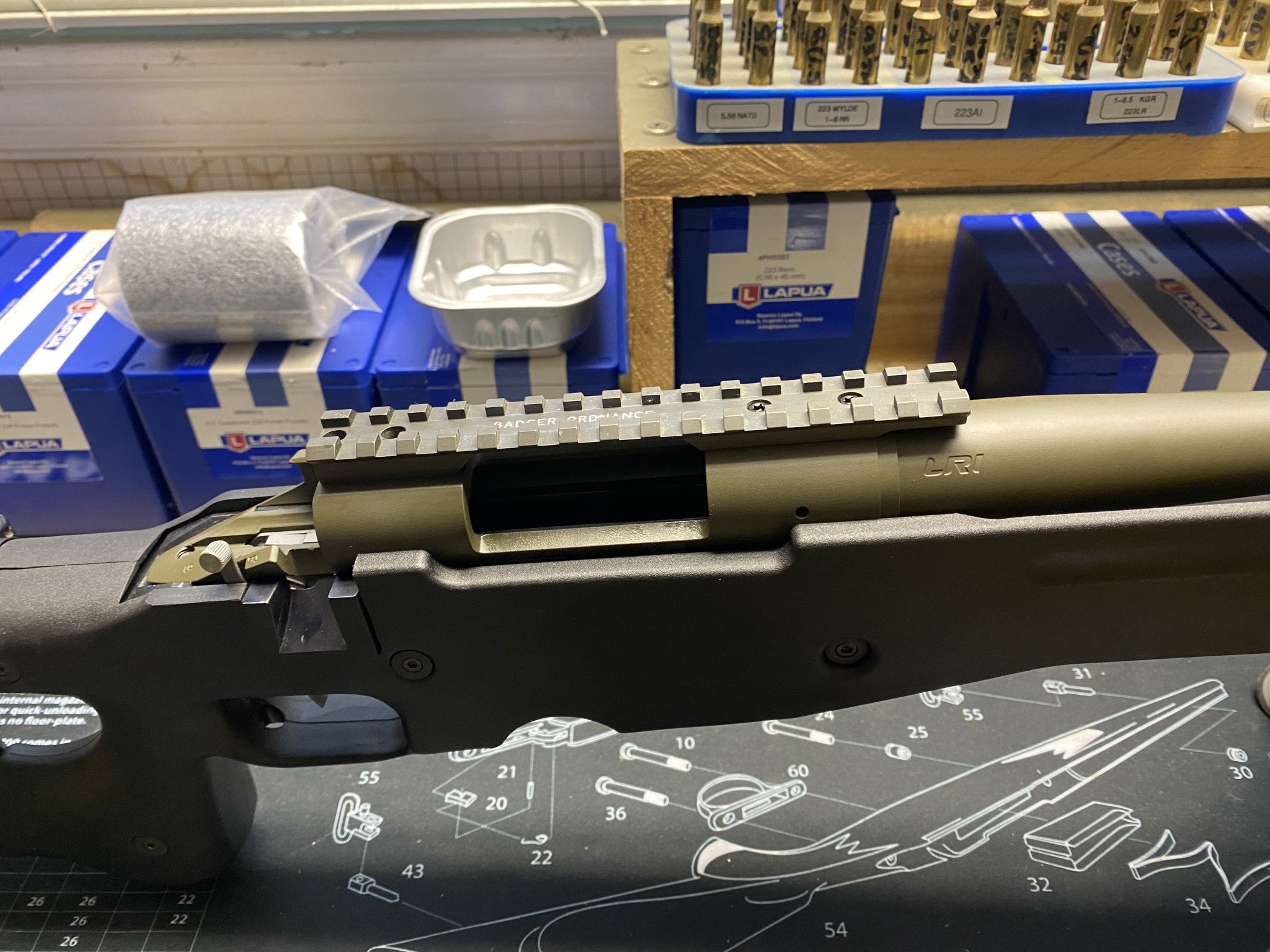

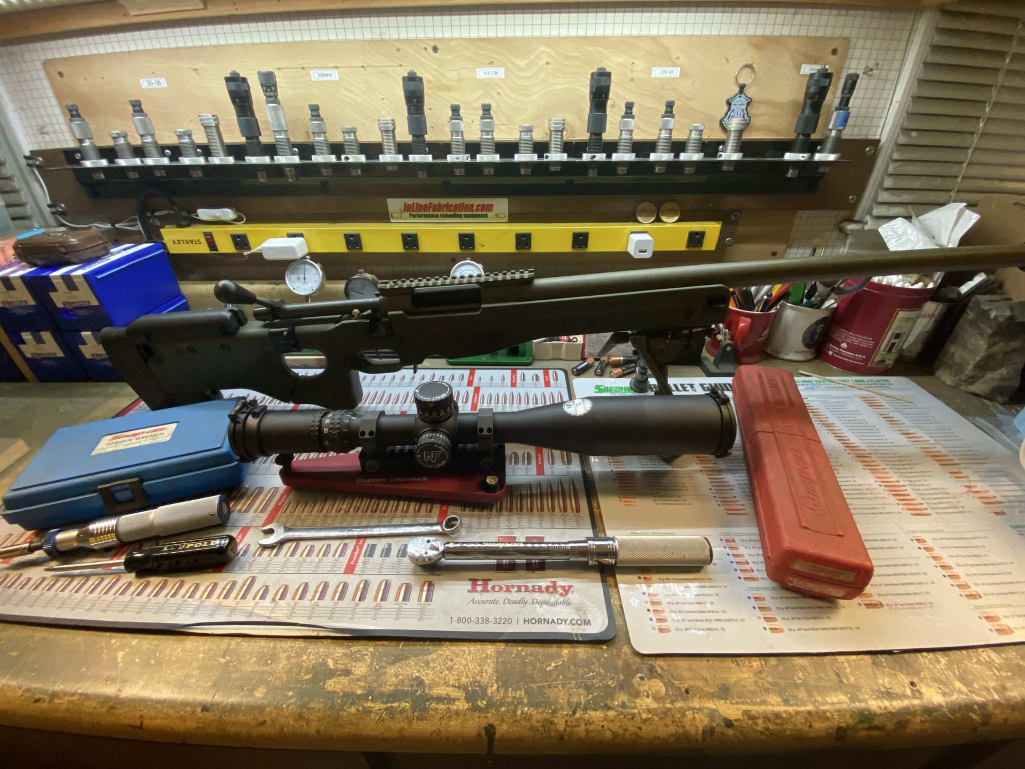

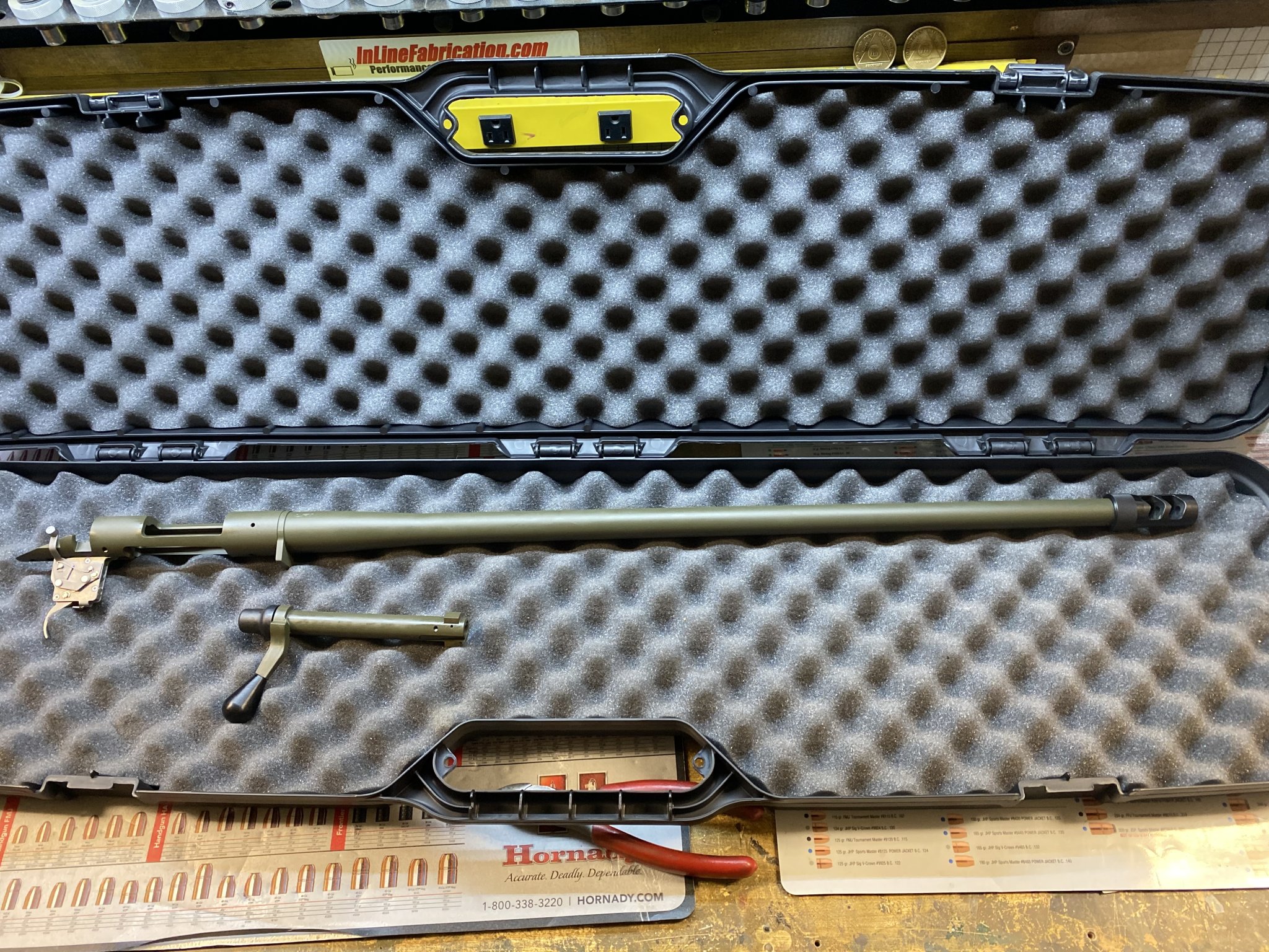

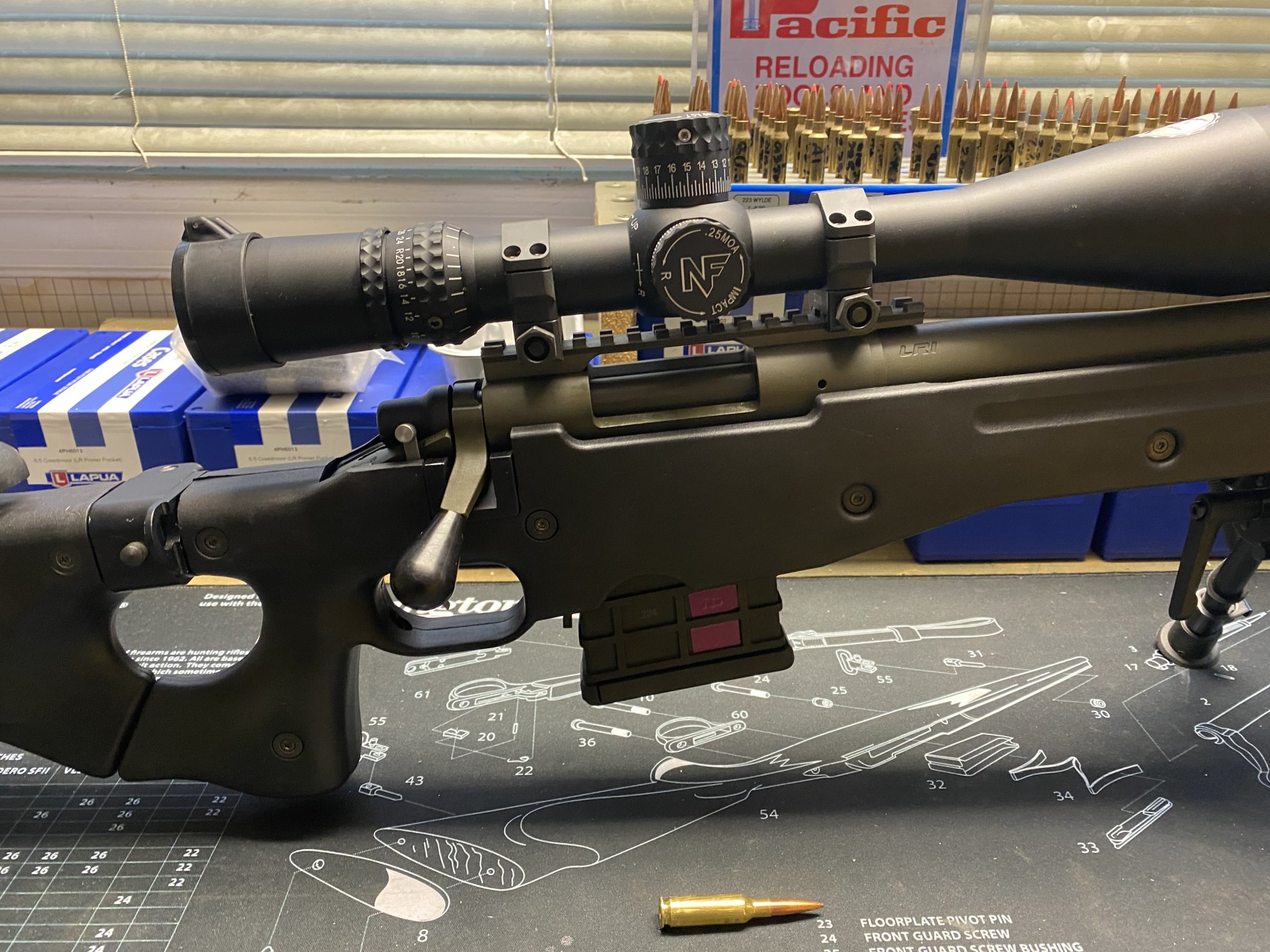

I bought myself a new scope for my birthday and mounted it…..
Before:
During:
After:
The Razor will end up on my 223AI that’s getting it’s 22 year old 8.5-25X50 Mk 4 retired.

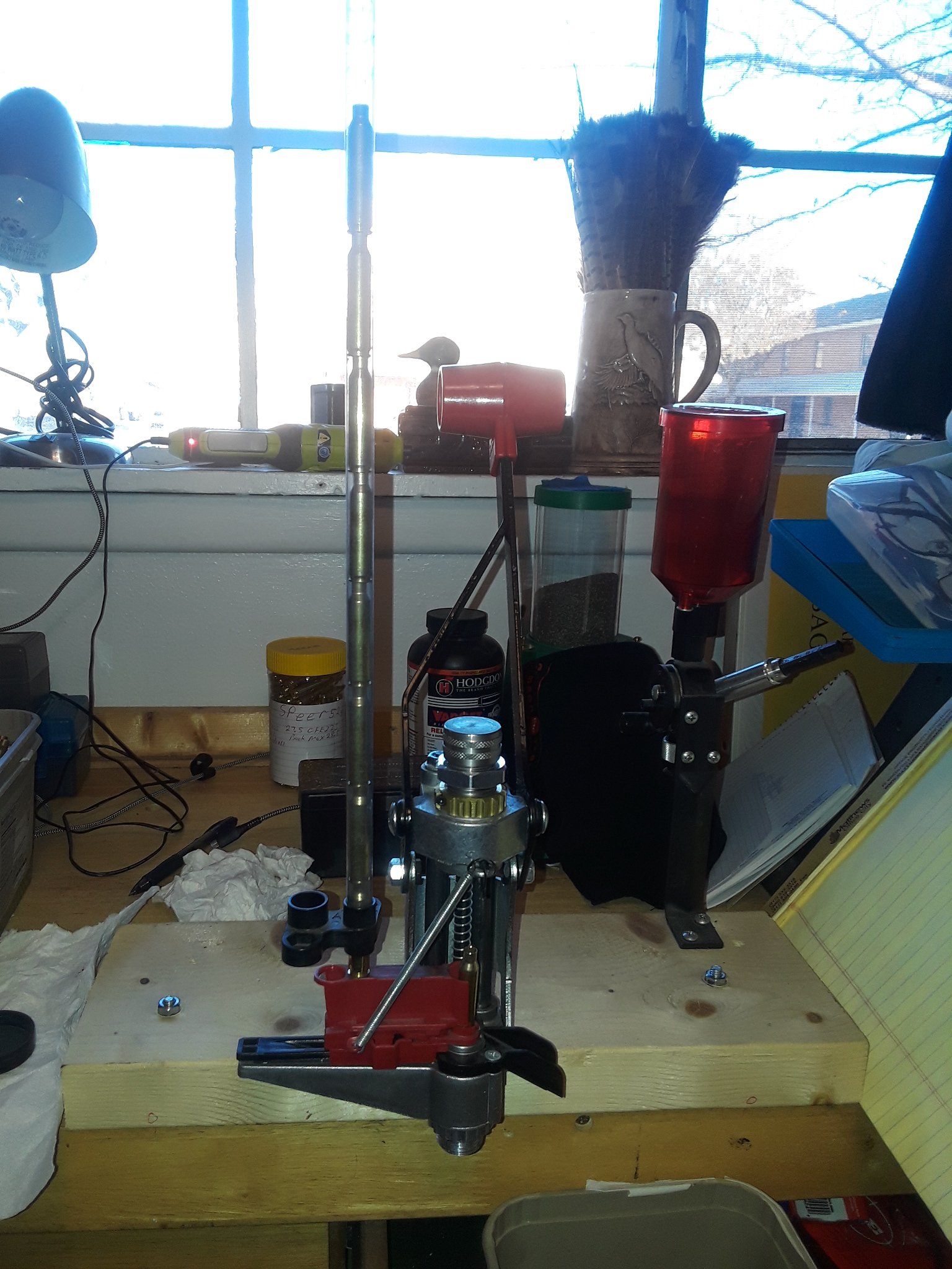

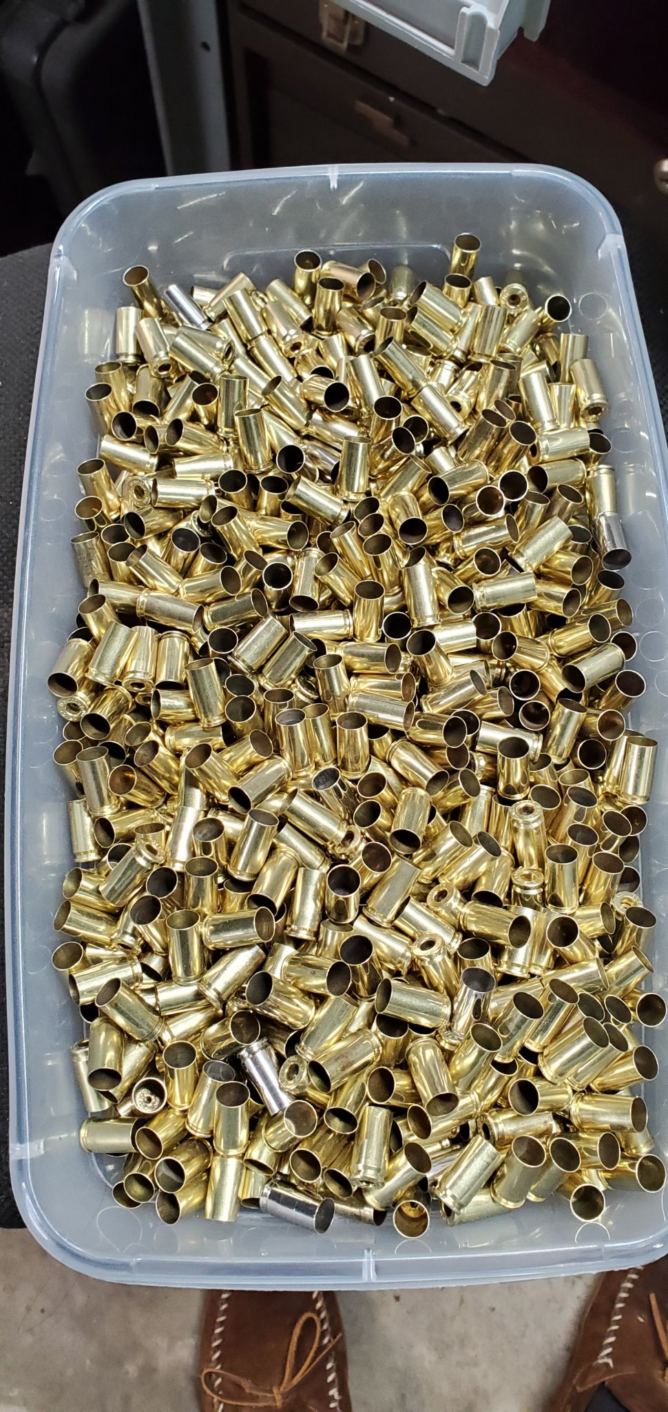

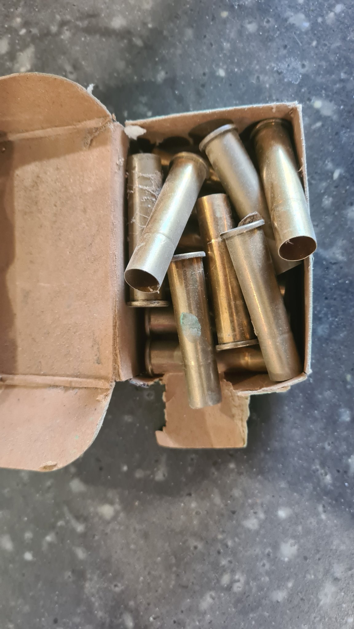

It really is. I had been given the 9mm military brass form a friend and didn't relish the thought of depriming and then swaging on the old RCII. When is saw the APP press and the swage kit on sale at Midsouth I said what the hell. Glad i did. Now I can also deprime/resize then tumble before loading on the PRO1000 which I prefer. That's another machine people dog on a lot but dammit if it doesn't make accurate ammo fast. I bought when it was all I could swing when raising a family and never felt the need to upgrade. The only problem with either machine is i run out of things to process or load pretty fast..... :) .
I have an extra FW Arms self centering swage foot around, and I am going to try that out with the pocket swager. It works as is, but I think the self centering hold down will give me more confidence. Hopefully get to it today.
So this works very well. You can really go fast because of the auto center gizmo, and not worry about getting squirelley at all. I hooked it up to a Dillon casefeeder and just went until my arm got tired.

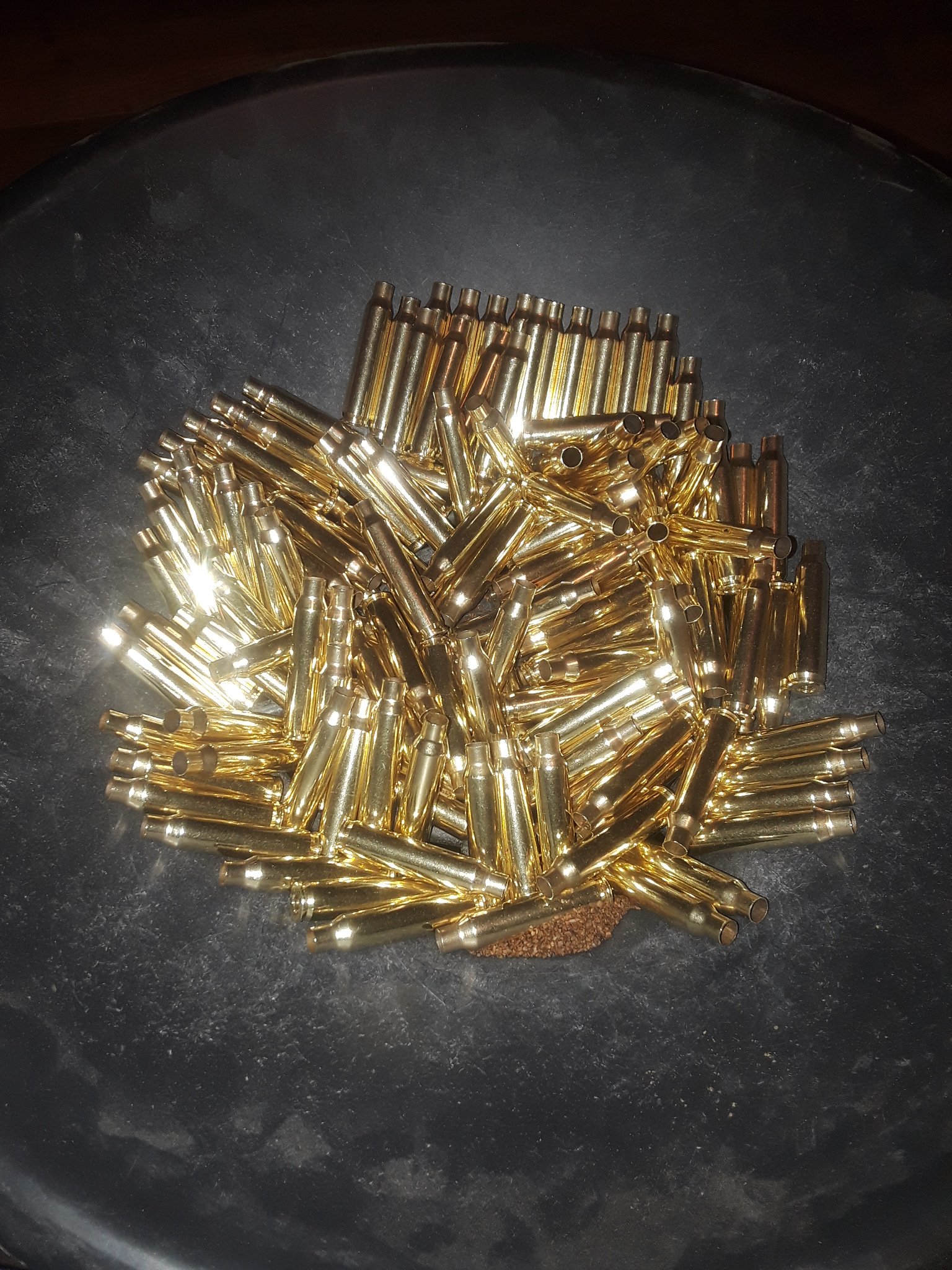

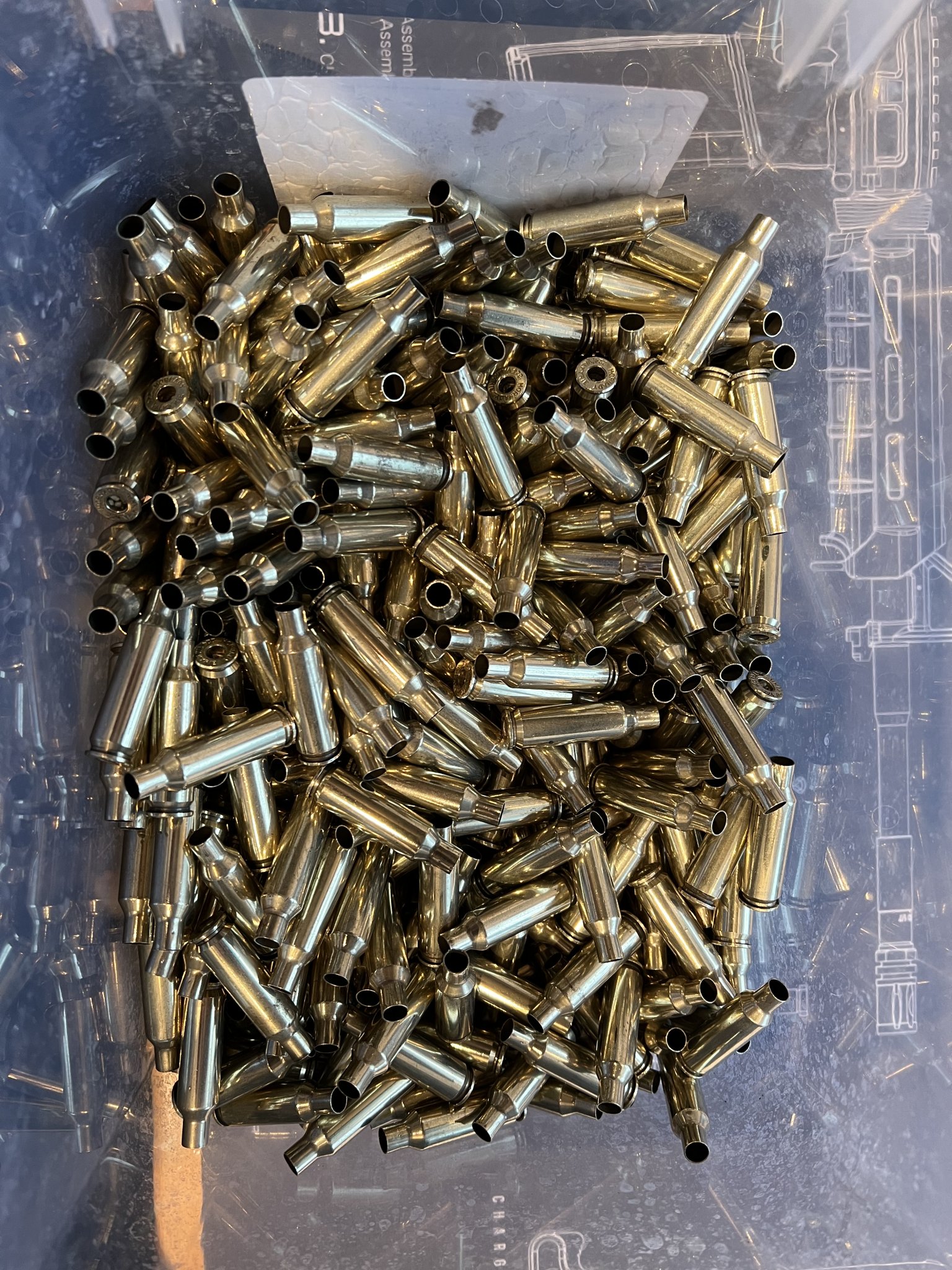

Decided to start working on the Hornady 224 brass after the two classes this fall. Suppressed brass from the gas gun is nasty.
Gonna deprime them tumble them in the big Dillon before I bother re-sizing.

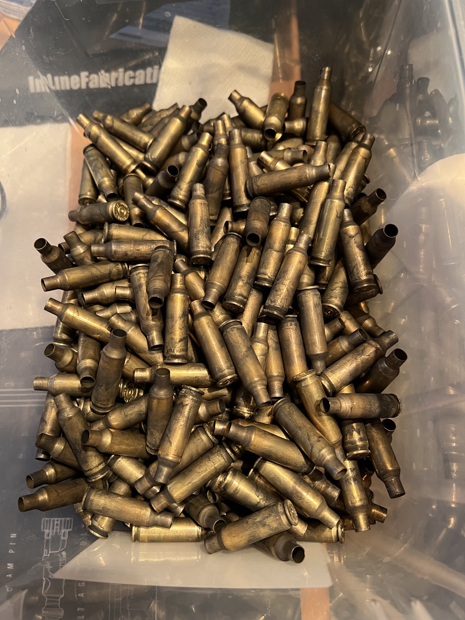

I’ve not touched my stuff much.
Gonna deprime them tumble them in the big Dillon before I bother re-sizing.View attachment 7773963
I picked up some range brass that must have been shot suppressed or something and looked that sooty.
I put it in a big rubber bucket with some lemi-shine and it took the gross stuff off the brass.
I dried it in my furnace room. I put it all in an old pillow case and shook/moved it about to help clear water that was stuck in the case. DONT leave it in the bucket - it will never dry and water will stay in the bottom of the case.
My brass I shoot is clean enough to just toss in corn cob but if shot suppressed or it sat out and oxidized lemi-shine will be my new goto method.
