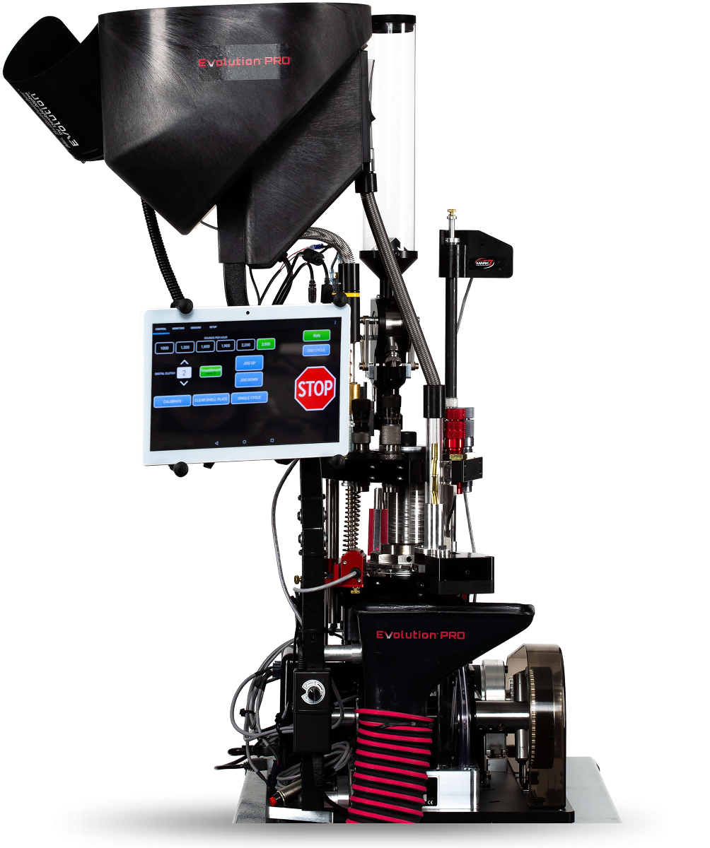

Which one are you getting? I run an Apex on an autodrive, and once you get it humming, it is spectacular.
The one piece of advice I would give is to use it run by hand for a week or so because you can feel when things are going sideways, and then tune them. If you are getting a Revolution, I don't know anything about those. If you are getting an Evolution, you'll really want to switch the priming to the new Apex system, which is miles better. Also the casefeeder is no longer a Hornady on the Apex.
If you have any questions about what might be getting you hung up and how to fix it, feel free to DM or tag me. It's a slightly complicated system, but when firing on all cylinders, it really works well. Tech support is also really good.

Thanks. Getting Apex. But seems like revolution is the only pics around.

Apex is awesome. Some people have bitched about the fact they went to a cast toolhead, but I don't see that being an issue, especially when you look at the really good new casefeeder and the awesome priming system.
A few things off the bat:
1. With the casefeeder, make sure you only tighten the screws on the rear hatch so that they are flush on the inside. If you tighten them all the way, you'll get stoppages with cases catching on the screws.
2. Check all four of the adjustments on the primer system. I had to adjust three of four, but just a little bit.
3. Your main adjustment will be on the indexing pawl screw. Read that section in the manual. It sounds like a pain in the ass, but it's super easy. It needs to index perfectly, though.
4. Every few thousand rounds you'll need to remove that screw, apply vibra tite, and reinstall. You'll see that you will stay in index for 1500 rounds, then adjust and you will get 800 or so, then down. When you keep having to adjust, you vibra tite.
5. As far as settings go, call Mark 7, they will know exactly where you want to be. I only do 9mm on mine, and I run Index of 2, top dwell of 0, bottom dwell of 1. At 2000 rounds per hour setting that gives me 1506.
6. The most important sensor, IMO, is the primer orientation sensor, followed by the powdersense and bulletsense. If you can swing it, get the sensors you want before you put the thing on the autodrive, just because it is easier access.
7. Primer Xpress is really good if you want to go in that direction. It takes a little bit to get everything set perfectly, but it's worth it.

if you are using an autodrive, you just mount it to the autodrive base. It is plenty heavy to be stable on a good bench. If you are not using an autodrive, it comes with bench mount hardware. It's four bolts, slightly larger than the Dillons. You don't want to go higher, like on an Inline mount, with it.
How did you mount yours?
Two other things come to mind. First, if you have never used an autodrive before, it is imperative that you back all of your dies off the shellplate. Each time you start the autodrive, you calibrate it, and if your dies are touching the shellplate, it will calibrate to short stroke. Just back them off a turn and a half or so. Second, you ideally are going to want to use the Lyman Pro Die pack. First because there is a separate case expansion station, and the Lyman expansion die is great, and second because they are built to be run slightly off the shellplate, and say so in the instructions.
The guy at Mark 7 told me their number one issue is that customers run the die all the way down to the shell plate and then don't understand why their autodrive fails constantly.
