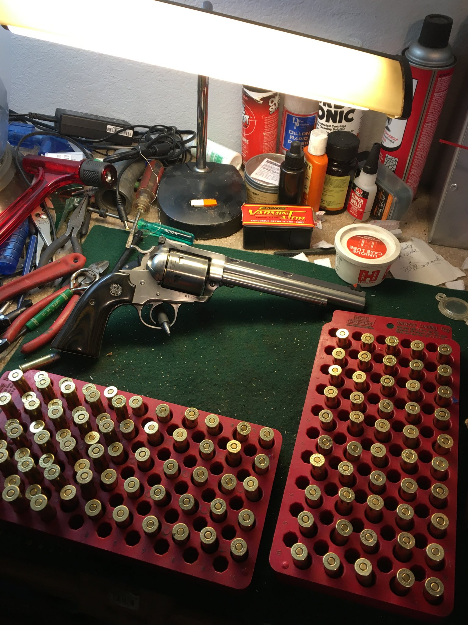

After de-capping, wet tumbling, F.L. sizing, neck flaring, and priming……..ready for powder. Whew!
200 cases of .44mag

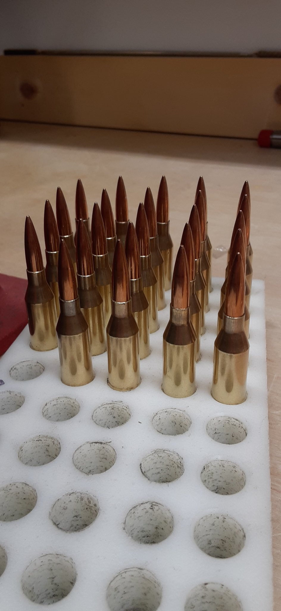

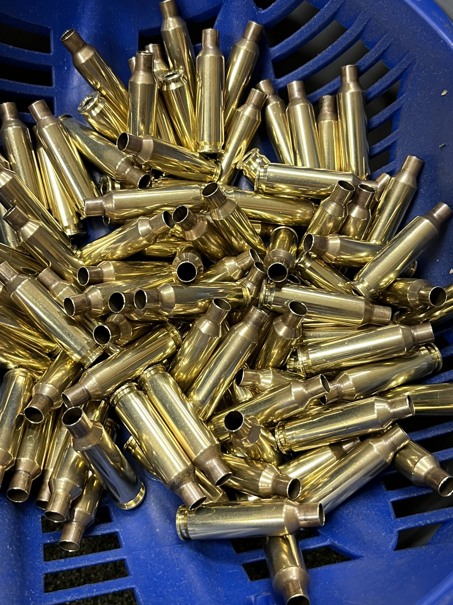

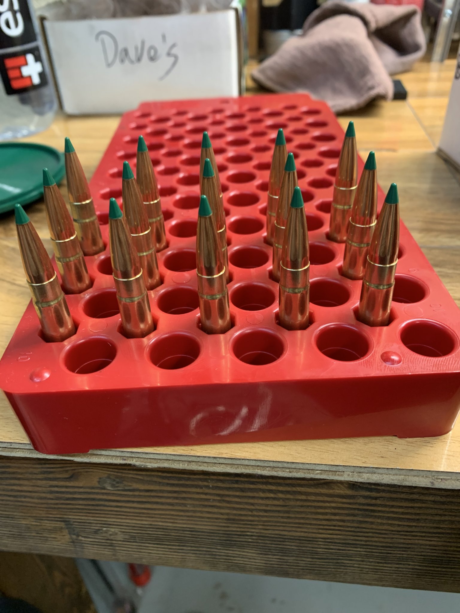

Finally got my honed die back from Forster so loaded up some rounds for the 6BRA. I fireformed 300 Lapua cases with hornady 105s and imr4064 but now on to the good stuff.
105 hybrids, Varget, CCI 450
Loaded 3 rounds each in .2 grain increments from 30.4-32gr just to see what this barrel will produce.

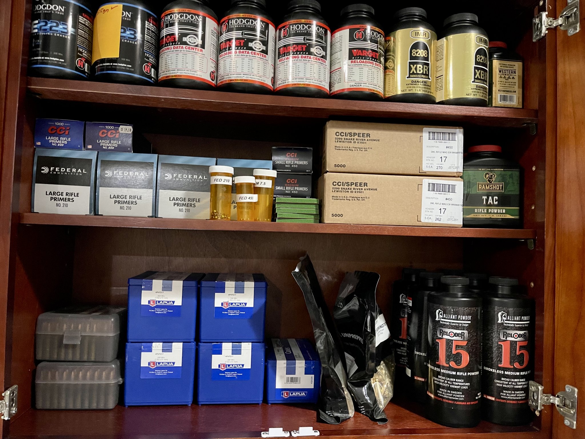

Where did you get 8208?
I purchased it from Powder Valley. I have never had any luck getting powder with Discord notifications. It is always gone by the time I log in to the dealer. Every once in a while I check powder valley and I get lucky. When I saw the XBR 8208 was in stock I purchased what I needed immediately. Then I realized I forget to buy bullets. I called Powder Valley and asked if they could add bullets to my order, but they said no. They suggested I place another order combining the powder with bullets and then cancel the first order. When I tried to reorder it was already gone.
BTW, I always post here when I find hard to get powder that is still in stock.
Thumbs up for posting back to the Hide 👍 8208 is really the only stuff I'm after right now, and sifting through the powder in stock notifications got old after a while. I guess I'll just have to keep checking PV

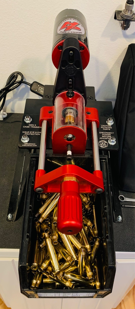

I exercised my new Henderson Powered Case Trimmer for the first time on about 150 cases of 300 Win Mag ... took me less than 1/10th of the time it used to take mounting, adjusting, spinning and measuring in the manual case trimmer I used to use ... "minutes" instead of "hours". Also way easier and more accurate than the Frankford Prep Center that I desperately tried to love (but just couldn't). No doubt the Henderson is an expensive little gadget, but now that I've used it for volume trimming, I believe it's WORTH EVERY CENT !!! Randomly checked about 20-ish of the cases when done, and consistency of length was literally spot on (to the half-thousandth) my target length ... really impressive precision and repeatability.

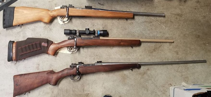

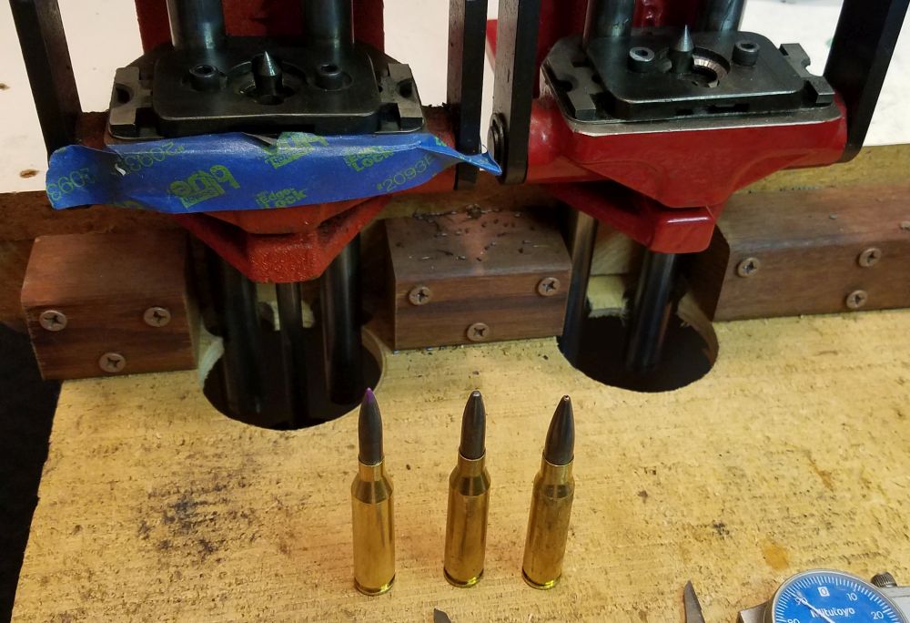

Making dummy rounds for 243, 260, and 308 to check feeding in 1903 Turkish Mauser builds.
The 2.990" 243 round is long for use as a go gauge for 243 chamber throating.

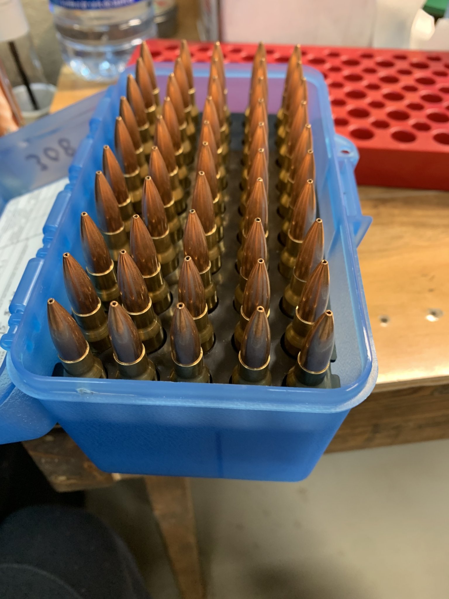

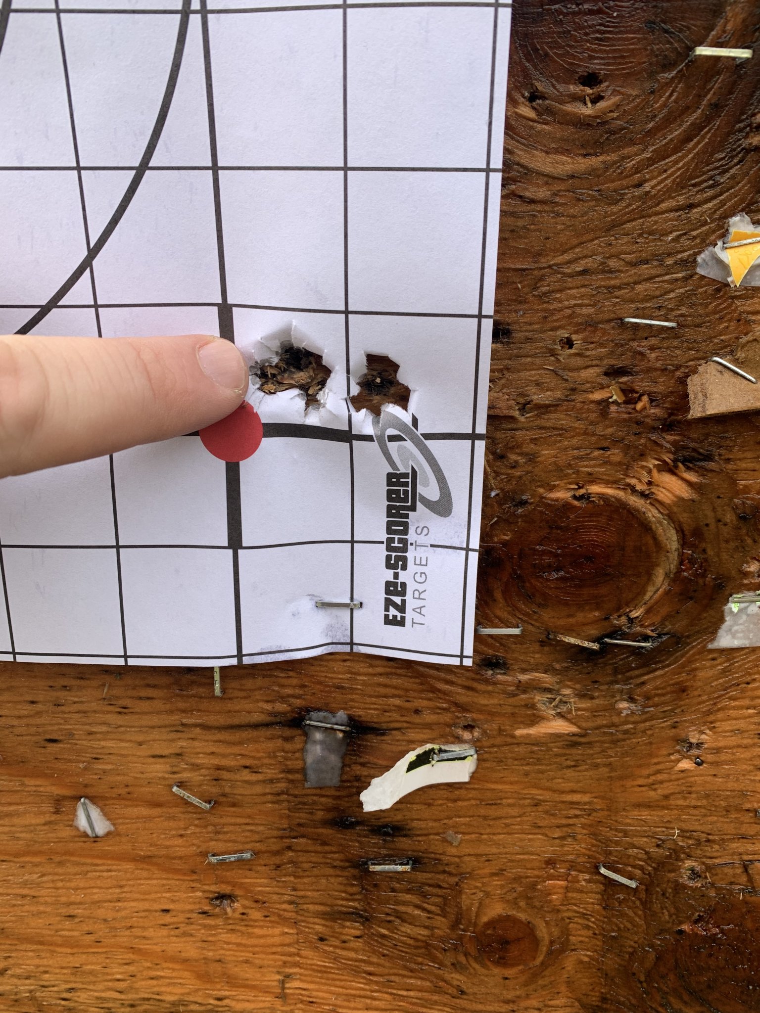

@Mooseknuckles
How many grains of Varget in that Peterson brass? And OAL? Let us know your velocity if you chrono?
I have some new Peterson brass in .308 and have been wondering where to start.
I’m running 42 grain of Varget with an oal of 2.845 or 2.272 base to ogive. My velocity was 2604 average over 5 shots. I was basically trying to match velocity of 175 FGMM. Accuracy was good too.
Last shot was my fault. Twitchy trigger finger.
5 shot group at 100.

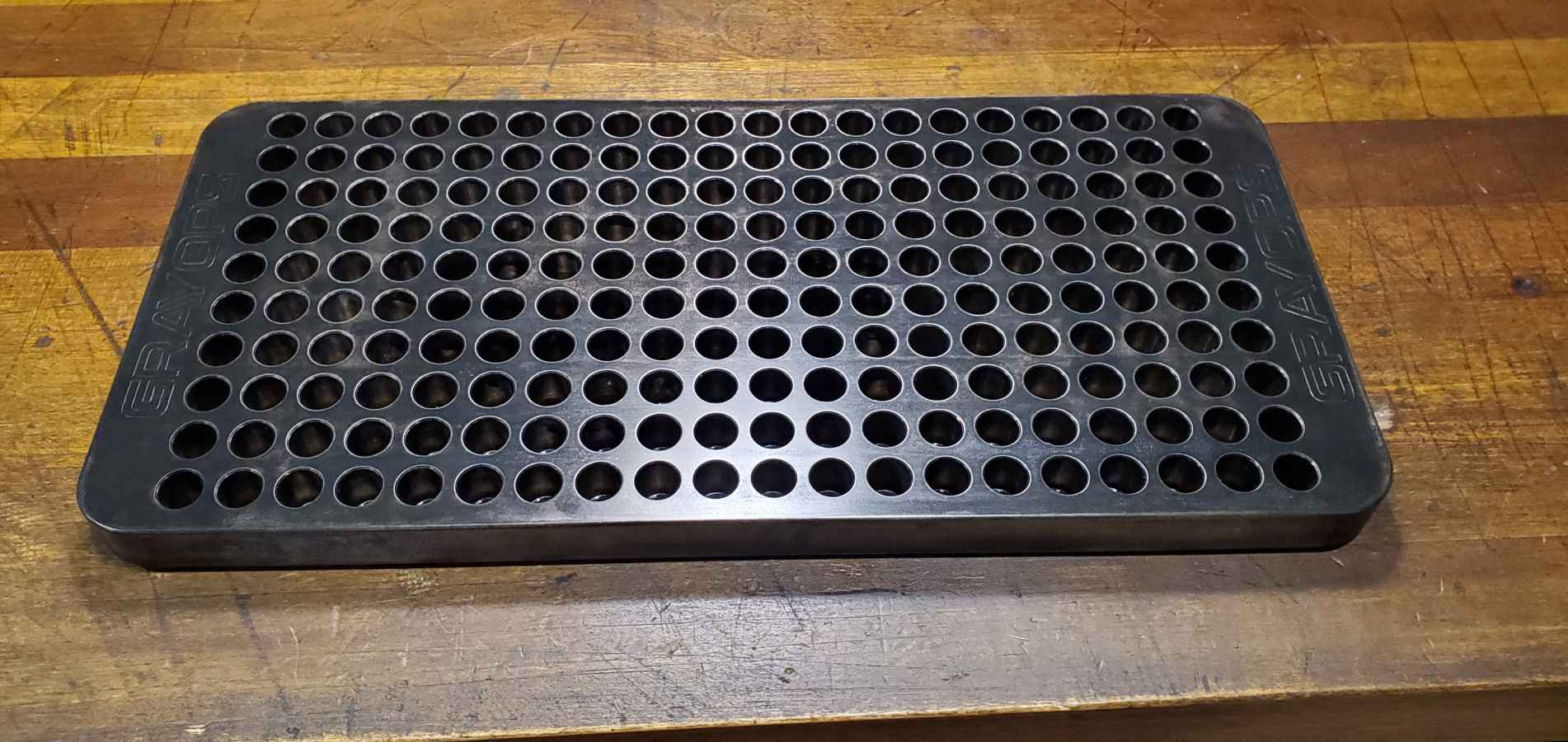

Did the poor mans anodizing on an aluminum reloading block that arrived today. The shiny machined finish along with all the holes made me dizzy when looking at it 😵
Wish I bought one a long time ago. For years have been using the cheap $6 Frankford arsenal blocks. They didn't hold the shells very well so every loading session one would eventually cling to the funnel as I lifted, dumping powder on the table. Or I get clumsy and brush my arm past causing a few to kick around powder. This thing is heavy, tight fit around the cases. Has 200 holes so I can stagger 100 if desired.

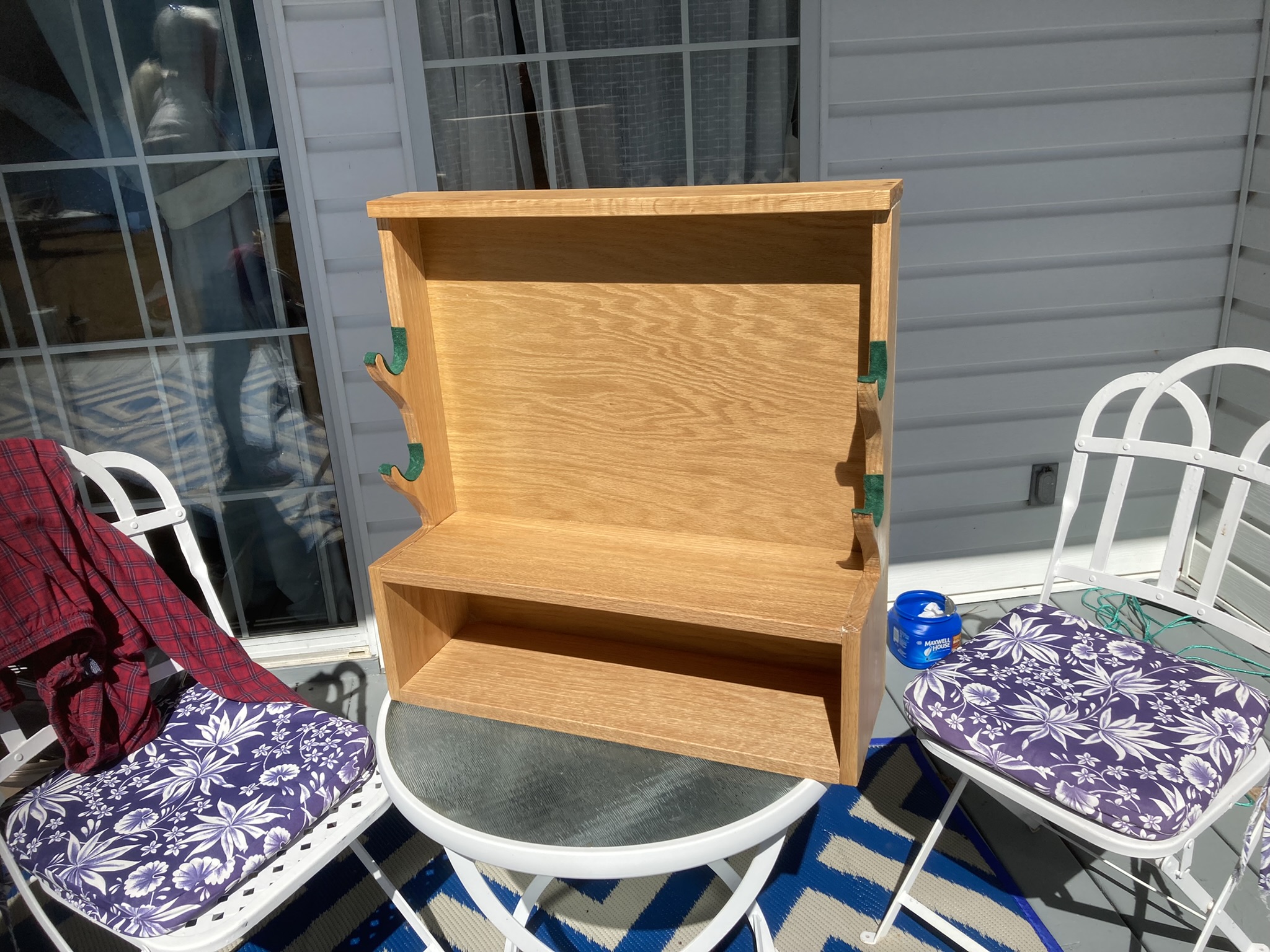

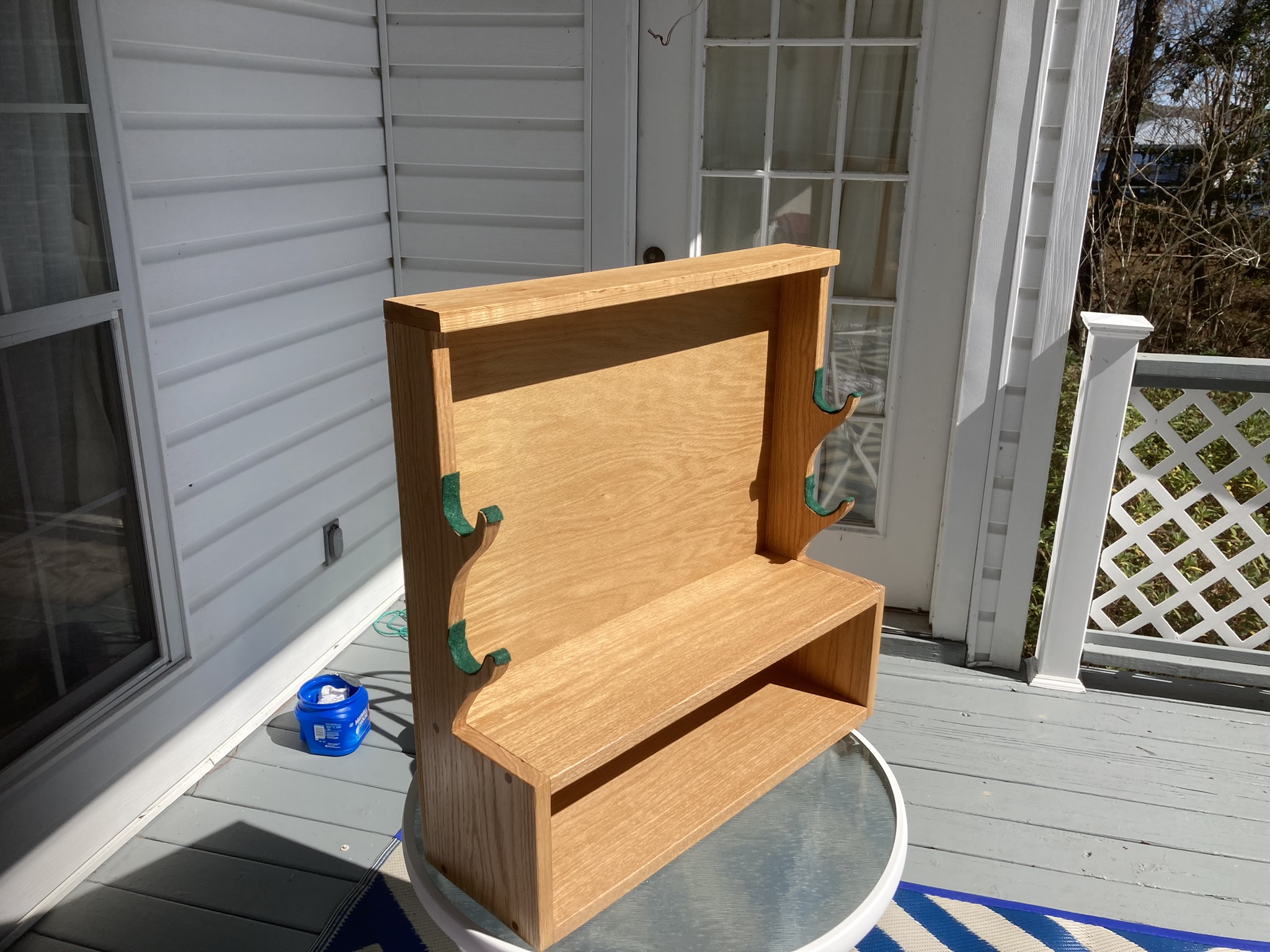

Our son is getting into Black Powder Rifles. Unlike the rest of his firearm collection, he wanted show these off and asked me to build him a rack to put on his mantle. Well between my jig saw getting sick (the durn thing was just purchased in 1989, you’d think they would build things to last wouldn’t you?) and my catching the meta-virus which ruined my December and half of January, this was not finished by Christmas as promised.
But I put the finishing touches on it today. As Brenda Lea says, at 73, I am not quite as good a carpenter as I was even ten years ago, but at least the finish came out nice.

Nice work! When I was a pup growing up (1960's & 70's), most every house I'd visit had one of these or a full gun cabinet with the house's collection of rifles and shotguns proudly on display. Miss those days.
