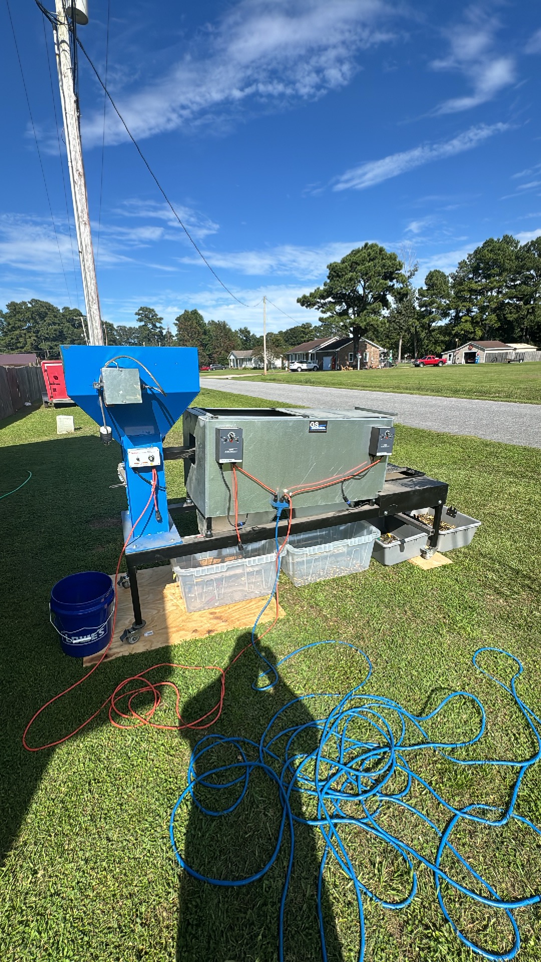

Uggh....that sucks. I was using stainless pins and wet tumbling. Problem was that the pins were cut the perfect length to wedge across the case mouth of my 6.5 Grendel, 6.5 Creedmoor, and 6.5 SAUM brass. Had to use pliers to remove pins on every affected case and then manually shake out all the pins stuck in the case that were captured by the wedged pin. The tumbling media you are using would have avoided that.
hahaha same here! what a pain in the ass. Nothing like a 15 minute task turning into 45... SMH

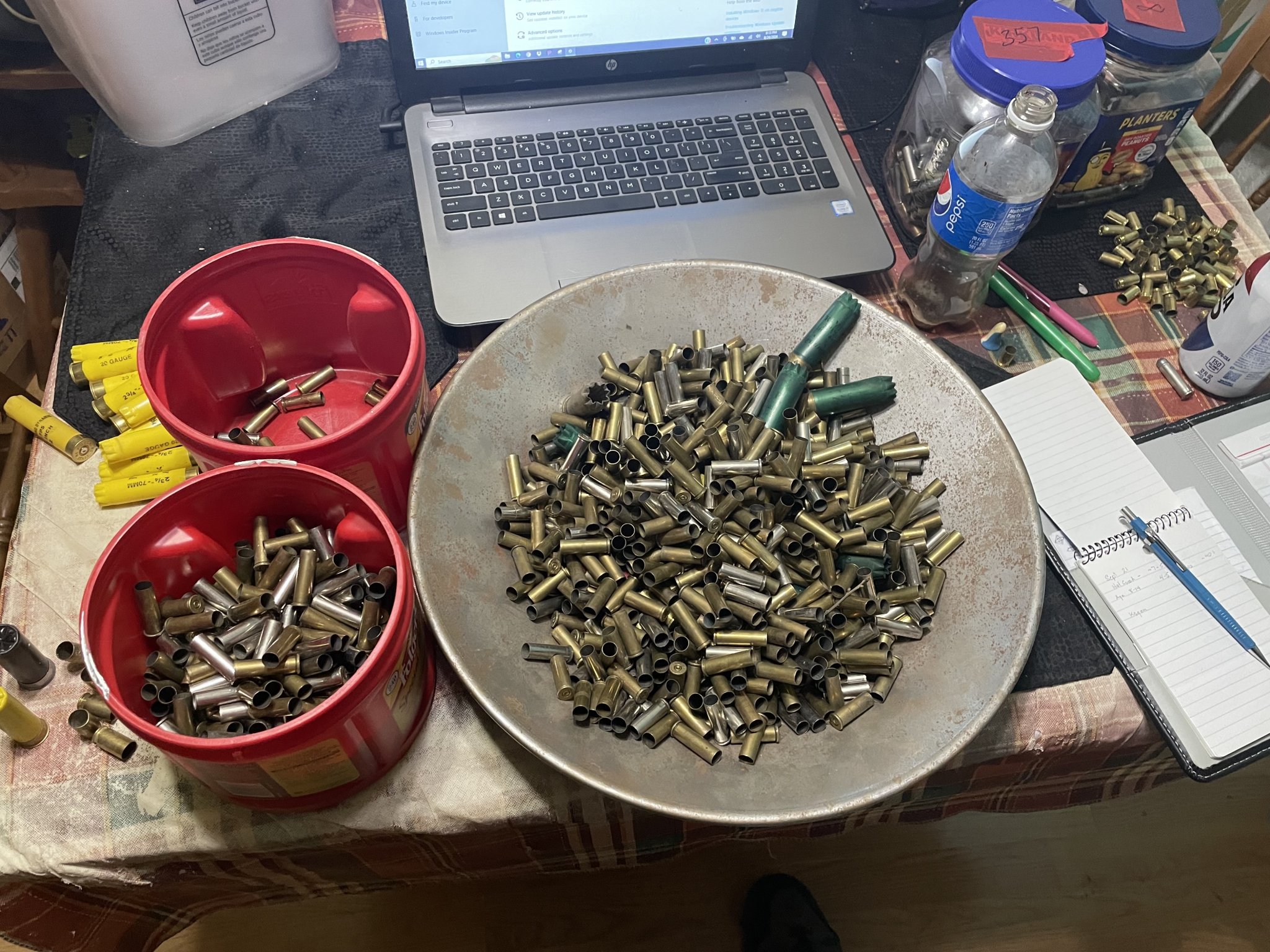

I got a cool day off and shamed myself into trying to straighten it up. Discovered 12+ brass bags that needed to be sorted. So I’m sorting out 38 Spl, 357 Mag, 12 ga, 20 ga, 9mm, and 45 acp (🤬 45 acp SP).
About half way through the project, and hoping that I don’t find more bags of mixed brass.
That doesn't sound like any kind of fun sorting out pistol brass. 12 bags of it sounds like some sort of torture.
Can't find picture so use some imagination please.
I use a card table (in front of idiot box) and a strait edge (3 ft ruler) and some tubs with lables on tape.
The brass is dumped a couple handfuls at a time on the table and shoved base of cartridge against the strait edge and then drawn toward you.
Makes sorting faster, the brass that is predominant is left for last so it can be swiped across the table into a tub.
A trash can for junk and a container for recycling.
The lengths and diameter can be seen when lined up.

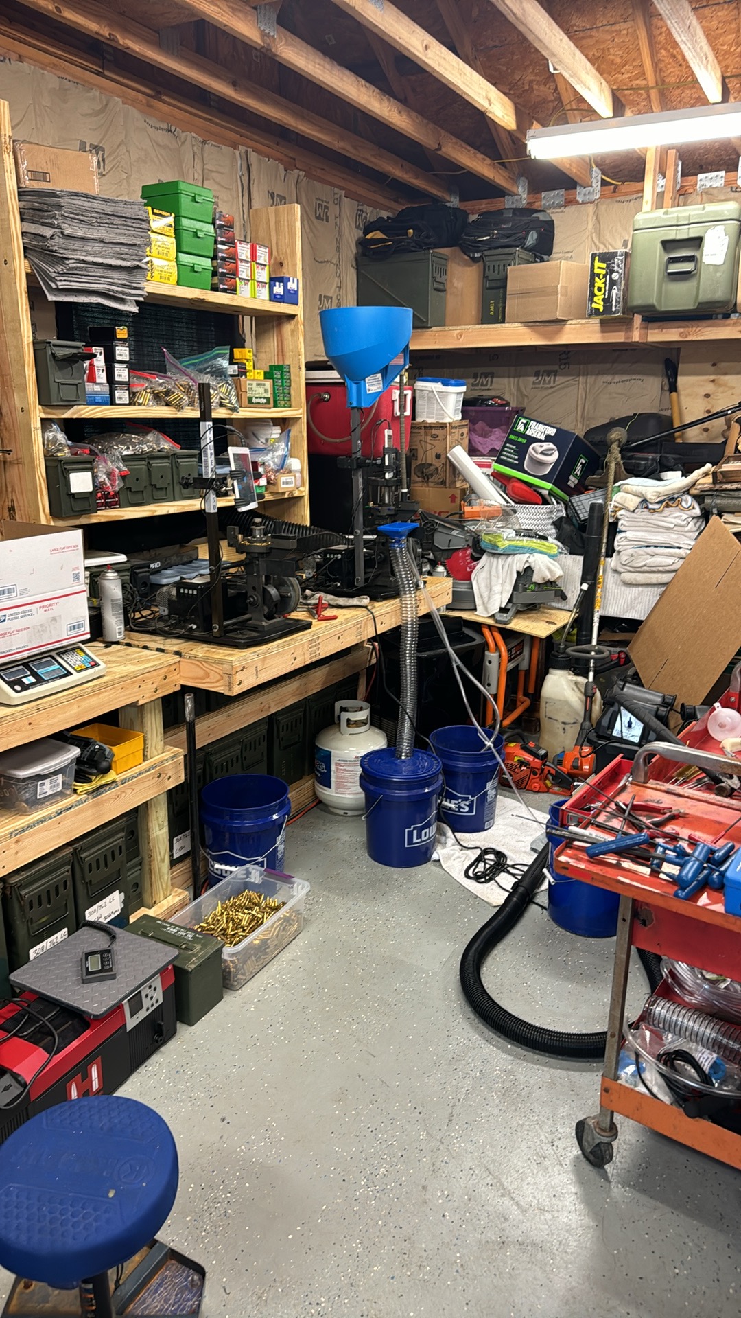

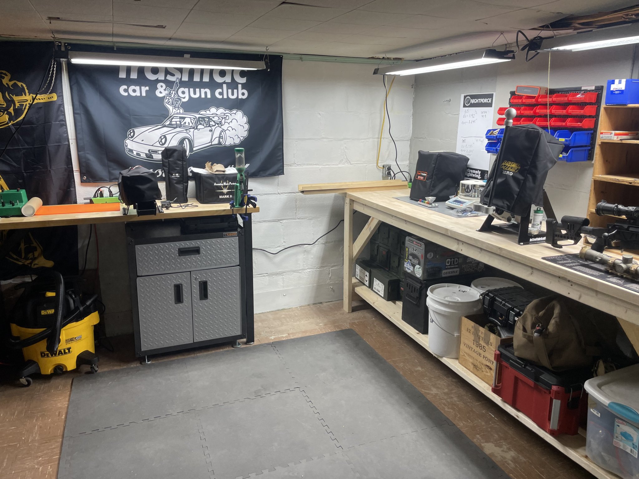

Hell of a set up man
thanks... i love it for its purpose... wish it was better insulated, better AC, but I make due.

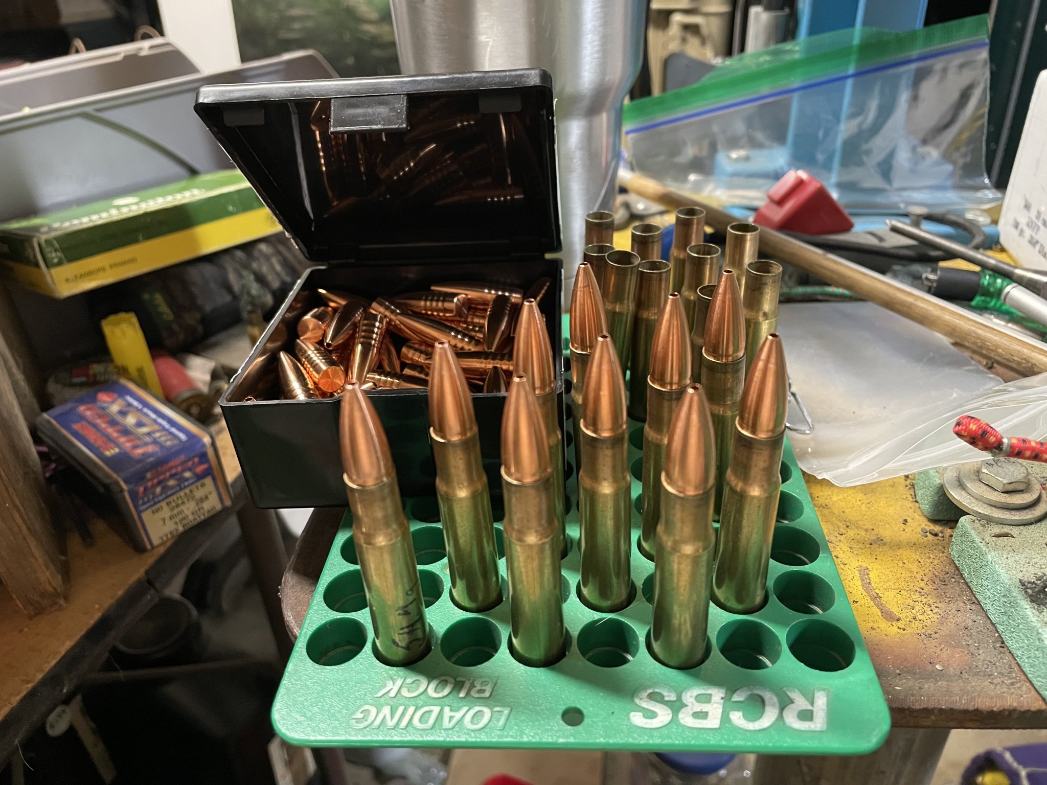

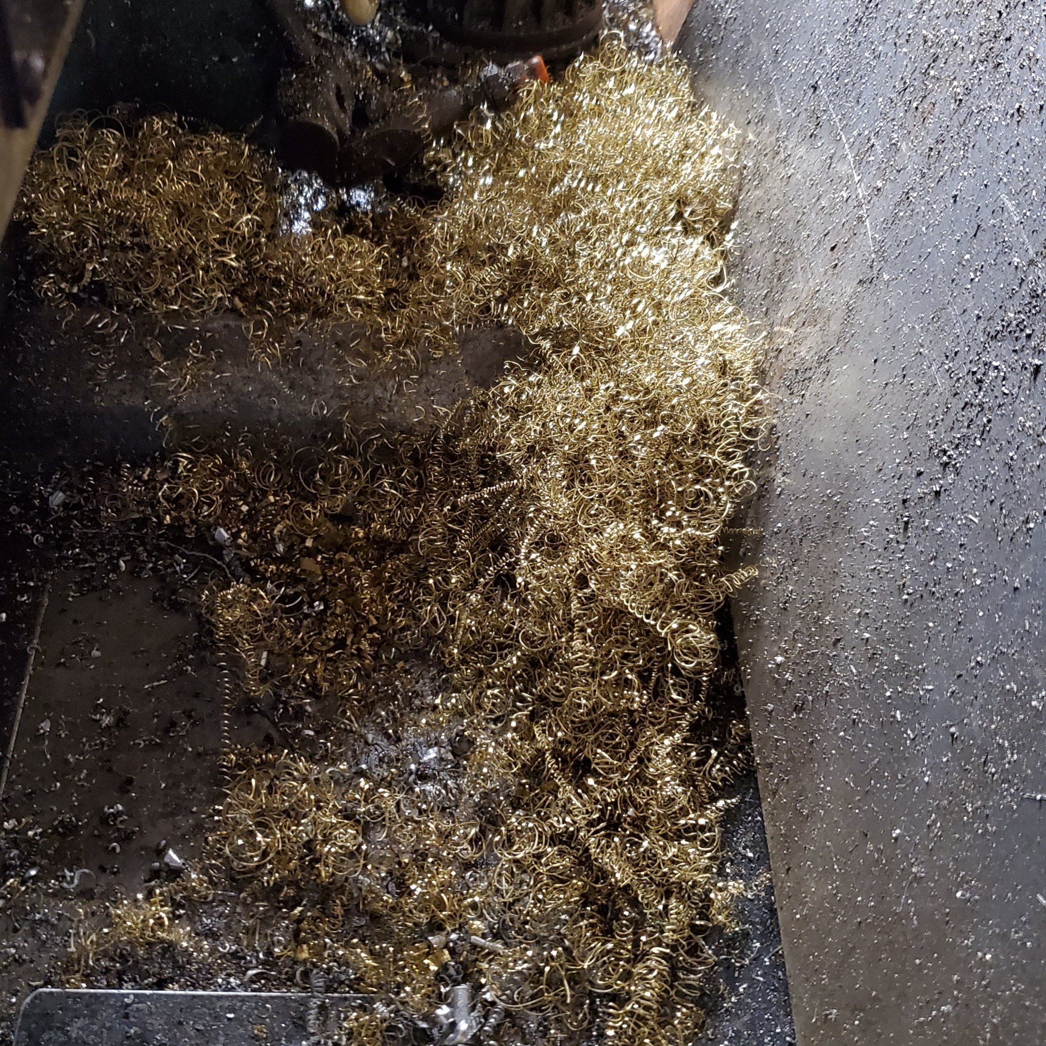

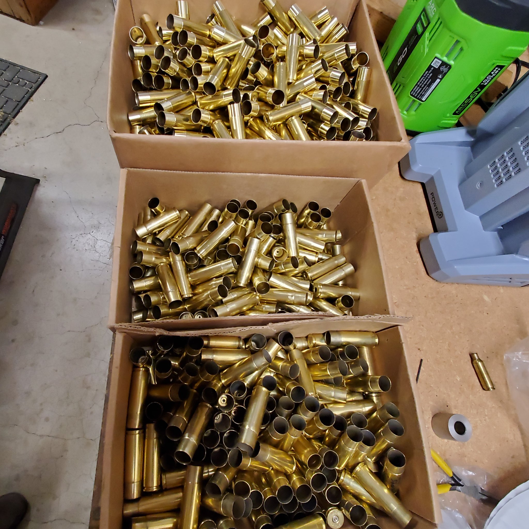

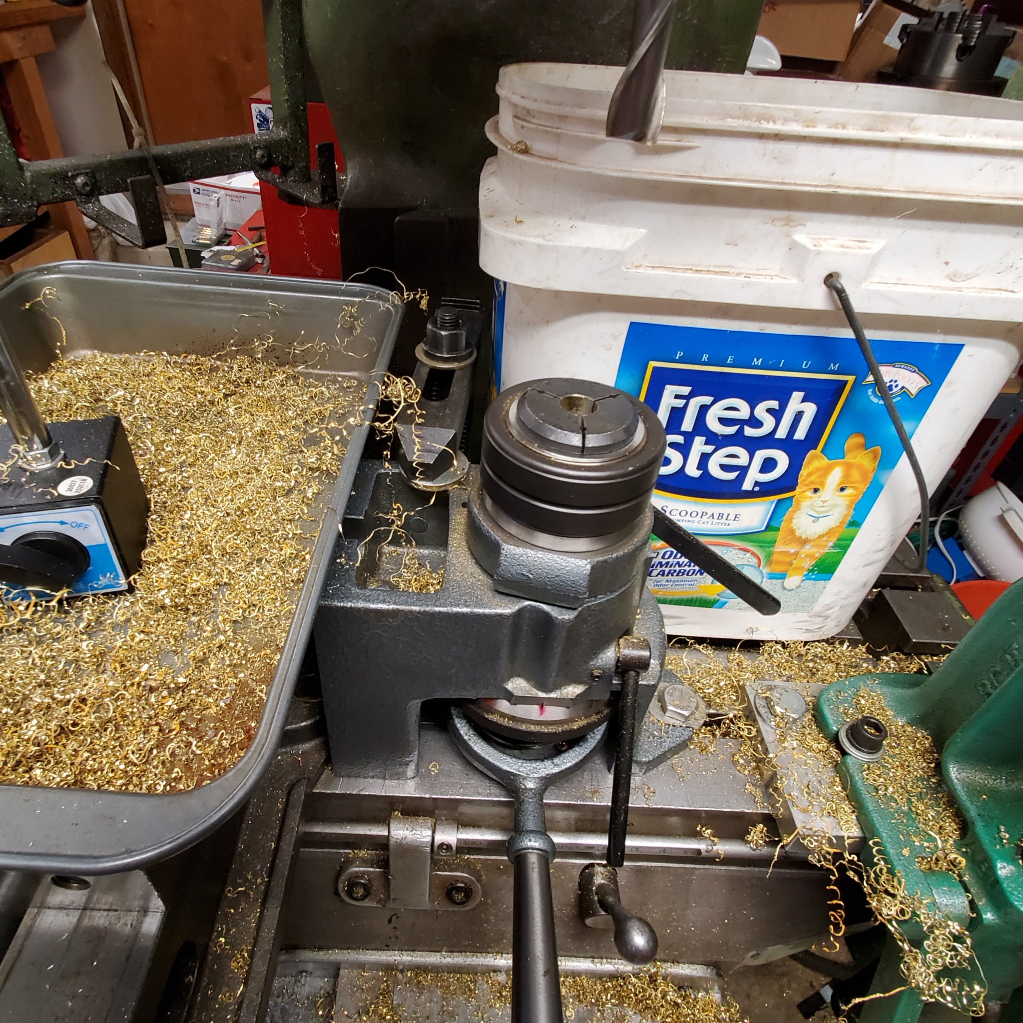

Today I finished processing 700 pcs of 510 Whisper brass.
It was a messy task, using machine tools... brass, chips evrrywhere...and the area was cleaned a couple of times, before the photo..the plastic bucket is for chip control on the mill... the pile of brass in the lathe bed from serious neck turning of the brass magnum cases.
This, is heavy duty, wildcat, brass making.
Cutting up new magnum cases for the .510 Whisper.
The new limited factory .510 Whisper cases are always out and $5 each.
So buy in large quantity of magnum brass cut em up and neck turn em yourself, and save a ton.
These were about 65 cents each...the first 200 Lapua 338 were $2 ea, found a better deal.

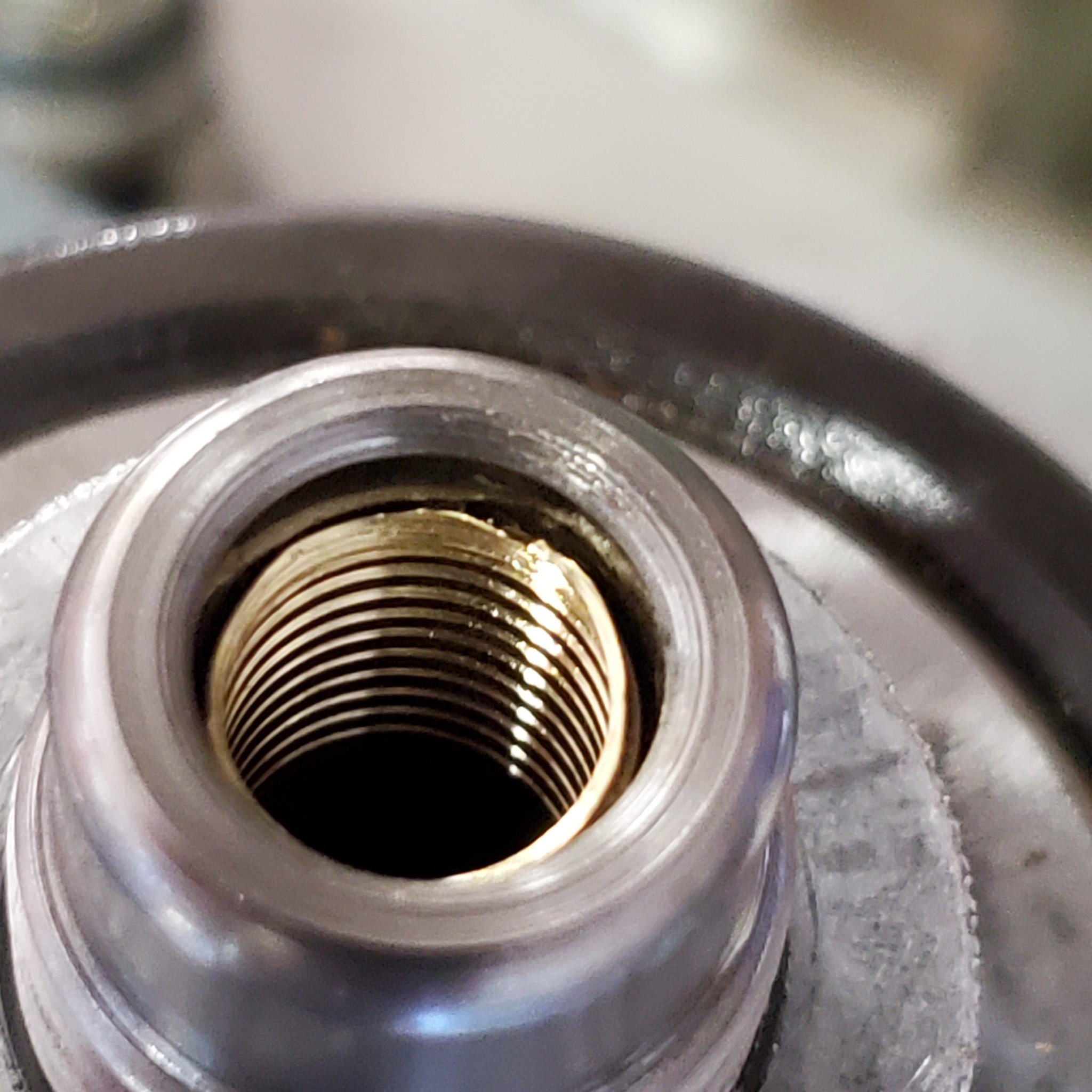

Worked on removing stuck brass from dies……did 3. Seems small compared but a pain in the butt!!
.510 whisper is something I could use…
I did the same when I stuck a hybrid case in the die and pulled off the SS case head...I didn't lube it enough.
It's a totally different procedure, pretty much requires a lathe or a mill. Since there is no case head left to tap only a stuck body. But a 7/16X 20 NF works great but it must be centered precisely.
Here's what it looks like.
Indicate in mill to center, drill out rough edges, tap with centering fixture, then use bolt & spacers to pull case body out of die.
The lathe use the same basic setup, but a boring bar to remove rough edges.
