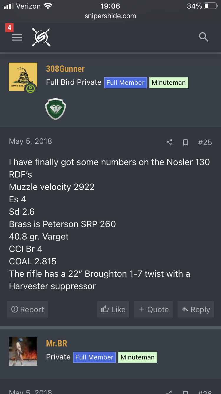

View attachment 7706443I
I am shooting a 1-9 to 1-7 left twist Bartlein now and getting 2920 with the 130 RDF’s, this barrel is also 22”. The problem with a longer free bore is you are not going to be able to chase the lands.

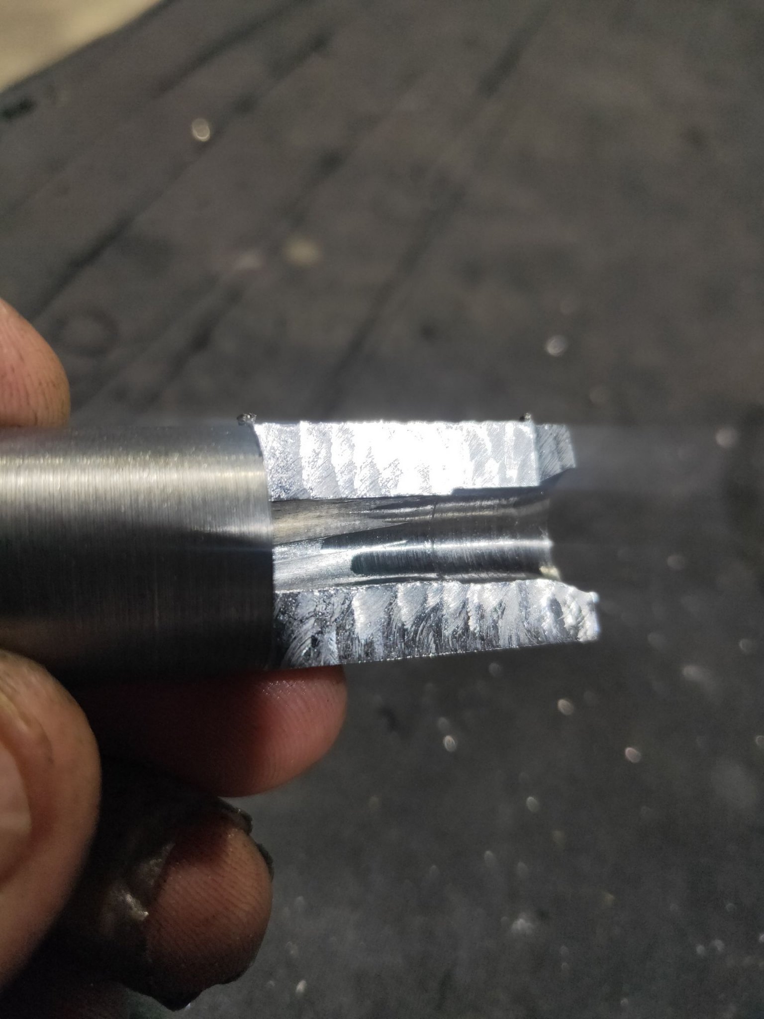

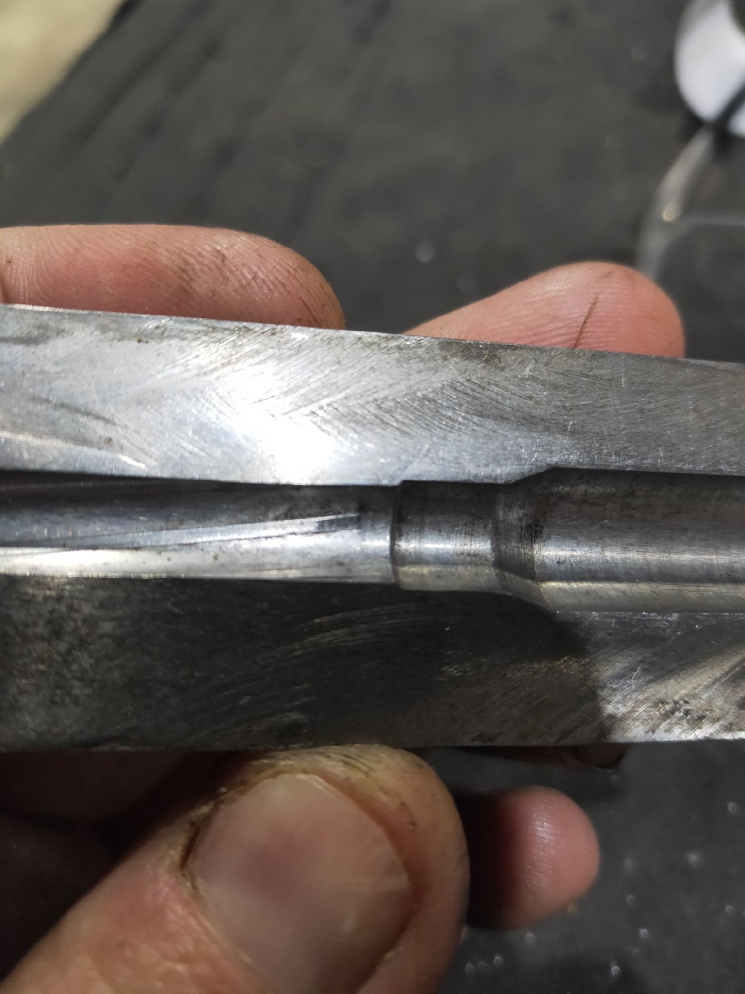

The lands are stepped. They engauge at normal length, however the diameters change. If I remember I'll chamber a spare barrel and cut it in half to show how I do, or previously did it.
Not trying to give a busy guy work, but it would be fascinating to see a cutaway of an old barrel with this mod. When you have time.
Reactions: iceng
Shitty attempt on the second one. 3 jaw chuck, didn't check, just rammed it in for an example. Hopefully you get the idea. Really can't be asses doing a proper quality one. It's 930pm, I'm going home.
Top one is a normal 308win. Bottom one is 308win+P throat.
Should look cleaner, but it was a bit wonky, so didn't cut clean, but for the example, you should hopefully see. The bullet will seat at the same depth touching lands. They are stepped out a diameter, and laid back more. Think .304 rather than the .300/.308 diameters, and instead of 1min30sec, it's 1min10sec angle (I think, I'd have to check).

@iceng Looks like it’s about half the angle for the throat engagement, which aligns pretty nicely with what other people have said. That does make it easier for the bullet to go into the rifling misaligned, though, so concentricity is critical for +P load accuracy.
Reactions: Yondering
The initial angle is 1-30 halfway down. Then it goes to a more gradual angle to major land diameter. The final angle can vary depending on what reamer your are using. Kiff was the guy that came up with the term (bore rider) At one time Dave offered it in smaller calibers. A friend of mine did one in 260. The lead (not freebore) was twice as long as most conventional 1-30 Dave offered at the time. The problem with smaller diameter calibers is that the throating end of the reamer is very long and delicate. I will say this reamer was nice. But it still scared the crap out me.
The initial angle is 1-30 halfway down. Then it goes to a more gradual angle to major land diameter. The final angle can vary depending on what reamer your are using. Kiff was the guy that came up with the term (bore rider) At one time Dave offered it in smaller calibers. A friend of mine did one in 260. The throat (not freebore) was twice as long as most conventional 1-30 Dave offered at the time. The problem with smaller diameter calibers is that the throating end of the reamer is very long and delicate. I will say this reamer was nice. But it still scared the crap out me.
