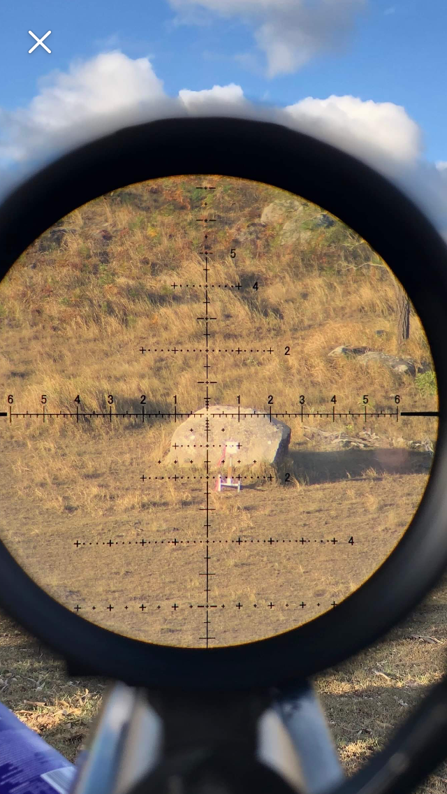

Yes this is a 4-40 prototype . Apologies for poor quality phone photo through the scope , image is very much
better in person . Glass is very good , reticle is easy to use and not too busy . Tracking was within 0.23 % ,
it has a wide angle eyepiece which gave the impression of a much larger exit pupil , so easy to get a great
sight picture . ( actual exit pupil , is front lens size divided by max zoom power )
It’s physically much smaller than the 6-60 Genesis , so looks more at home on conventional rifles such as the
6.5 x47 in the quoted post . On a big Magnum , I’d run the 400 MOA 6-60 : this 4-40 model will be excellent for
guys wanting to ELR their everyday calibers . It has around 90 MILS travel , enough to get your 6.5 to 3k if you
need to .

Very cool, when will the 4-40x be available? 300 minutes is more than enough for my .375 cheytac to get out to 3000+. Will the 4-40x cost less than the 6-60x?
I currently run a 10-60 x 56mm High Master with a Recknagel adjustable and a Tarac. The glass is totally usable at high mags, March is definitely ahead of the pack on resolution. The piggybank is slowly getting to a Genesis but now I might wait and see especially if the 4-40x is cheaper.

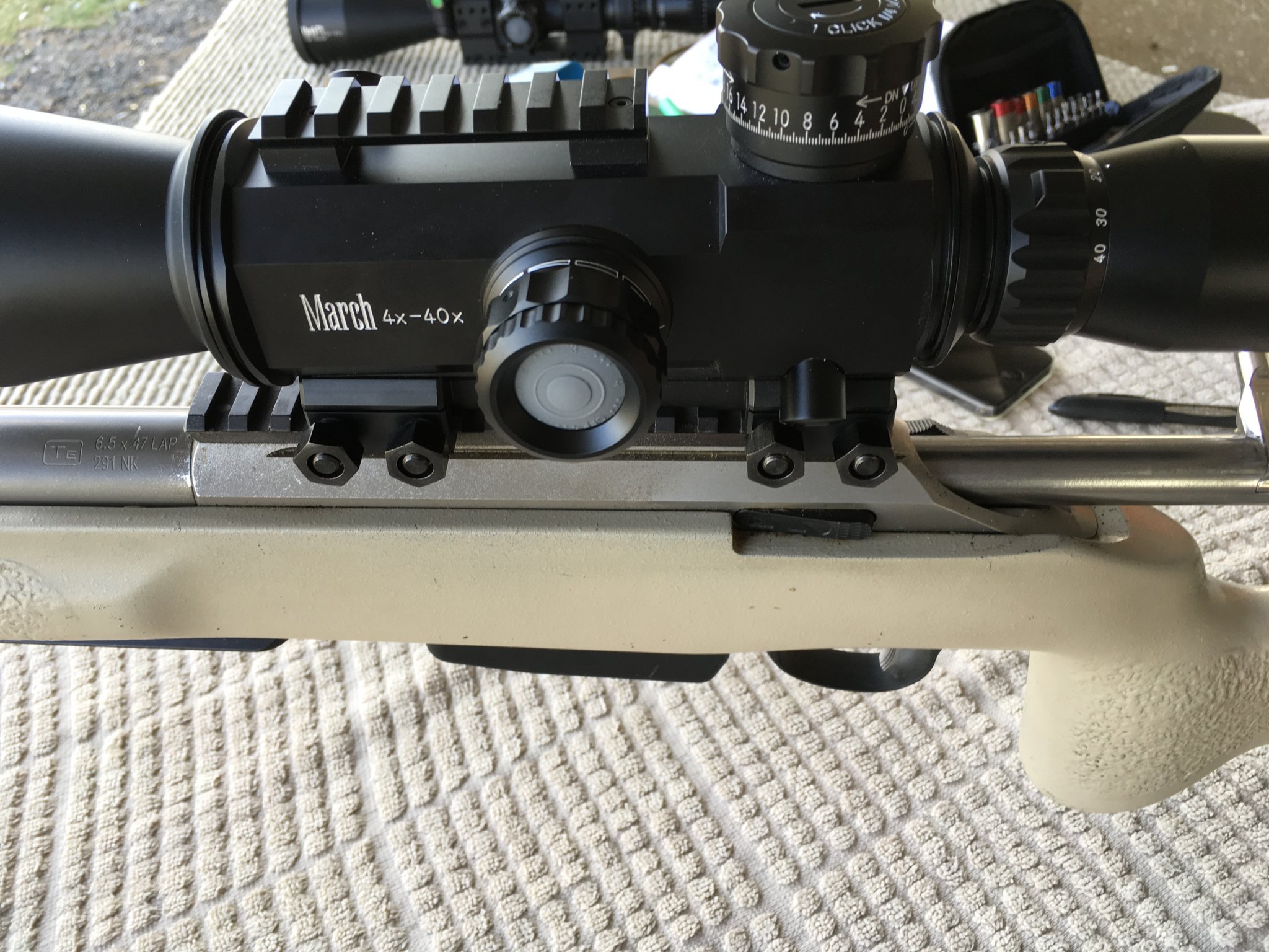

Not sure when 4-40 will get released , a lot of testing to do yet . We need to get a lot of rounds down on
a 50 first , March have a very high G recoil test rig in Japan , but there’s no substitute for real world field
testing . I think the price will be slightly less than the 6-60 , but not much . The amount of precision
machining required is just the same as it’s big brother , there’s just a bit less material involved . The 6-60
is ready now and should be slowly trickling into stock worldwide . March / Deon only assemble a few scopes
per day , so this will always remain a boutique high end product .
