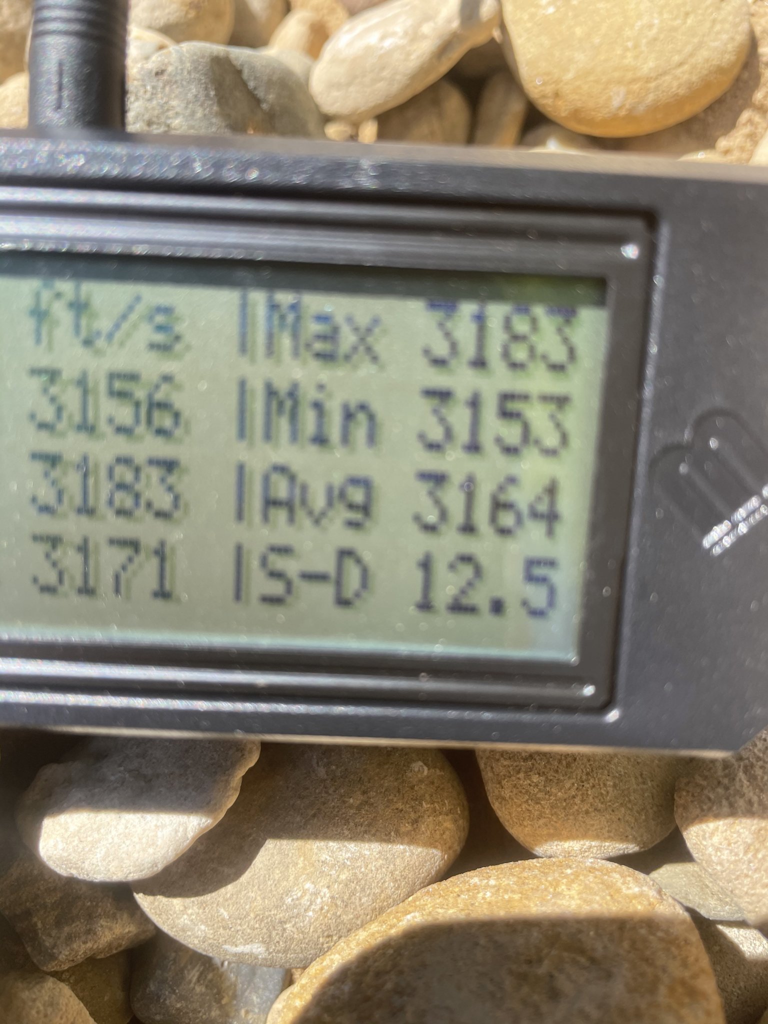

I've had great luck with downloading it, but that's using Sta-Ball exclusively. One neat thing about ball powder is that case-fill doesn't matter nearly as much as with stick stuff... this is partly why running 20+ range-pickup, hastily loaded, run o' the mill USPSA 130pf 9mm bunny-fart loads will get a low SD of ~5 when run over a chrono (even though the cases are only half full).
It's still ball powder though, which sometimes makes it a pain in the ass in other ways, especially numbers-wise: mainly it doesn't do one any favors like H4350 and/or Varget seems to, the combustion just isn't as even/consistent (that's even if you're weighing every charge to +/- 0.02 gn) so it's harder to live with in that respect. I've had to become a better (more OCD?) reloader to get to where now I constantly/regularly see good ES/SD numbers with it (usually an SD 7-9). That, and in my experience, it's only really temp-stable if it's nice out, it can get wonky once the temps are lower towards ~40degF. I've had a couple of matches where my dope seemed to fall apart and be all over the place in the morning, only to then fix itself and get back on track as the day went on and the temps warmed up.
I figured this out by accident of course, previously I'd tried loading the 6CM slower with H4350 and it didn't work out too well, but later, when Sta-Ball was the only thing available and all I had, I tried it again and it's been great since (I've shot a bunch of it like this too - 2 barrels, ~2300rds of life each).

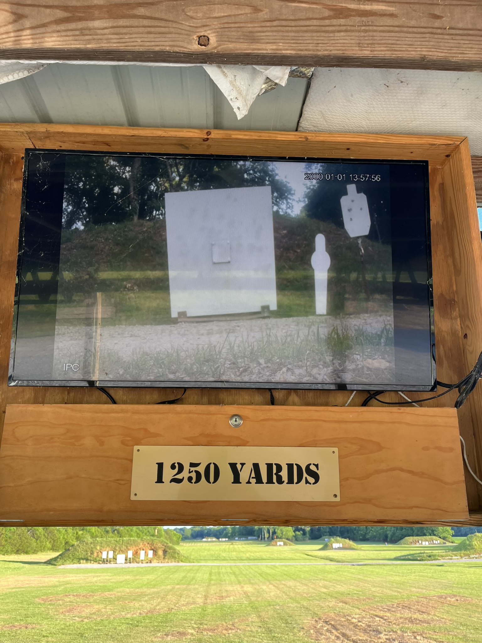

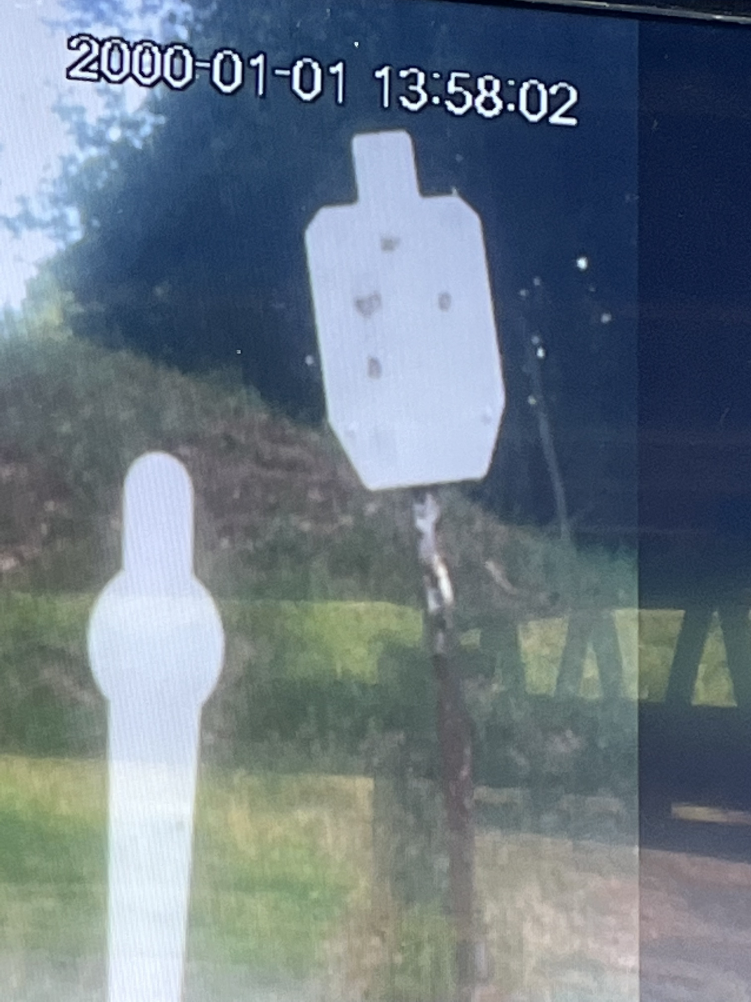

Accuracy is better than decent too, here are 5 shots off a tank trap/Shmedium, 41gn StaBall jumping 0.100":

IDK if it'd work out as well with one of the more usual suspects (4350, RL16, etc) maybe that's why we don't hear about guys downloading it so much..? With stick stuff, I'd probably try H1000 or something slower that'd still yield good case-fill..? (YMMV)
View attachment 8010016View attachment 8010017
I really like the idea of a 22br as a match cartridge but 6BR brass availability is a big issue for me.
A 22creed downloaded to 22br speeds would be fantastic (on paper atleast) but researching reduced cartridges brings up very very little other than for hunting purposes.
Interesting what you've said about the ball powders being better suited, I tend to want to stick to H4350/Varget for the temp sensitivity.
With Winchester bringing out new temp stable Sta-Ball powder it could be worth me exploring.

I downloaded my 6mm Creedmoor with 7828 and find it works outstanding (10 shot group @ 400 yards of 2.5" with the best 5 being about 1/2"). Never chronographed it but the targets don't know that. Strelok says its 3150. I know 7828 is temp sensitive, but we'll see how much it matters.
3150fps is downloaded?
Reactions: BurtG and beetroot
I was thinking the same thing! I try not to run my creed much above 3000 if I can. They will run faster I know but I sometimes ran into issues when I tried.
Same here. Even when back running the .243 I was at about 2995fps. No real reason in todays matches to run faster.
Hah, I really need to start re-reading what I THOUGHT I wrote when autocorrect might get involved. Meant to just say "loaded" not "downloaded".
I actually found a pretty decent lower node but had a bit of stringing. Pushed up to a higher node and found a sweet spot that just sang before hitting 3200 fps. Went with the 6mm Creedmoor to use more, slower powder in the first place with 108 ELDs. I saw everyone else's success with 4350 but came across 20 lbs of 7828 for $10/lb so figured I'd see if it would work.
Coming up on 1k rounds on the barrel so we'll see how much longer it goes. Have a new one on standby (Lothar Walther 26") as soon as the factory tube is toast.
Reactions: BurtG
I'm always temped to run em fast when I see the numbers, but my memory haunts me from issues on hot/wet/dirty trips
