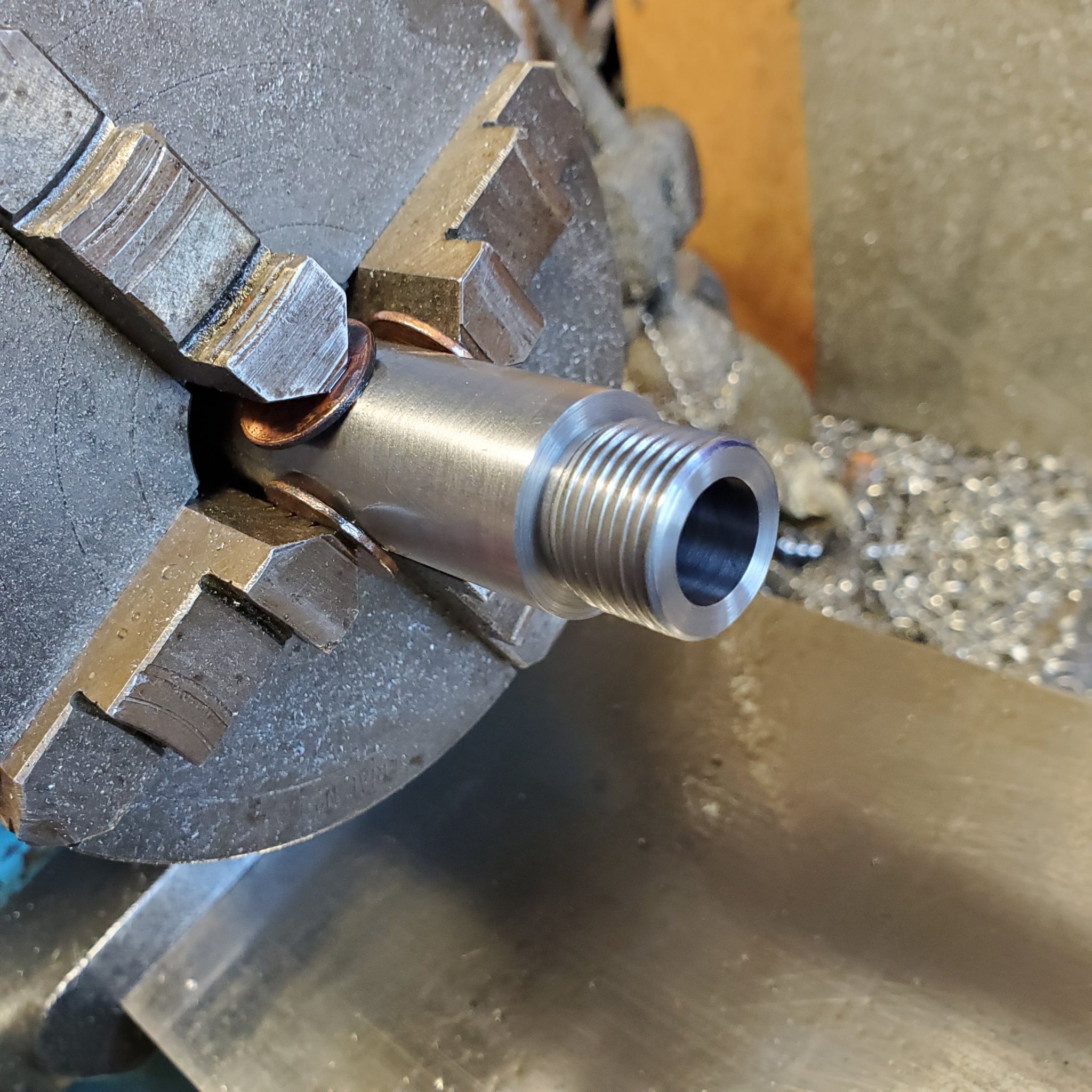

Personally I adore my 16" .375 Raptor Takedown. Easy to use commercially available magazines, no special bolt required, just barrel and bob's your uncle.
Quiet as a 300blk with a Dead Air Primal and Maker 400gr solid coppers, even quieter since I have a gas block that can be easily cut off if desired.
Build:
Aero M5 Upper and Lower
X-caliber custom barrel with RCA matched bolt
Cry Havoc Barrel Take-down system
Law Folder
Strike Collar Adjustable gas block
Aero BCG
JP SCS
Keymount muzzle (forget exactly whose, jmac I think)
rounded out with a 1-10 LPVO on a bobro mount for perfect return to zero on removal/remount.
breaks down into 4 pieces + mag, no loss of zero or accuracy.

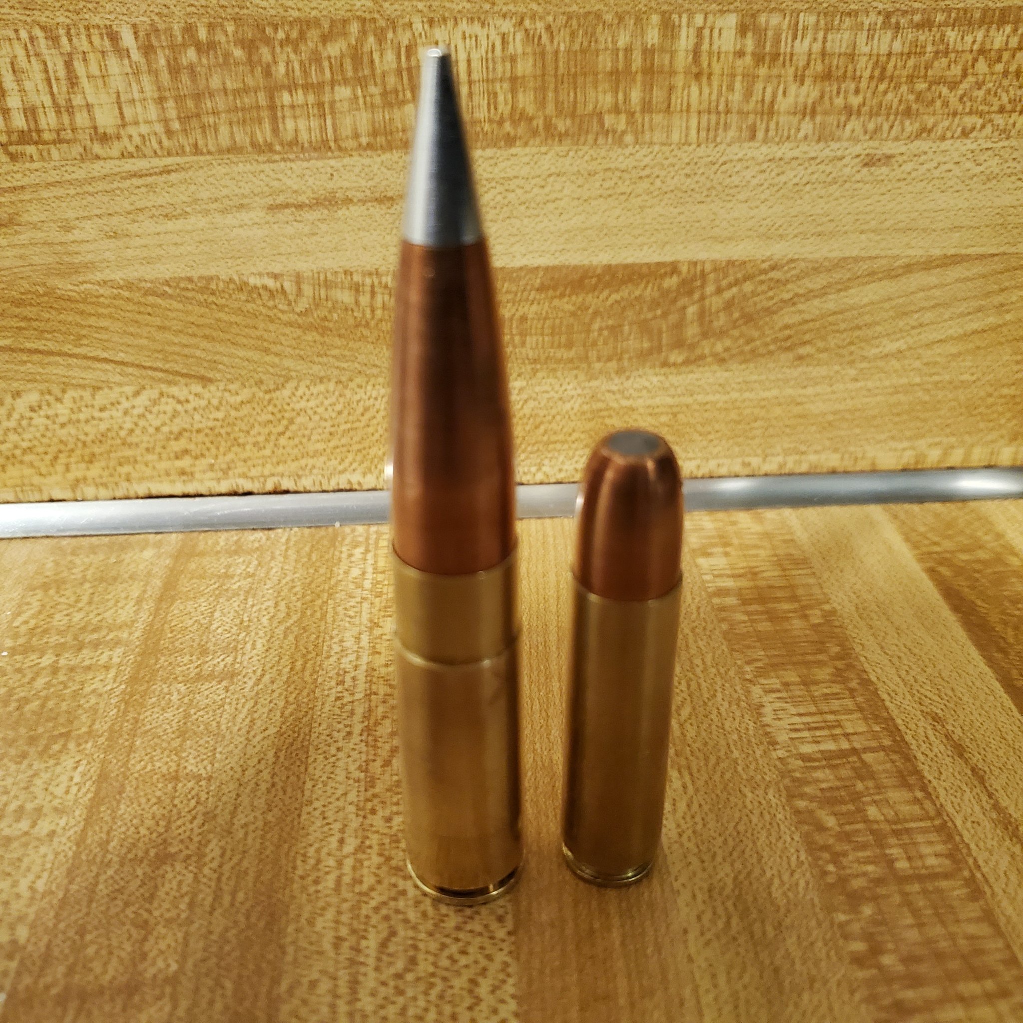

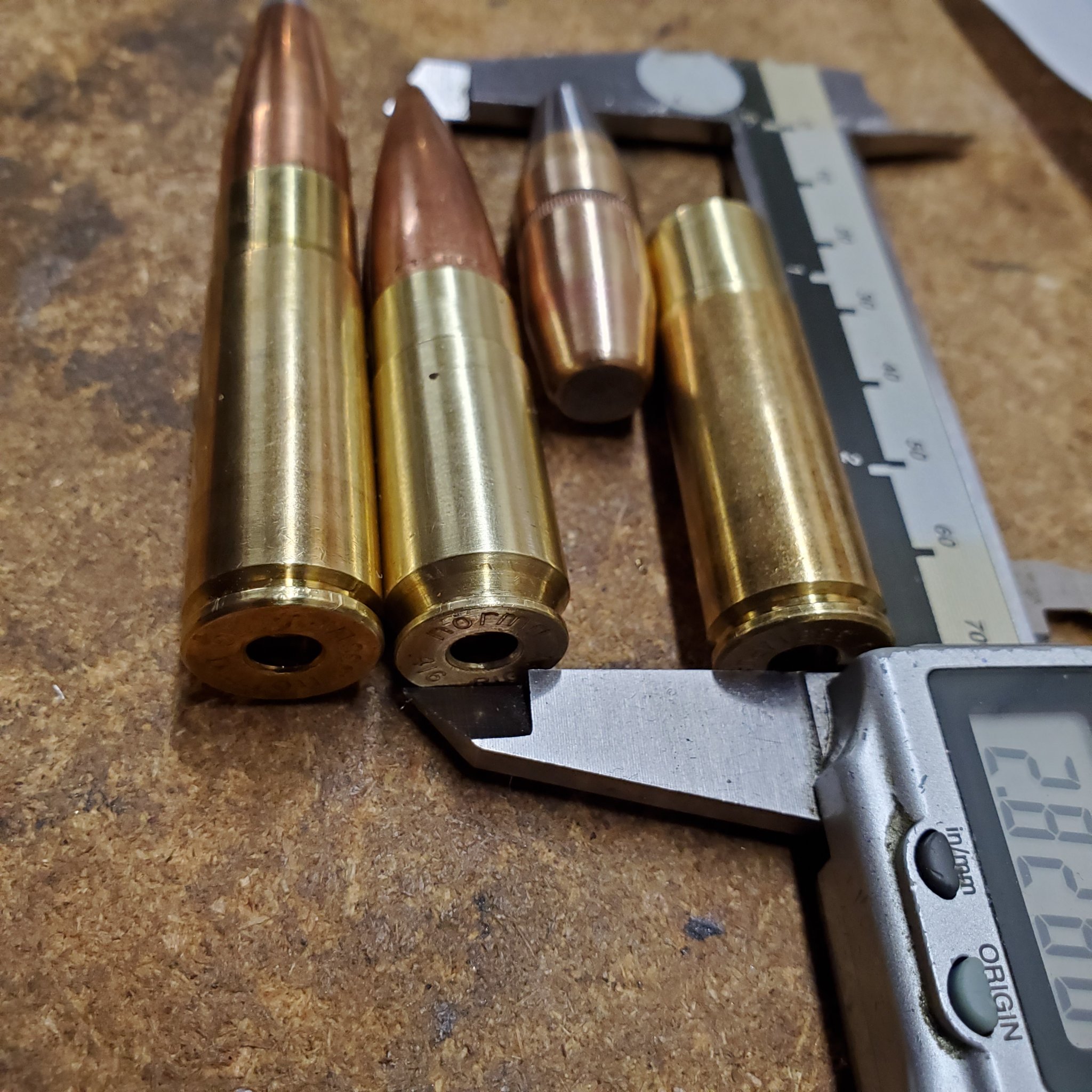

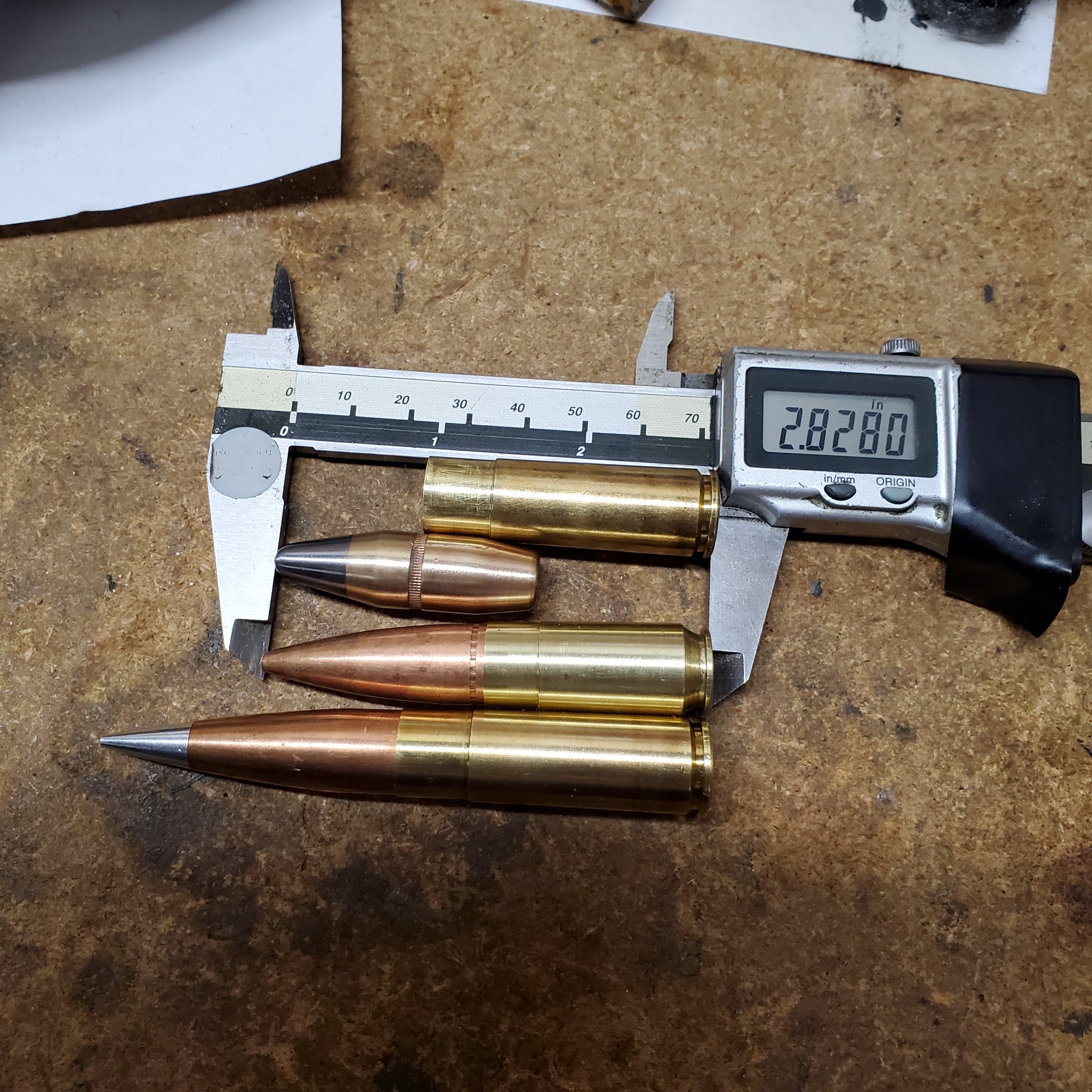

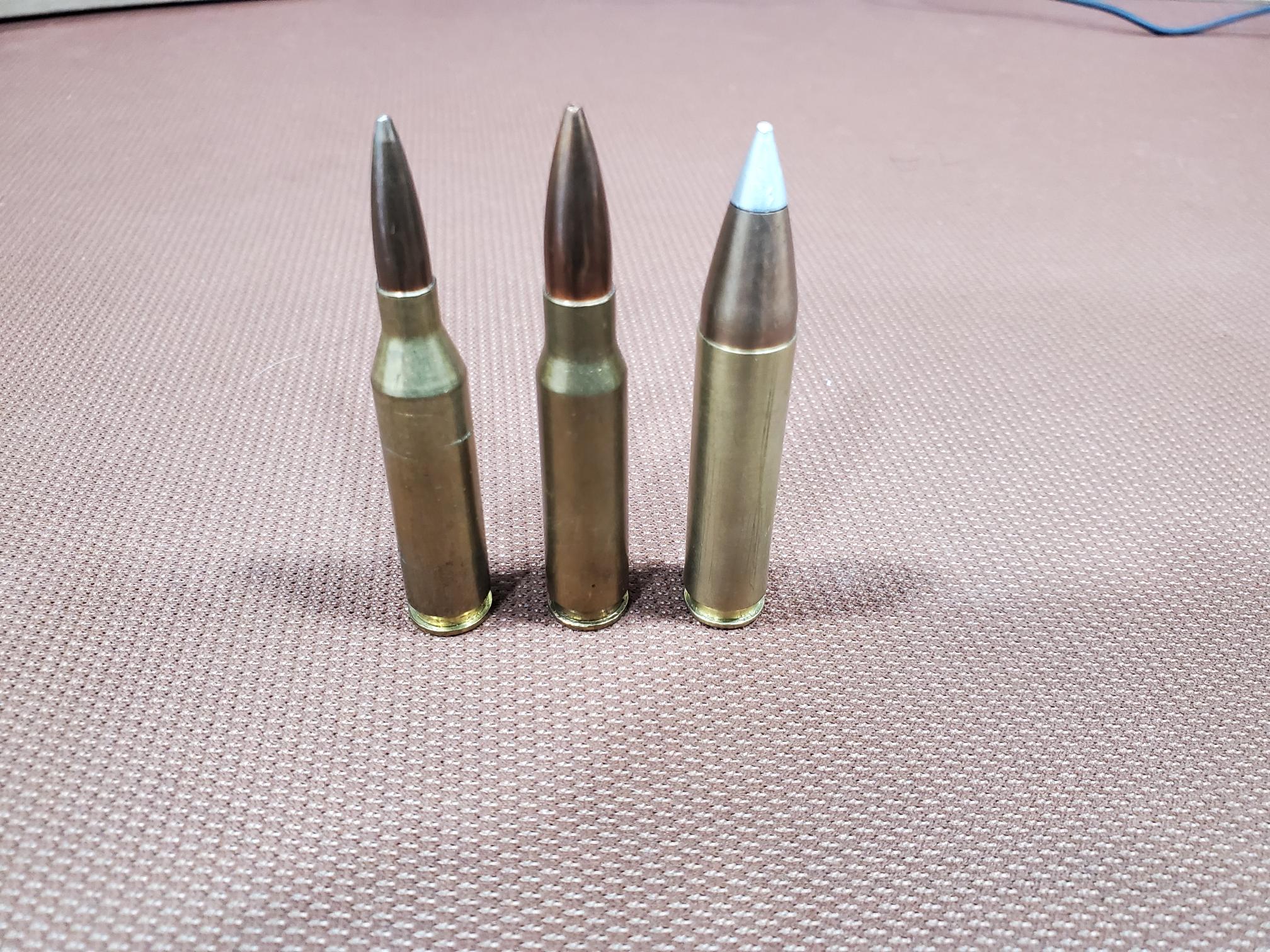

How about LR in 45 Raptor handloaded with a 300 grain Parker "match" bullet? Loaded cartridge overall length fills a LR308 mag without modification. MVs over 2000 fps. Picture from left to right: .243 Win, .308 Win, and 45 Raptor.
Troll OP or not, it could be a fun discussion.
A 700 grain bullet at 1000 fps would put a thwackin’ on a pig…

Have you seen an AR10 510 Whisper? Mag bolt face long action bolt guns are all I've seen.
No, not in its current form, unless you use shorter bullets in the 500 gr range, or less, cut the case heads down to fit 308 bolt face, & cut a new extractor groove, or maybe Use a different case. But it can be done. Too expensive and time consuming for the average guy...but not for a retired machinist, cause all the work is free...I have a .510 10 twist barrel ordered and a reamer from PT&G but it's for a long action bolt gun...so the 1002 gr copper bullets can be used.
This is a barrel chambered for a .500 dia case in an AR 15, not much chamber wall left limits it to about 42000 psi. Its threaded for the barrel extension. In next photo after the extension has been torqued down (I use 125 ft/lbs) the head space checked, and gas block journal turned and gas port drilled, & threaded for muzzle brake, all done in a day, if ya have all the tools ready to go. So yes it would be a different animal but it can be done.
A picture is worth a thousand words. I was planning in a LA bolt gun...but it "can" be AR 10 friendly... these are actual. 510 whisper cases ...but what do ya want to shoot out of it? Notice the shortened case with a 650 gr bullet it has a machined rebated rim and a COAL 2.8" it will fit the AR 10 platform. Then there is the homemade 550 gr bullet that will fit in the standard 510 whisper case and meet the 2.8" AR 10 requirements....but would need the cartridge head turned down for the rebated rim to fit the AR 10...so it's a rebated rim 510 whisper, but limited to bullet selection...unless single load on the longer bullets.
My AR 10 is modified to feed 2.940" to 2.960" cartridges depending on the mag. So there ya go it all depends on how ya want to attack it...the standard case with rebated rim and shorter bullets or short case with long high BC bullets. The 550 gr on a full super, regular 510 whisper case length load... the recoil would be rather substantial...but even subsonic it would smack pretty hard but leaving the above 650 grain bullets mostly off the table, unless ya shorten the case. So you can but it but it must be modified or compromised a bit, to suit your needs. Waiting on a barrel, for the bolt but might order another in the future for an auto. This is all pretty easy stuff on a good well equipped lathe, and too bad more shooters haven't spent time on machine tools. There is just almost no limit to what you can do...
