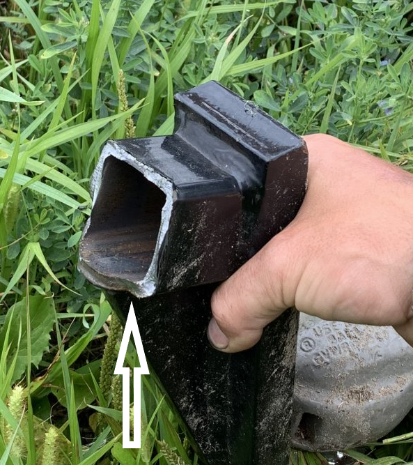

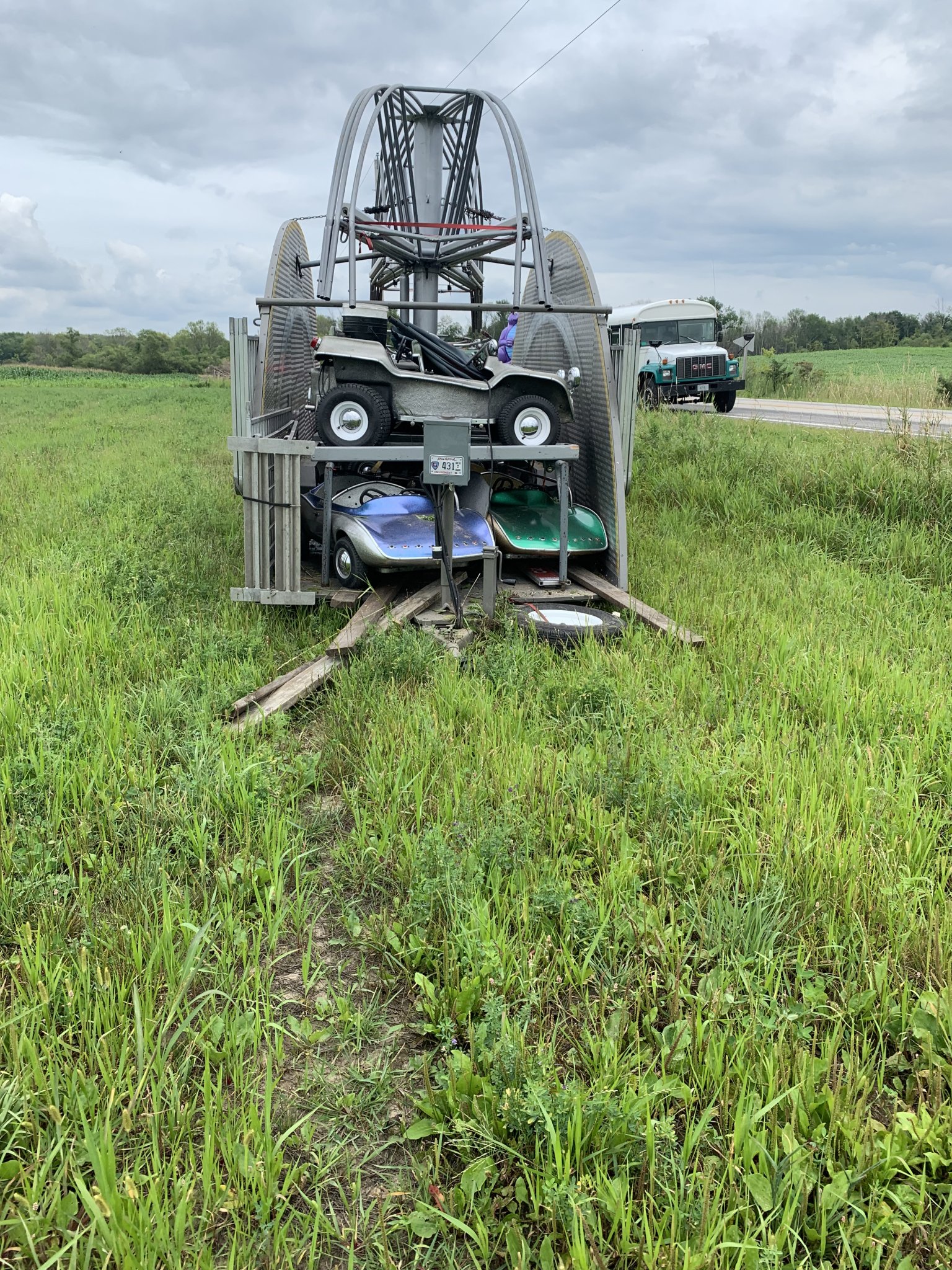

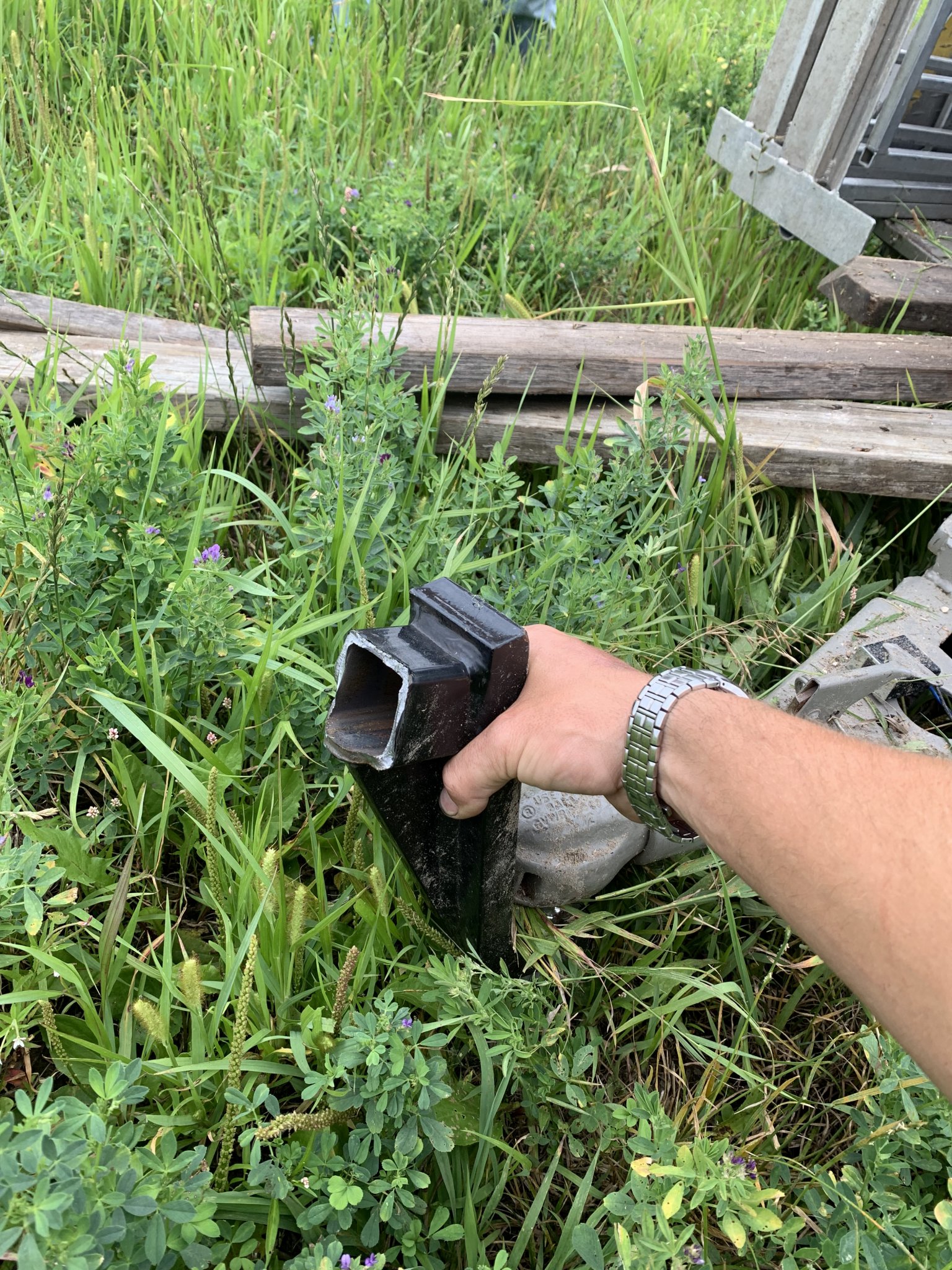

Some days suck a little more than others. The hitch snapped right off. The safety chains held for a bit until it caught something in the road. Broke a chain, then pulled the beak away switch. The other chain came unhooked somehow and by some stroke of luck the damn thing drifted off the curb side of the road and stopped in an unplanted field. No major damage that can’t be fixed before we open on Thursday.
Fuck Reese hitches!

View attachment 7128958View attachment 7128959
Can’t click like for this ^^^ ?. Fortunate though all things considered.
Looks like a fair amount of drop on that hitch. Do you guys think that’s a contributing factor over time?
It’s an 8” drop. Not sure if that’s contributing or not. We run a 13” on a much heavier trailer and haven’t had a problem. We made that hitch though. This is for a much lighter trailer and it’s on the back of an air ride trailer. I wouldn’t have thought this would be one that would have broken
Fuck Reese hitches!
Cheap Chinese Steel (?.....). Glad no one was hurt. (y) (y) (y)

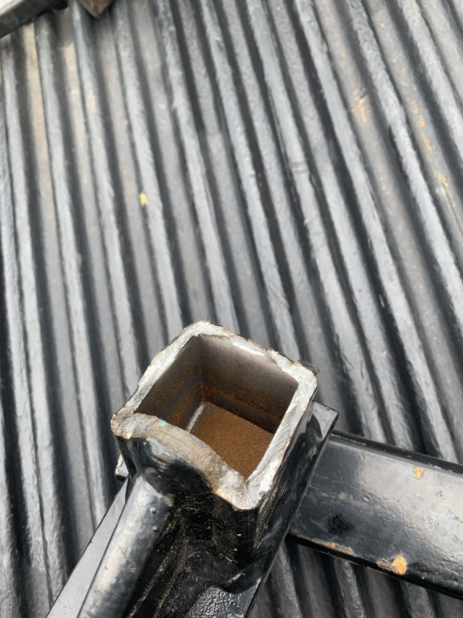

I agree, classic crack propagation from the coloration and the shape of the fracture. Repeated stresses.View attachment 7129347
I believe you are correct. I looked at it this Morgan’s the crack started on the bottom. Possibly the edge of the weld was undercut and stressed it there.

This is the first one we’ve broke the main shank on. We’ve busted the flat stock at the bend before and right across the hole the ball goes through but never a main shank.

I agree with solid all the way. 1018 cold roll and burn it in HOT then call it a day and never look back. Watch the undercuts on the gusset plate but it will be much less of an issue on the reciever with bar anstead of tube. Plus ChiCom tube is total garbage at best.
USA 2" 1018 bar stock may look expensive but what would it cost if that trailer rolled?
I’m sure we probably have a 20’ stick of 2” around. The funny thing is, we run factory built hitches for insurance reasons. If a hitch breaks, it’s one more persons insurance that they sue if someone gets hurt. It’s a lot like most of our ride parts. I can make most of them, way stronger and most of the times better myself. That’s not allowed though. Our insurance company wants the shit to roll down hill, and they don’t want to be at the bottom.
