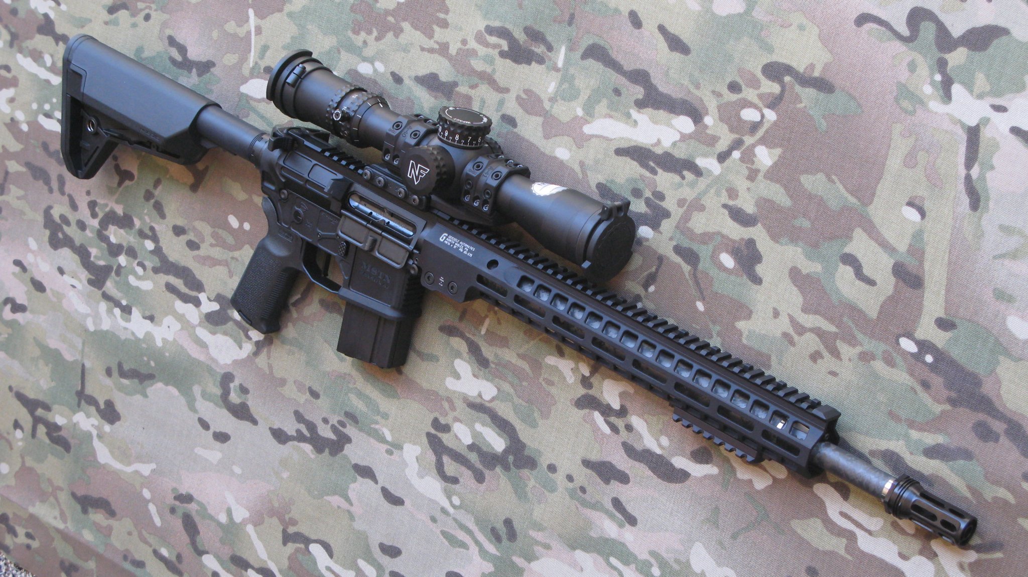

I'm half way to my 6 ARC build. I just need charging handle, Proof 20" carbon barrel and gas block.
-Sharps Livewire lower
-Magpul PRS lite stock
-Triggertech Diamond 2 stage
-Magpul K2+ grip
-Seekins Safety
-Aero enhanced buffer tube
-JP Silent Captured buffer
-JP enhanced upper
-Sgt of Arms 17.5 ARCA handguard

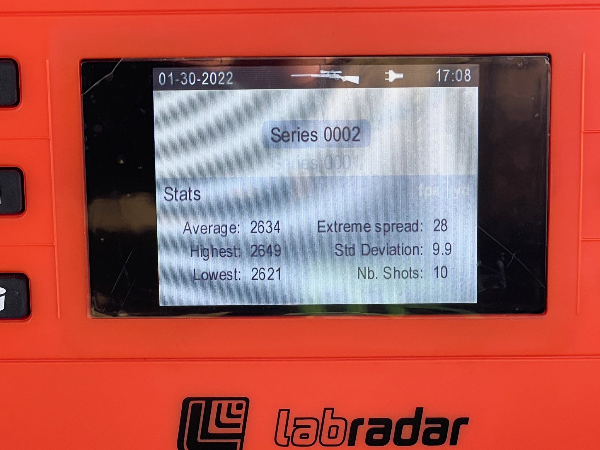

My 20" Proof with factory 108 ELDM is doing 2640-2660. No excessive fouling that I have noticed. It seems to be about the same or slightly less than my other 556 AR's as far as carbon. Barrel cleans easily and the JP carrier just wipes clean. It's an AR, they can run dirty with lots of rounds through them without cleaning contrary to what the internets says.

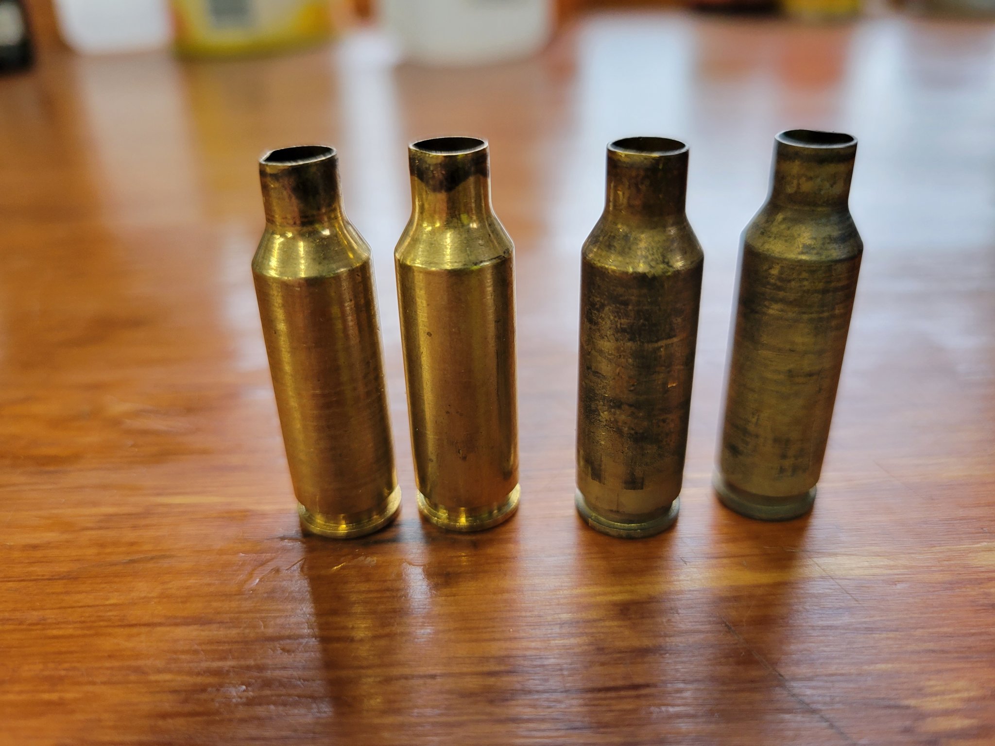

Pictured is fired factory brass loud/ suppressed.

Looks about par for the course for my LVR loads suppressed with both my ARC and Grendel. My suppressed .223 loads are probably a little cleaner, but not a ton, with much lower amounts of 8208.

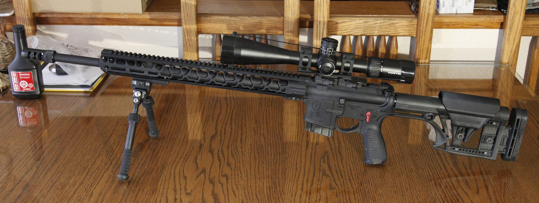

It shoots fricking amazing across the board..just a note I did opt for the matched bolt. Some groups at 100, no bs, this tube shoots.
Weight comes in just a smidge under 15lbs.

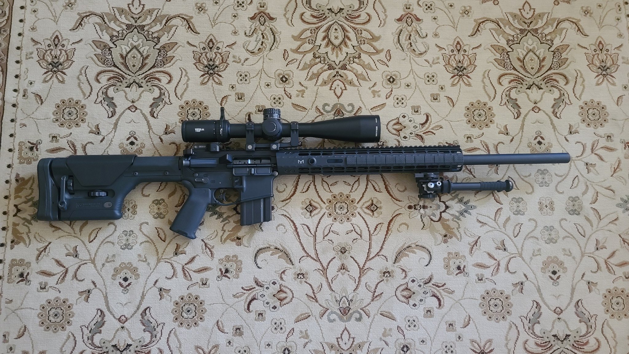

It's kind of like it's owner - a bit on the flabby side - 11.9 pounds. But remember, this is a range toy to shoot out to the shorter side of ELR. It has an Atlas bipod, a 22" barrel and a 5-25 PST Gen 2, so I wasn't even slightly worried about the weight. And that's why I want to build a recon / hunting rifle with a 16" or 18" CF barrel and lighter weight parts. I won't go overboard on the ultra-light side because I want it to be durable.
