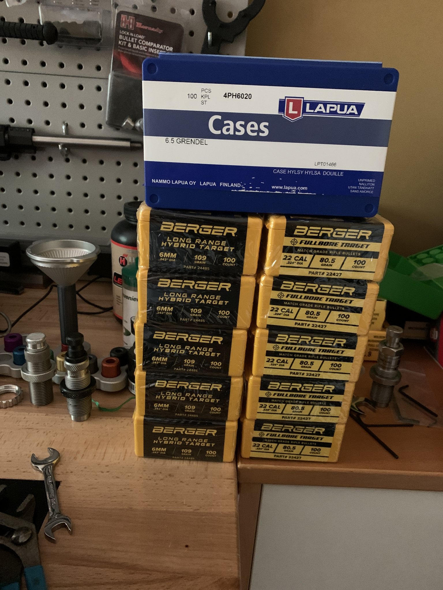

Just got new pills & Brass for the ARC & Valk (500 Starline inbound).
This will make Snuby madd! Sorry man, but ARC brass is unobtanium & Hornady wants Lapua prices for it if they ever sell it.

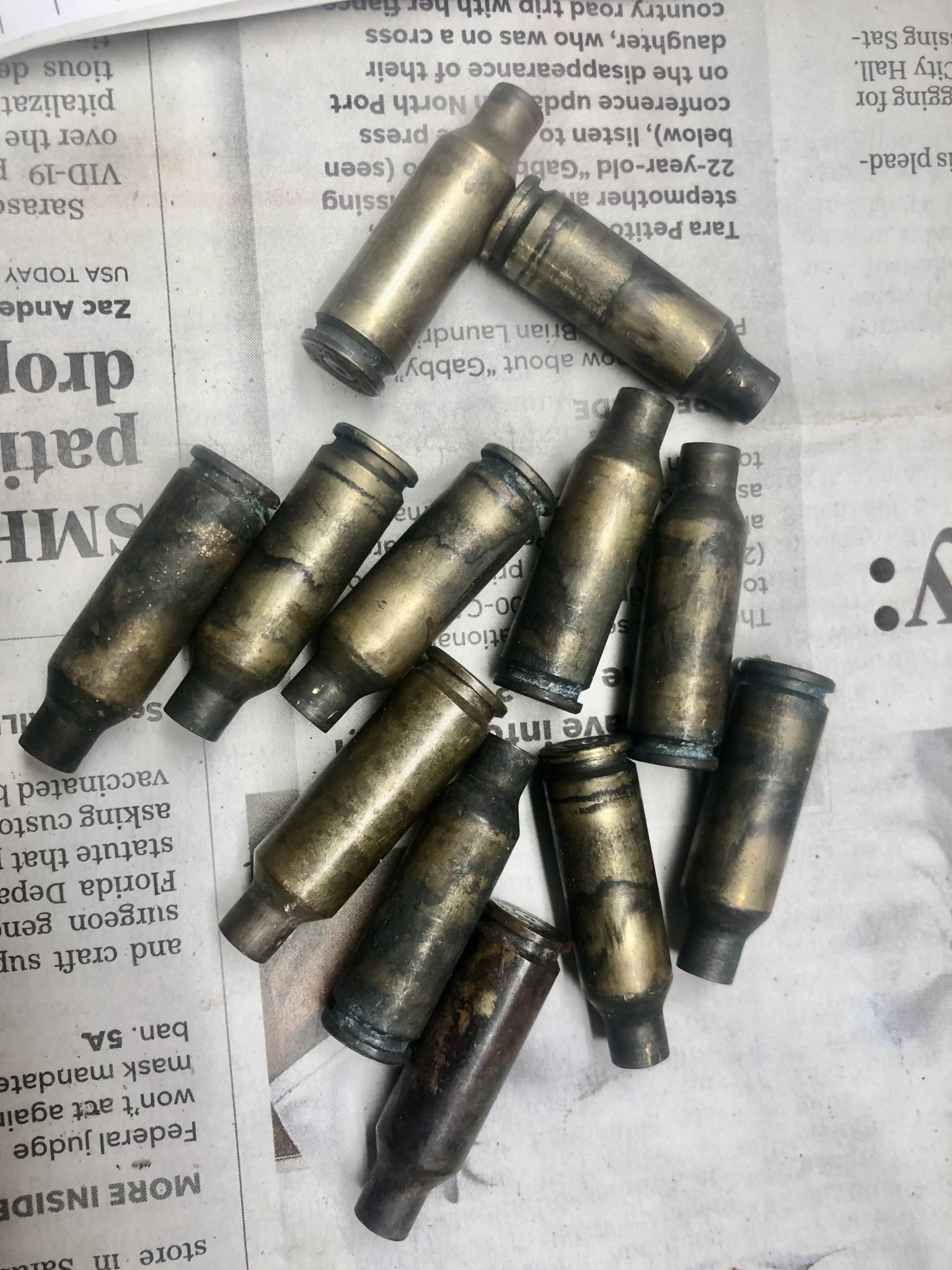

Heck, I don’t reload but have recovered all but a few pieces of brass from my range trips. I put them all back into the boxes they came in and stash it away.
I might have to start reloading when I get more retired.

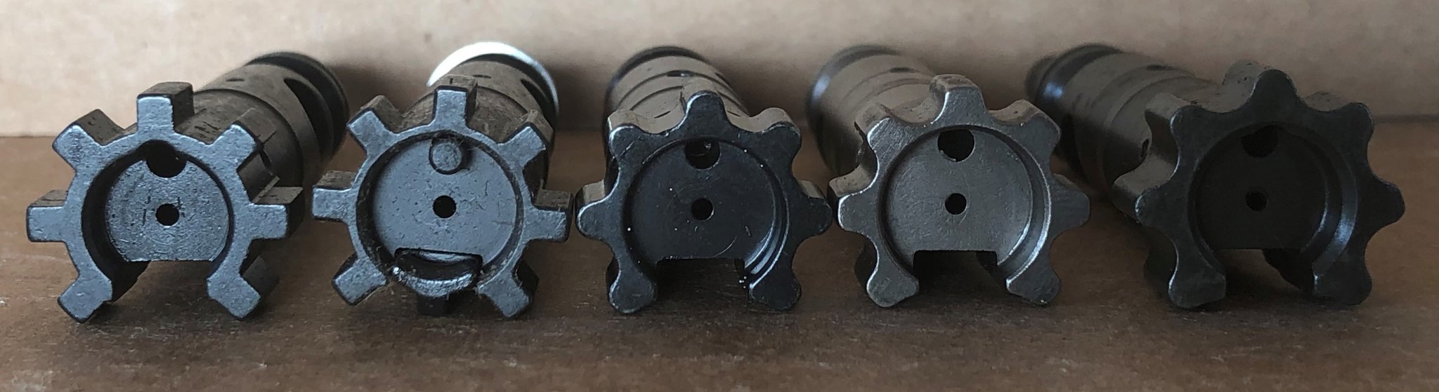

The Grendel with a .136 recess is weaker than the bolt with the .124 recess 7-8% but still weaker, any engineer can explain that in about 30 seconds. The bolts below are the Titan, quite a bit stronger than the type 1 or 2.

Stronger than your average bolt. The bolt on the far right is the 800 series was designed to allow shooting a 6BRX(308 diameter) in and AR15, it came first around 2007 there were also Grendel and 6.8 versions. The second from the right and second design is the 750XD also works with 308 sized, Grendel, 6.8 sized cartridges. third from the right is the Titan, I designed it for Grendel/7.62x39 sized cartridges, never made those for the 6.8. 2 bolts on the left are 5.56 and 6.8 I believe.

Would the Titan be only for bolt action rifles? Do they make one for the AR-15 ?
EDIT -- Didn't see the variety of bolts until I opened my laptop, sorry. Question: Then which of the two on the right would be best for the 6 ARC? And what might the difference be between them? And thanks for offering this info up.

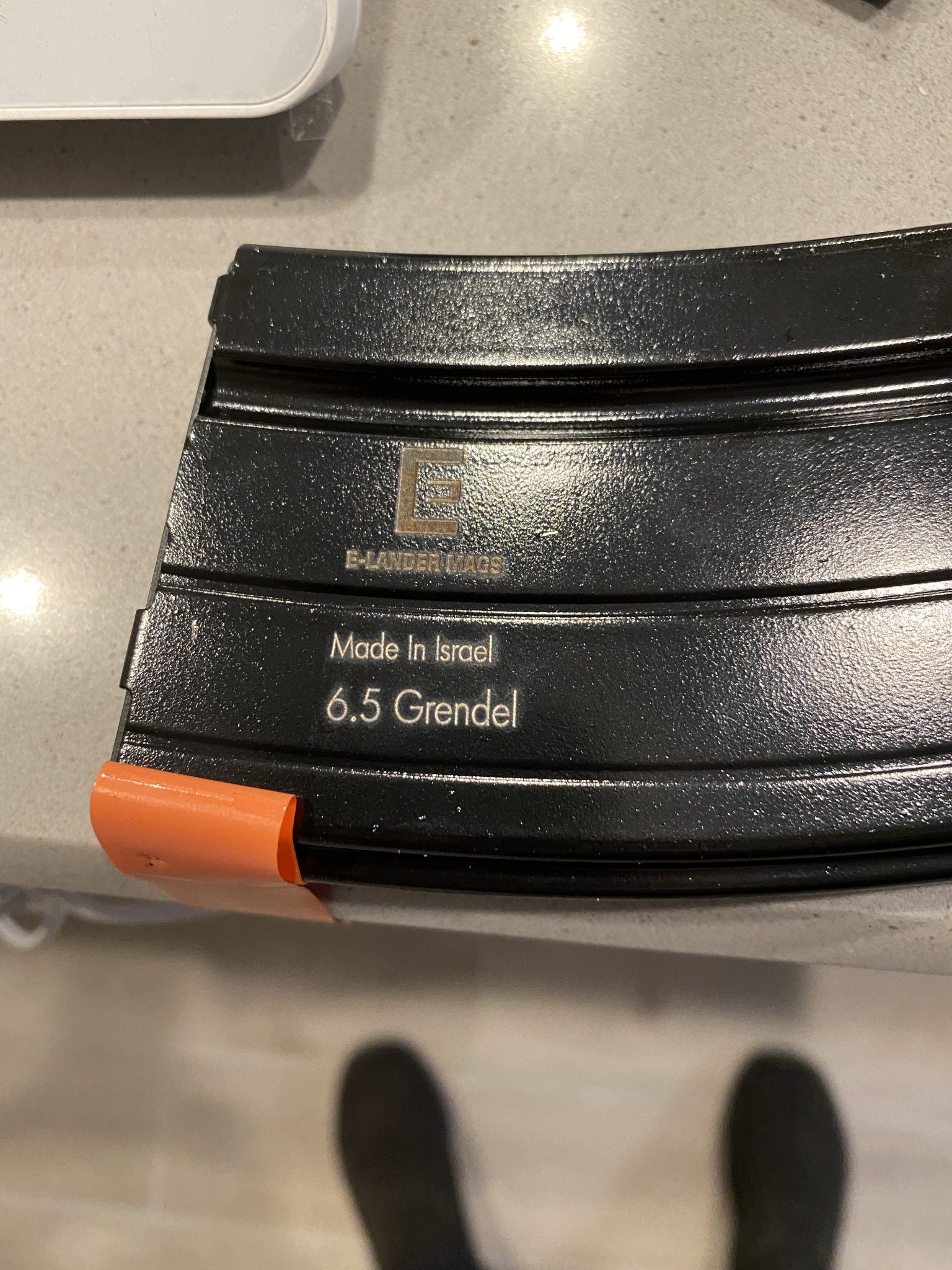

So you guys shooting the ARC aren't using the same Grendel mags that have been around since 2007-8? ASC made them then CPD split off and started making them in house. Bill A was using Lancer for a while. So what are these new ARC mags?
Honestly do not remember where the mags came from. I know of no new mags for the cartridge. Doesn't mean there arent any. Some of the ones I have are 17rd Israeli made for 300 BO. That said they only fit 11 of the ARC. Pic to follow
The orange tape is how I separate calibers

I remember those and that was probably what Bill A (Alexander Arms) was recommending. Should be good mags, IMI.
