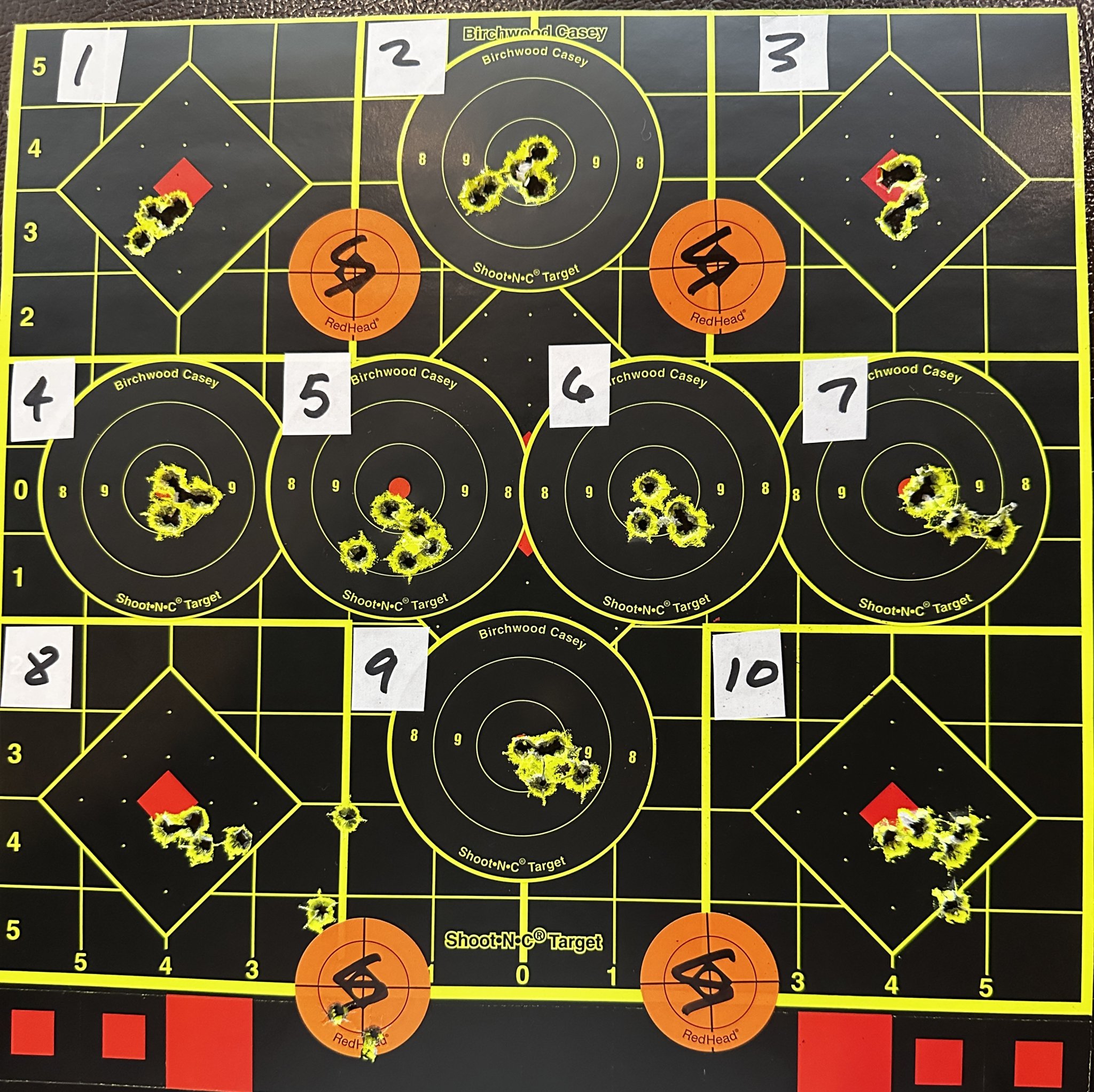

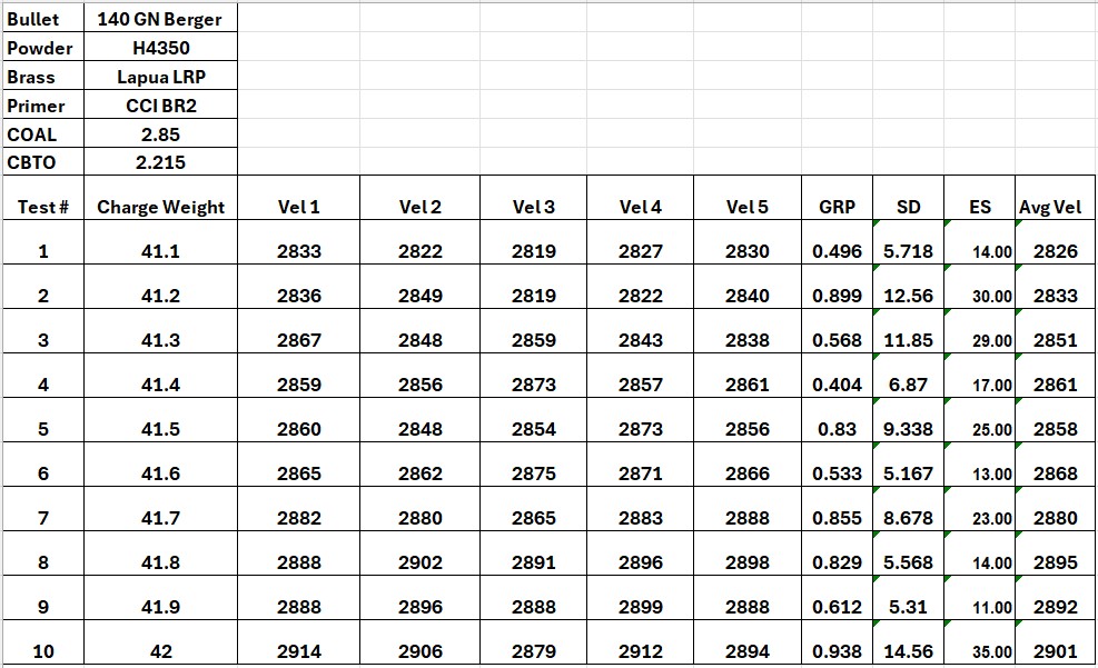

Working on initial load development for a new rifle. Barrel has a little over 200 rounds down the tube. My current thinking is to run seating depth tests with 41.0 gn and 41.8 gn loads. In a previous test I tested 40.9 and 41.0 loads and the ES/SD results were almost identical to the 41.1 gn load shown here with slightly lower velocities. I didn't have a lot of time yesterday, so I wasn't able to let the barrel cool down as much as I would have liked which likely effected the group sizes in the later groups as the barrel and the can were getting pretty warm. All groups are 5 shots at 100 yards with virtually no wind measured with Ballistic X. All test loads were seated .005 off the lands with Berger LRHT 140s. I'm curious which loads others would choose and why if they are different from the ones I'm planning to use. The extra shots between targets 8 and 9 are sighters. Thanks in advance for your thoughts!

I’m not seeing any real differences, once you do bigger sets of data. Adding in your comments about barrel heat opening things up; I would pick 41.8 and do a slow 10 shot group on paper at 300. Data collection at 100 is where I do Rimfire. 300 paper shows differences better for centerfire. Also, very slight variations in position often obscure load differences on target.
All of those groups and SDs look like they’ll be plenty good for hunting and practical shooting. Probably fine for PRS as well. You aren’t likely going to make significant gains by shooting another 1-200 rounds trying to find the “perfect” load. I’m usually a fan of 41.3-41.5 grains of H4350 with a 140. That has consistently worked over like 5-6 barrels

Your charge increment of -0.1 gr is real tight and doesn't really correlate with the variations in point of impact. It looks like you have some variations due to moving from target to target. You also didn't mention if you shot round robin or not.
I would actually pick #5. The group size isn't the reason. The POI of 4 and 6 is the same and #5 group isn't bad and shift in POI is probably shooter. The SD's are good. Comments on the type are target above should be considered as a possible issue.
Thank you for the replies. I wasn't actually too concerned with the group sizes in this test so much as finding a node where the SDs and ESs remained in a tight window.
Personally, I would go for #4 based on group and I would discount ES/SD with such small data set.
In the past, I've had super ES/SD with initial 5 shot LD testing that increased quite a bit with larger data sets.
Also, personally I'd also look at something around 2,750 fps and see if you have an accuracy node (and I hate using that word "node") down there also.

You're increments of .1 grs is too small for that size of cartridge, IMHO, making really hard to see what'd really going on unless you had a much longer string of POI's. For the future, I'd suggest .3 gr increments for that many POI's. With that said, I'd suggest you retest 4 through 6 . . . even #7 to see if there's anything there can can repeat. I think there might be something there.
What I like to look for in a series of groups is where the center of the mean average is at a pretty consistent position.

Shoot and See target are terrible for recording groups IMHO. If you have an in-home printer try some of these: Free Printable Targets
The 41.7- 41.9 Grain range of H4350 is a known accuracy node with 140 grainer's in many a 6.5 Creedmoor. BTW

I would actually go lower and see about a slower node from 2750-2820
And your speeds are smoking on the top end. When I was shooting 6.5 creed with a 26” barrel I was dumping 42.3 of H4350 and still below 2850.
41.5 is for thinner brass like hornady. The op is using lapua which is thicker and therfore powder charges need reduced. That's why 41.8 is near 2900 instead of near 2800. Show me some case head pics and I bet I can find you some ejector marks. I woukd suggest backing off also.
No pressure signs at all. Have to admit the velocities are higher than what I expected and I would prefer them lower to extend the life of the barrel which was the reason I was going to do the seating depth work on the 41.0 load. The primers are CCI BR2s and neither the primers or the case show any signs of pressure.
Looks like hodgdon says with a couple diffrent 140s and h4350 40g is about 2700 in a 24" at 60k psi. 2900 is starting to get to pressure shooting 123s in the 6.5 creedmoor. It's your brass though. You certainly aren't the only one out there playing "it's safe in my gun" on the ragged edge.

Since 3-7 are basically going to probably switch places as far as "best group", I'd probably just pick #4 or 5 and run several more test groups with it.
Not that .1gr charge difference isn't cool to experiment with, but the changes in accuracy are going to be negligible...you are literally changing a quarter of a percent. Any perceived change on target is due to the shooter at that point (if you aren't shooting a bench rest setup).

.1 grain increments is way too granular to try to discern a difference. In a 6.5CM a .3 gr increase should generally produce a 25fps increase. So you should be seeing a 8-10fps increase 'ish. But as you can see the correlation is loose and there's really no rhyme or reason to your right side column chart. It's just white noise.
2900 with 140's is really fast. You're probably going to wear the barrel faster which is going to create a slightly less consistent load/ barrel from batch to batch. You want to be looking for 2750 - 2800
.005" off the lands is too close to the lands. You should see about .002 - .003" of throat erosion every 100 rounds. You will also get carbon fouling that will change where you perceive the throat to be when you measure it by .002 - .005". This means that .005 jump you have will be more affected by fouling in the barrel than say a .020 - .030" jump. I would just set those Bergers to .020" jump and leave them.
I think your target and data chart is a good example of white noise. All your groups are generally the same. There's no obvious difference. The velocity data is the same. If you picture a 6" black circle and plot all your data inside that black circle, that's what it would like like in a graph. Generally invisible and falling within acceptable variation. Just some data inside the normal noise of dispersion and variation of generally high quality reloading components and an average shooter. I don't think you always have to shoot a 30rd group to perform load development nor do I think load development is a myth, but your data here would be what someone who argues the opposite would use.

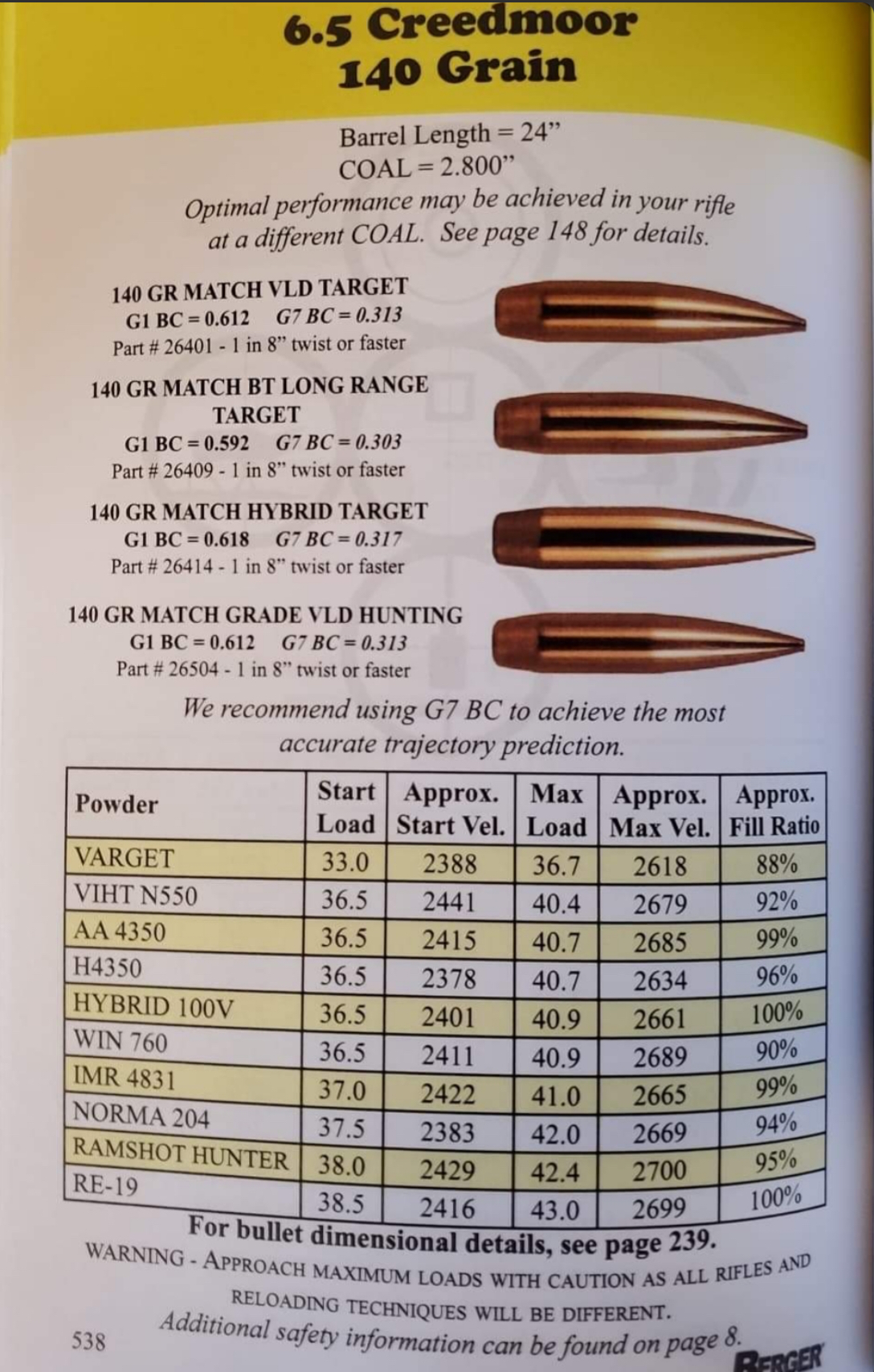

I hadn't seen the Berger reloading guide. Interesting that they say the max load with H4350 is 40.7. Hornady says its 41.5 with a 140 bullet. I just checked Hodgdon and they say its even lower at 40.0 with a 140 ELDM. They don't show any data for the Bergers at all.
Using my lapua brass I find that the books are usually pretty darn close to where I start having increased bolt lift upon extraction. Most all of my creed h4350 loads are between 37-39.5 grains.

His Barrel length is 26" not 24", his COAL is 2.85" instead of 2.80, and his powder lot, chamber, barrel, case and primer maybe way different than that tested by Berger. Min and MAX charges are wise suggestions, but are not rules written on stone tablets.
Also notice that Berger lists Starting Velocity and Max Velocity as "Approximate". Again nothing written in stone.....
One rifle may hit MAX charge way under book value. Another rifle may go way over. My Quickload BTW shows 41.9 Grains H-4350 @ 2.85" as a 58K PSI load @2773 FPS.
I take the OP at his word. Apparently the loads were perfectly safe in his rifles.
If it was me and my rifle I would lower the charge down to 41.1 grains to maximize barrel and case life. 2826 FPS avg is plenty of velocity for a 140 grain bullet for steel banging. ES of 5.7 and sub 0.5" groups are nice too.

your groups are all the same, and there are no nodes. just pick a charge of velocity you like and go shoot.
and if I were you, i would pick at least 0.040'' jump. and I would try 0.080'' if group* will shrink.
*a group of at LEAST 20 shots !!!
Max loads are, IMO, written by liability lawyers.
