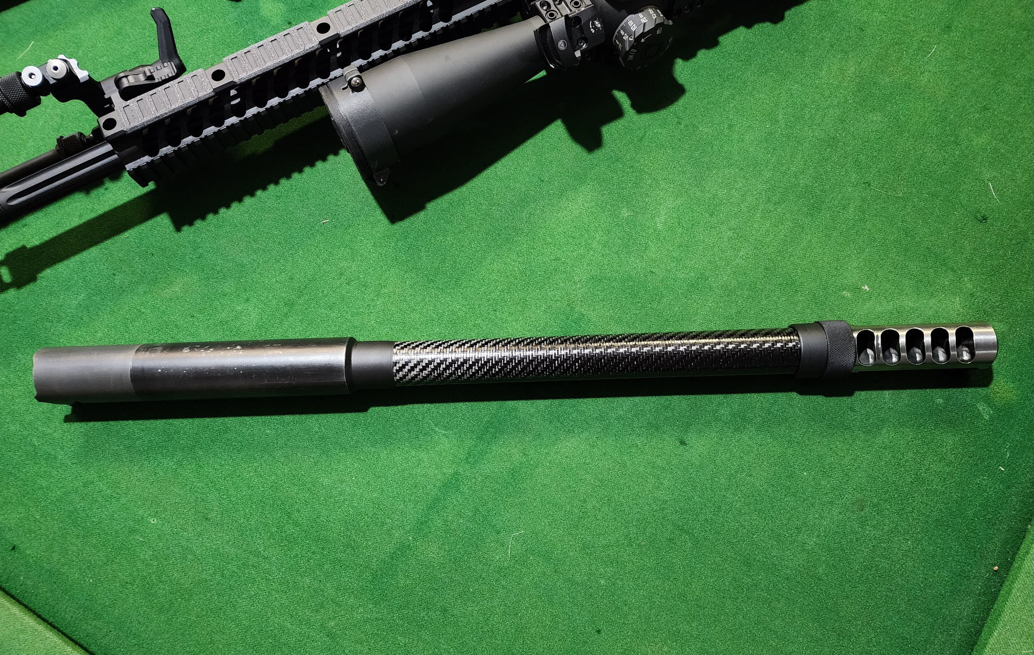

Very cool barrel, mine looks similar but it is in SS. Who made that wooferocau?
