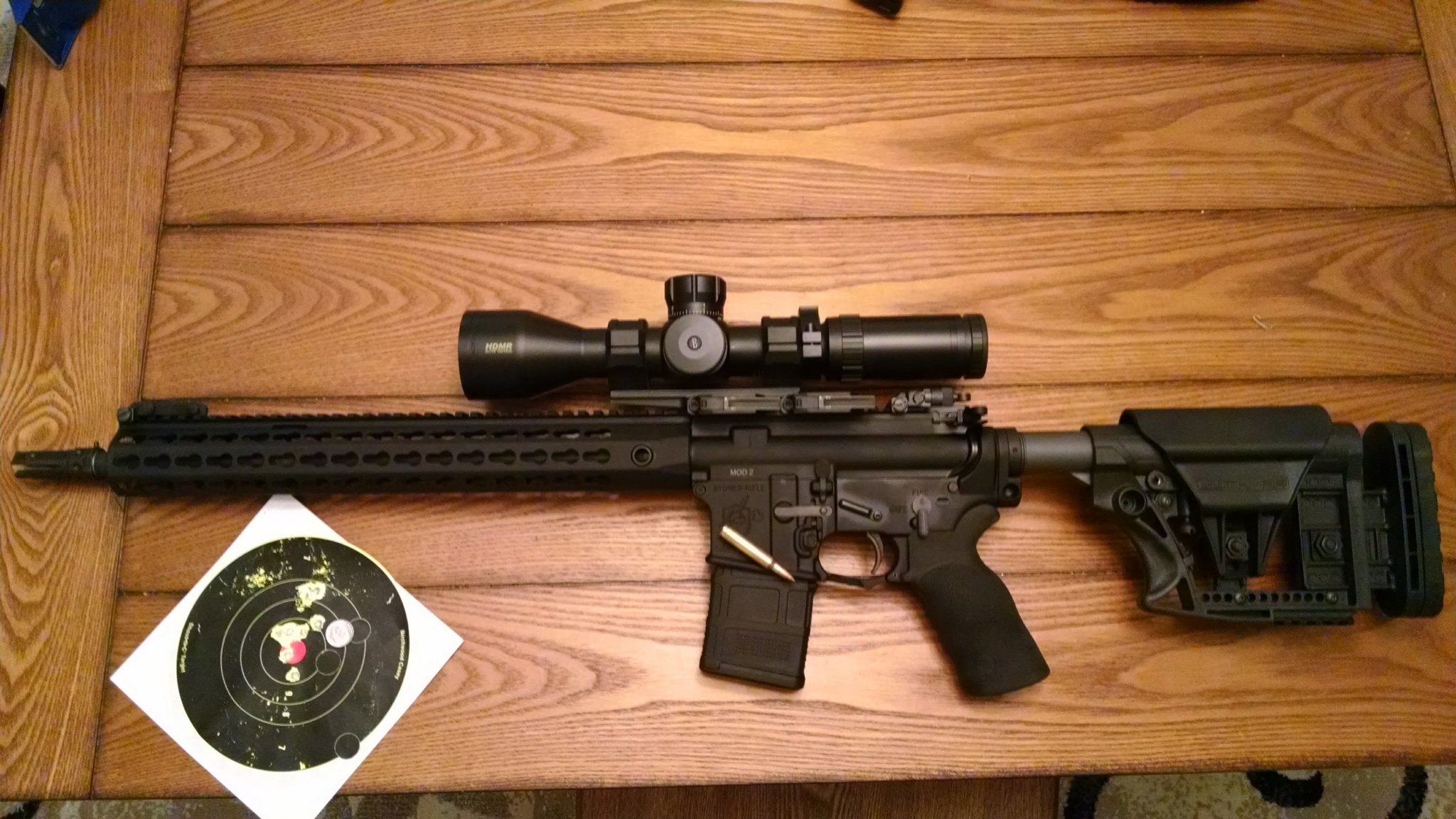

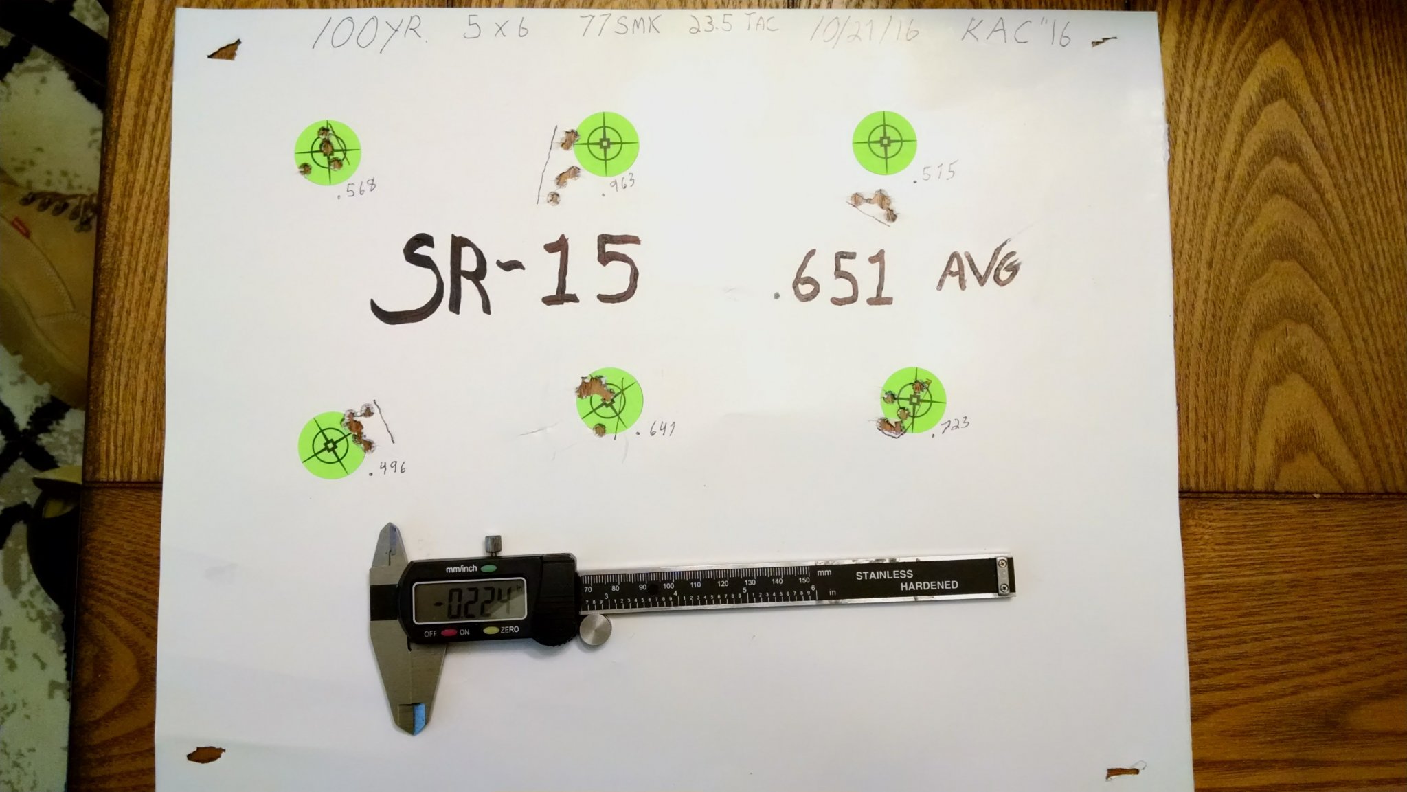

I’ve had two KAC SR-15’s, two LMT MWS’s, and BCM barrel that were 1/2 minute guns. Chrome lined barrels can be extremely accurate.
My KAC was a shooter as well..
First pic with the rifle is two groups, 10 rd group in the center and then a 5rd group couple clicks higher using the same point of aim. Then I shot a 6x5 with it.
