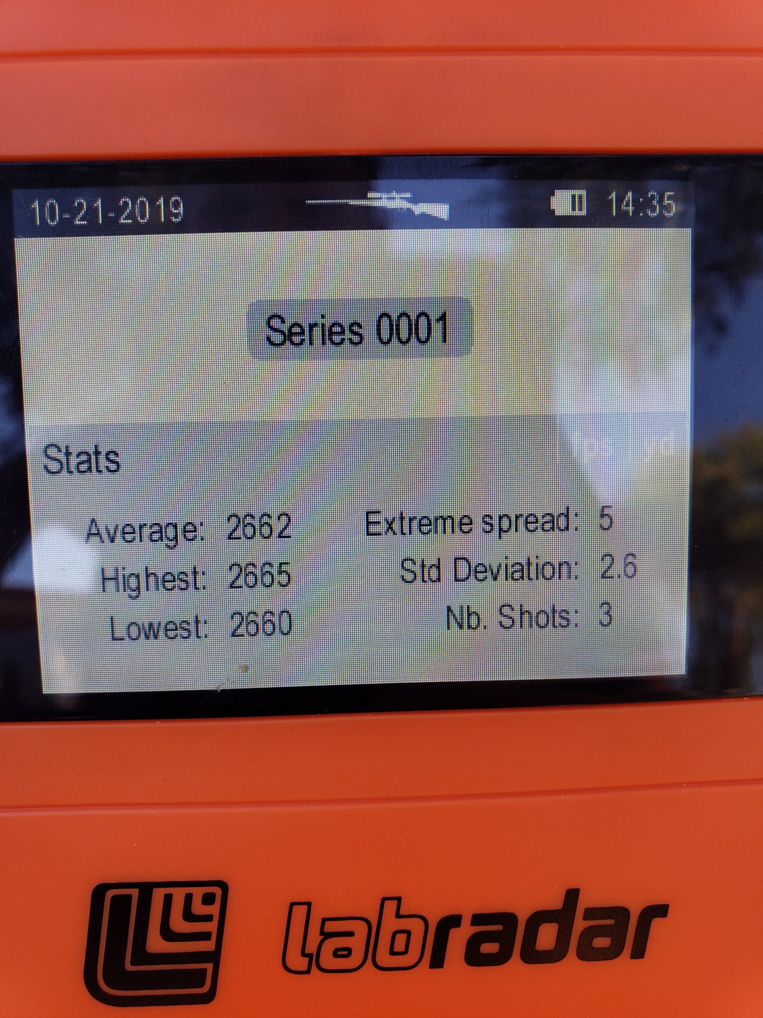

Shooters world precision powder has loaded about identical to varget and I have actually had better SD's. This is with the Berger 200 20 x.
Ah HA! Thank you for that - real-world results. I guess i'm stuck on Varget for the temperature sensitivity thing being at altitude and having 60-70 ambient temp. swings, as I shoot during all seasons.

Unnerving? Yeah, my last batch of 208ELDMs for my 300WM at the upper range of powder loads had me standing up, rifle on the ground, turning my face away and pulling the trigger to make sure I didn't do something wrong. Living and learning at it's finest.
