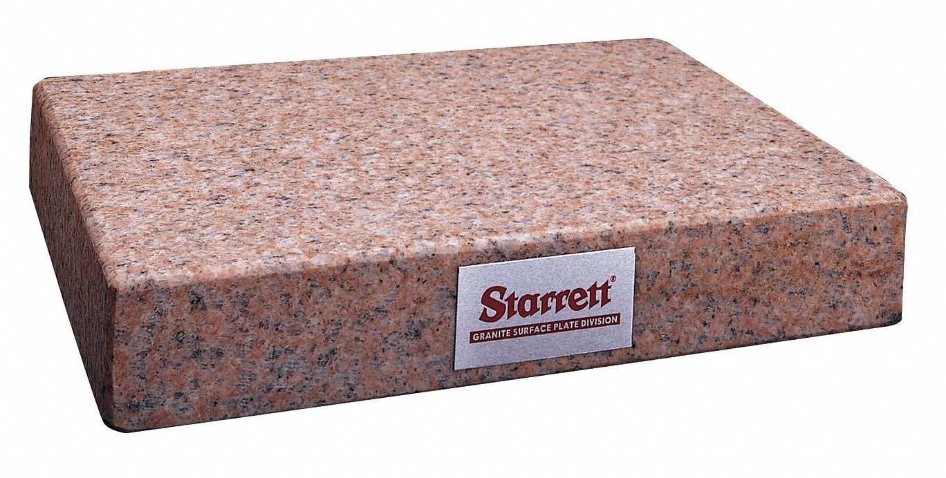

That's what I have.Why not start with a nice flat surface?
You learn to use the tools you have avalable to the extent of thier capabilities.
