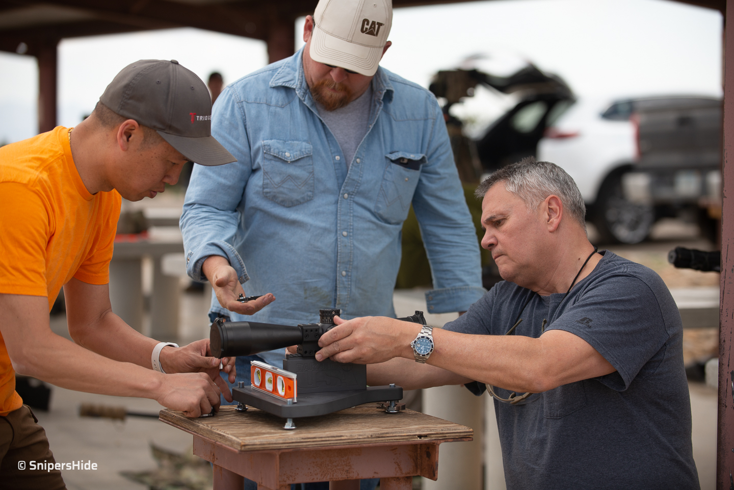

We finished a two-class yesterday
Marc tests every scope in our classes,
We adjusted 5 students, (even the OCD ones) for canted Reticles in the rings ... in fact, we see 1/3 of all students have scopes that are mounted with a slight cant in the rings. 99% have no idea, regardless of how they mounted them.
It is so common we have taken to testing every student because it's fixing the problem.
Then to compound the amount of shooters who naturally push and pull the rifle, canting during the shot process is even bigger, at which point the fix is not the scope, the level or the shooter, but the Bipod. The only way to fix a student who pushes and pulls the rifle over ( 99% to the right) is to give them a bipod that locks in place. In some cases we even set the rifle to 11:30 because they are so heavy-headed, we have to adjust them off-center, knowing they will push it straight.
Canting a rifle that is set up, level scope to level rifle is worse than canting the scope or rifle to account for a known value,
The main problem we face is the butt of the rifle. Manufacturers fail to recognize the back of the rifle needs to be adjustable for both cant and lift. You fix the back of the rifle, you solve a lot of problems

We constantly adjust people off-center to fix problems,
None of these are that, and we specifically ask dickhead ... who did you hear or read that line from, ME, of course you did ... trying to repeat my own words back to me is even worse

I didn't read a question, I read an accusation... as if we don't understand how to adjust a rifle to a shooter. That we can't or don't recognize when a shooter might need an adjustment, or before we move or adjust anything, we don't ask the student if that was intentional.
