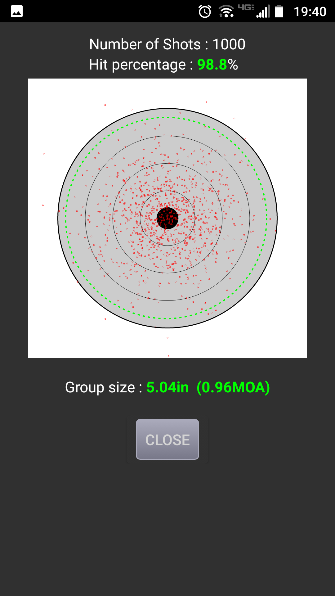

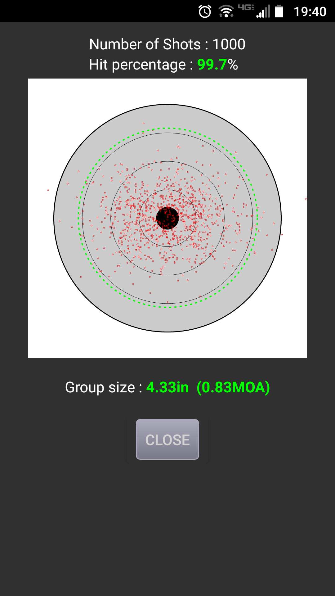

He's right. The SD is just there because people want it there because in there is the average based on the number of shots fired. The SD of the AVG is just the variation of the average. Not because Lynn Jr. knows statistics. Because he can see it down range and makes the connection with the ES. There isn't much difference between 8 to 16 for SD down range on target when their ES has no material difference. SD is just OCD for picky reloaders for the most part. Oh shit, look! Tighter group wins the match. It does make a difference. Never mind. He is not right. He was referring to his father's world record abilities.
SD=8
7037725
SD=16
7037727
