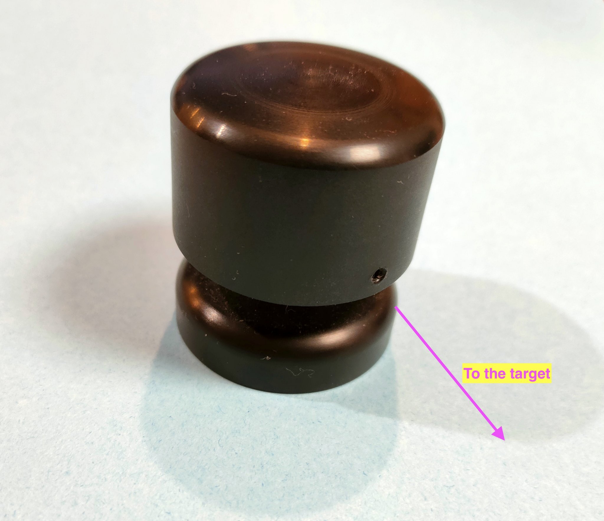

With Strelok the Calypso wind meters allow using the phone's compass to set target azimuth. A Kestrel with Strelok requires aiming the Kestrel at the target then pressing the target direction button in Strelok.
One thing to be aware of, not every cellphone or tablet has a built in compass. Accuracy can suffer if it is using GPS assist for direction as it requires some movement to tell where it's pointing. So read up on the specs of your device before committing to anything.

  1. Set Ultrasonic Wind meter on a tripod and orient it to the first target
  2. Aim your phone to the same direction as Ultrasonic and tap 'Set Ultrasonic azimuth' button
  3. Find the target with LRF and range it
  4. Enter distance to the target and slope angle to the program
  5. Aim your phone to the target and tap 'Set Target azimuth' button
  6. Read calculated elevation and wind hold for this target on the phone screen
  7. Shoot
  8. Rotate swivel bench to the next target and repeat from item 3
