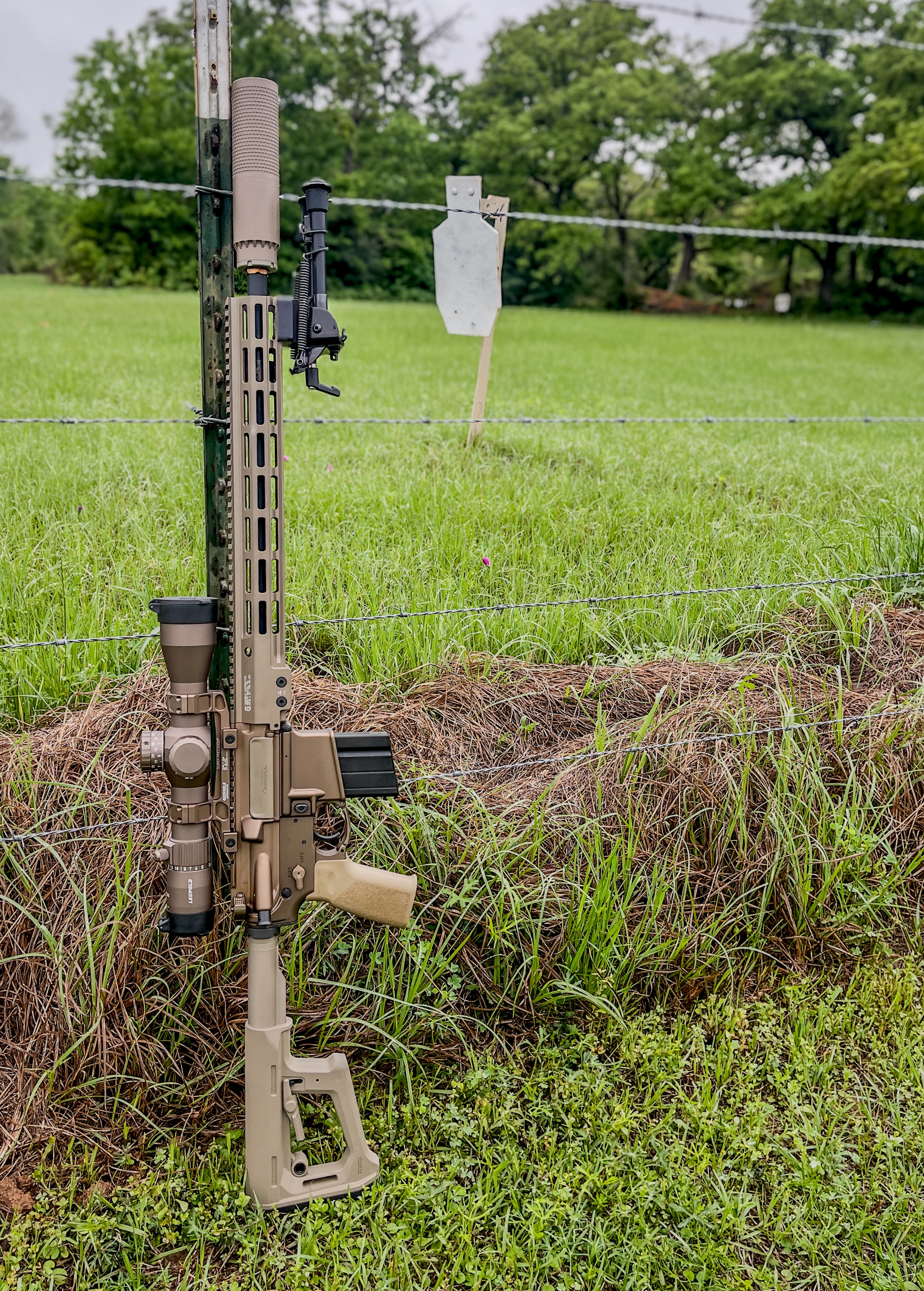

I’ve been trying, but I’m sure I’ve missed some. My build is a little different.
San Tan receiver set
Craddock RTR 18” barrel RLGS
Superlative Arms piston kit
Geissele MK4 15” handguard
Geissele SDE trigger
BCM MK2 buffer system
JP enhanced spring
Radian Raptor CH
Radian Talon ambi safety
NightForce NX8 2.5-20 in ADM Recon mount
HUXWRX flash hider
HUXWRX FLOW 762 suppressor
Started with a T0 buffer, but I’m seeing signs of the BCG outrunning the mag. Extraction is right at 3 or 330. I’m going with a T1 bufferView attachment 8618800

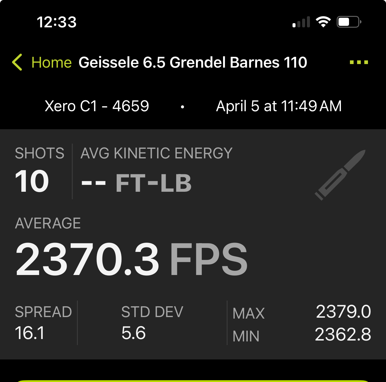

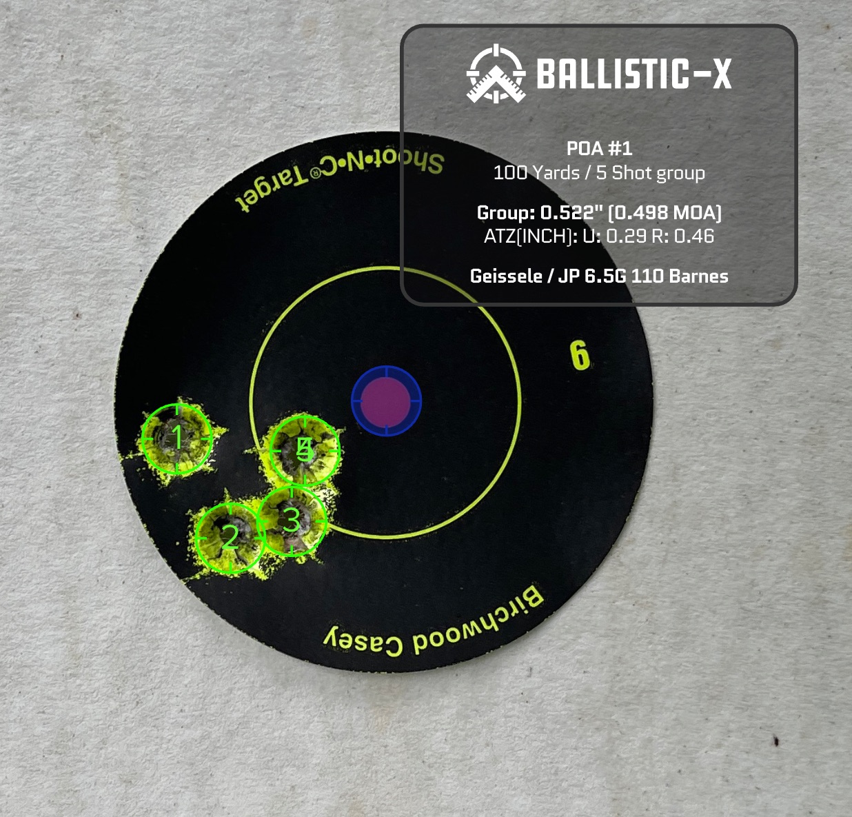

One manufacturer has already said they would load the Ultra-High Velocity Grendel once we’re finished with development. I know I want a new ogive shape, so the current experimental bullets are more weight-based than form factor-optimized.
When you play with weights, you have to set up center of balance and center of aerodynamic pressure too. Tail-heavy bullets are prone to yaw-induced instability, but these aren’t tail-heavy right now. They are more focused on traditional engagement ranges though, basically matching or exceeding 14.5”-18” 5.56 but from an 8.5” barrel.
With the Alpha brass, it’s very tempting to push pressure, but we started out staying limited to 50ksi MAP. Speeds with that pressure are well in-excess of anything I ever anticipated. 8.5” barrel uses pistol-length gas, otherwise there isn’t enough plug dwell time.
Reactions: tmaz and Bakwa
At 900yds, it’s really begging for 12-16x on the top end with a larger objective.
Not sure how many scopes out there are compact enough for the 12” Grendel to do that, but it performs really well out at distance, almost indistinguishable from an 18”.

Everything Geissele minus JP barrel and bolt. Shot with factory Barnes 110. Group is rounds 11-15 through the gun. The OCL infinity with vented cap is great on this rifle, quiet and kept the gun clean.
