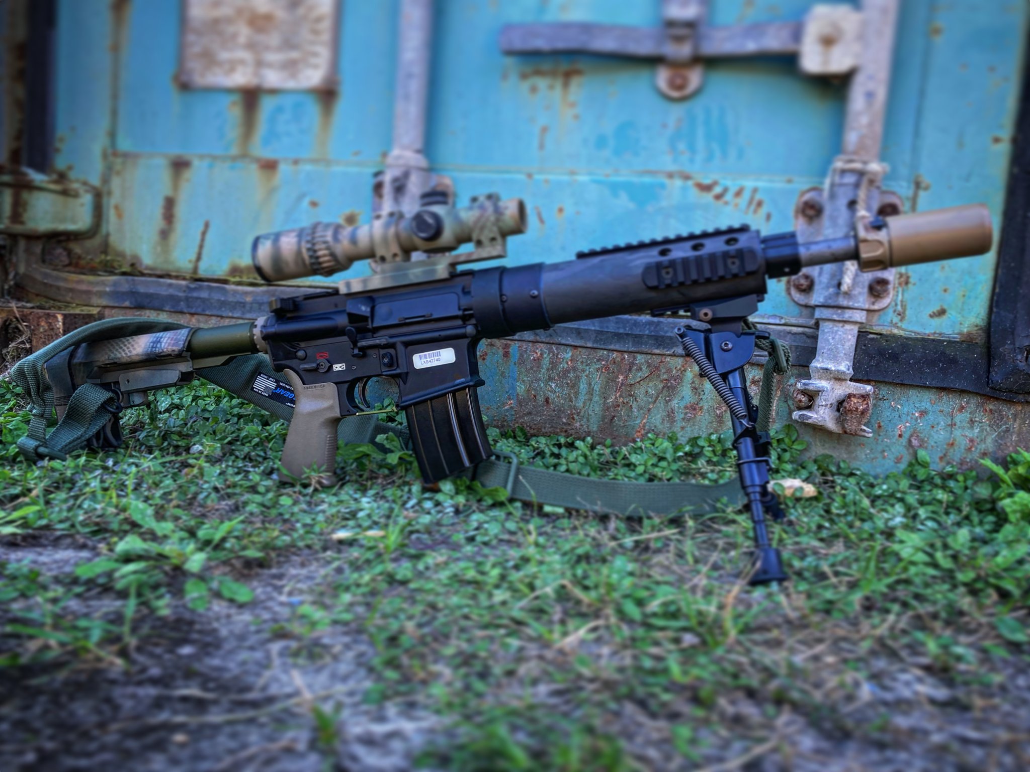

I’ve had this 12.5 Noveske barrel for a few years now and keep changing the configurations of the setup.
When I go to shoot groups I keep accidentally getting the occasional .5 minute results. The thing is definitely a shooter.
I need to take a few animals with this guy and report back with pics.

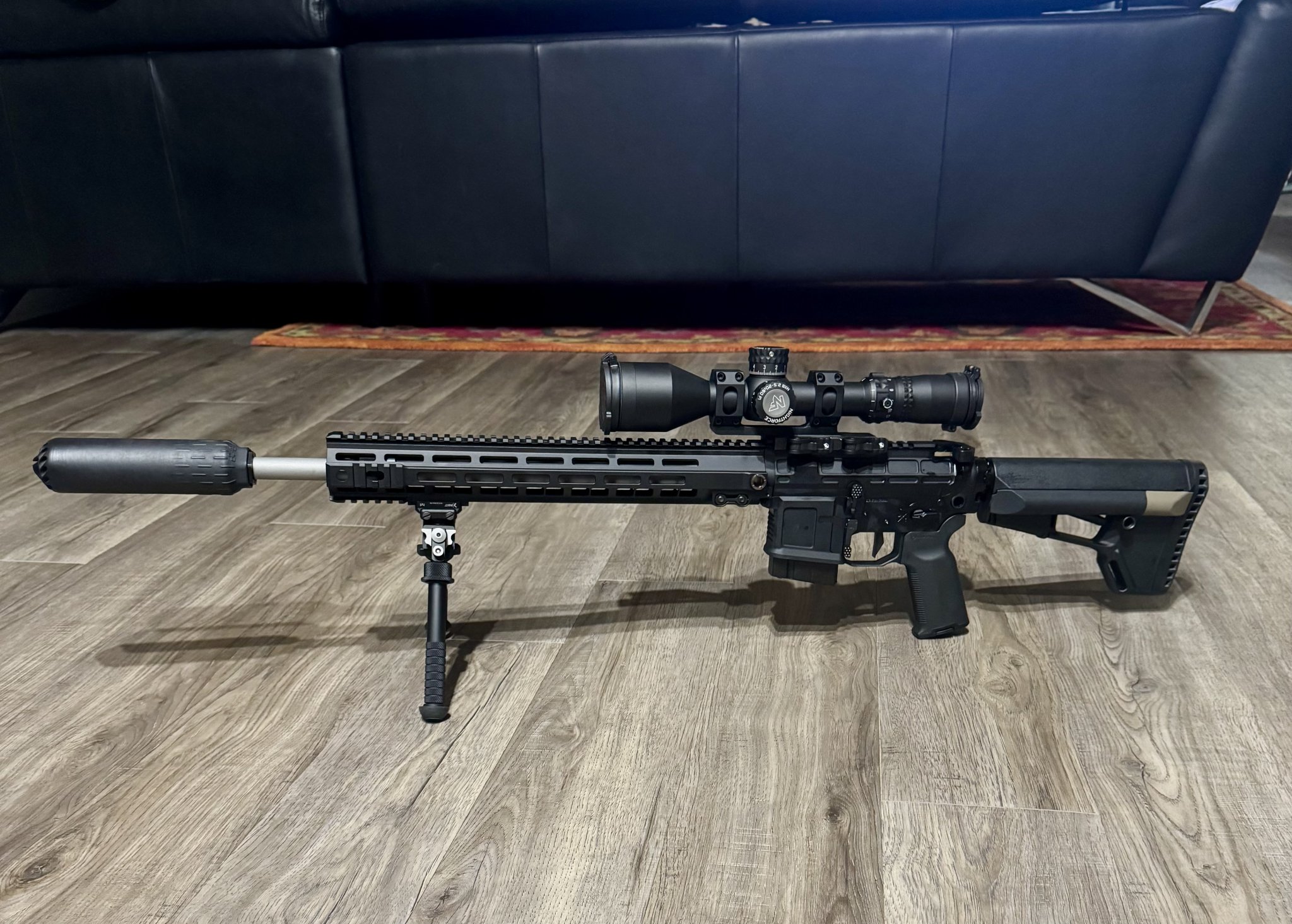

No one will ever accuse me of being an innovator, but I just finished a 6.5 Grendel build. I’ve only shot it at 100 yards, but so far I’m very impressive with the soft recoil and nearly no muzzle rise shooting 120 grain Scenars. I’m very much looking forward to load development and hopefully at least 800 yards.
Specs on your build? The last parts are on the way for mine, 13.9” sbr build. Have been following all the Grendel threads closely.

I’ve been trying, but I’m sure I’ve missed some. My build is a little different.
San Tan receiver set
Craddock RTR 18” barrel RLGS
Superlative Arms piston kit
Geissele MK4 15” handguard
Geissele SDE trigger
BCM MK2 buffer system
JP enhanced spring
Radian Raptor CH
Radian Talon ambi safety
NightForce NX8 2.5-20 in ADM Recon mount
HUXWRX flash hider
HUXWRX FLOW 762 suppressor
Started with a T0 buffer, but I’m seeing signs of the BCG outrunning the mag. Extraction is right at 3 or 330. I’m going with a T1 buffer
