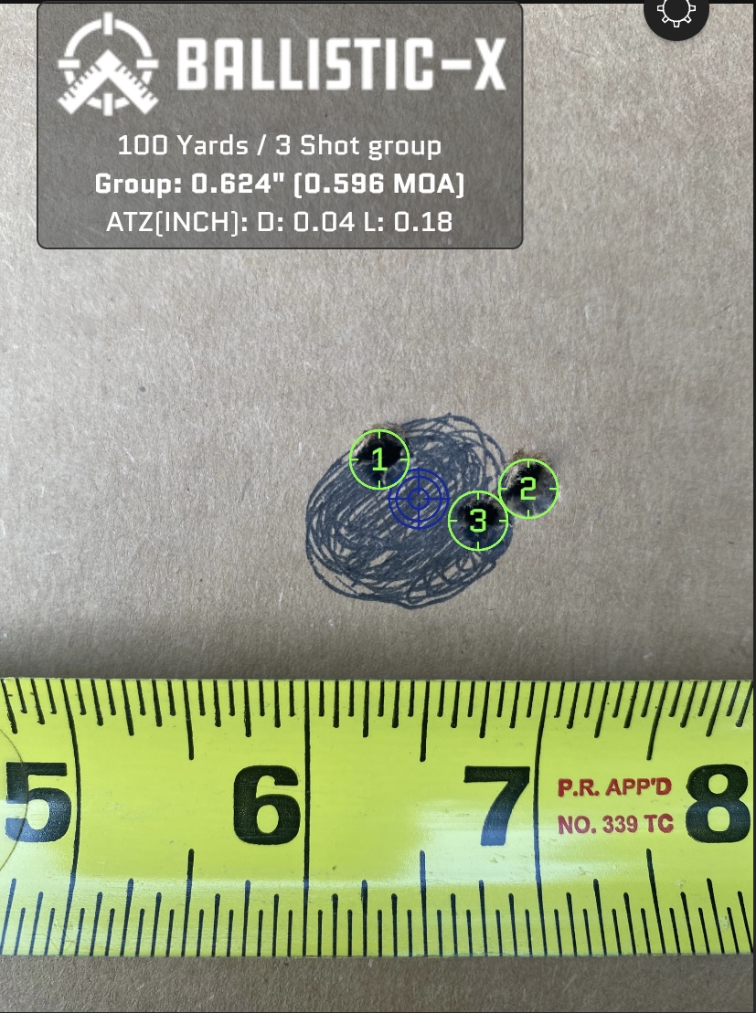

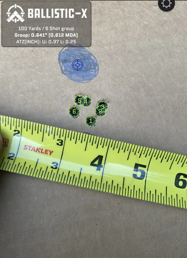

I put this one together last week for a coworker after he shot one of mine. He took a chance on a 16” Aero barrel that was on clearance at B Kings for $88.00. The gun short stroked until we opened the port up, then it ran fine. Hornady Black 123 ELD gave us 1.5” groups. I figured he got what he paid for. We tried some of the 100 gr Vmatch ammo and the little rifle loved it. We cronographed 20 rounds and it averaged 2558 fps. Took it back home and cleaned it and the barrel cleaned up really quick. Barely a trace of copper after shooting 60 rounds through it.
He was certainly happy with the little rifle. Some people seem to get lucky on those bargain barrels.
He was certainly happy with the little rifle. Some people seem to get lucky on those bargain barrels.View attachment 8486921
View attachment 8486935View attachment 8486936

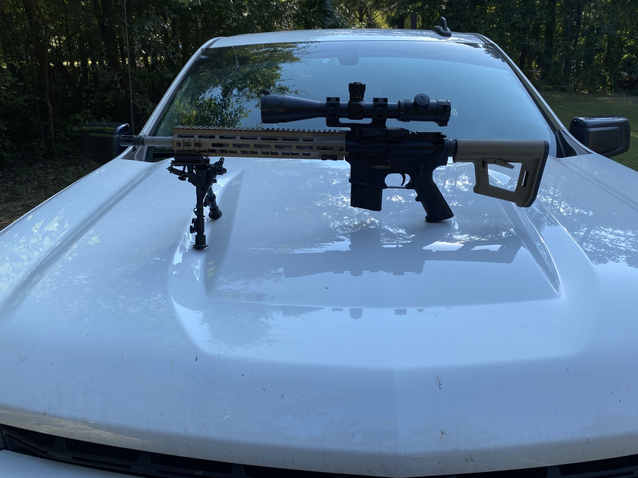

Aero lower with one of the new Magpul moe pr stocks
My new favorite stock. Too much slop but nothing a 2.5" strip of loop side velcro on the buffer tube couldn't fix. They have a DT-PR version that just started shipping, but my DT stock I have is a PITA to adjust so Im holding off on ordering one. With the velcro the PR is awesome.

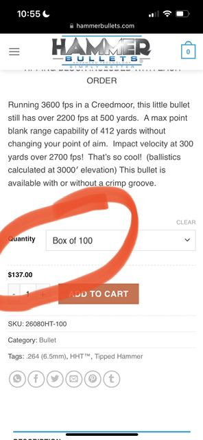

Right now, you can shoot the 80gr Hammer HT at 2950fps from a 16”.
One of the projectiles I had made will do 3440-3539fps from a 16”, so you’re looking at 22-250 performance from an AR-15 carbine without chasing pressure and burning barrels.
From an 18” Grendel, you’d be looking at 3513-3612fps.
