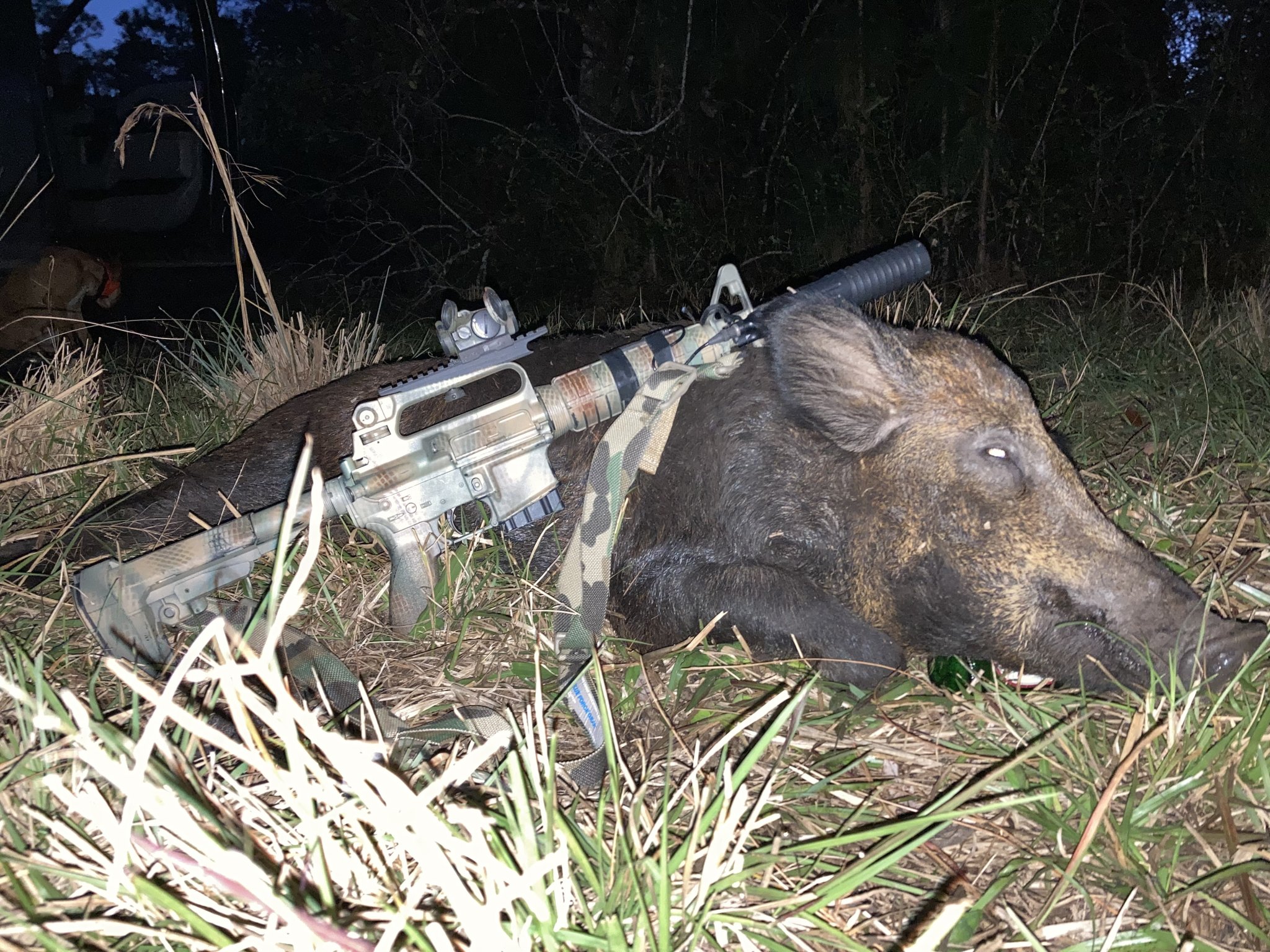

The 6mm ARC with 103 eldx hunting bullets all "knock down" (kill) hogs....about the same as the 6.5 120/123 gr 6.5 Grendel.I haven’t played around with the more popular 6 ARCyet , but I’ve shot and hunted with my Grendel a lot for several years now. I feel like it’s an agile cartridge if loaded properly can get a lot done. It’s a good compromise if your hunting a variety of game close up. Mostly mine is used thermal hunting. So it’s gotta be able to take down big hogs, but also hit those small fox’s, coyotes, and bobcats. The 123 sst aren’t really fur friendly though. That’s why I’ve been developing a load using the 100gr VT. I’m hoping that will be more fur friendly and when we’re calling I’ll just swap mags. I’ve also taken several small whitetail with it. I think for the AR platform it’s one of the best cartridges aside from 5.56 and still fairly cheap to shoot.

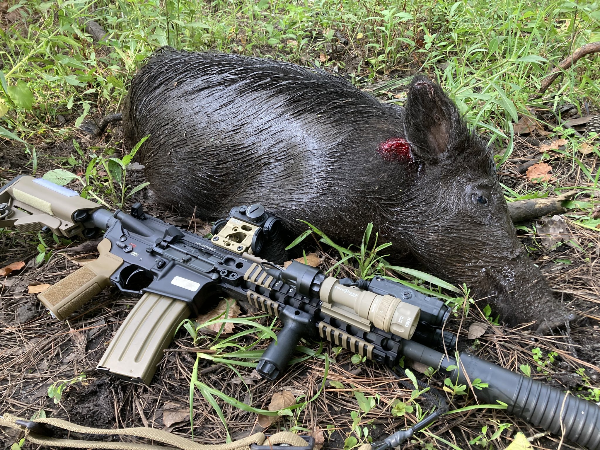

Real Hunters don't use 223 on big game, sorryThe 6mm ARC with 103 eldx hunting bullets all "knock down" (kill) hogs....about the same as the 6.5 120/123 gr 6.5 Grendel.
A 223 will kill hogs, especially with good hunting bullets.

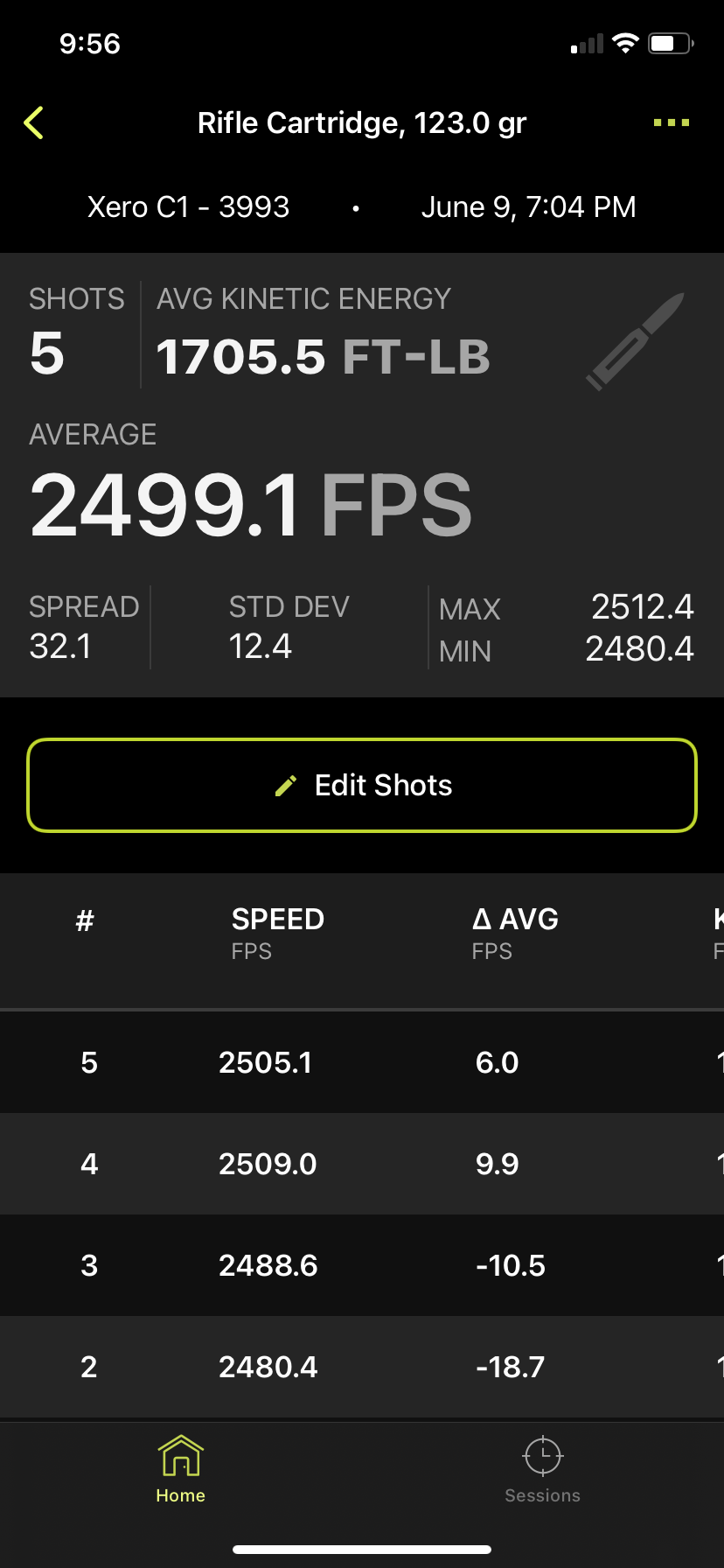

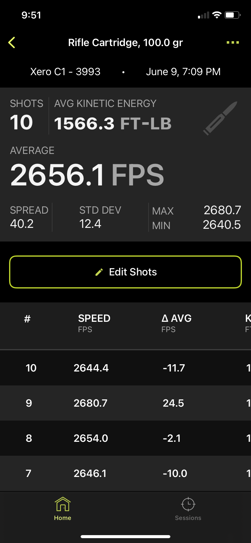

So right now, I’m really liking the 100gr ELD-VT box ammo from Hornady. It gives you basically 6mm AR/ARC performance without having to make the change when I looked at my real-world numbers vs Doppler data for 6mm ARC with 103gr-110gr.
