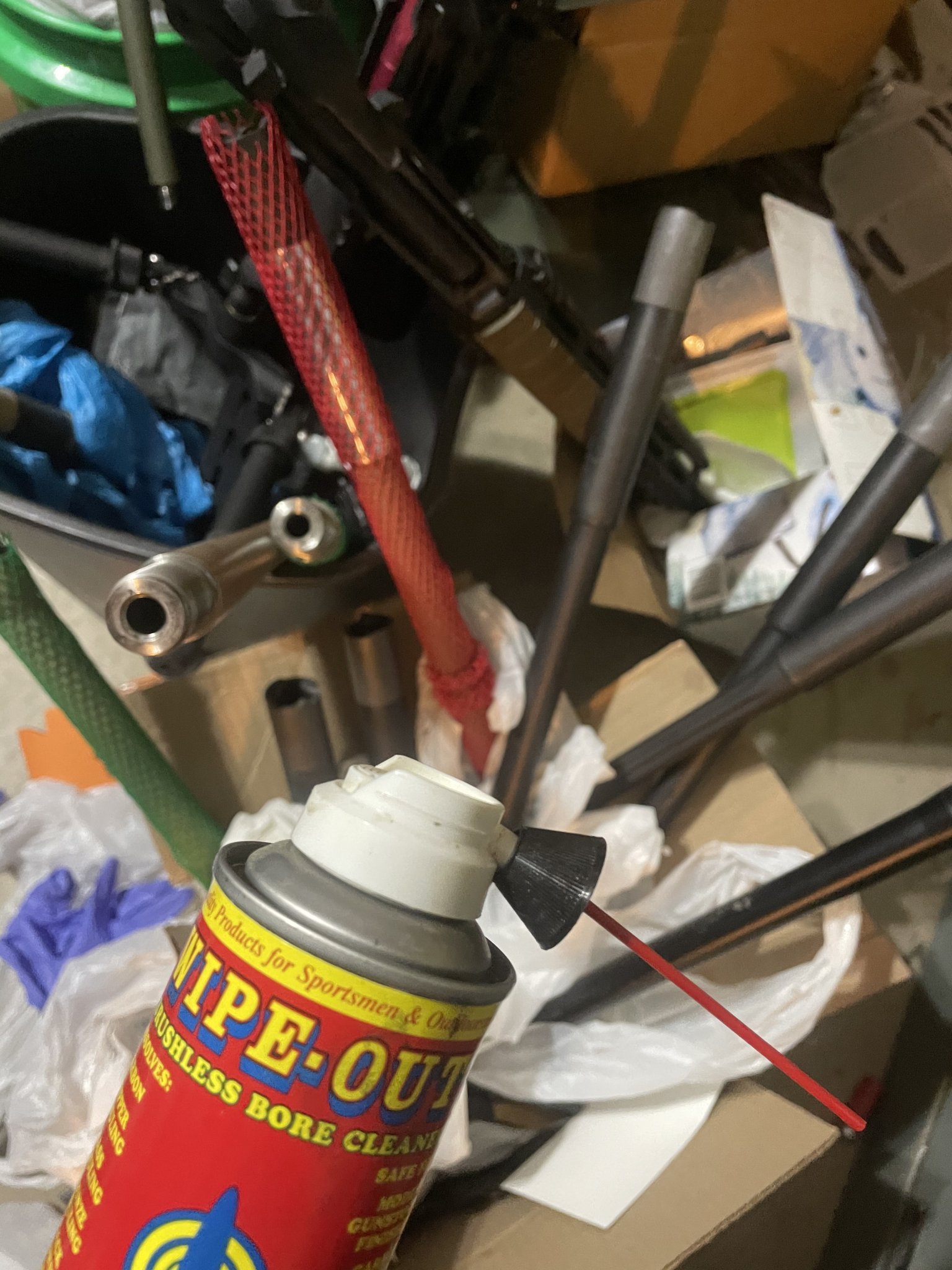

I’m sticking with wipe out and patch out even though it can take a few soakings.

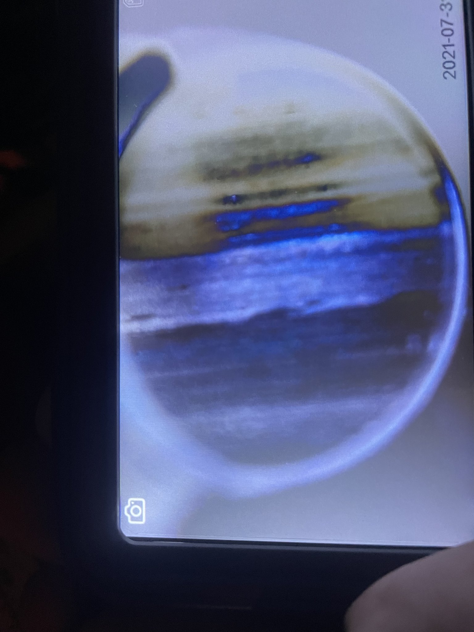

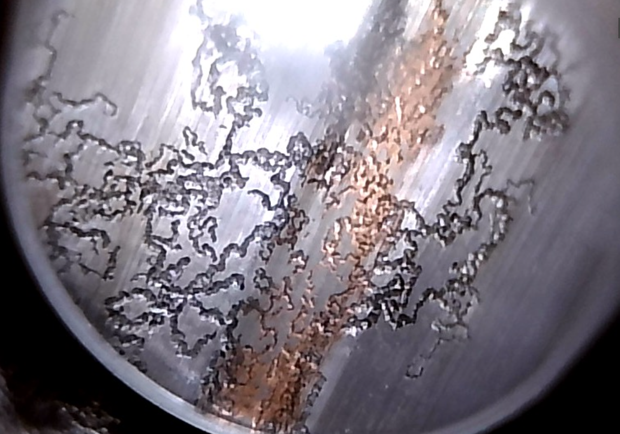

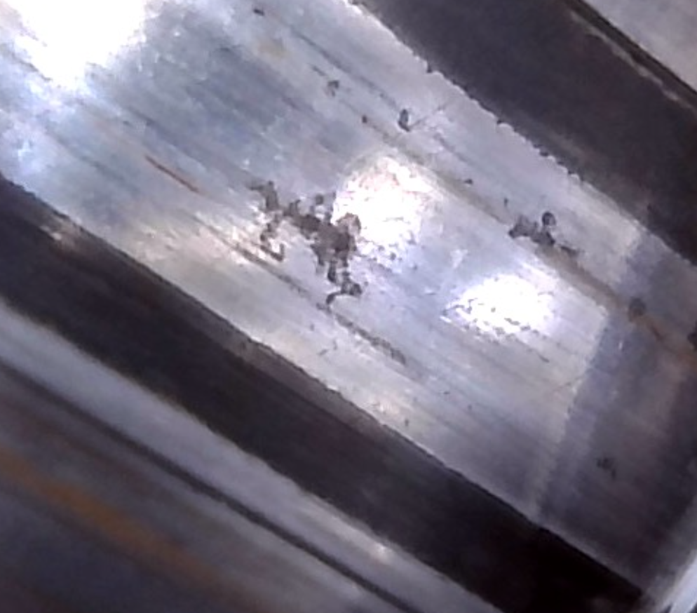

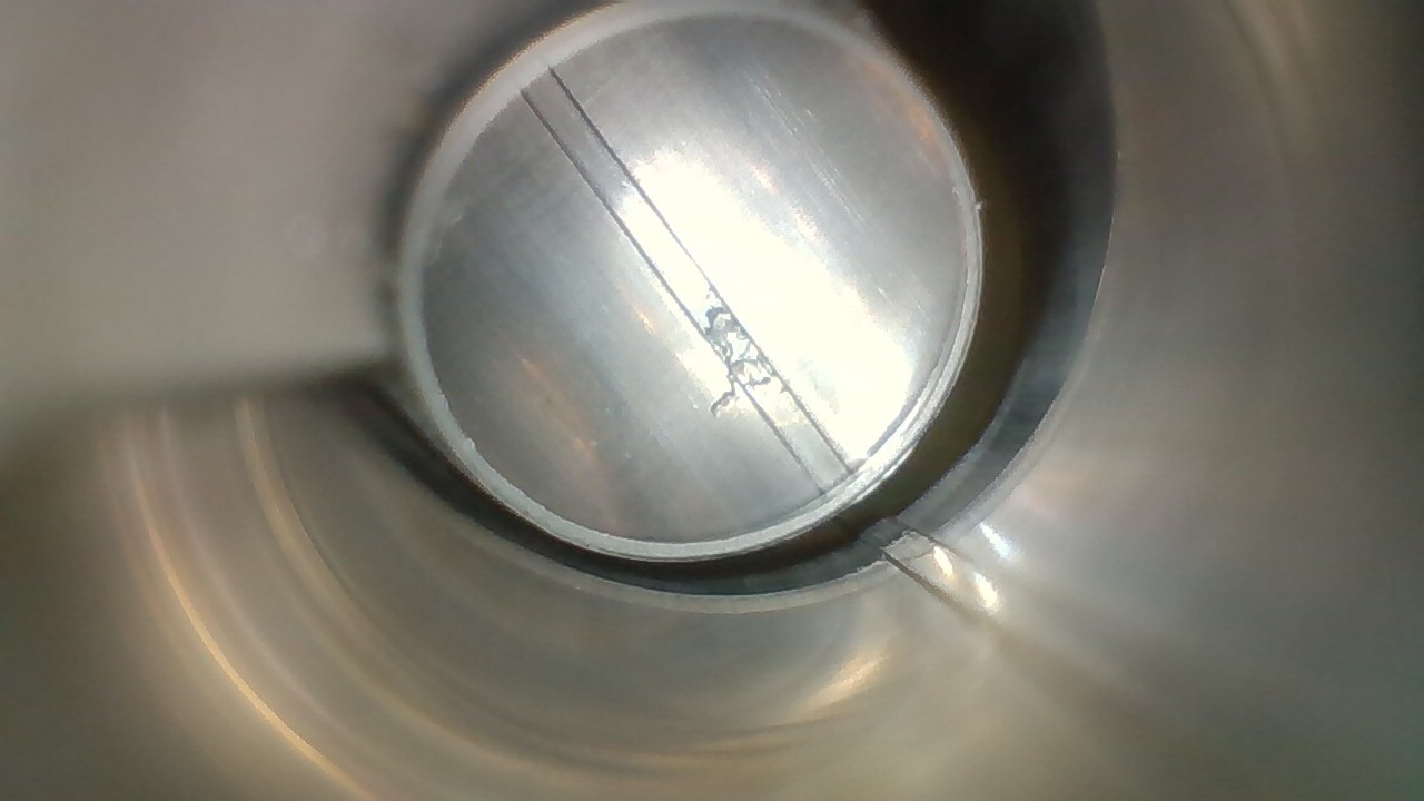

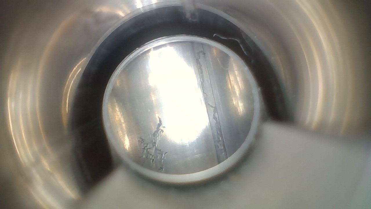

I have come to a conclusions that you may want to hear about. In a previous thread, I was noticing some of my high value barrels degrading in accuracy quickly. I decided to scope them and found a common theme amongst the barrels that shot the worst. I had dreaded "barrel worms" or what is referred to as filiform corrosion, image below.

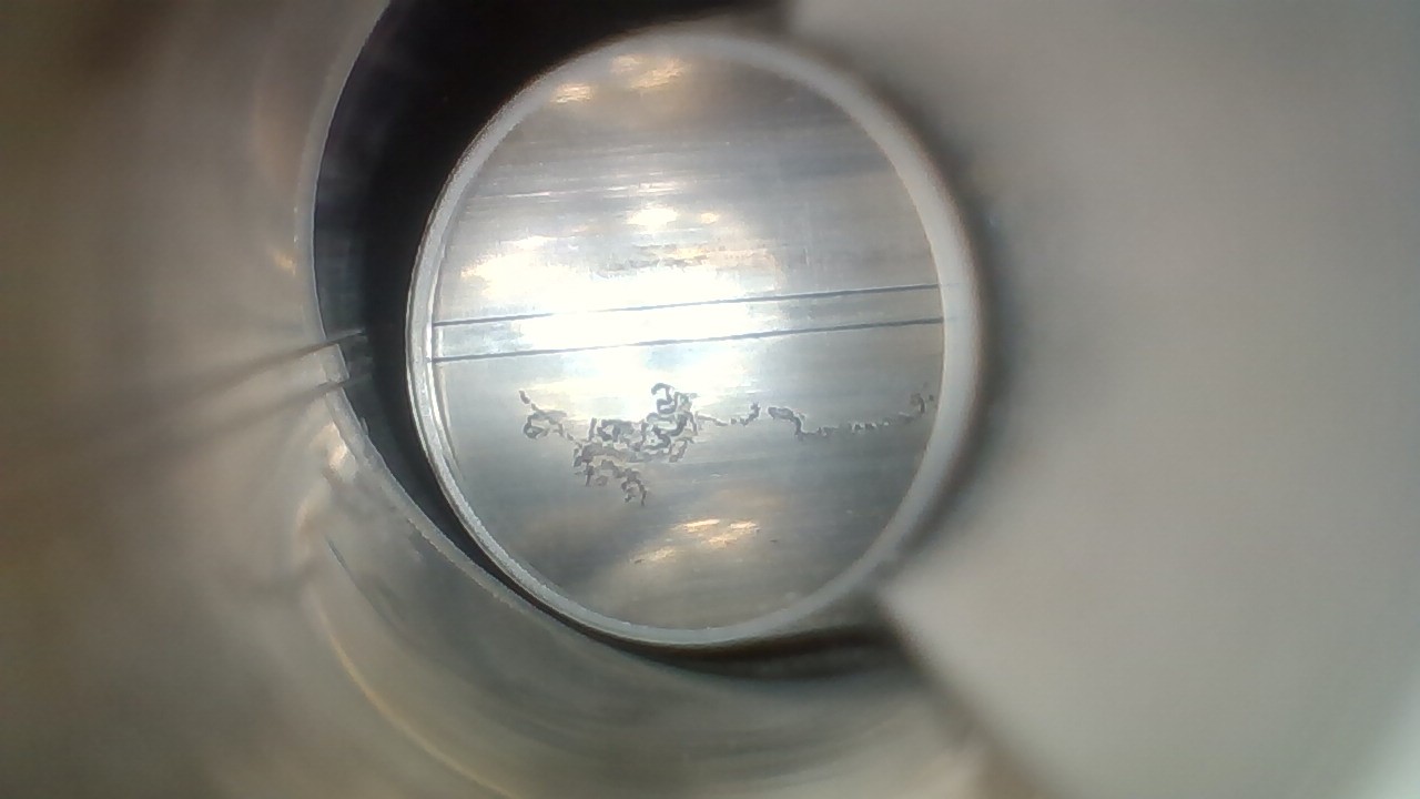

I have seen this issue in several of my barrels, and I now know what is causing this. It's the use of the cleaner called M-Pro 7, inside the bore. When there is carbon built up and NOT completely cleaned out, then covered with M-Pro 7, a chain reaction kicks off, moisture in the air probably contributes. After sitting for a few months filiform corrosion starts to weave it's way outward and under the coating of M-Pro 7.

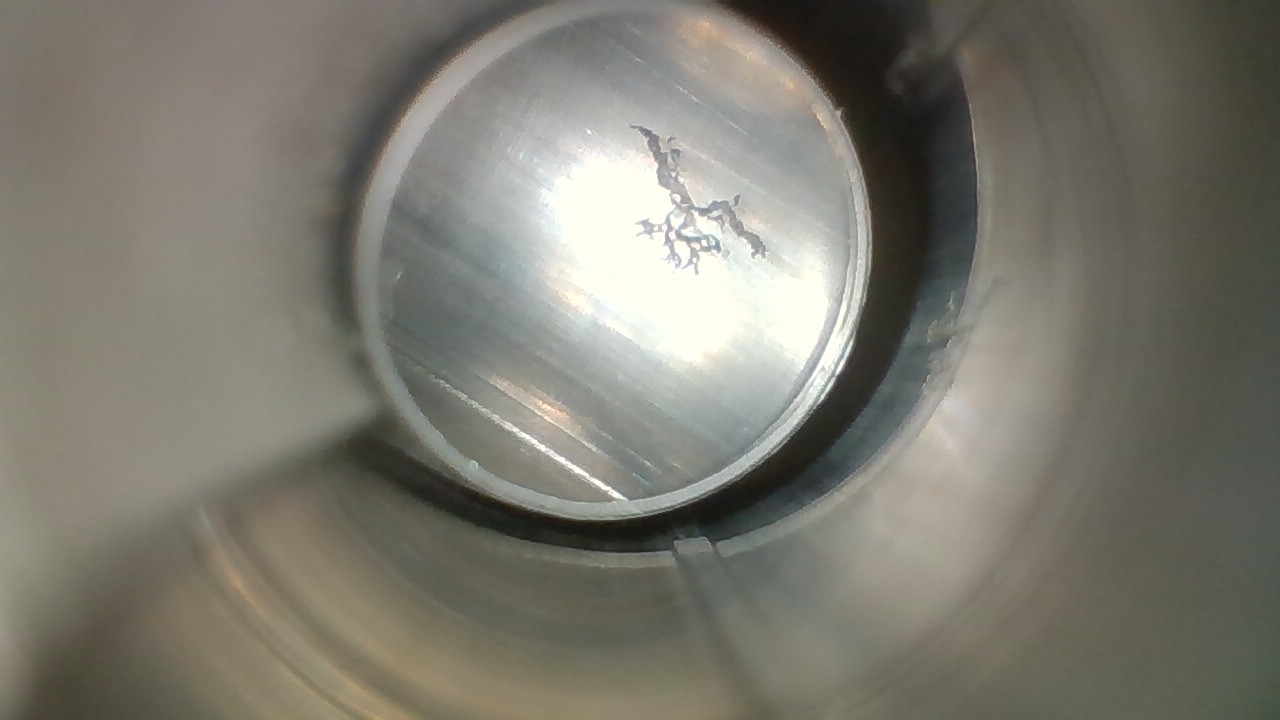

Here is another barrel below that was only cleaned with M-Pro 7, and nothing else. As you can see the same pattern is starting, albeit not as bad as the totally ruined AI barrel above.
This is the stuff. I am sure people will balk, "it couldn't be that! it's supposed to clean and protect!" Well, it's probably in combination with a lot of things like how the guns are stored and moisture. But the agents in M-Pro 7 are the catalyst. My other barrels that are not cleaned with this stuff, or cleaned at all for that matter do not have the same issues. After months of trying to figure this out, this is my conclusion. As per Frank Green on the site I am now using Hops #9, and chasing it with a lite coat of CLP, hopefully it does the job of stopping any further corrosion. Heaven forbid I would ever destroy any of my Bartlein barrels, that would be a disaster.

Not sure exactly what you are asking in the terms of have I seen it happen? You mean during the barrel making process? I'll say no. Not what is in the pictures at the beginning of this thread.@Frank Green have you ever seen this happen with any Bartlein barrels? I know you try to control the alloys pretty well and work with the mill closely.
Just trying to see if we can expand on what @Kanwhitetails just said.
Also if people don't know Frank Green is Bartlein.
Frank, thanks for the insight, once again, your commitment to this community is truly impossible to put a value on.Not sure exactly what you are asking in the terms of have I seen it happen? You mean during the barrel making process? I'll say no. Not what is in the pictures at the beginning of this thread.
Have I've seen barrels guys have sent in and or brought back after shooting with these barrel worms/pitting/etching in them? Yes. I'll say though it isn't common. Maybe like two a year or so and at times if that.
Hard to say if it's in the steel from when it was made. It's rare and I mean rare we ever find a piece of steel with voids in it from inclusions in the steel. If I had to put a number on it...like maybe 6 barrels in 20 years out of tens of thousands that we've made.
I do feel it's more from cleaning or a lack of cleaning and putting the gun away dirty etc...it's a chemical type reaction.
Just recently I sent a barrel out to the lab. Barrel had like 80 rounds on it. It had what looked like a few random pits in it (not the barrel worm syndrome). When I got the lab report back and the pictures which we're magnified inspected at 200x, 300x and 500x magnification. This is what they found...this is the short version....
The point indications were corrosion tubercles on top of shallow pitting corrosion sites. 2. The tubercles contained sulfur and chlorine as notable elements. The chlorine suggests use of an improper cleaning substance or otherwise unfavorable environment. 3. No indications of voids or porosity within the metal were observed. 4. No issues with the raw material were observed.
So in the first sentence look what it says... (on top of shallow pitting) but they stood proud about +.004" up from the surface. They where not what I though where pits or voids. So where did the chlorine come from?

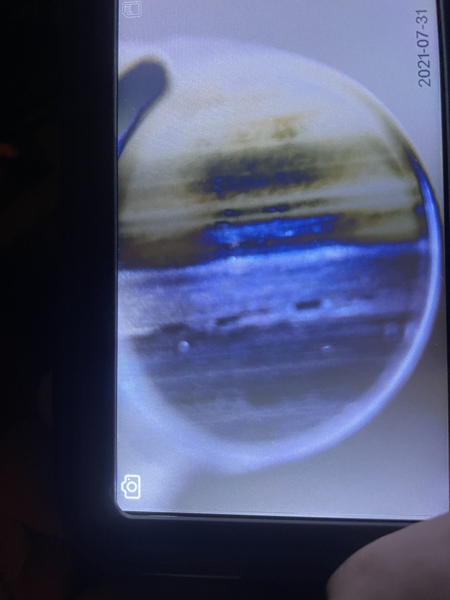

You need ivermectin just like Rogan did, that’s what the internet said.Ok, the title is a joke, but check this out. From my AIAX barrel, it used to shoot one shot on top of the next, now the groups have opened up, it still shoots good but just not 1/4 moa anymore. WTF did I do, was this from rust? Overpressure? I have never oiled my barrels and was this from erosion? Whats the copper color stuff, is that copper or rust? Gunsmiths chime in please.
View attachment 7767379View attachment 7767380View attachment 7767381
I do not doubt that's the case for most people. I believe I met several conditions that lead to corrosion, possibly a trifecta, one of those being environment/humidity. Possibly being close to a coastal region contributed.I use MPro7/Hoppe’s Elite. I’ve been using it for years. No barrel worms here
